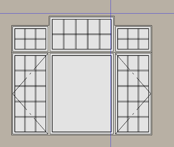

DenisonDrywall Posted 13 hours ago Share Posted 13 hours ago (edited) Why can I not get these units to mull together? They will mull 3 across but I can't mull the top units to the bottom units. Its not an option in the task bar to mull them together when the top units are selected with the bottom units. Thanks. Jennifer Edited 13 hours ago by DenisonDrywall Link to comment Share on other sites More sharing options...
GeneDavis Posted 13 hours ago Share Posted 13 hours ago Check to see all windows are on same floor. If the uppers cross a ceiling line even with upper room as open below, they won't mull. 1 Link to comment Share on other sites More sharing options...
DenisonDrywall Posted 13 hours ago Author Share Posted 13 hours ago It is a one story with vaulted ceiling. I moved the wall so that the top windows were not part of the attic wall (so they were all in "one" wall) it didn't make a difference. i tried moving all the windows to be at floor height so they were again, all in 'one' wall...didn't work either. does it have something to do with they are the Marvin Window blocks? Link to comment Share on other sites More sharing options...
DBCooper Posted 13 hours ago Share Posted 13 hours ago Make sure that all 3 bottom windows have the same top and bottom heights and same elevation reference. You should be able to mull the 3 of them together. Make sure that all 3 top windows have the same bottom heights and are in the same wall as the bottom windows (not in the attic wall). You should be able to mull the 3 of them together. Now you should be able to mull the top mulled unit with the bottom mulled unit making a "nested" mulled unit. I this still doesn't work, post your plan. Link to comment Share on other sites More sharing options...
DenisonDrywall Posted 11 hours ago Author Share Posted 11 hours ago Prem.zip I did all that. plan posted Link to comment Share on other sites More sharing options...
CarrieS Posted 11 hours ago Share Posted 11 hours ago Gene is correct. You have the windows on 2 different floors. Even if it doesn't look like it in elevation. In your plan view you have the upper windows on the Attic Level. Cut and paste the windows down to floor 1 and you'll be able to mull them properly. Link to comment Share on other sites More sharing options...
DenisonDrywall Posted 11 hours ago Author Share Posted 11 hours ago I physically moved them all to start at floor level to mull them and it still wouldn't do it Link to comment Share on other sites More sharing options...
DenisonDrywall Posted 11 hours ago Author Share Posted 11 hours ago Ok. So i cut and pasted them (which it didn't want/like to do) instead of moving them and then it worked. This is something that needs to be changed in the program. We shouldn't have to do that. thank you for the help. 1 Link to comment Share on other sites More sharing options...
