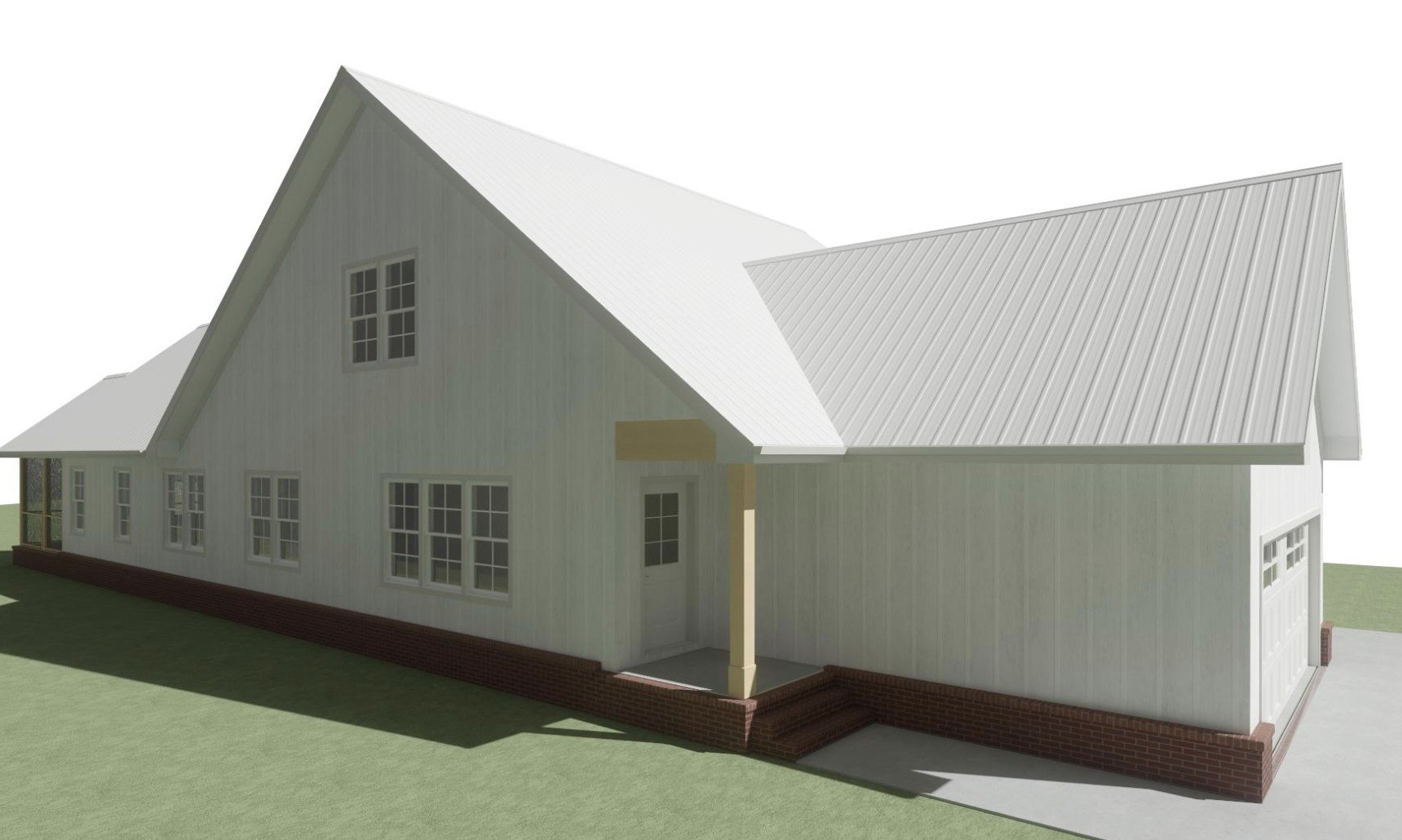

winterdd Posted Thursday at 11:53 PM Share Posted Thursday at 11:53 PM Is there ANYTHING else in the library for board & batten besides what we all have, CA board & batten and James Hardie products. Hardie B&B is too close together and looks like metal and CA B&B just doesn't stand out as well in renderings. See below, one is my file and the other is my same file I threw into chatgpt. The battens are way better in chatgpt and more appealing to send clients. Not a big deal though, just asking. I love CA, don't get the wrong idea. Link to comment Share on other sites More sharing options...
Renerabbitt Posted Friday at 12:06 AM Share Posted Friday at 12:06 AM Are you on X18? use the new cladding features and add any type of board and batten that pleases you 1 Link to comment Share on other sites More sharing options...
Mark3D Posted Friday at 12:07 AM Share Posted Friday at 12:07 AM Have you looked at the new feature in x18 1 Link to comment Share on other sites More sharing options...
Rpadge Posted Friday at 01:52 AM Share Posted Friday at 01:52 AM If your not on 18, you could use a wall material region to create battens. I beleive if you do a search there a couple of posts on here about it. 1 Link to comment Share on other sites More sharing options...
winterdd Posted Friday at 03:03 AM Author Share Posted Friday at 03:03 AM No X18 yet! Link to comment Share on other sites More sharing options...
Rookie65 Posted Friday at 03:17 AM Share Posted Friday at 03:17 AM Maybe look at the Certainteed bonus catalog and the vertical siding 1 Link to comment Share on other sites More sharing options...
joey_martin Posted Friday at 03:00 PM Share Posted Friday at 03:00 PM If not on X18 then I like to use a material region. You create a batten and then multi copy it down the length of the wall. It will cut itself around openings and gables. It's pretty easy to do. You can also add a "framing" layer to the exterior and have it "frame" the battens, though I didn't have good luck with that method. 1 Link to comment Share on other sites More sharing options...
winterdd Posted Friday at 03:47 PM Author Share Posted Friday at 03:47 PM Thanks guys! All good info..... 1 Link to comment Share on other sites More sharing options...
