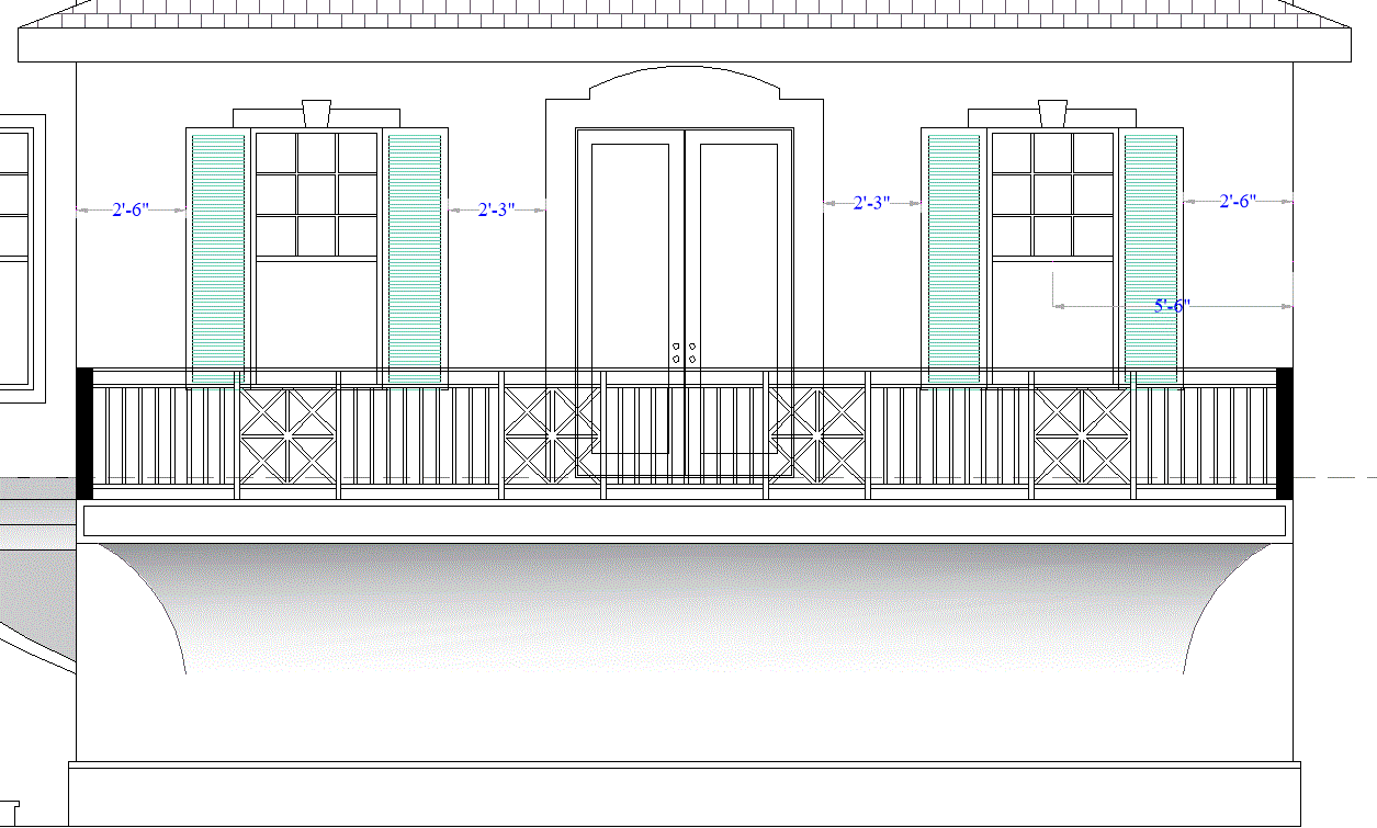

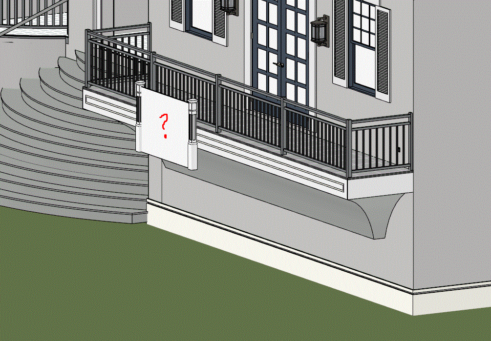

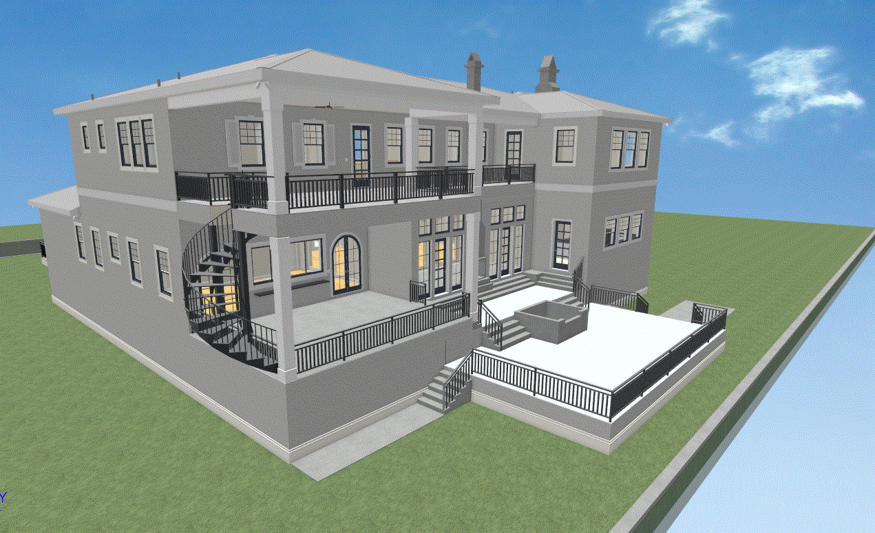

Before I dive into this railing & the 6 or 7 other railings around this house I thought I would ask.
To get a double top rail with balusters I would have to create a symbol or mill work for that?
To get the decorative panes I would need to do the same?
And I would need to break the railing wall into segments to place the decorative portion in that wall.

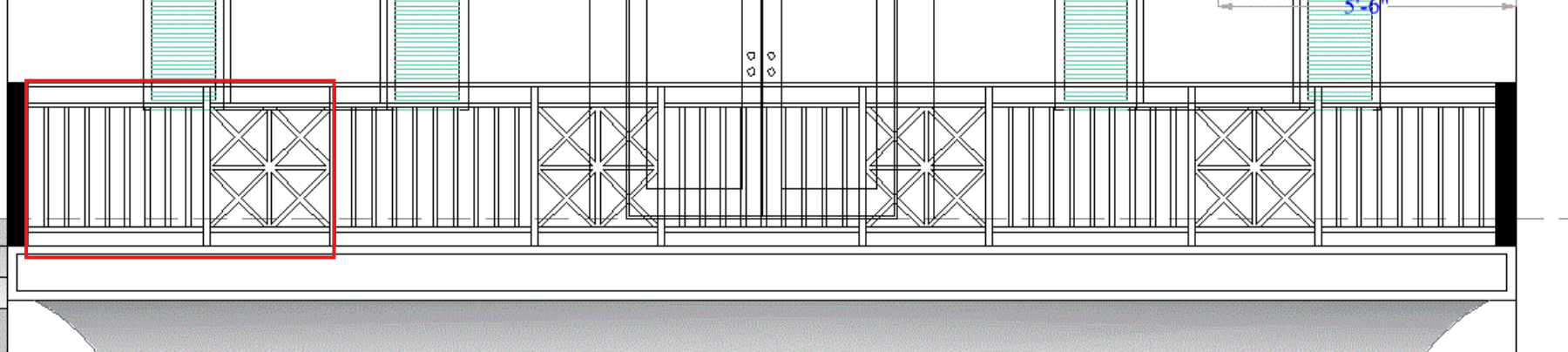

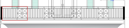

Could you find a good repeatable "breaking point" and just make one panel that includes the balusters and the custom panel?  Then you don't have to try and break and do funkyness.
Meaning...what if you make this section in red one panel.  That's your repeat, set that as your custom panel and then it should work?...

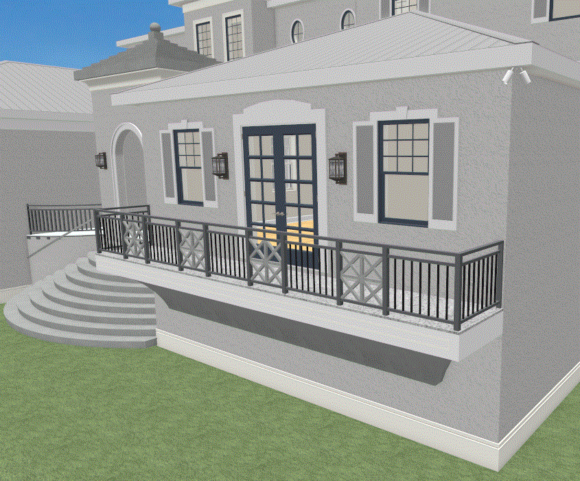

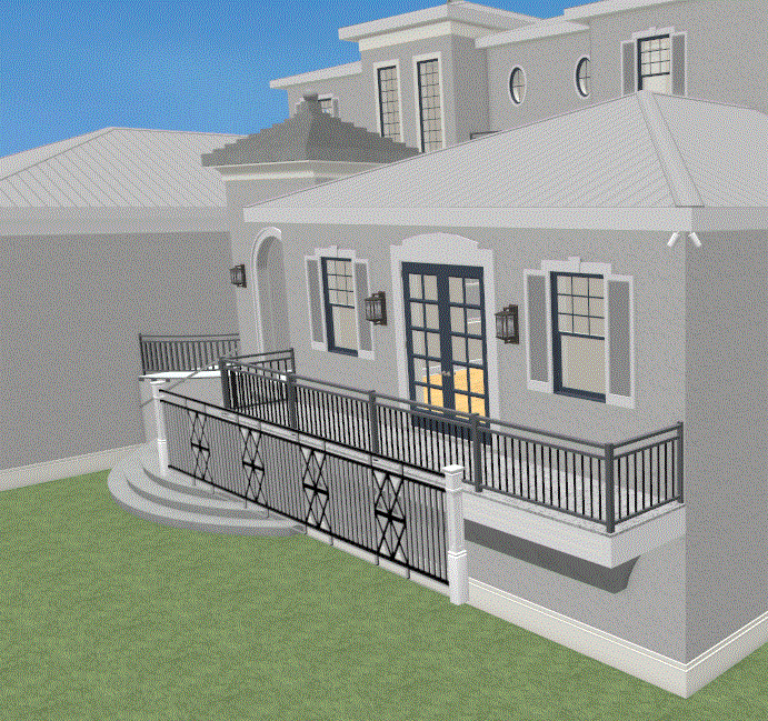

2 hours ago, ACADuser said:
I was able to get the main railing with the double top rail in another post.
Tried you railing Rene but it did not come over correctly. Thanks for the gift though!
Lol you used all the exact right combinations of render settings for that to not show up. Raster views it will show correct and vector elevation should show but may need the pattern offset and scale adjusted

It is not that difficult once you done one, but defiantly tedious work. Headed to the Keys for 2 weeks so the rest of the railings will have to wait.
Building in these flood zones is a PITA.
