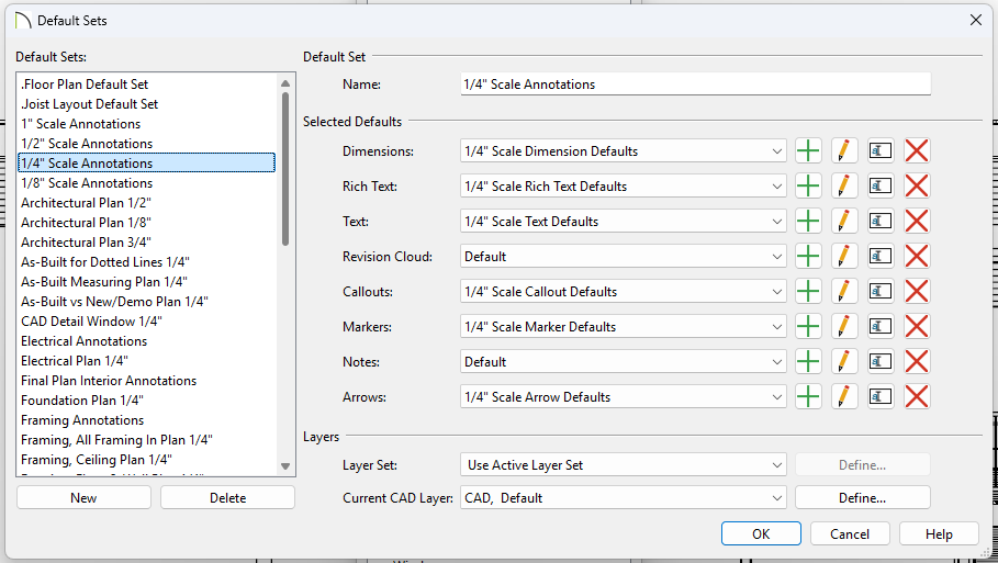

JonathanK Posted May 11 Share Posted May 11 Would default sets be what you're looking for? You can setup all your presets in there, and when you pull your elevation view, you can select which default set you want that has all of that information setup on the back end. Link to comment Share on other sites More sharing options...
JonathanK Posted May 11 Share Posted May 11 Here's a snip of the Default Set dialog box that allows you to change the aspects of each Default Set. So essentially you would create new (or use existing) settings for each of these items. They would be custom to whatever Default Set you're wanting. Link to comment Share on other sites More sharing options...
HannahKucerova Posted May 11 Author Share Posted May 11 1 hour ago, JonathanK said: Would default sets be what you're looking for? You can setup all your presets in there, and when you pull your elevation view, you can select which default set you want that has all of that information setup on the back end. Hi Jonathan, The Default Sets option does do some of the elements of what I am after, but it doesn't allow me to set the default layer for the elevations or specific clippings, etc. If what I was after isn't feasible, it's definitely a "halfway" bridge. Was just trying to get everything in one pop. :-) Link to comment Share on other sites More sharing options...
Joe_Carrick Posted May 11 Share Posted May 11 31 minutes ago, HannahKucerova said: Hi Jonathan, The Default Sets option does do some of the elements of what I am after, but it doesn't allow me to set the default layer for the elevations or specific clippings, etc. If what I was after isn't feasible, it's definitely a "halfway" bridge. Was just trying to get everything in one pop. :-) Default sets include layersets. That should handle everything. Link to comment Share on other sites More sharing options...
HannahKucerova Posted May 12 Author Share Posted May 12 5 hours ago, Joe_Carrick said: Default sets include layersets. That should handle everything. Yes, they do. But unless I am missing something very obvious, even when using these custom defined default sets (which I do use and have several custom default sets set up for my workflow), all of my newly created elevations get set to whatever layer I have put in the Cross Section/Elevation defaults. There is also no option to control the individual camera/section settings, which is another thing I was hoping to streamline. Link to comment Share on other sites More sharing options...
JonathanK Posted May 12 Share Posted May 12 You can change the different camera elevation defaults to be more "standard" to what you do 80% of the time. But you're right...you cannot have different "types" of wall elevations. The only thing you can do is set your wall elevation default, and create a bunch of different default sets that are what you're looking for. When you pull your wall elevation or exterior elevation, or cross section, then you change your default set in that particular camera view. In reality...probably same amount of clicks. Link to comment Share on other sites More sharing options...
