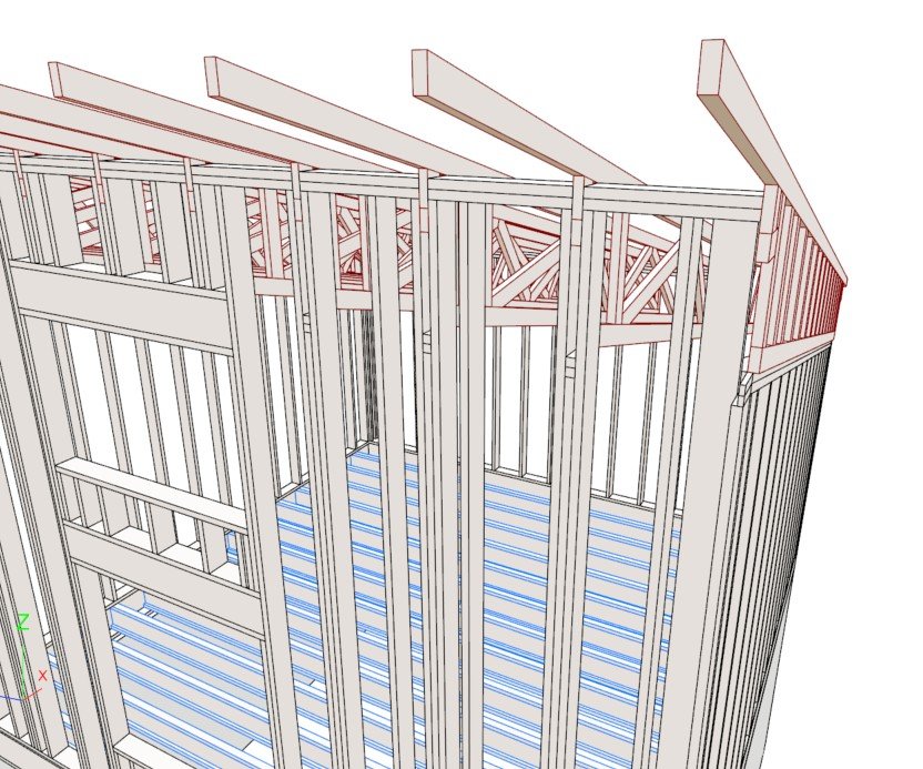

MN_JohnH Posted May 8 Share Posted May 8 (edited) I am wondering how to build a roof truss that bears on the top cord like this picture and then I would need to get the wall to frame up to that bearing point. I have a plan here where I was able to change the shape of the truss and I made the walls to balloon through ceiling and now they go all the way to the upper truss cord and don't stop at the bearing point I created in the trusses with the truss envelope. Also, how can I get the framing to use my trusses instead of making it's own trusses in addition to mine? Raised bearing roof truss problem.plan Edited May 8 by MN_JohnH Added information Link to comment Share on other sites More sharing options...

MN_JohnH Posted May 9 Author Share Posted May 9 Thanks for the responses. I guess I didn’t make it clear that I know how to draw the trusses. The problem I’m having is controlling where the walls frame to the truss. Basically, I can’t find any setting that lets me define the top of wall framing at a specific point on the truss. Yes, I can raise the roof and get the look I want, but when I reframe the walls I still end up with the same problem. For example, what if I want the wall to frame to the bottom chord of the truss? On the lower side I can accomplish that by setting the room ceiling height and not balloon framing through. But then the higher side frames to that same level. If I set the walls to balloon through, then the framing runs all the way to the top chord instead. What I need is a way to control the top plate height / bearing point of the wall framing relative to the truss. Right now, when the wall frames all the way to the top cord, the framing gets crazy because it tries to frame around all the truss members. My second problem is that once I manually draw and place my trusses, then build the roof framing, Chief creates another complete set of trusses automatically. So now I have duplicate trusses plus even more crazy wall framing, and it ignores the bearing points I established in my custom trusses. So I can build and customize the trusses fine (I think), including locking the envelope with bearing points, but I can’t get the walls to frame to those bearing points correctly. Again, my sample plan is attached. Raised bearing roof truss problem.plan Link to comment Share on other sites More sharing options...

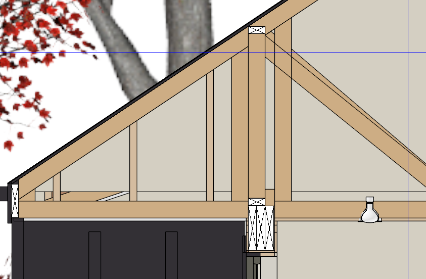

GeneDavis Posted May 9 Share Posted May 9 Have you done as suggested by me and others? Edit the truss to have bearing pockets, edit the walls to rise up into the bearings? It's just basic Chief Architect. Do it and show us results. My work is all in a locale with a gsl of 100 psf, and I have never met a header-under-truss situation I could not solve. Here's a pic of one going to con docs right now. You can see how the truss chord is interrupted so that a pocket is formed so the bearing is accommodated. The section view is picking up the 2x4-framed close-off panels we are doing in every 24" truss bay. You can see the top and bottom members as crossboxes in the view. The job is getting all its walls panelized in the shop sistered alongside the truss plant, and these are part of that package. I never show my truss guy anything other than the envelope required for a truss. This job has one exception, a gable end truss for which I want the 2x3 upright chords done to a specified layout. You may not know this, but the 2D truss detail views you have in Chief, showing all the chords and webbing, those are very editable and you can arrange any bearing pockets, and web arrays you want using Chief CAD. Link to comment Share on other sites More sharing options...

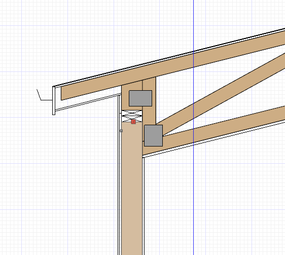

GeneDavis Posted May 10 Share Posted May 10 Edited truss envelope, chords, bearing, and web. Edited wall framing. Link to comment Share on other sites More sharing options...
MN_JohnH Posted May 10 Author Share Posted May 10 10 hours ago, GeneDavis said: Edited truss envelope, chords, bearing, and web. Edited wall framing. This is what I want to do but my question is, how do you set the top of that plate so that when you reframe that wall it frames to that level again? I know how to build and manipulate the trusses, I know how to manually raise the top plate and stretch my studs. I am thinking that is what you did here. But my hope is that there is a way to set the top height of the wall so that if I change a window in that wall or anything like that and want to reframe the wall, I don't have to manually adjust the top plate and stretch the studs every time. Link to comment Share on other sites More sharing options...
GeneDavis Posted May 10 Share Posted May 10 Short answer: you don't. Chief has no settings you can do in dialogs that raises plates above ceiling heights. Chief generates wall framing based on room def specs, so clicking on a wall and framing it places the top plate at the ceiling height specified. As I said upthread, you need to edit the framing to raise the plates where wanted, and extend the framing up to the raised plates. Those edits don't "stick" if you doodle openings in the wall. I threw out the test file and can't play with it, but I just thought you might succeed this way. It'll do it for a simple shed building with roof shape like you showed in your upthread image of the truss with bearing pockets. Use CAD to figure the plate heights you want, both low and high sides, and do room division so that all rooms on the low side have ceiling heights for that low side, and likewise across the building for the high side. Fram those walls and you might find they are poked up into the truss envelope where you want them. Now all you have to do is edit the truss. Show us your results. 1 Link to comment Share on other sites More sharing options...

GeneDavis Posted May 11 Share Posted May 11 Would you be satisfied if your section looked like mine, upthread? No CAD detail needed. Your wallframe elevations will be exactly how they should be built, and your trusses will have the bearing pockets exactly to your specs. I did it in Chief. You should too if that is what you're after and needing. Lots of us do workarounds due to the software's limits. 1 Link to comment Share on other sites More sharing options...

MN_JohnH Posted May 11 Author Share Posted May 11 11 hours ago, GeneDavis said: Would you be satisfied if your section looked like mine, upthread? No CAD detail needed. Your wallframe elevations will be exactly how they should be built, and your trusses will have the bearing pockets exactly to your specs. I did it in Chief. You should too if that is what you're after and needing. Lots of us do workarounds due to the software's limits. Yes, I will just work it like this. I will build the trusses and then, when I am reasonably sure that my wall is done, I will edit it so that is it right in the cross section and any 3d framing view. (and hope that I don't accidentally reframe all or that wall again). I just was hoping there was an easier way. Sorry for dragging everyone down this rabbit hole. I still don't know why Chief wants to use it's own trusses after I have put mine in but I can work around that too. Thanks! Link to comment Share on other sites More sharing options...
