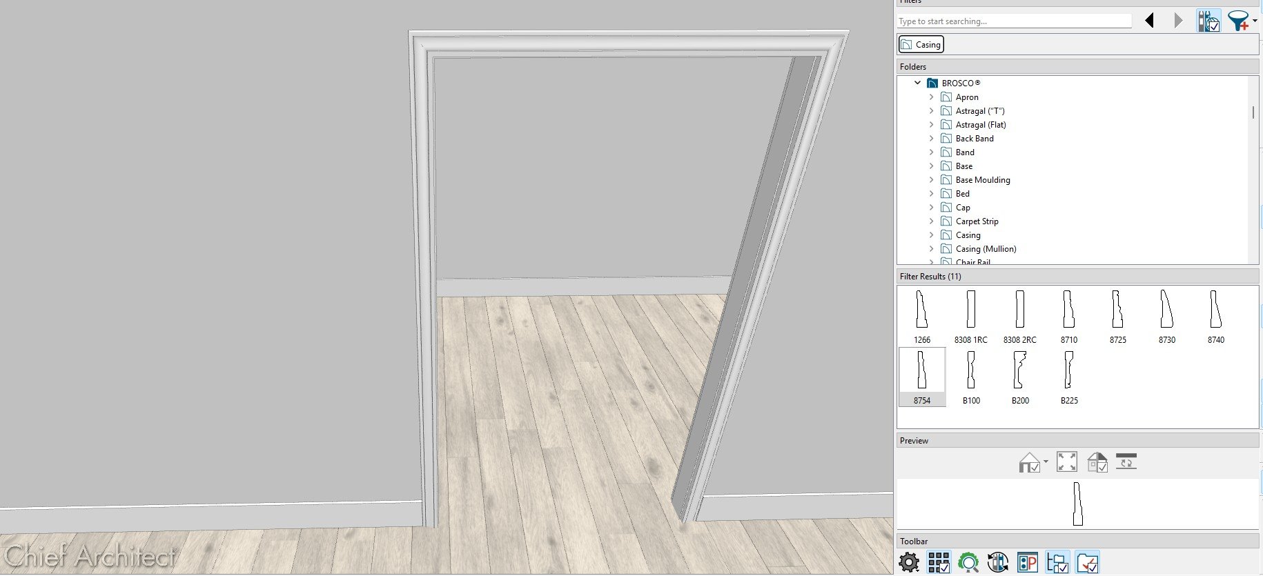

Gary-Doski Posted January 19 Share Posted January 19 My Brosco Library installs the door casing backwards, Anybody else have this? Link to comment Share on other sites More sharing options...

robdyck Posted January 20 Share Posted January 20 8 hours ago, scottharris said: Seems to work okay for me. In the picture you've posted, the casing is illustrated backwards. The thin portion should be at the jamb. When reviewing casing molding profiles from the library, the molding profile must appear 'upside down' in the library browser in order for casing to not be installed backwards. I doubt there are many (any) casing manufacturers who illustrate their casing products with the thicker portion at the top, although the 'flat' portion may be at the right or the left. In Chief's library, there are many different orientations for casing profiles and the main variation from the expected results is in manufacturer content. And, if a person wanted to make a corrected version of the Brosco casing profiles, each molding profile would need to be placed and then oriented correctly (for Chief), and then added to the Library and renamed. Chief allows molding rotations of user library items, but not a reflection of the profile. Link to comment Share on other sites More sharing options...
Chief_Content Posted January 20 Share Posted January 20 Hi Gary, It does appear that these casing profiles are not oriented in the expected way. We'll make a note and work toward getting an update posted. Thanks for pointing this out! Link to comment Share on other sites More sharing options...
DG1949 Posted January 21 Share Posted January 21 In the meantime, you can copy the molding to your User catalog, then place the symbol, rotate and reflect it as needed it and add it back to the User Catalog. Link to comment Share on other sites More sharing options...
