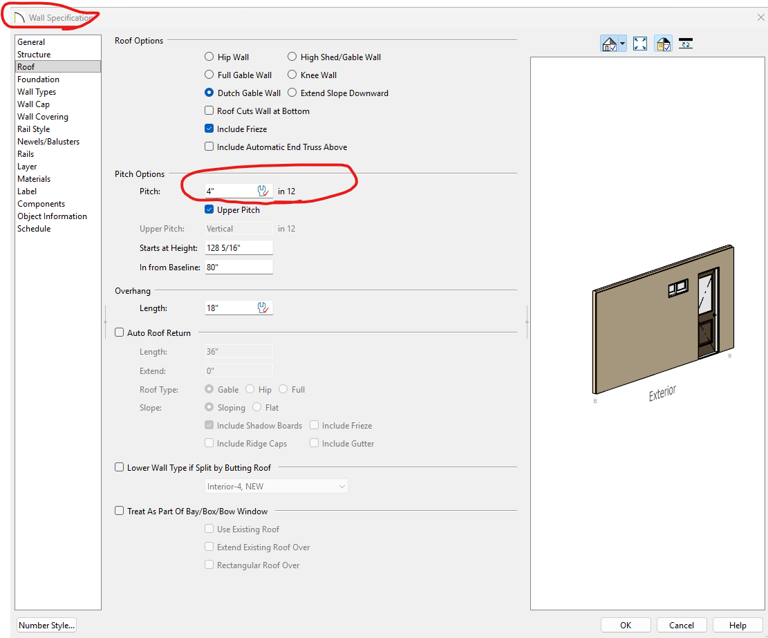

DRAWZILLA Posted October 27, 2025 Share Posted October 27, 2025 In the porch wall dbx, you can make the roof pitch different then the house on an individual wall basis and still use auto roofs Link to comment Share on other sites More sharing options...

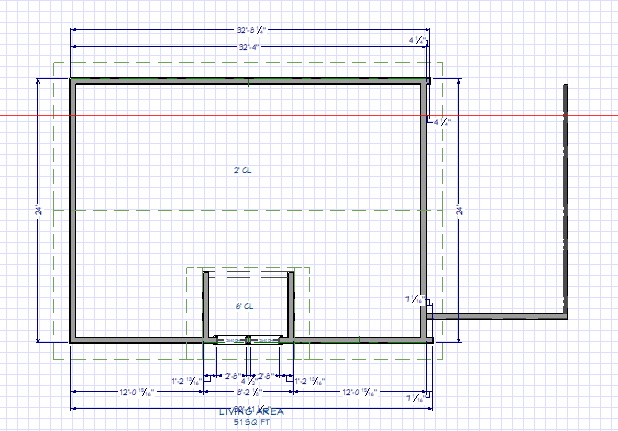

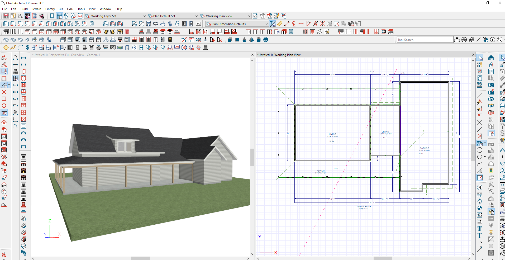

Garybills Posted October 28, 2025 Share Posted October 28, 2025 Like they said Change the porch wall pitches, one thing you will need to change the front and back porch rails, in the roof tab to have upper pitch set at the house roof pitch or it will make the house the pitch of the porch. This is auto roofs all the way. You do have to have a 2nd floor in the tall part. I have it set to 24' ceiling height and made a small room in the middle for the shed dormer.  Link to comment Share on other sites More sharing options...
