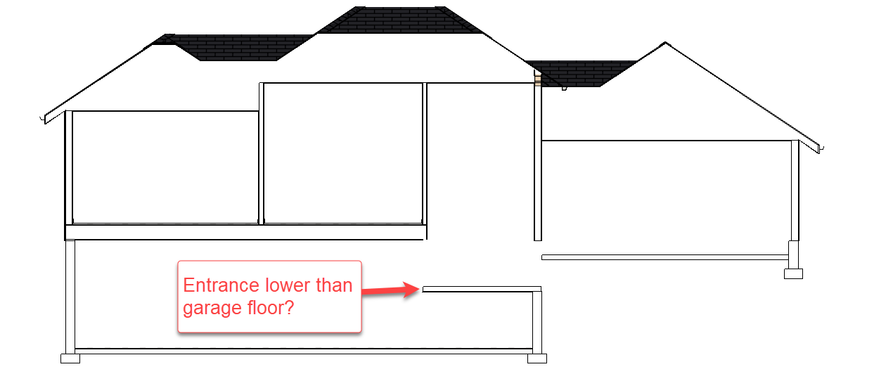

decorators3 Posted September 23, 2025 Share Posted September 23, 2025 Hi I've attached my plan as well as the PDF plans sent to me. I cant seem to figure out if I have the split entry correct . there is a gap between the garage and the foundation and not sure if i have the garage height etc done properly to show correctly in the 3D rendering Wondering if i have made some error from the pdf to plan ??? Thanking you in advance Cheers Levina 24 Frampton_r2.pdf for ca.zip Link to comment Share on other sites More sharing options...
GeneDavis Posted September 24, 2025 Share Posted September 24, 2025 Looked at the pdf and cannot understand the garage. The floor plan shows a door to the front entry foyer from the garage, and no step height is called out. The elevation is clearly showing garage floor elevation a few steps down. Have I missed it, or is no floor elevation data given on this pdf plan? Link to comment Share on other sites More sharing options...
SHCanada2 Posted September 24, 2025 Share Posted September 24, 2025 (edited) my guess is the exterior front steps should only be two risers or they are adjusting the grade next to the steps. This would give you enough to get into the garage, but then that would screw up the front windows (they would need window wells). you might want to drive by and see it or look on google streetview. I also notice the garage floor looks like it is a couple inches above the bottom of the front stairs ...or they have 3 risers in the garage and they have to make sure not to drive into it Your "porch room" is set to -53" absolute floor elevation. Why is it a porch room, as it is inside the house? It should not be a porch room second, it shows 4 risers into the main house rooms. This would imply a max of 4*7-7/8 change in floor elevation. Where does -53 come from? third your garage floor is at -26 1/8" which is above -53". effectively making your garage floor above your porch room floor If it was me I'd put the garage at -3*7.5 which is -22.5 less the door rise, say 3", which would put the garage at -25.5 relative to the entry. Given the entry(porch room) is 4 risers less than the main floor, I would put your "porch room" at - 4*7.5 which is -30". Add that to the garage puts the garage floor at -30+-25.5, which is -55.5. I would then adjust the roof on the garage to match the height of the roof on the elevation ...you could also scale the elevations and measure the front risers Edited September 24, 2025 by SHCanada2 Link to comment Share on other sites More sharing options...

Doug_N Posted September 25, 2025 Share Posted September 25, 2025 It seems that the floor levels are sort of confusing. Why is the entrance lower than the garage floor? Link to comment Share on other sites More sharing options...
