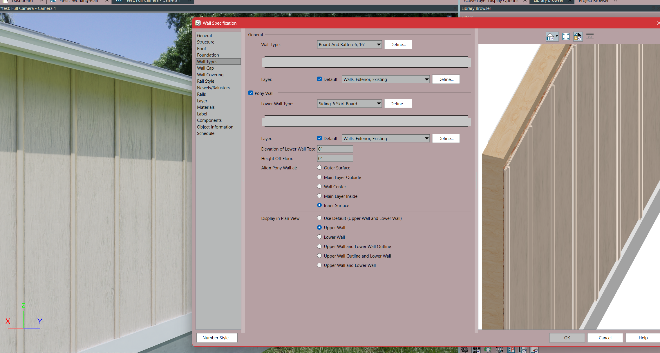

Renerabbitt Posted October 14, 2025 Share Posted October 14, 2025 For reference I no longer do it this way, I use a custom texture instead and its part of the wall. So I just draw out walls..the way it should be Link to comment Share on other sites More sharing options...
GeneDavis Posted October 14, 2025 Author Share Posted October 14, 2025 Hey, @Renerabbitt! Show us how that texture is created and used. Thanks. 1 Link to comment Share on other sites More sharing options...

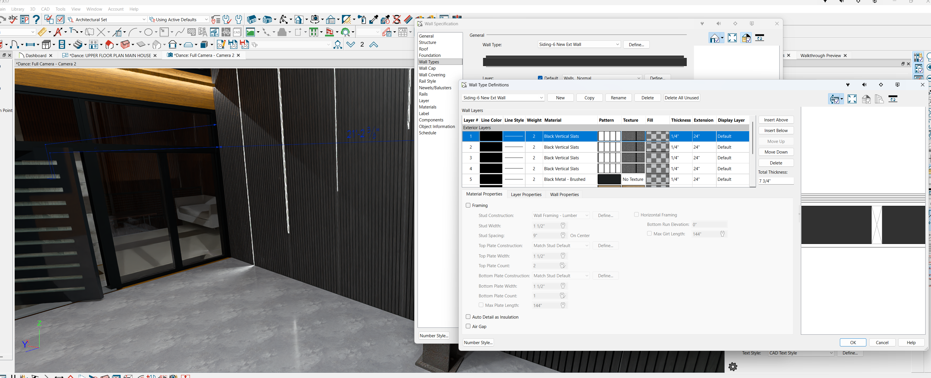

jtcapa1 Posted October 15, 2025 Share Posted October 15, 2025 Rene's NEW way is even better than Rene's old way. Just playing around with textures and multiple layers in Photoshop. Once my client saw the black wood slat textured wall, he came up with the idea to put vertical rope lighting in the grooves, which actually worked with this latest version from Rene. That is the fun black hole of pushing 3d modeling to the limit. Link to comment Share on other sites More sharing options...
