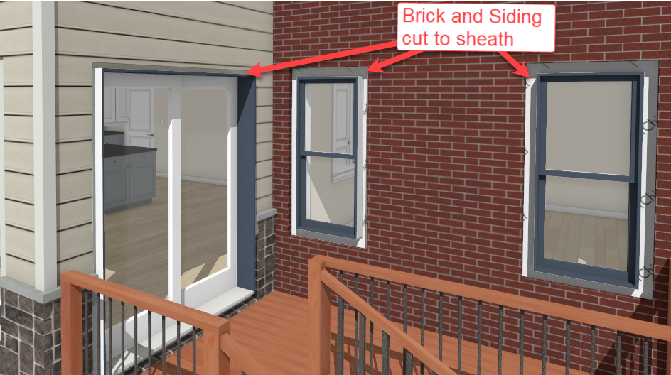

Doug_N Posted August 29, 2025 Share Posted August 29, 2025 I can't seem to get this to work properly. Addition - Copy.zip Link to comment Share on other sites More sharing options...

Doug_N Posted August 29, 2025 Author Share Posted August 29, 2025 Hi Shane, The layer is on and the window is not recessed. 1 Link to comment Share on other sites More sharing options...

DBCooper Posted August 29, 2025 Share Posted August 29, 2025 (edited) I think it has to do with your invisible deck railing that is up against the brick wall. I think Chief is treating it like a double wall which affects the wall cutout and casing. At any rate, the window will build normal when you get rid of the railing. Not sure if there is a better work around to get what you want though. Might want to send this in to Chief because it seems wonky to me. Edited August 30, 2025 by DBCooper Link to comment Share on other sites More sharing options...

JKEdmo Posted August 30, 2025 Share Posted August 30, 2025 5 hours ago, Doug_N said: I can't seem to get this to work properly. Addition - Copy.zip 4.92 MB · 5 downloads Doug, Pretty sure DBC is right. You have invisible railing walls up against the house. These are interfering with the window and door openings. Jim Link to comment Share on other sites More sharing options...
