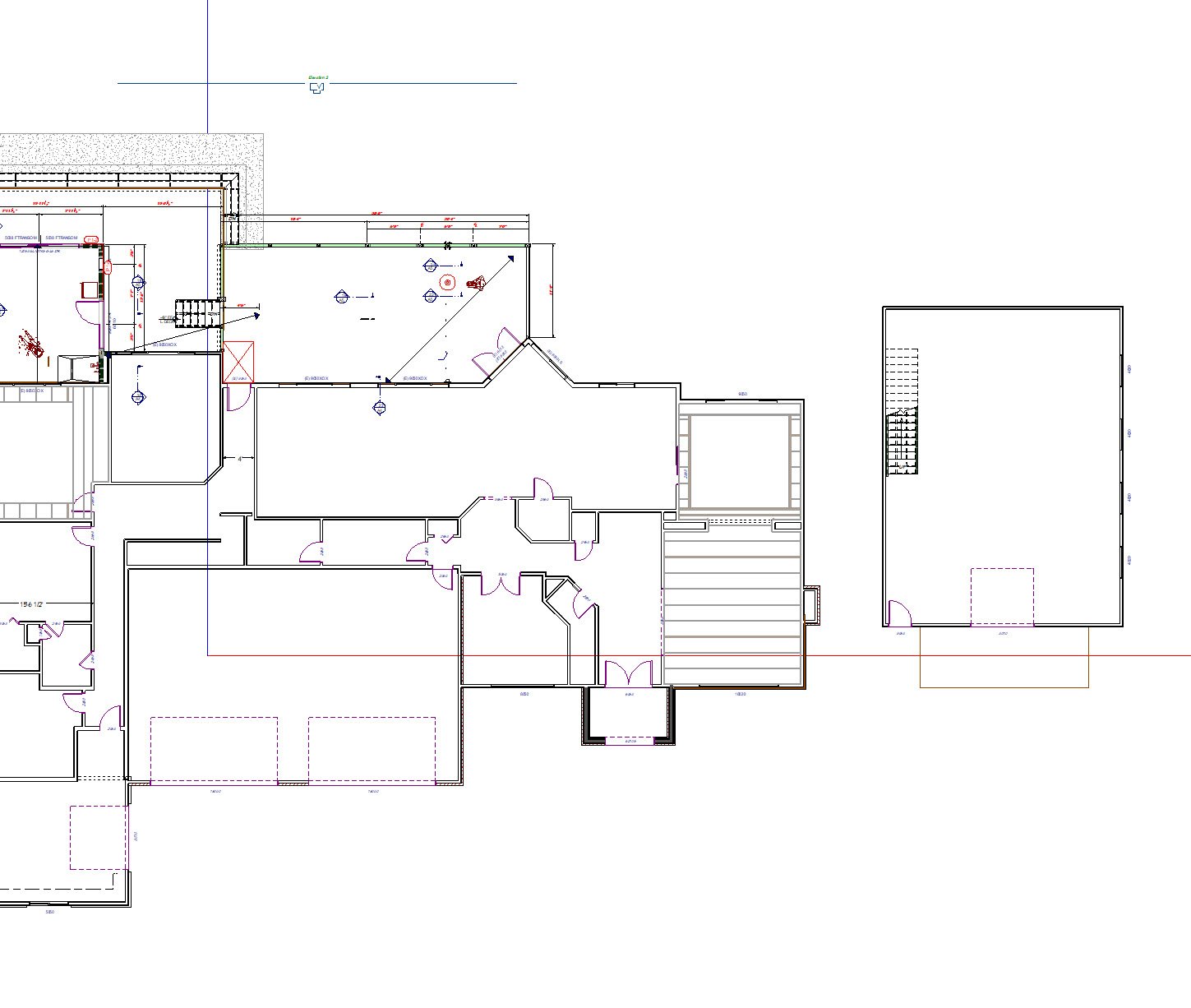

jtcapa1 Posted August 8, 2025 Share Posted August 8, 2025 I've run into this many times, as I'm sure others have, but in my haste I have not learned the best way to work on a project that has more than one building on site. In this case I've got an existing CA file from a great client who wants to build a detached shop. I love showing how the two buildings will interact, but it is a *&% bear to work with both in the same plan file. What have others here figure out in terms of working on the 3d model, getting it just right then merging it back to the main plan file? How is that best accomplished?? Link to comment Share on other sites More sharing options...
