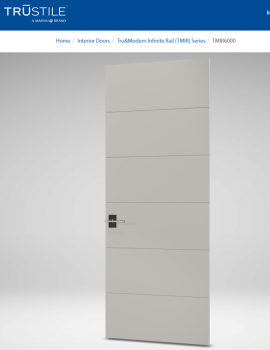

GeneDavis Posted April 4, 2025 Share Posted April 4, 2025 Try making a door from solids, slabs, countertop, whatever, saving as a door symbol. Use the TruStile visualizer for inspiration. Those little reveals are probably 1/8" x 1/8", and surely NOT on the sides. Link to comment Share on other sites More sharing options...
