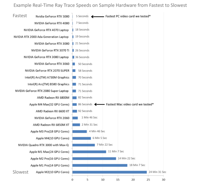

Renerabbitt Posted October 9, 2024 Share Posted October 9, 2024 2 hours ago, dshall said: A timely thread for me. I have the MacBook Pro on order. I should have it in a week. I will be interested in the speed issues... But I do need an external monitor..... - 27" min........ -4k or 54k? Does anybody have a suggestion for an external monitor???? I would really encourage you to wait another month for the new M4. m3 is still a bit underwhelming in the rendering side when compared to PC Link to comment Share on other sites More sharing options...
