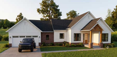

I rendered this plan in Twinmotions about year ago. The new image was rendered in Chief using my backgrounds and camera settings in this forum thread. I also added some leaves and tree shadows. I still need to work on the Backdrop images (not my background images) which I only use for window reflection, but I'm going to need to wait until Chief fixes the Spherical Panoramic Backdrop controls. At the moment, you can control the Spherical Panoramic Backdrop as a background image, but changing the settings do not show the changes in the window reflections.
Twinmotions - and brought into Photoshop and Camera Raw
Chief Architect - and brought into Photoshop and Camera Raw
  • Like 1
  • Upvote 3
Link to comment
Share on other sites
1 hour ago, ACADuser said:
Nice work Steve. Very impressive.
Thank you! It was still more than 2 hours of work with fussing with all the details and changing material properties, etc. But I would guess the more we do it the faster we get.
There is a clear difference between Twinmotion and Chief. I am hoping to try and figure that out. Twinmotion looks more like a photograph, but it too is not perfect. I guess if it was easy than everyone would be doing it. My goal of course is to find that sweet spot with the background image and camera settings to make it look more like a photo.
I would spend some time trying to make some better materials. That's always going to be a major difference. You are talking about a software that uses 1K textures vs one that utilizes 4-8K textures :)
Not to mention TM has a holw lot of other tricks up its sleaves. Bicubic/tri/planar projection re-mapping, sepearate backdrop and light sources from HDRI's, better caustics...all kinds of things
Yes, for sure on the materials. I did spend a bit of time in Twinmotions creating materials and all the maps. I need to do the same with Chief.

A few things stand out at me but I don't know if you are going for realism etc. The leaves on the ground will always look fake and throw me off...in fact anything in the foreground, if it isnt perfect..and I mean perfect, just shouldn't be there. Like the plants, I know that's part of the design, but they look so fake that I don't even notice the house. I would use some other photo to illustrate that landscaping and avoid having them in the shot.
the people will always look fake unless you use ai to replace them.
the fire look fake, and photoshop has a fire generated you could use.
the pavers need to be a better texture in my opinion, same with the stone wall.
The black point on your backdrop needs to be lowered...your blacks look like they have a white wash on them.
  • Like 1

I just spent about 25 minutes on chiefs Crowne Point Model.
generated grass to replace my grass texture. a quick grunge overlay on roof, some hand drawn elements on the stone and a bit of editing. its not perfect but it took 25 minutes from opening the file, which needed a few fixes, to editing the shot:
  • Like 1
Great window reflections. That is a big one for me that needs to be right. Like mine, they both have a long way to go for Chief to look amazing.
