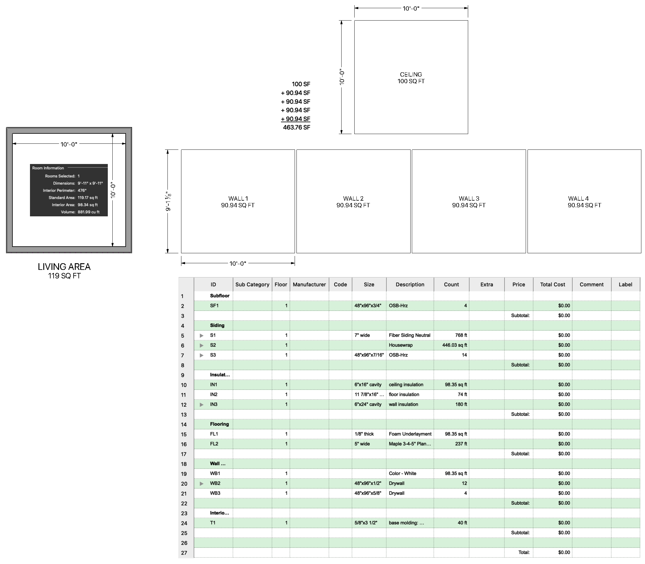

GeneDavis Posted September 29 Share Posted September 29 When I began building I was lucky to have a drywall supplier that worked up the sheet counts by on-site measuring. He chalked the counts onto each room's door frame, and the house got loaded, room by room, with the rock. Ceiling boards on floor, wall boards against walls. Chief's calcs fail to subtract the thickness of the ceiling rock and the 1/2" pry-up the lower course gets off the floor. Just subtracting that would help to get the counts more realistic for the 1/2" boards. But if you've specified 12-foot boards for a 10 x 10 room, you're gonna have to live with that small pile of two-foot offcuts. Unless you've some 13 and 14 foot walls, they're going in the dumpster. Link to comment Share on other sites More sharing options...

Michael_Gia Posted October 1 Author Share Posted October 1 7 hours ago, builtright3 said: Im sure you can customize it but It always seems to time consuming and I can do take off faster with a pencil and calculator. Cumbersome as it is just give your materials easily recognizable names. Set up your template or your latest plan that you want to use for a save as method, with materials that are easy to pick out from a material list. Ensure that your wall definitions, floor and ceiling structure have those materials that you’ve customize the names for. to double check I use the perspective floor overview and run around with the rainbow tool to make sure all the materials are what I expect them to be, and that they are set to “area” in the material list tab. then what I do is just export a comprehensive material list to excel where I sort the table by the material name. One list to rule them all. I also use the “generate report” feature and enter a price of $1 to get the total for a specific material. Both work. I have to thank @robdyck for these tips and techniques. Link to comment Share on other sites More sharing options...

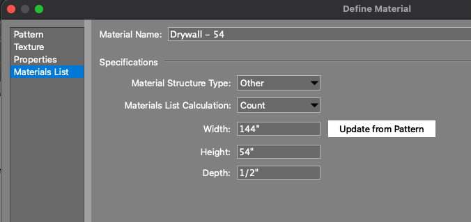

Chrisb222 Posted October 1 Share Posted October 1 7 hours ago, builtright3 said: Im sure you can customize it but It always seems to time consuming It's not that bad. Copy the drywall material for as many different boards as you use and give them a name that makes sense. I specify 5/8" 4x12 boards for ceilings, so all my rooms have "Drywall - 5/8" as their ceiling finish. I made 3 board styles, 1/2" 48"x12', 1/2" 54"x12', and 5/8" 48"x12', then assigned them to their respective wall definitions and ceiling defaults. In the Define Material, set the Calculation up as Count and put in the correct dimensions: In my experience it gets the count real close, and it's easy to see in the Material List which boards are being counted. Add for waste and you should be good. Link to comment Share on other sites More sharing options...
