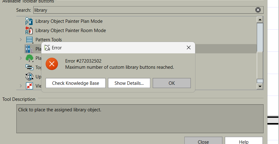

Steve_Matlaga Posted October 14 Share Posted October 14 Hi, X17 user. I'm part of a small team that services accounts for designers/dealers across the USA. I've spend years working with Chief and as I've come along the way, I've embraced custom tool sets as my go to. WELL, in 2026, to find out that the CHIEF DEV team implements a lame limit on custom Icons is INSANE bordering time to rethink Chief. Buttons are the biggest time saver in Chief for me!!!! To think I'm limited to some arbitrary number (not very high either) of custom 'Place Library Object' buttons really ticks me off. PLEASE tell me, this clever Dev team has lifted such a silly limit hard coded in the x18 version? We don't want to switch to x18 until bug reports are done and more positive feed back is seen. If THIS SINGLE limit has been addressed, we'll update today! AND YES,, I have tried to copy a tool set , delete most all of the tool bars, in hopes it would free space for another set of Place Library item icons. NOPE. No go. CHIEF!!!! WHAT ARE YOU DOING? No inherent way to copy tool bars from one set to another. Now I find out that an advance high end super cad package has a limit on something stupid like an icon that simply references a file item in my library? Don't you think this deserves major attention as it's one of the top features being able to customize the GUI to our needs? Tell me I'm missing the obvious so I can delete this post and share the solution with others! I'm just beside myself upset right now. It's like a major punch in the gut when I finally felt somewhat of a confidence level with Chief. Link to comment Share on other sites More sharing options...

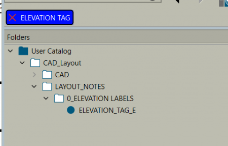

Renerabbitt Posted October 15 Share Posted October 15 The cap is 400. Quite a lot. Possible that you may be overlooking some old custom objects buried in an unused toolbar config? 1 Link to comment Share on other sites More sharing options...

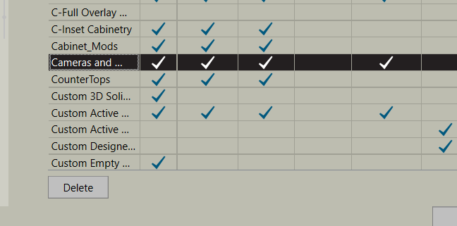

Steve_Matlaga Posted October 15 Author Share Posted October 15 2 hours ago, Renerabbitt said: The cap is 400. Quite a lot. Possible that you may be overlooking some old custom objects buried in an unused toolbar config? It's very unlikely I have 400 custom library objects. However, if you start really utilize custom tool bars , 400 is not near as many as it sounds. You could have around, what? 40-50 per bar line across a 2k screen That's only 10 rows of full custom bars max, across ALL your potential custom TOOL SETS. IT's not 400 per set. It's a cap across the entire software structure. This needs to be addressed by Dev team IMHO. I'm really stuck at this point though. Now that I am slammed, I needed far more ease of access custom library buttons. I really dislike tags/folders and menu diving. Mainly, it's a screen limitation and my eyes aren't what they were. The custom assignable icon system to library objects really is a god save. The LIbrary Browser is very old school and time consuming. Icon tool bar groups create a reflex response to exactly what is where. You'll memorize the aprox location of 400 items in no time if you are doing this daily. Menu diving, time consuming! Even with tags, you are turning tags off and on over and over to make find something easier. That's just not efficient. Just that one row of commonly used 'tags' as I call them, with Rich Text or even plain text icons saves me countless hours over the course of a week/month! At this point, my system is more or less LOCKED and I'm stuck with what i have. I deleted bars, and still won't let me add anything. Boooo. Oh, also to note. That 400 cap? It's WAY too low if you consider that is TOTAL CAP. Meaning, if you have just a few tool bar sets, YOU ARE DONE and at the limit. 400 PER set? YES. 400 TOTAL system wide? Please explain how that is a good thing? I work with four cabinet lines, and each has it's own set of object icons. If I want 10 or 100 lines, that seems like an obvious ask for something like a high end design cadd program. (even if generic, one for inset, one for full overlay framed, one for full overlay frameless) GUI really should be the top priority of the user experience. You of all people know how valuable that single aspect of chief is! Link to comment Share on other sites More sharing options...

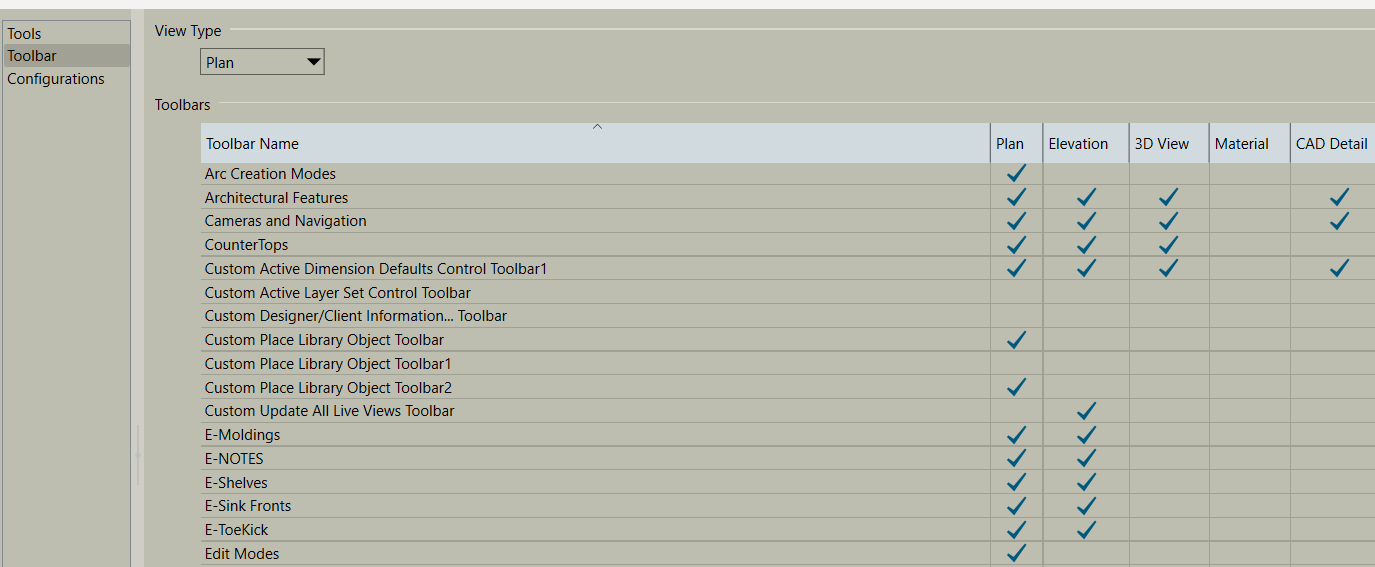

CarrieS Posted October 15 Share Posted October 15 Perhaps when you are "deleting" the tools you're not actually deleting them but just hiding them in some way? It is pretty rare for users to reach the cap even before we increased it's cap in X15 to 398. For example if you have the Customize Toolbars dialog closed and you pull off the toolbar and X to close it out, it is not deleting the toolbar only turning it off. You have to have the Customize Toolbars dialog open to delete a tool from a toolbar. If you are reaching the limit and need more it is best to contact our Support team or write in to Suggestions@chiefarchitect.com so we can track the feature request. 1 Link to comment Share on other sites More sharing options...
Renerabbitt Posted October 15 Share Posted October 15 1 hour ago, Steve_Matlaga said: This needs to be addressed by Dev team IMHO 1 hour ago, CarrieS said: 398 I was told that we are never going to get more than this amount as it hits a new set of criteria in the coding that is challenging to circumvent 1 hour ago, Steve_Matlaga said: (even if generic, one for inset, one for full overlay framed, one for full overlay frameless) I would change your approach. Instead of storing an object for every object type, create style pallets that can be combined to build those cabinets, and build your labels to match the object nomenclature based on the face configuration as well as the supplier field. Its very inefficient to store cabinets as opposed to face configurations that can build cabinets on the fly in a few clicks or swipes. 1 hour ago, Steve_Matlaga said: I deleted bars, and still won't let me add anything You must have more objects in some other toolbar configs that have populated library objects. This is why i prefer to code my toolbars outside of the program. 1 Link to comment Share on other sites More sharing options...
Steve_Matlaga Posted October 16 Author Share Posted October 16 19 hours ago, Renerabbitt said: I was told that we are never going to get more than this amount as it hits a new set of criteria in the coding that is challenging to circumvent I would change your approach. Instead of storing an object for every object type, create style pallets that can be combined to build those cabinets, and build your labels to match the object nomenclature based on the face configuration as well as the supplier field. Its very inefficient to store cabinets as opposed to face configurations that can build cabinets on the fly in a few clicks or swipes. You must have more objects in some other toolbar configs that have populated library objects. This is why i prefer to code my toolbars outside of the program. Not that I can find. And, yes, working on Stream Deck icon set perhaps, and figuring a simple way to replace Chief's Icon system limits using the unlimited resources of stream deck. I need to explore 'best methods' first, but the answer has been sitting on my desk the whole time. LOL. Simpler alternative will just be a custom API that has unlimited icons and put that on a separate screen. I've actually been doing a few things for several versions. I store a cabinet set of boxes into a single library set. Drop them on the project, and set them as default. However, as I've been experiencing much larger projects with up to 30 rooms, each project need two or three cabinet lines and overlays. Much easier to switch my tool bar set that references style pallet cabinet configs. Hence, the custom library count goes up fast. I realize everyone looks at a GUI differently. THat is the beauty of Chief. We get to config our GUI exactly as we want. We can mimic our thinking/logic and set up tools/library objects any way we wish. Putting a cap on that really doesn't make sense on a global scale. Putting a cap on it PER tool bar set, makes lots of since. Yes, I and my associate will call Chief next week to discuss. In the meanwhile, I feel that looking for a solution outside of chief will be more productive as I can take immediate action on creating that/those tools. I will freely share such to assure others can enjoy the results. I can see it being a game changer to create endless toolsets where the induvial groupings and be shared easily between those custom sets. Also, will free up the main screen for larger drawing area, and only key tools being on hand. Link to comment Share on other sites More sharing options...
Steve_Matlaga Posted October 16 Author Share Posted October 16 (edited) 21 hours ago, CarrieS said: Perhaps when you are "deleting" the tools you're not actually deleting them but just hiding them in some way? It is pretty rare for users to reach the cap even before we increased it's cap in X15 to 398. For example if you have the Customize Toolbars dialog closed and you pull off the toolbar and X to close it out, it is not deleting the toolbar only turning it off. You have to have the Customize Toolbars dialog open to delete a tool from a toolbar. If you are reaching the limit and need more it is best to contact our Support team or write in to Suggestions@chiefarchitect.com so we can track the feature request. I deleted them in the actual tool set tools. To help others, please understand how the limit works. 398 icon custom library objects is the TOTAL max across ALL tool sets. In my case, I created all tool sets in the Masterset. No matter what, once I hit the limit, there's no way around that. I could have 50 Toolbar configurations, but it's all limited by the same program wide max! Let's say you are in a toolbar set called 'Tags Only' If you make a new custom placement object tool bar, and populate that with 30 icons of library objects, that is part of your total 398. Even though, that toolbar is only in that config set, it still counts against the global total. This means, you are pretty limited in the number of actual 'custom' sets of tools you can build across all custom configurations. I'm hoping to build something simple, like a screen of icons separate from Chief, that simply fill out the item name in library browser, and click so it's ready to drop on the plan. That replaces all limites. We'll see if that is even possible. Worse case, I rethink what is really important to have on hand. The most time consuming thing to be has been adding text markups to my drawings. Hence, why I'm talking about this to start with. Think about how much time is saved by a click of a mouse, vs editing your text each time!!! Think how much time is saved by those text items being RIGHT THere vs digging into folders and/or tags. Using tags require many mouse clicks to get to the actual sub menu of tagged items. EXAMPLE: Vs ONE click when they are always RIGHT on top in a tool bar. HINT: If you have UNUSED place holders for future library objects in various tool configs, those are counting against that 398 even though they aren't linked yet. As I'm sure I'm not the first to hit the frustrating limits... I'm going to share what I can while I'm digging into this subject. GO THROUGH ALL YOU TOOBAR CONFIGS and remove/delete ALL unused Library Object icons! A counter would be helpful so we know how many we have left! The above really was the main issue for me. I think I'm back to around 100 or more free spaces now. Appreciate the feedback as it led me to dig more. COME ON CHIEF!!! Let's get creative! Edited October 16 by Steve_Matlaga Link to comment Share on other sites More sharing options...

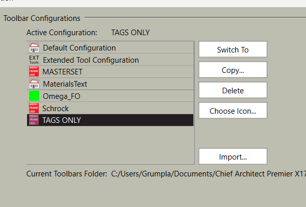

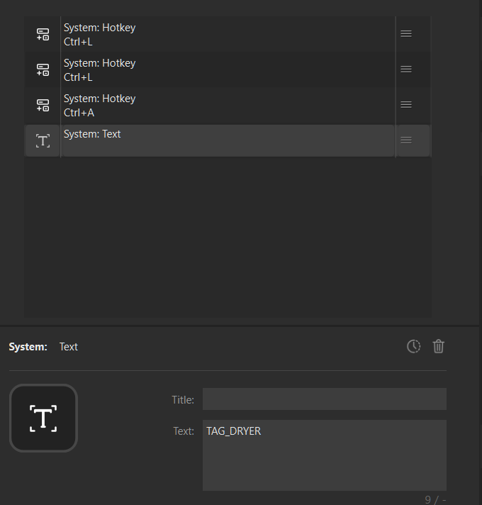

Steve_Matlaga Posted October 16 Author Share Posted October 16 SOLVED Well, I ended that issue fast! In fact, mind blown. The solution outside of Chief is amazing, unlimited, and cheap/free. My complaining turned into turn my Chief experience into a true modern GUI that has complete freedom to do exactly what I want. It's not hidden behind a pay wall or such. For now, I'm going to just tell you, you can use hot keys, and direct any third party software to produce key strokes that will direct chief to place a custom library object. I think half a day of work, I can recreate all the existing chief tool bars, my own tool bars, and shut off all chief tool bars to gain a full screen for design work. I'm getting far more than I hoped all over finding a silly limit by the devs. This might not make sense yet, but a preview is the transparent menu right on my chief screen ready to go to work! Hover over it, to simply click and place whatever you like. In my case, it's all able labeling my floor plans quickly. However, these tool bars can literally be anything and most everything you already use in Chief, including the same icons. It's going to take work, but in the end, I have a tool that does anything I need the way I want it to work. 1 1 Link to comment Share on other sites More sharing options...
Renerabbitt Posted October 16 Share Posted October 16 4 hours ago, Steve_Matlaga said: set called 'Tags Only' Just curious, what is your tags toolbar all about? Link to comment Share on other sites More sharing options...

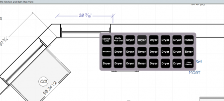

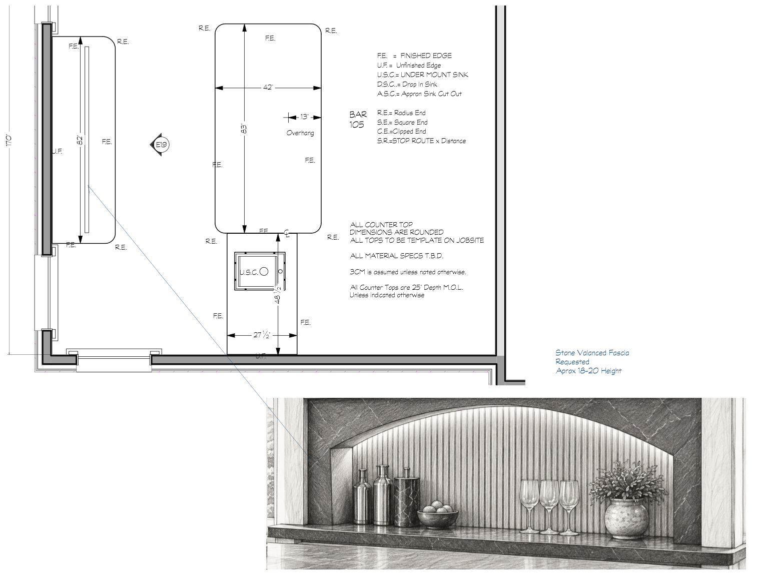

Steve_Matlaga Posted October 16 Author Share Posted October 16 (edited) 9 minutes ago, Renerabbitt said: Just curious, what is your tags toolbar all about? They are simply labels/call outs I use for my floor plans. If I have a base 36, with roll outs, I want a clean text note 'Roll outs'. I don't use cabinet labels, just call out numbers. So, I need to clearly label appliances, points of interest, and other such floor plan/elevation notes. Say, I'm making counter top drawings. I drop the text where I need it. Takes seconds.; I use a lot of rich text, or standard text saved as a library object to save me countless time. Commonly used Keys, Notes etc. In fact, I pretty much try to make all commonly used actions a click ! Can't imagine digging through Chief's browser folders or using this 'tag' system they came up with (or maybe you came up with, lol) Edited October 16 by Steve_Matlaga Link to comment Share on other sites More sharing options...

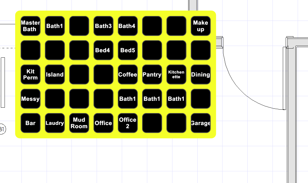

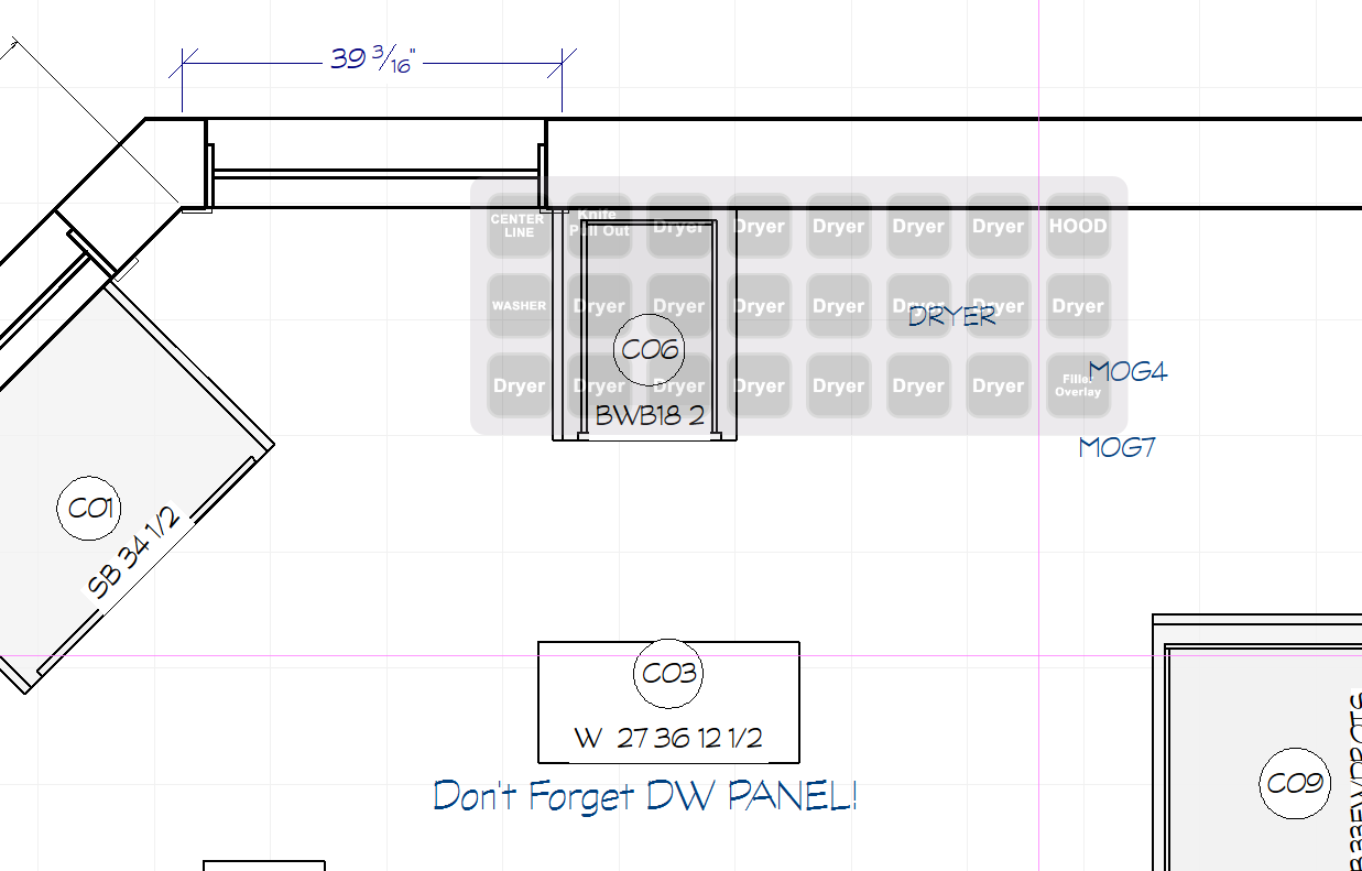

Steve_Matlaga Posted October 19 Author Share Posted October 19 Sample : Change Item to a Different Room for Schedule Organizing. All Button menus will be on a separate screen just under the main screen Again, for anyone interested, I'm using Virtual Scream Deck, but you can use this on Ipad, Android, Mac, Windows... Or get a Stream Deck! Many other apps are out there to do this, and I still believe this is by far the most useful way to work in Chief. It runs completely separate from Chief and has nearly zero affect on the speed your system runs with infinite buttons. Link to comment Share on other sites More sharing options...
Renerabbitt Posted October 19 Share Posted October 19 5 hours ago, Steve_Matlaga said: Virtual Scream Deck FYI i think radial menus are far more efficient than buttons as when you swipe past the bounds of the slice it triggers the button, and the radial menu appears wherever your mouse is. Its far easier to have muscle memory of the swipe be remembered vs the location of a button and the precision it requires to hit the button. Regarding your setup. for different cabinet lines it can just be a conditional statement switch. For example a condition where if supplier is crystal cabinets then print option 3, where acessories is option 1; option 2; option 3 Then you make a style palette tool that only applies "supplier" so that you can quickly change your supplier, and so on and so forth Link to comment Share on other sites More sharing options...
