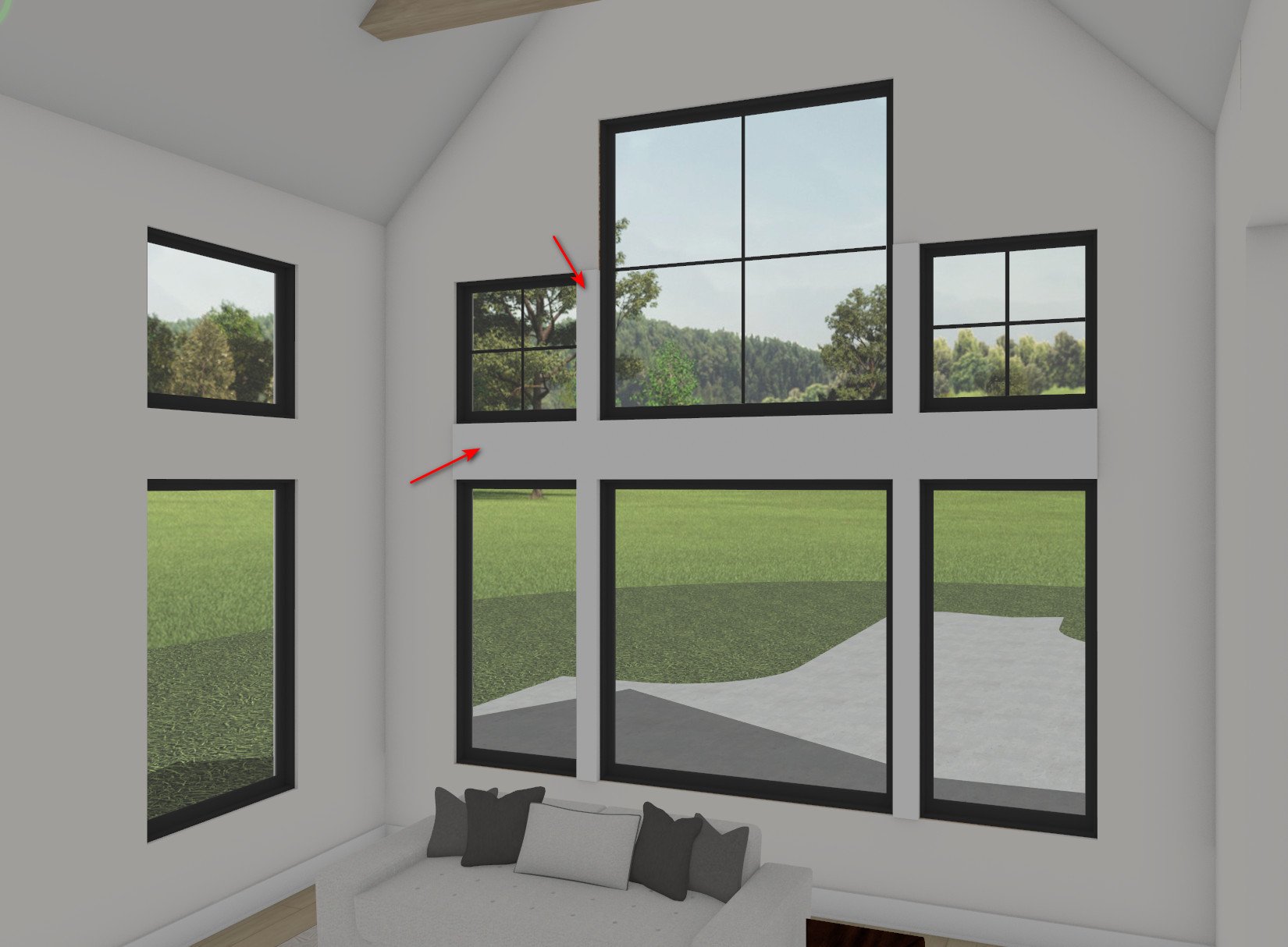

Steve_Nyhof Posted yesterday at 12:09 AM Share Posted yesterday at 12:09 AM I am not sure why this has not been an issue before, but I do not want any casing on my mulled windows on the Interior. Is there a way to turn the mulled casing off? Link to comment Share on other sites More sharing options...

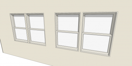

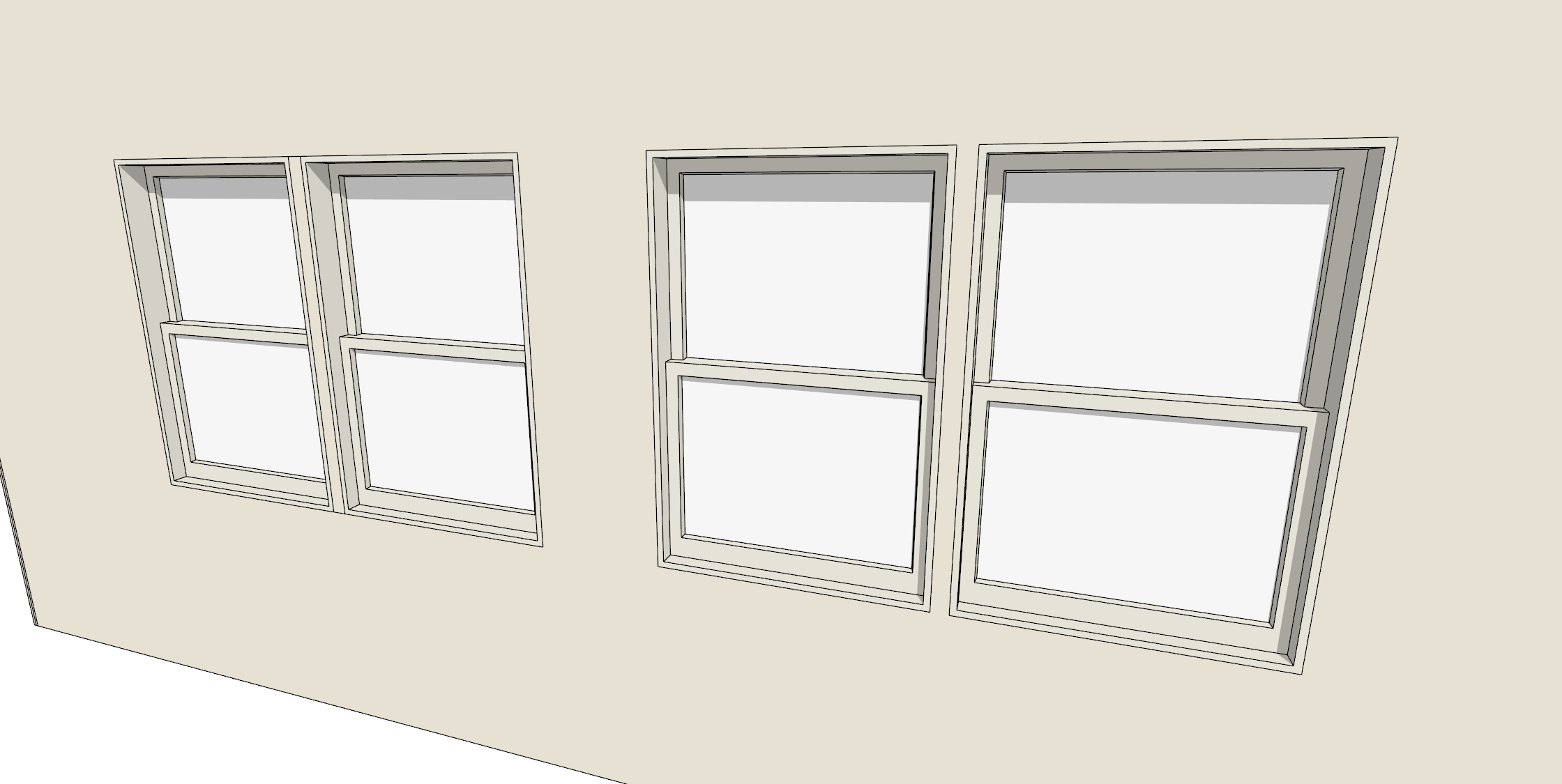

DBCooper Posted 23 hours ago Share Posted 23 hours ago There are a couple of things you might want to try. First, you can unblock them (like Alan suggested). Second, if you really want to keep them blocked, you can make the "inside mullion depth" 0 which will make the trim flush with the wall and then set the interior trim material to the same material as the wall. This should look pretty good but you might get an extra line in vector views. In the picture below, the windows on the right are just two windows and the ones on the left using the technique I am suggesting. Link to comment Share on other sites More sharing options...
Joe_Carrick Posted 18 hours ago Share Posted 18 hours ago 11 hours ago, Steve_Nyhof said: I am not sure why this has not been an issue before, but I do not want any casing on my mulled windows on the Interior. Is there a way to turn the mulled casing off? Hi Steve, "Mulled Windows" should only be used if they are going to be provided by the manufacturer as a single object to be installed in one rough opening. What you show in your pic would be six single windows (aligned but not mulled) Link to comment Share on other sites More sharing options...
