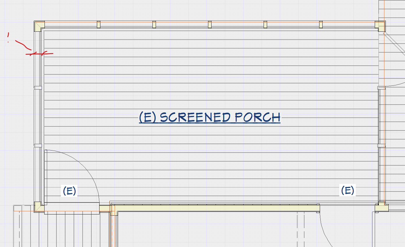

JKEdmo Posted August 18 Share Posted August 18 Is it possible to have a deck room's planking stop at the inside of a wall instead of running to the exterior of the wall / floor platform (e.g. w/ a deck offset value)? I have an existing enclosed screened porch and I thought I'd tried to show the flooring with true deck boards. I know deck rooms are supposed to be exterior, but was wondering if this can be finessed as a deck room type w/o resorting to manually adjusting deck board widths, etc. Thanks again, Jim Link to comment Share on other sites More sharing options...

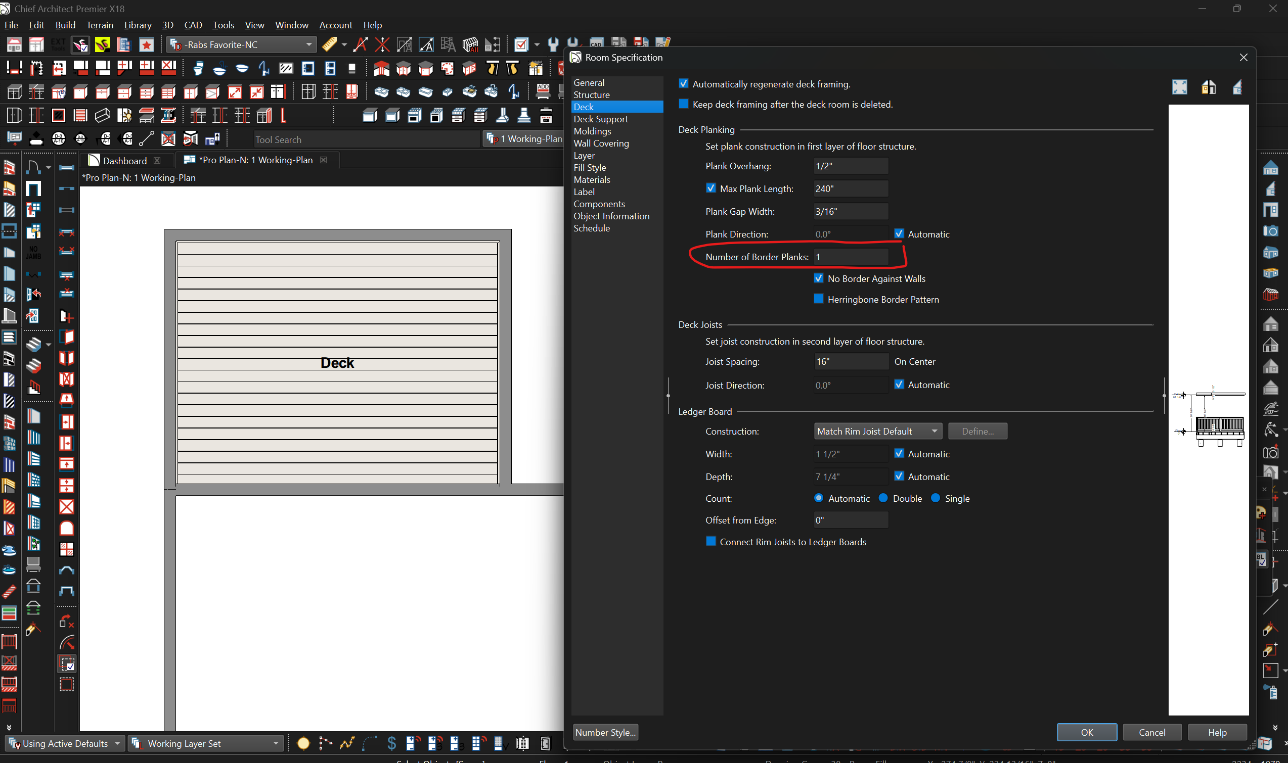

Garybills Posted August 19 Share Posted August 19 8 hours ago, JKEdmo said: Is it possible to have a deck room's planking stop at the inside of a wall instead of running to the exterior of the wall / floor platform (e.g. w/ a deck offset value)? I have an existing enclosed screened porch and I thought I'd tried to show the flooring with true deck boards. I know deck rooms are supposed to be exterior, but was wondering if this can be finessed as a deck room type w/o resorting to manually adjusting deck board widths, etc. Thanks again, Jim, you could try border planks that will stop the planks. This is X18 btw. Link to comment Share on other sites More sharing options...
JKEdmo Posted August 19 Author Share Posted August 19 14 hours ago, Garybills said: Hi Gary, Thanks for looking at this. Seemed promising, but it still generated a border plank within the walls. Jim Link to comment Share on other sites More sharing options...

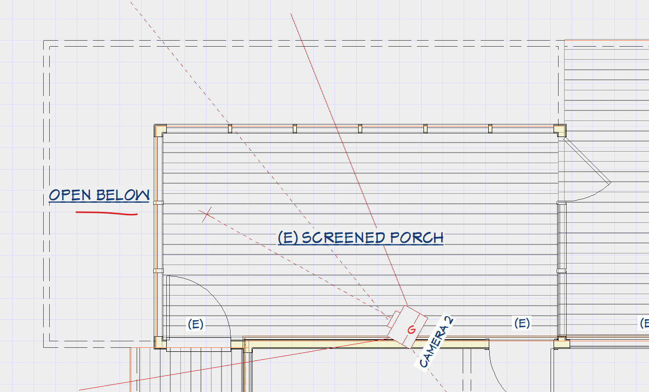

JKEdmo Posted August 19 Author Share Posted August 19 Well, I think I figured out a workaround. Not sure if this will lead to issues down the road... A Deck Room is an exterior type room and I believe I read somewhere it is designed to generate deck boards to the exterior edge of the deck walls that are not adjacent to interior rooms. So, I created an adjacent Open Below room next to the Deck room to get rid of the exterior space and it seems to work. The interior deck boards now stop at interior wall surface. Link to comment Share on other sites More sharing options...
