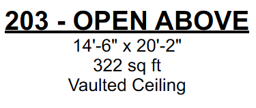

Joe_Carrick Posted August 10 Share Posted August 10 (edited) 1 hour ago, Renerabbitt said: I think your suggestion should just be allow rich text in room labels which we've been hammering for years. Because you could just write conditions for room type and accomplish the same thing and would be less work than going through every room type to produce a unique label. Also I will mention it again, I am perfectly happy to login to your machine and show you exactly how I have this done using a custom font and how simple it is once you have it setup. Its a helper manual that remaps anything you want to another part of a font family. And I can do this for any font you want in a matter of minutes. So while we are holding your breath for RT in room labels you can have the perfect system without all of this manual work that you are doing with your labels. If you are at the raining in idaho I'd be happy to set this up for you Unfortunately for me, going to the UGM in Idaho is just to much money. My RTB room labels use Arial Normal but with Bold, Underline & sometimes Italic. Here are a few examples: All of this information is presented by custom macros. I don't currently use a check for "room type" but I do check some NVPs. Are you really able to do this with the current room labels. Edited August 10 by Joe_Carrick Link to comment Share on other sites More sharing options...
