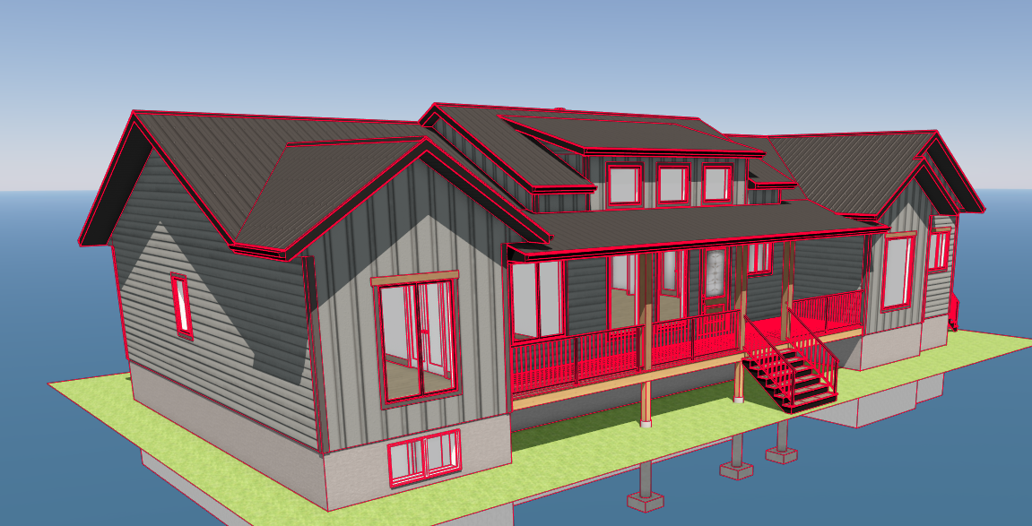

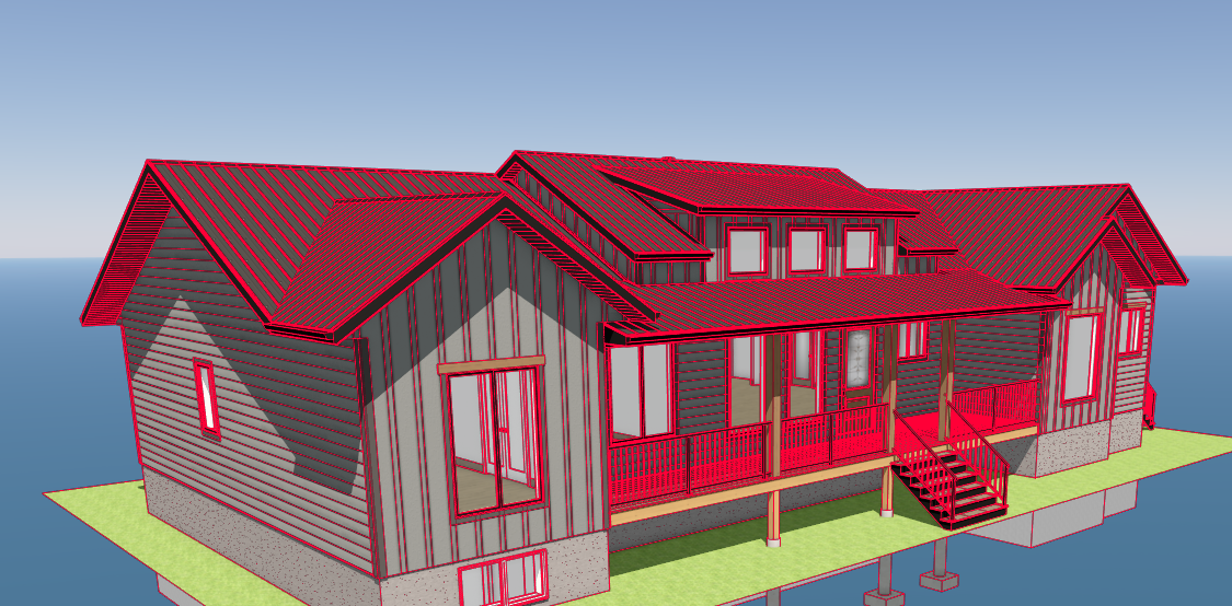

robdyck Posted August 8 Share Posted August 8 (edited) As Gene mentioned, the toggle patterns tool only works in a vector view. For all other rendering techniques you can turn the layer "Patterns, 3D Views" on or off as needed. ON: OFF: Edited August 8 by robdyck Link to comment Share on other sites More sharing options...
