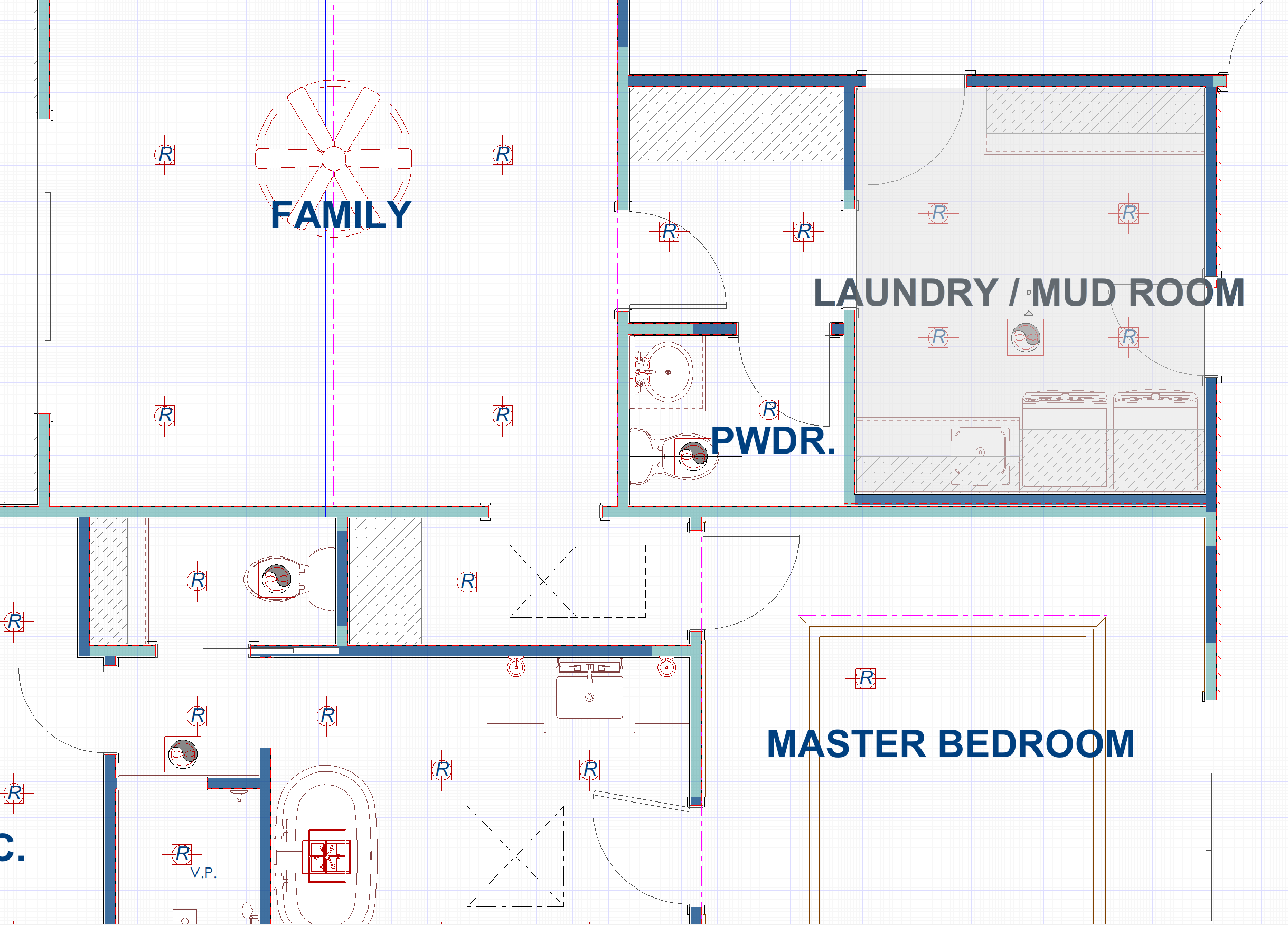

cjanderson66 Posted Friday at 10:37 PM Share Posted Friday at 10:37 PM (edited) Okay so I just got the new Beta installed and the first thing I notice is the room labels. In previous editions you would pick on the room and the room label would have a surrounding box that I could modify the label so it could be adjusted in the room. Now you pick on the room and you can barely see the pick box to move it and there is no way to modify the size any longer. What was the point of this change and is there a way to modify the room label? Edited Friday at 10:58 PM by cjanderson66 needed an attachment Link to comment Share on other sites More sharing options...

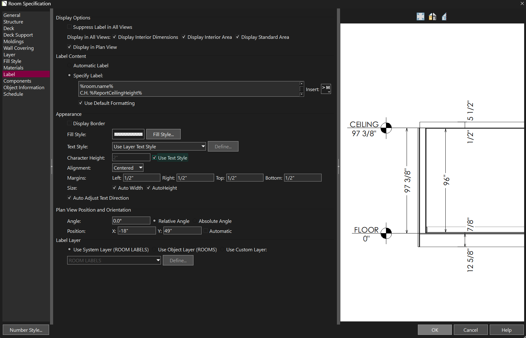

MollyNDG Posted Friday at 11:12 PM Share Posted Friday at 11:12 PM I'm not sure about the selection issue you are seeing, I am not able to replicate it. You modify the size within the Room specification dialogue, under the Label tab. The size is determined by the text style used, which is found under the Appearance section. You can set it to use the layer text style or you can uncheck that and type in a specific text size. Link to comment Share on other sites More sharing options...

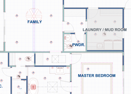

Renerabbitt Posted Friday at 11:17 PM Share Posted Friday at 11:17 PM 38 minutes ago, cjanderson66 said: What was the point of this change and is there a way to modify the room label? SO many many many things are better with the new room labels. its just a learning curve. like molly said just get into the label settings. My room labels now automatically resize and abbreviate and auto plaec themselves in the room and its frickin awesome Link to comment Share on other sites More sharing options...
cjanderson66 Posted Friday at 11:32 PM Author Share Posted Friday at 11:32 PM 13 minutes ago, Renerabbitt said: SO many many many things are better with the new room labels. its just a learning curve. like molly said just get into the label settings. My room labels now automatically resize and abbreviate and auto plaec themselves in the room and its frickin awesome Rene, How in the world did you get it to automatically resize and abbreviate. If you look at my screenshot, my Laundry / Mud room label is to long to fit in the room. I have checked and unchecked all the boxes in the Appearance section and it still does not let me resize the text. Link to comment Share on other sites More sharing options...
Renerabbitt Posted Saturday at 12:04 AM Share Posted Saturday at 12:04 AM 31 minutes ago, cjanderson66 said: Rene, How in the world did you get it to automatically resize and abbreviate. If you look at my screenshot, my Laundry / Mud room label is to long to fit in the room. I have checked and unchecked all the boxes in the Appearance section and it still does not let me resize the text. see video 260710 (2).mp4 1 Link to comment Share on other sites More sharing options...

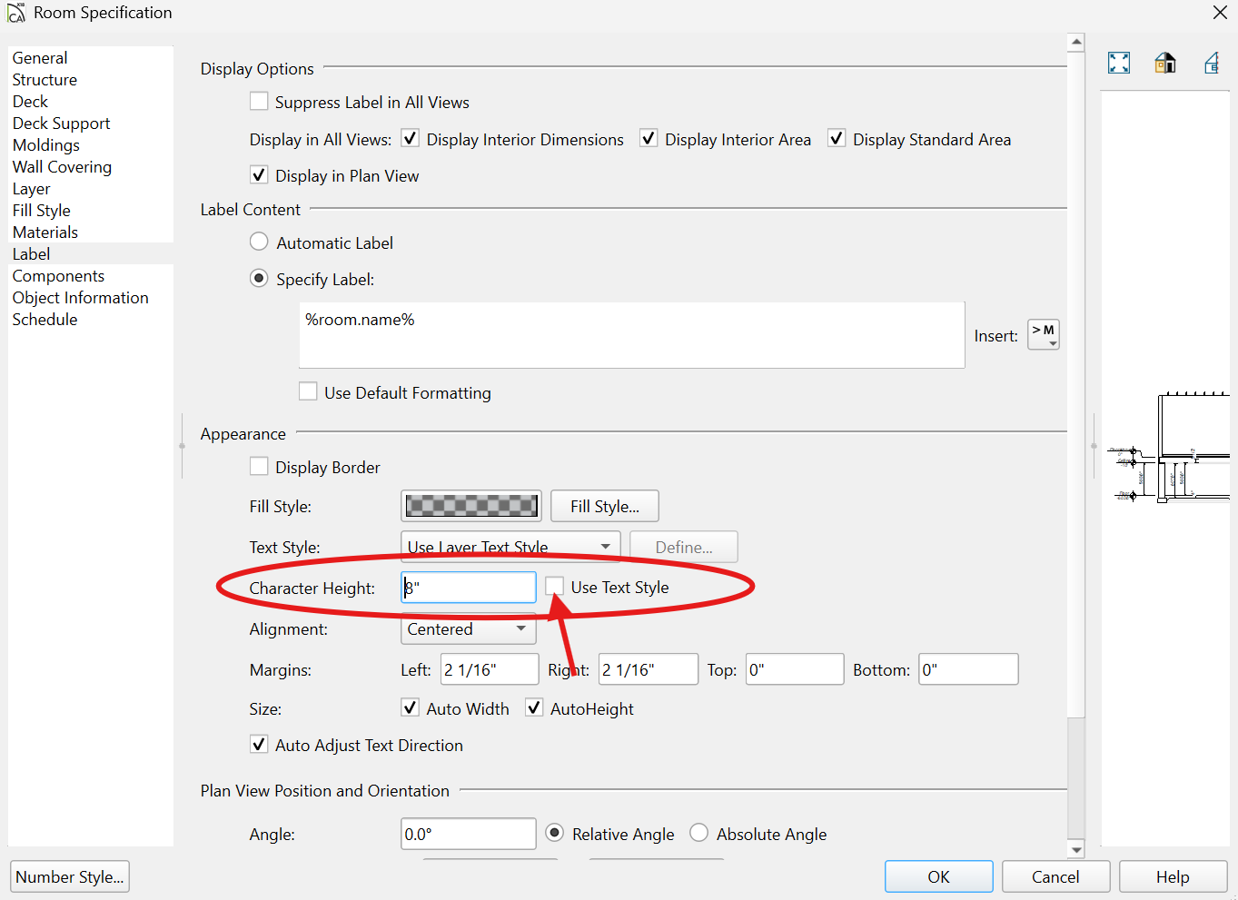

DBCooper Posted Saturday at 02:25 AM Share Posted Saturday at 02:25 AM OK, lot's of changes in X18 and most of them are for the better because they made room labels work like all of the other labels and added a bunch of new tools that mostly work for all labels now. As Molly said, you can resize any label by choosing a new text style for that label in the dialog. If you want to resize a room label like you could in X17 and before, all you need to do is first select the room and then you need to click on the "edit label" button. Then if you hold down the "x" key, it will automatically resize the label when you drag a corner handled just like it did in before. You can also do this in the dialog by first turning off "use text style" and then setting the "character height" to whatever you want it to be. 1 1 Link to comment Share on other sites More sharing options...

KilianDrafting Posted Saturday at 12:38 PM Share Posted Saturday at 12:38 PM (edited) 13 hours ago, cjanderson66 said: in the Appearance section and it still does not let me resize the text. Like DBCooper said, if you uncheck "Use Text Style" under the Appearance section then you can change the text height of the individual room label. Edited Saturday at 12:40 PM by KilianDrafting 1 Link to comment Share on other sites More sharing options...

cjanderson66 Posted Monday at 04:22 PM Author Share Posted Monday at 04:22 PM On 7/10/2026 at 8:25 PM, DBCooper said: OK, lot's of changes in X18 and most of them are for the better because they made room labels work like all of the other labels and added a bunch of new tools that mostly work for all labels now. As Molly said, you can resize any label by choosing a new text style for that label in the dialog. If you want to resize a room label like you could in X17 and before, all you need to do is first select the room and then you need to click on the "edit label" button. Then if you hold down the "x" key, it will automatically resize the label when you drag a corner handled just like it did in before. You can also do this in the dialog by first turning off "use text style" and then setting the "character height" to whatever you want it to be. That resolved the issue. I never even noticed the edit label button at the bottom. That is huge. Thx. DB 1 Link to comment Share on other sites More sharing options...
