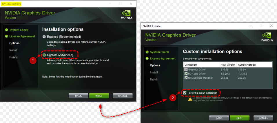

CarrieS Posted July 16 Author Share Posted July 16 @joselyn_renWhen you install the the driver I recommend using the "Custom (Advanced)" option and choose the option for Clean Install. Sometimes remnants from previous drivers can interact and still cause crashing. Technical Support has had consistent success with this approach. Feel free to contact Support if you'd like help with the process. Link to comment Share on other sites More sharing options...
