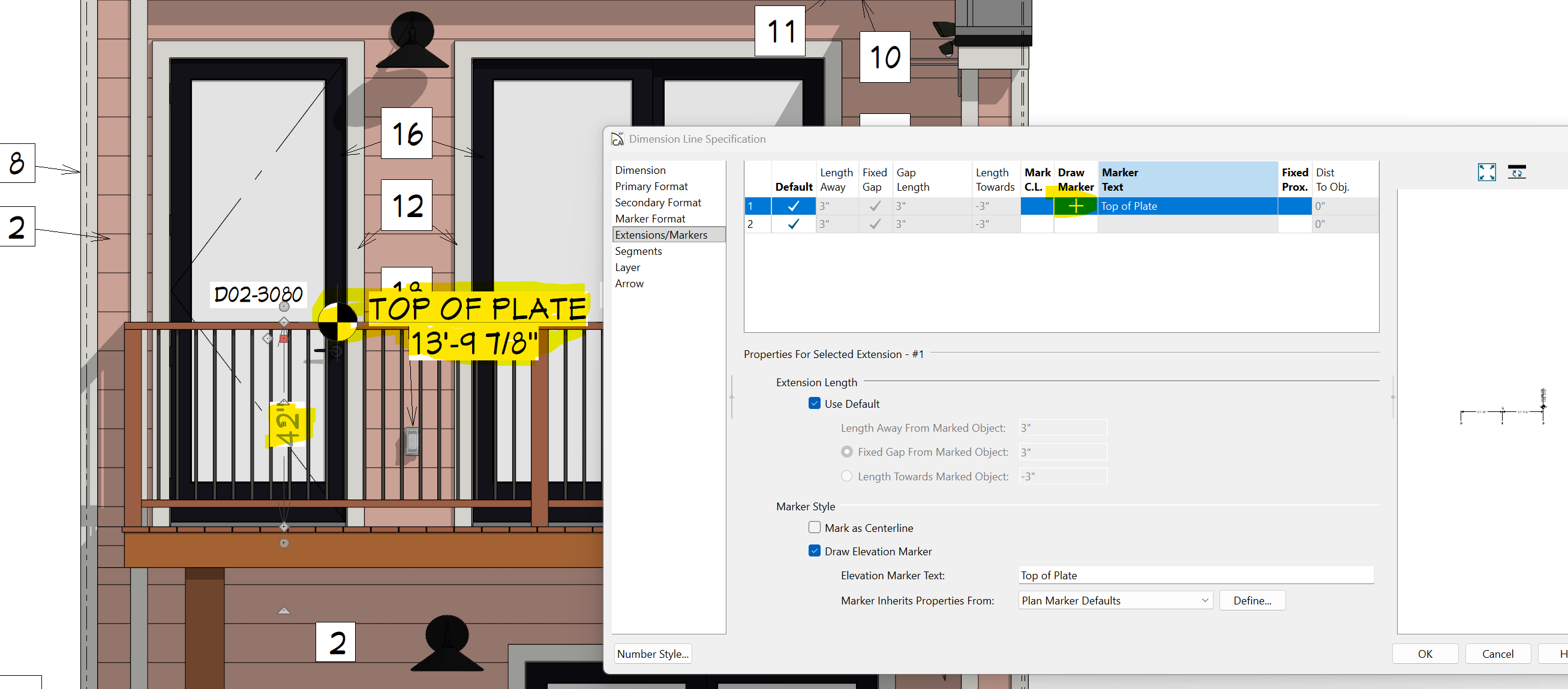

robdyck Posted May 31 Share Posted May 31 On 5/29/2026 at 9:45 PM, mtldesigns said: I am curious on why a railing height dimension changes when moved off the railing, A simple clue as to what Chief is locating can be found by going to the Extensions / Markers tab and checking 'Draw Marker'. You'll see that Chief is locating the top of plate. Because it's an auto-locate, it jumps to a different top of plate locate when the dimension is moved. The 'Why' I can't answer...just the 'what'. You should also notice that once that dimension is moved away from the wall, it is probably next to impossible (if not entirely) to locate the top of the railing. A point marker is needed. 1 Link to comment Share on other sites More sharing options...
mtldesigns Posted May 31 Author Share Posted May 31 (edited) @PitMan71 @Joe_Carrick You guys are right. I did change this to 42" after I sent this post. Even though IRC says 36", this is a vacation rental in Mexico Beach, I'd hate it if some person, a kid especially, got to excited and fell over. @robdyck I see what you mean.. don't like Marker for this type of dim. I'll stick with the manual 42". And you are so right, even if I wanted to move the dim off the rail, I cannot pick the top of rail, unless I cheated at put a line there to dim to. Edited May 31 by mtldesigns added to post Link to comment Share on other sites More sharing options...
robdyck Posted June 1 Share Posted June 1 16 hours ago, mtldesigns said: I see what you mean.. don't like Marker for this type of dim. I only suggest turning the marker on for inspection purposes. Another useful inspection tool for this is dimensioning in section view. You will notice that Chief will create a point marker when you try to dimension to the top of a railing cut by the section. This sort of tells us that we can't really locate rails with the dimension tool (at least that's my conclusion). Summary: If I needed to move the dimension away from the railing, I would also simply add a point marker or cad line and dimension to that (exactly what you alluded to). Link to comment Share on other sites More sharing options...
