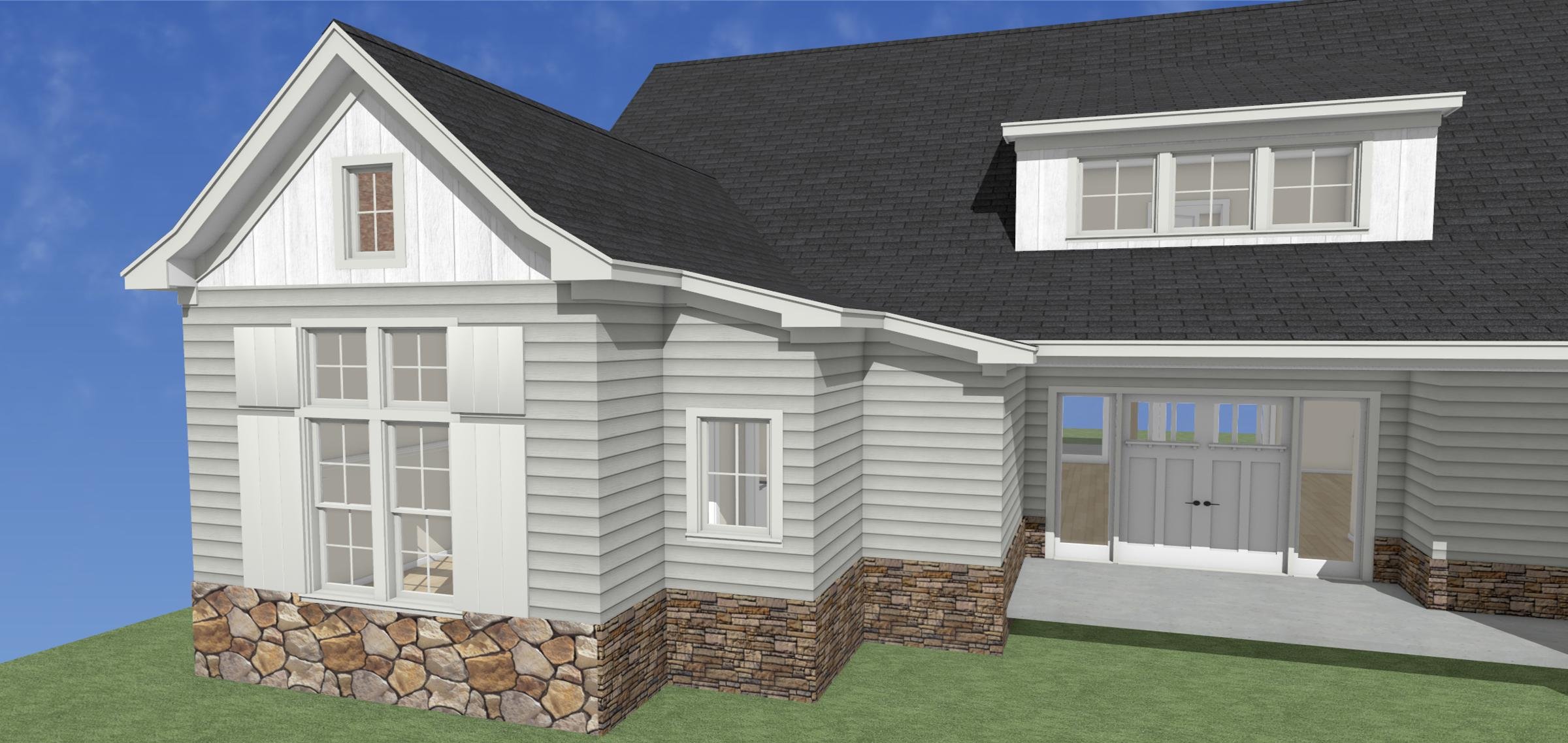

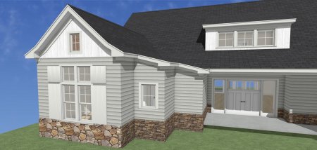

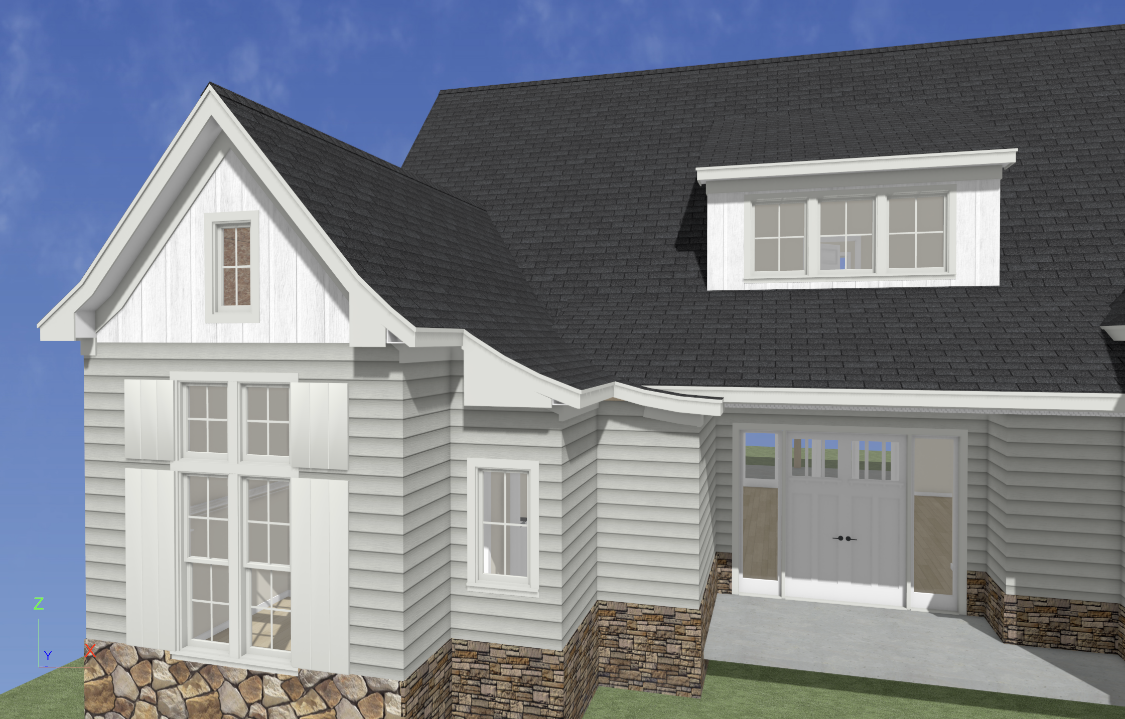

PitMan71 Posted March 4 Share Posted March 4 All I am having a boxed soffit issue where the trim is being placed on the outside edge of the box and not where it's supposed to be. I have tried several things to try and resolve and nothing is working. Hoping someone has sHidden Oaks 34.plan.zipeen this issue before. Thanks for having a look. Shane Link to comment Share on other sites More sharing options...

PitMan71 Posted March 4 Author Share Posted March 4 (edited) 1 hour ago, MPDesign said: I'm not sure if you intended it to be curved. Thanks for having a look.... Yes. I want that section of the roof to be curved. Edited March 4 by PitMan71 Link to comment Share on other sites More sharing options...
MPDesign Posted March 4 Share Posted March 4 ok, well I have found curved roofs don't tend to play well in chief. no matter the version. Hope you get it sorted. Link to comment Share on other sites More sharing options...

Solution robdyck Posted March 6 Solution Share Posted March 6 I'd suggest getting all the roofs exactly correct before curving that roof plane. Apply the curve only once all the roof planes are correct and all ridges, hips and valleys are connected. Then, be prepared to apply fascia and shadow boards and other trim pieces manually. 1 Link to comment Share on other sites More sharing options...
PitMan71 Posted March 6 Author Share Posted March 6 51 minutes ago, robdyck said: Then, be prepared to apply fascia and shadow boards and other trim pieces manually. I did exactly what you said and resigned to the fact that I would need to add. them manually. Thanks Rob. 1 Link to comment Share on other sites More sharing options...
PitMan71 Posted March 6 Author Share Posted March 6 From Support. Hi Shane,Thank you for contacting Chief Architect Support.After some tinkering with the roof, it seems like there's an issue with boxed eaves on curved roofs in X17. I'll make sure this gets reported to our developers to take a look at.In the meantime, I believe the best workarounds would be to either unchecked Curved Roof in that roof plane, or patch the holes manually with 3d solids.NathanChief Architect Technical Support Link to comment Share on other sites More sharing options...
