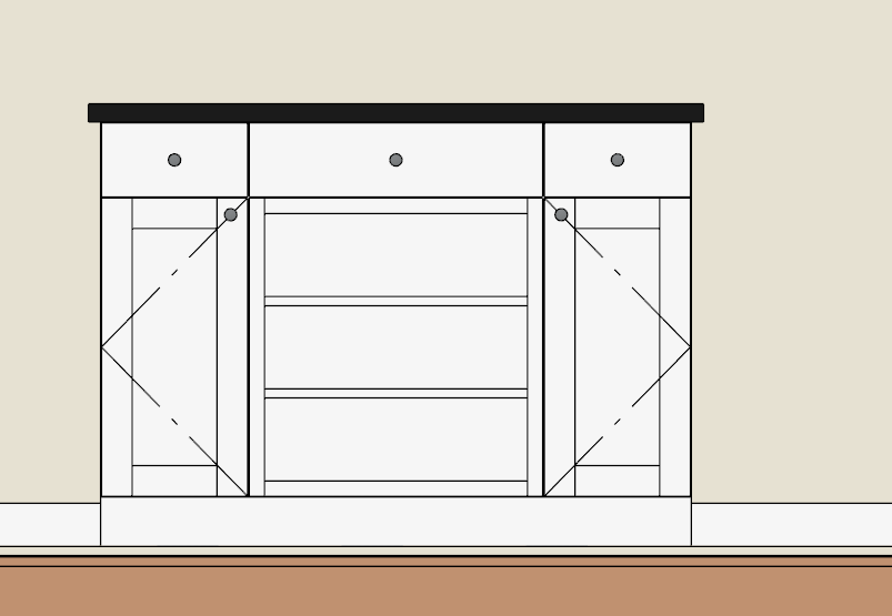

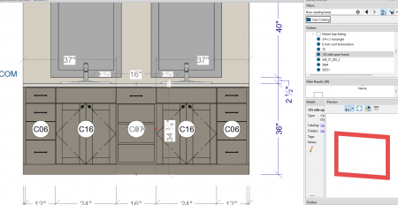

GeneDavis Posted February 6 Share Posted February 6 See the pic. The cabinet at center of this vanity run has a drawer at top and under is an opening with two shelves. I want to dress the opening with a 1.25" frame surround, to bring the face out flush to the surrounding fronts. You can see the door object I made for this in the side panel. How is this done? Link to comment Share on other sites More sharing options...
Renerabbitt Posted February 6 Share Posted February 6 21 minutes ago, GeneDavis said: You can see the door object I made for this in the side panel. How is this done? You didnt need to create a custom door, you could instead use a framed glass panel door and change the glass material to a classification of air gap, such as insulation air gap. Regardless, to answer your question. Change that from an opening to a right or left door and apply your custom door. Let me know if you need more specific instructions 1 Link to comment Share on other sites More sharing options...
GeneDavis Posted February 7 Author Share Posted February 7 Hey! Thanks for the look @Renerabbitt. I feel honored that the CA king of cabinets entered the room. I put my open-center door on the cab as a door panel, but did not try putting it on as a hinged door. Doing it as a hinged door gives me the shelves I need, but how do I get rid of the opening indicator in the 2D elevation? Link to comment Share on other sites More sharing options...

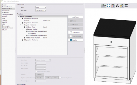

MarkMc Posted February 7 Share Posted February 7 16 hours ago, GeneDavis said: I want to dress the opening with a 1.25" frame surround, to bring the face out flush to the surrounding fronts. An alternative would be - split opening vertical, change item types and sizes split horizontal, change items types and sizes No need to change indicators though it takes a bit longer the first time but leaves a lot more control to alter if using in the future. Even faster just using the attached Style Palette. I used a renamed slab to make adjustments easier. Framed Opening Style Palette.calibz 1 Link to comment Share on other sites More sharing options...
