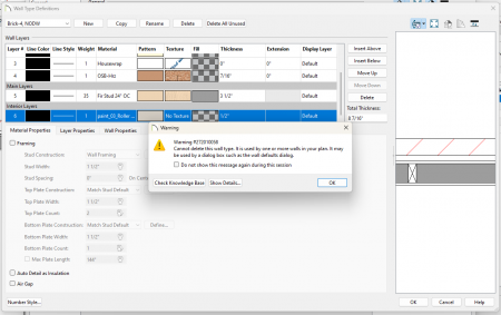

kwhitt Posted January 26 Share Posted January 26 I’m creating an exterior brick wall with no wallboard on the interior. I do this by copying Brick-4 and attempting to delete the wallboard layer. When I attempt to delete, I get the attached error message. This method worked fine in X16 but not in X17 to which I just recently upgraded. Link to comment Share on other sites More sharing options...
joey_martin Posted January 26 Share Posted January 26 Seems like a silly question but, are you sure you are hitting DELETE on the right and not at the top? 1 Link to comment Share on other sites More sharing options...
kwhitt Posted January 26 Author Share Posted January 26 Yes, and I've tried it several times - even restarting Chief. Sometimes after modifying the new wall, it will revert to Brick-6 and totally ignore the changes I made. Link to comment Share on other sites More sharing options...
Doug_N Posted January 26 Share Posted January 26 Next question, have you created a copy of the wall type being used in the plan? Hopefully, it is the copy that you are trying to modify. Also, it would be helpful for you to post a copy of the plan file. Link to comment Share on other sites More sharing options...

kwhitt Posted January 26 Author Share Posted January 26 Here's a link to the file in a Dropbox folder: https://www.dropbox.com/scl/fo/jo4umwplypjp7rgaupfhu/AHYDZkRSEgkF5B-IUQJc_aY?rlkey=z3zmmk8rg2ugcax2t0m4ndqfs&st=auasrjk2&dl=0 Please open the wall marked by the revision cloud and see if you are able to delete the wallboard layer. Thanks! Link to comment Share on other sites More sharing options...
DBCooper Posted January 26 Share Posted January 26 (edited) I think Joey is correct. The only way you will get that message is if you are trying to delete the "wall type" and not when you try to delete the currently selected "wall layer". Basically, you are pushing the wrong "delete" button. If you are indeed pushing the right button, then something is seriously messed up. You should exit Chief and reboot your computer to see if it keeps happening. FWIW, I went ahead and downloaded your plan and had no problem deleting the paint layer. Edited January 26 by DBCooper 1 Link to comment Share on other sites More sharing options...
