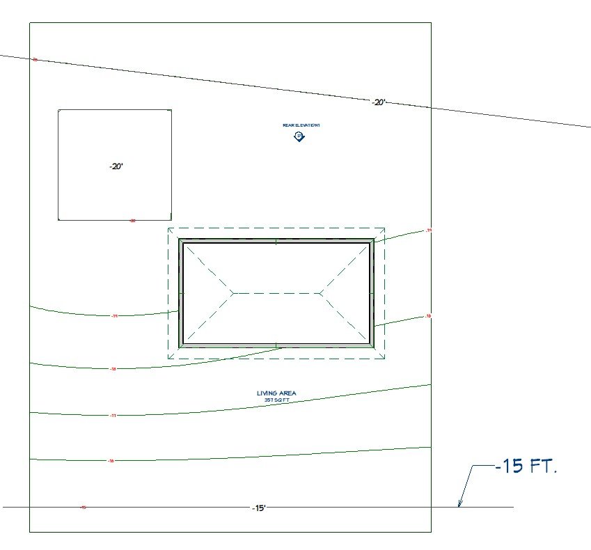

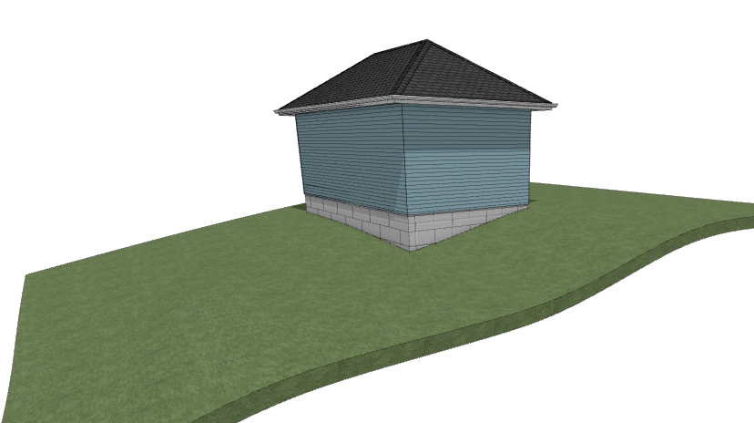

scottharris Posted January 7 Share Posted January 7 I think you will need at least one of your terrain values to be a different elevation - as Mark3D points out. Otherwise, the terrain takes on the common value you set which was -20’. In the example below, I added another elevation at the front with -15’ 1 1 Link to comment Share on other sites More sharing options...

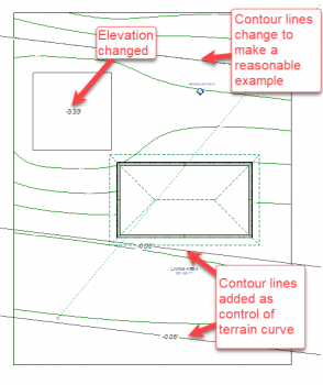

Doug_N Posted January 7 Share Posted January 7 I had to make several changes to data to get the terrain to generate some non-cliff like changes. So this is just to demonstrate the method to get to a result. You have to use real data from the entire site to make you project work properly. Hope this helps. 751877093_Terrainproblem.plan 1 Link to comment Share on other sites More sharing options...
