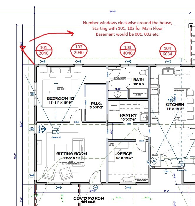

Ange822 Posted January 5 Share Posted January 5 Hi there, I am new to the window schedule / labels and needing some help. Is it possible to number the windows clockwise around the house rather than just randomly allocating numbers? Is there also a way to label them starting with 0 for the basement, and 1 for main floor, 2 for 2nd floor etc. I was hoping there would be a way to have the window number above the window size. I tried playing around with "both callout and label" but I'm struggling to make it work. thanks in advanced! Link to comment Share on other sites More sharing options...

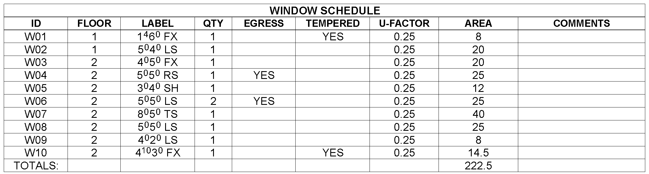

Ange822 Posted January 5 Author Share Posted January 5 (edited) 39 minutes ago, para-CAD said: You can reposition the order in the schedule. The first column allows you to drag up or down and the label updates in the plan. I don't know about floor zero numbering. Oh wow that is great!! Thank you so much!! How did you change the size of the window to have the subscript number as the inches? Is there also a way to have the basement as 001, 002, 003... and then the Main Floor as 101, 102, 103.. and then I can just re-order them? Edited January 5 by Ange822 Link to comment Share on other sites More sharing options...

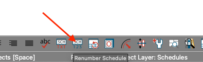

Chrisb222 Posted January 6 Share Posted January 6 14 hours ago, Ange822 said: Is it possible to number the windows clockwise around the house rather than just randomly allocating numbers? Just to add to what others have said, you have a couple of tools in the object toolbar to edit schedule numbering... You can change the window's position in the schedule using these up and down arrows, with the window selected: Also, if after adding the schedule you happen to delete a window, it may cause a gap in the numbering. There's a tool to renumber the schedule and eliminate numbering gaps: 2 Link to comment Share on other sites More sharing options...

para-CAD Posted January 6 Share Posted January 6 17 hours ago, Ange822 said: Oh wow that is great!! Thank you so much!! How did you change the size of the window to have the subscript number as the inches? Is there also a way to have the basement as 001, 002, 003... and then the Main Floor as 101, 102, 103.. and then I can just re-order them? I paid Alaskan Son to create the superscript option. He was fast and reasonable. It takes a modified font that he provides, I chose modified ARIAL. Then I set all my font type to ARIAL and the window and door openings to the modified ARIAL. Rene also provides this, I don't know if it is only in his plan template or can be sold as an individual item. 1 Link to comment Share on other sites More sharing options...
