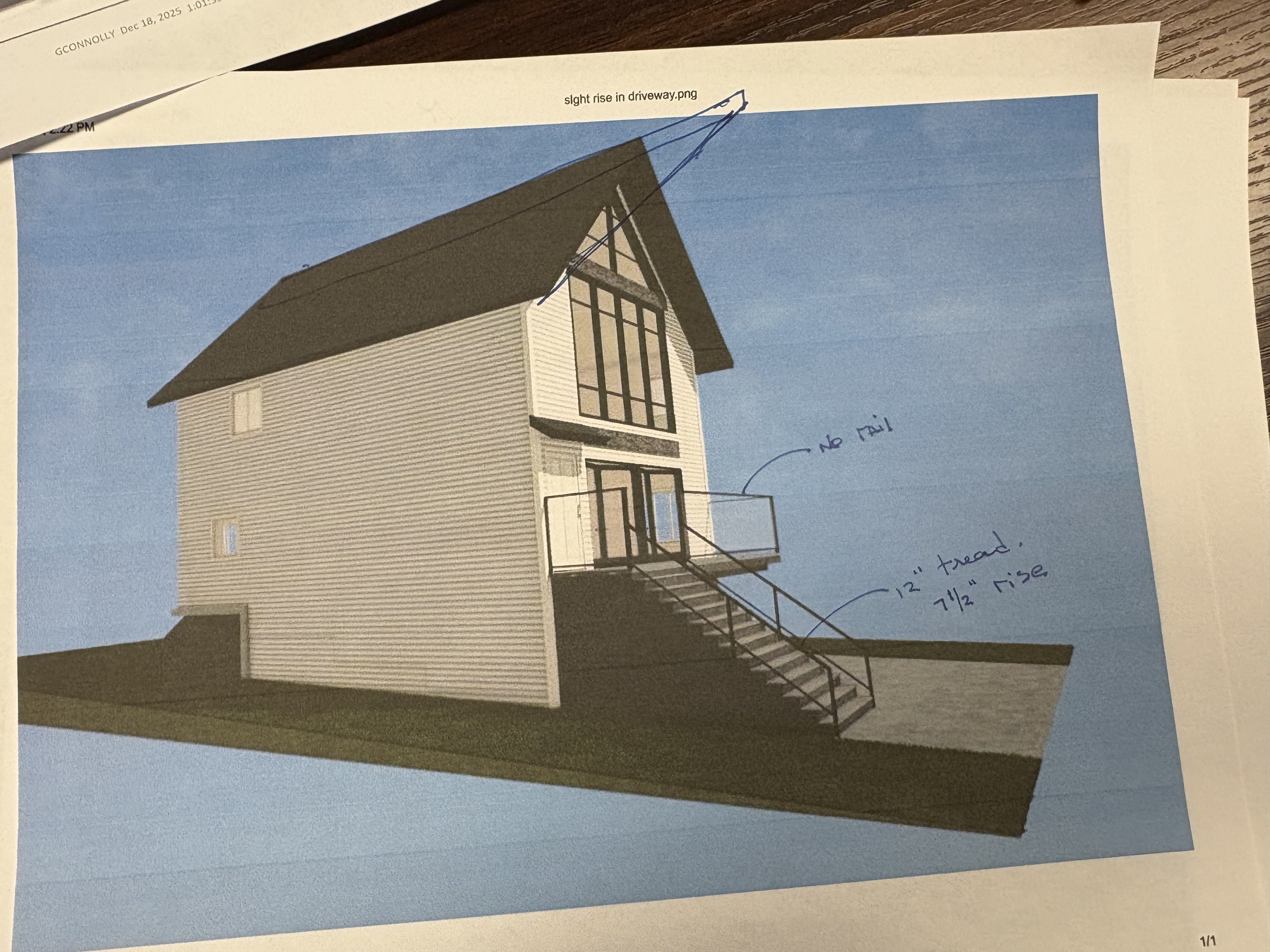

decorators3 Posted December 29, 2025 Share Posted December 29, 2025 (edited) I posted this a few days ago and got all your responses thanks! My original question was what is a gable perch? But now I have a Drawing of what the client wants so I'm asking how do I create this gable perch Thanks again in advance Edited January 3 by decorators3 Link to comment Share on other sites More sharing options...

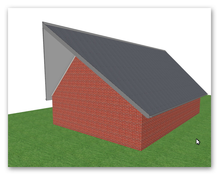

Mark3D Posted December 30, 2025 Share Posted December 30, 2025 Is that what you want 1 Link to comment Share on other sites More sharing options...
decorators3 Posted December 30, 2025 Author Share Posted December 30, 2025 1 hour ago, Mark3D said: Is that what you want YES!!! Link to comment Share on other sites More sharing options...
para-CAD Posted December 30, 2025 Share Posted December 30, 2025 That's called a prow over here 2 Link to comment Share on other sites More sharing options...
Mark3D Posted December 30, 2025 Share Posted December 30, 2025 just manual edit roof plains with auto roof turned off. 1 Link to comment Share on other sites More sharing options...

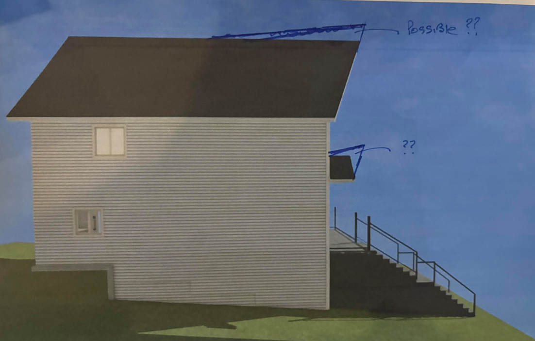

decorators3 Posted January 3 Author Share Posted January 3 thank you every one for your assistance it worked perfectly. Now the client has asked me if I can create the roof where the perch/prow is at a higher pitch than the ridge. here's how he wants the roof to look if its possible ( see image he sent me ) I looked at videos for dual roof heights but didn't see anything for this set up, should I copy the roof as if I was adding a curved and adjust the height then join but not sure how to approach this with a gable roof , any info is appreciated! Cheers Levina dual pitch gable.pdf Link to comment Share on other sites More sharing options...
decorators3 Posted January 3 Author Share Posted January 3 here's is an image of the clients idea. Link to comment Share on other sites More sharing options...
Mark3D Posted January 3 Share Posted January 3 You can give the baselines a angle Link to comment Share on other sites More sharing options...
decorators3 Posted January 3 Author Share Posted January 3 11 minutes ago, Mark3D said: You can give the baselines a angle yes I can do that and it works ,,now how do i keep the roof looking straight from the side view.. the roof looks slanted from back of house to front of house all the way to the front prow. client is looking for a slight upward slant towards the prow front overhang Link to comment Share on other sites More sharing options...

Mark3D Posted January 4 Share Posted January 4 (edited) Here is a possible way of doing it not sure if it could be made to work in real world situation the more expert chief users will have better idea of it being buildable roof ship front1.plan Edited January 4 by Mark3D Link to comment Share on other sites More sharing options...
decorators3 Posted January 4 Author Share Posted January 4 33 minutes ago, Mark3D said: Here is a possible way of doing it not sure if it could be made to work in real world situation the more expert chief users will have better idea of it being buildable roof ship front1.plan 4.03 MB · 1 download I think we are on the right track..clients can sure make you create out of ordinary scenatios..i think a small plane might work..i was creating one but eas too large..thanks..but will google Link to comment Share on other sites More sharing options...
decorators3 Posted January 4 Author Share Posted January 4 12 hours ago, decorators3 said: I think we are on the right track..clients can sure make you create out of ordinary scenatios..i think a small plane might work..i was creating one but eas too large..thanks..but will google thanks soooo much for your plan it looks prefect. I work in imperial measures so I have to adjust according; AGAIN looks great! Link to comment Share on other sites More sharing options...
