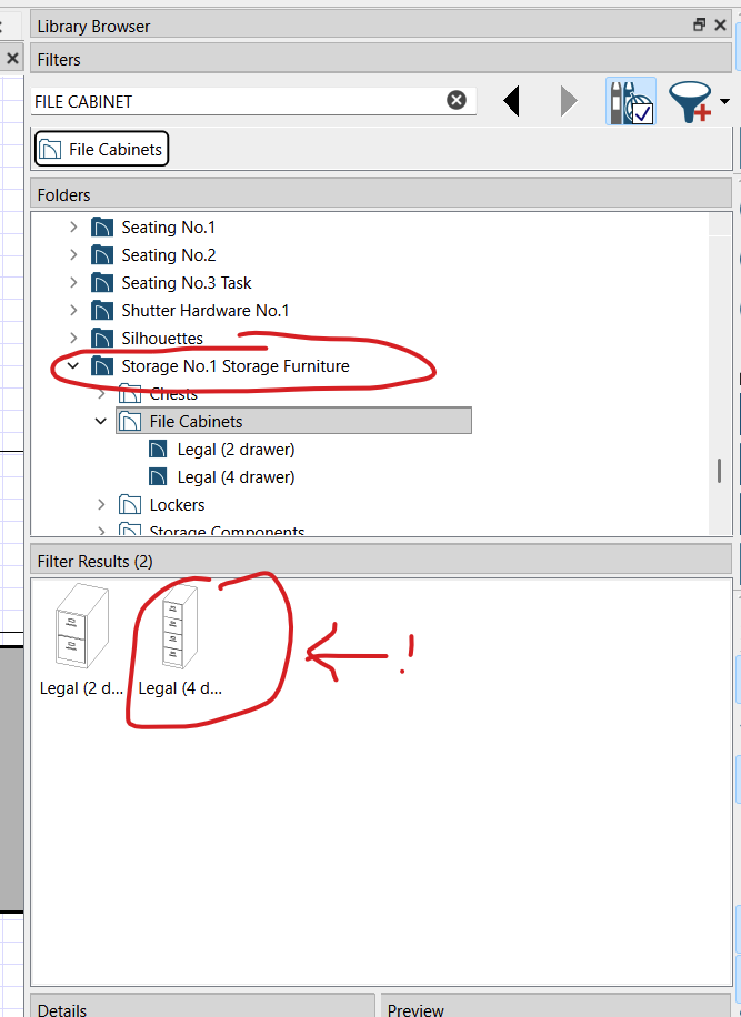

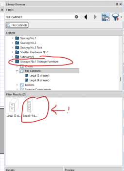

JKEdmo Posted December 10 Share Posted December 10 2 hours ago, raltd9245 said: Why can't I find a simple 4 drawer file cabinet in chief? Download the bonus catalog "Storage No. 1 Storage Furniture" 1 Link to comment Share on other sites More sharing options...
DBCooper Posted December 10 Share Posted December 10 If you want to find everything that is available from Chief, you need to make sure "include web results" is turned on in the library browser. This will include the bonus and manufacturer libraries that you haven't downloaded to your machine. If you search for "file", you will get a ton of stuff that has nothing to do with file cabinets. If you search for "file cabinet" (and include the quotes) you should find 4 different file cabinets. If you don't use the quotes, you will get a bunch of stuff you don't want because it includes anything with file or cabinet as part of the name. Link to comment Share on other sites More sharing options...
