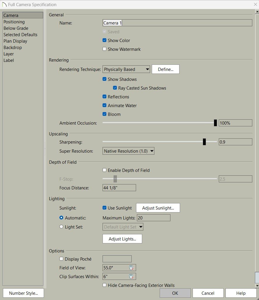

JKEdmo Posted 20 hours ago Share Posted 20 hours ago 1 hour ago, ericepv said: Past versions of Chief included a option called 'Extend Terrain to Horizon' in the camera DBX. I finally came across a use for this function but now I can't find it in the camera DBX or anywhere else the help index tells me to look. It's at the bottom of the Camera panel: Link to comment Share on other sites More sharing options...

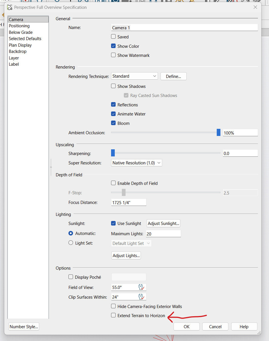

DBCooper Posted 11 hours ago Share Posted 11 hours ago I think it only shows up in a perspective camera and not an orthographic one. Also, it won't do anything unless you have a terrain perimeter. Link to comment Share on other sites More sharing options...

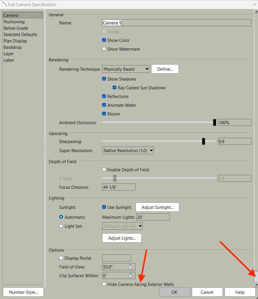

ericepv Posted 1 hour ago Author Share Posted 1 hour ago 18 hours ago, JKEdmo said: It's at the bottom of the Camera panel: I don't have this on my DBX... Link to comment Share on other sites More sharing options...
Chrisb222 Posted 3 minutes ago Share Posted 3 minutes ago 1 hour ago, ericepv said: I don't have this on my DBX... Yes you do. Scroll your specification window, it's right below Hide Camera-Facing Exterior Walls: Link to comment Share on other sites More sharing options...
