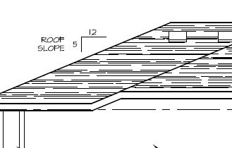

Mgovia Posted December 3, 2025 Share Posted December 3, 2025 Hello, I wondering how I would go about connecting my fascia and roof lines from two different heights? then have the wall cleanly fill the area. Thanks for any help in advance. Link to comment Share on other sites More sharing options...

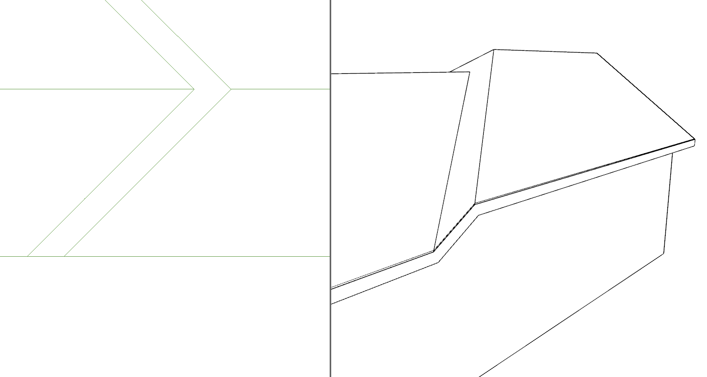

PitMan71 Posted December 5, 2025 Share Posted December 5, 2025 I don't know of a way to do this with auto roofs turned on. It would be simple with manual roof planes. in this case you could turn off manual roof planes and grab the edge of the upper roof plane that turns back toward the lower roof till it forms a point and then modify the lower roof plane to follow the new valley edge created by pulling the upper roof down. its easy once you get the hang of it. Link to comment Share on other sites More sharing options...

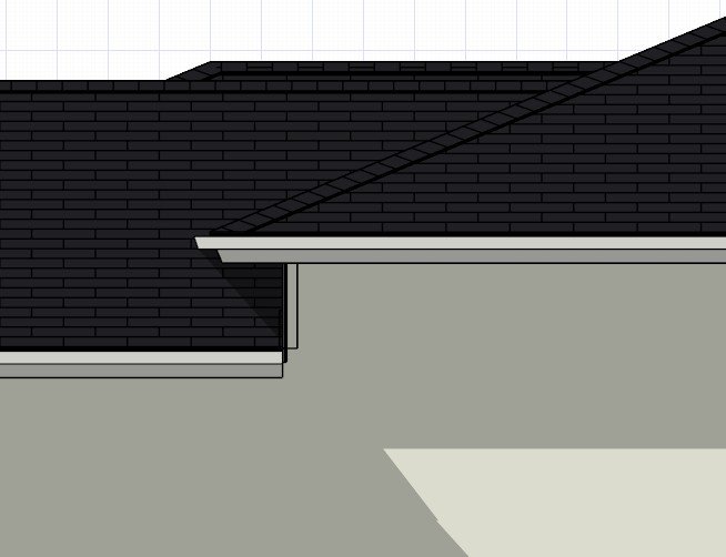

Chrisb222 Posted December 5, 2025 Share Posted December 5, 2025 I was having the same thought so I took a run at it. Pretty simple with manual roofs. Link to comment Share on other sites More sharing options...

JiAngelo Posted December 5, 2025 Share Posted December 5, 2025 With autoroofs on, draw an invisible room under the sloped area. Break the outside wall and tell chief the invisible rooms exterior wall is high shed gable. Once autoroofs is turned off you can delete the invisible walls. Choosing between manual or autoroofs method comes down to how far along in the process I am. 1 Link to comment Share on other sites More sharing options...
