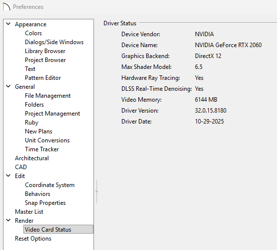

Joe_Carrick Posted December 3, 2025 Share Posted December 3, 2025 2 hours ago, JuanR2 said: The new one renders images almost 3 times faster: 9 minutes with the old one, 3 minutes with the new. Those numbers seem like CPU Ray Tracing. Are you sure you have the computer set up to use the GPU? Link to comment Share on other sites More sharing options...

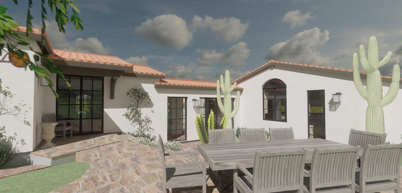

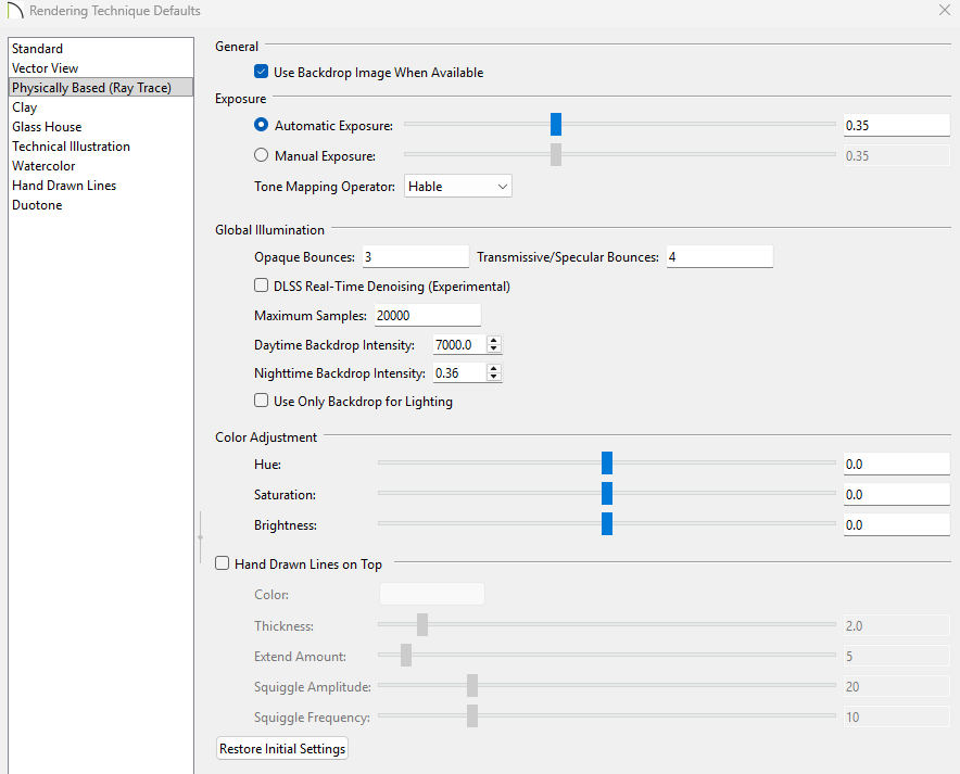

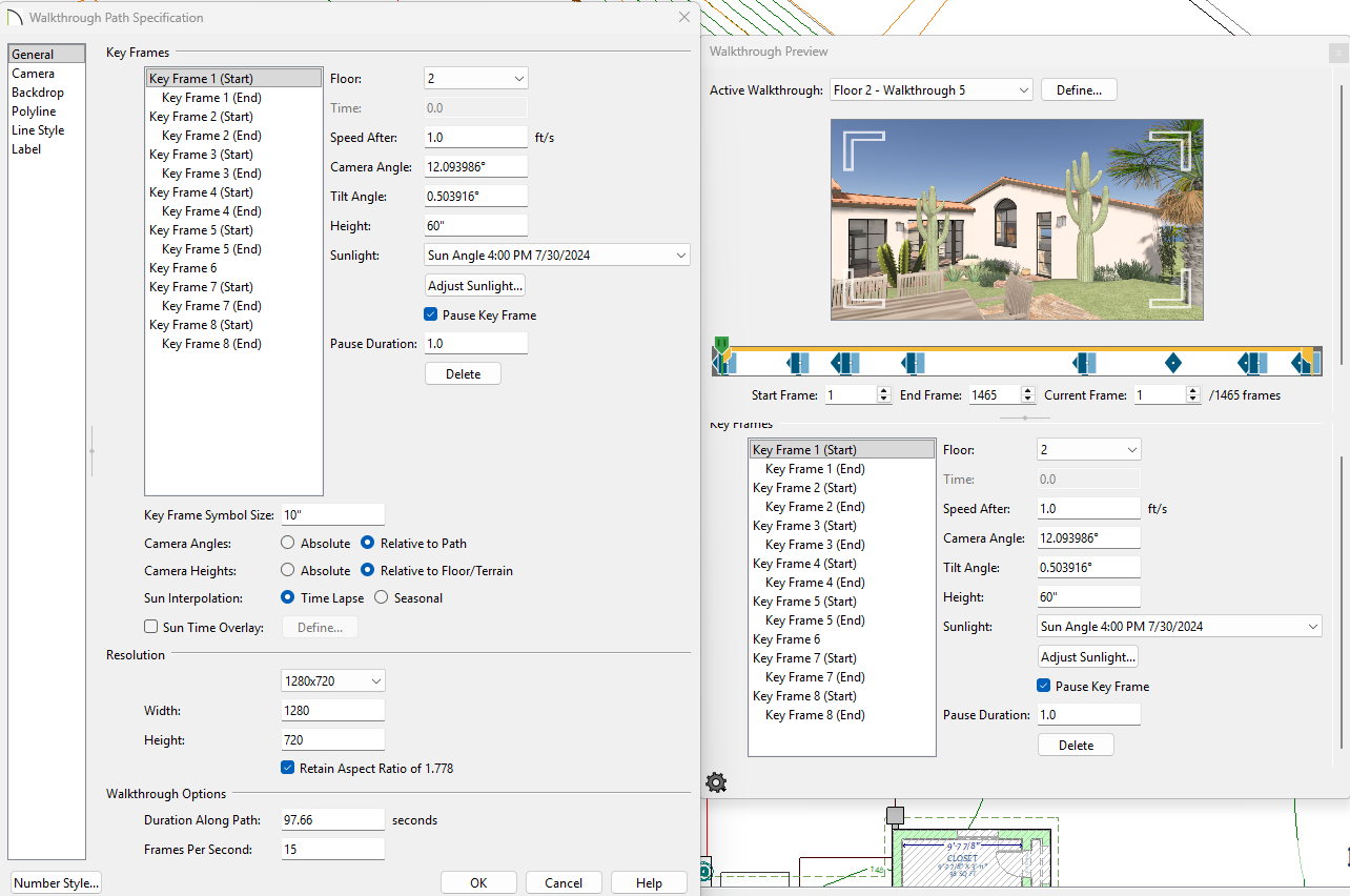

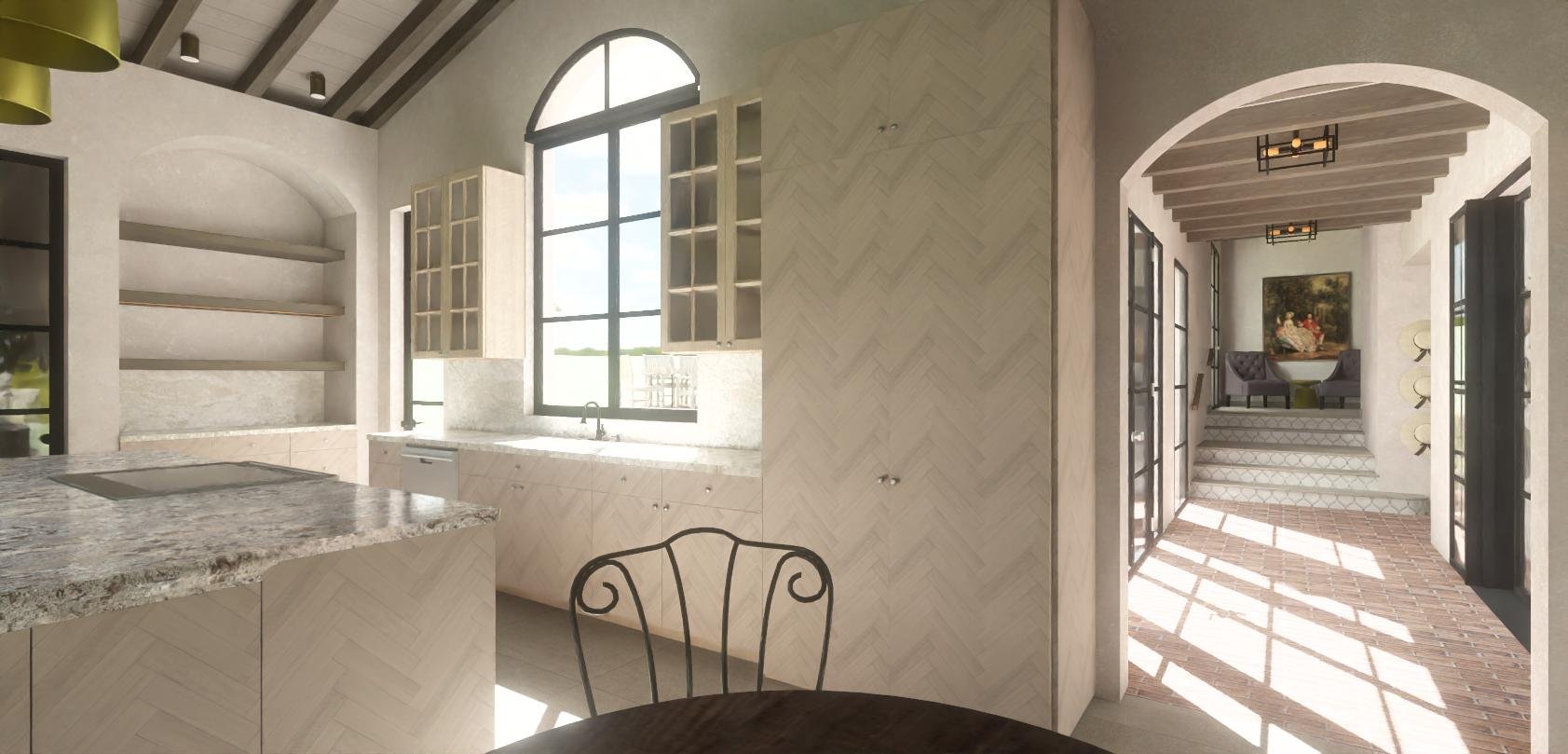

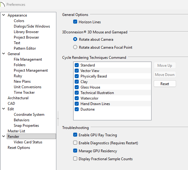

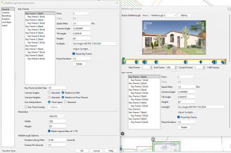

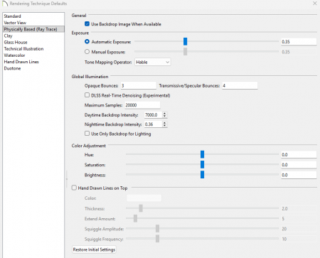

JuanR2 Posted December 3, 2025 Author Share Posted December 3, 2025 13 hours ago, Renerabbitt said: We dont have nearly enough info, sample rate too high. surface count can be super high, number of lights could be super high, number of transparent surfaces, resolution and size of screen, backdrop resolution, texture resolution, materials with pattern from texture enabled etc Thanks for all the Feedback! Part of the Mystery solved! I was using the default 20,000 Samples I was misled by the settings when I canceled at 3,000 Samples and the Rendering was poor (attached), after 7 minutes! Now with Setting at 500 Samples takes 1:18 min With Setting at 300 Samples -for production is great!- average 30 seconds! All done with my OLD notebook, 1 interior light (simulating a solar tube inside the shower) spherical 360 photo from the site WHAT ELSE DO I NEED TO MODIFY? I attached my settings also for Video Recording Link to comment Share on other sites More sharing options...
Renerabbitt Posted December 3, 2025 Share Posted December 3, 2025 Just now, JuanR2 said: I was using the default 20,000 Samples FYI the OOTB default is 250 samples, 20,000 is a setting you put in place at some point you can often get away with 30 samples if your scene has enough lumens. You can also turn on DLSS realtime for designing in live raytrace or raytracing walkthroughs super fast. 2000 samples is way overkill for most shots. A spherical 360 photo is okay, but an HDR backdrop is preferred as it has a radiance channel that can take the place of using the reproduce sun settings in chief. For your older machine in most shots you can turn your bounces to 2 and 2 and adjust upward if you see problems. PS, seriously turn on DLSS for your walkthroughs Link to comment Share on other sites More sharing options...

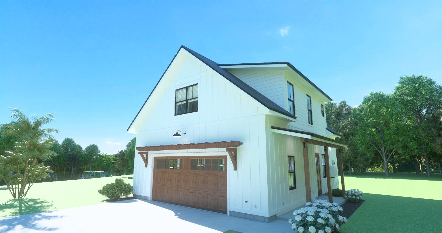

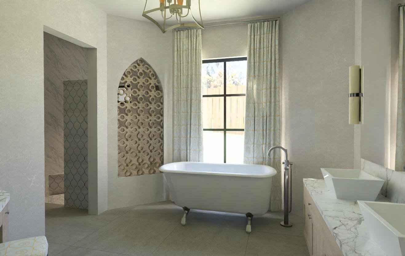

Renerabbitt Posted December 3, 2025 Share Posted December 3, 2025 (edited) FYI:: Edited December 3, 2025 by Renerabbitt Link to comment Share on other sites More sharing options...
basketballman Posted December 3, 2025 Share Posted December 3, 2025 50 minutes ago, JuanR2 said: Thanks for all the Feedback! Part of the Mystery solved! I was using the default 20,000 Samples I was misled by the settings when I canceled at 3,000 Samples and the Rendering was poor (attached), after 7 minutes! Now with Setting at 500 Samples takes 1:18 min With Setting at 300 Samples -for production is great!- average 30 seconds! All done with my OLD notebook, 1 interior light (simulating a solar tube inside the shower) spherical 360 photo from the site WHAT ELSE DO I NEED TO MODIFY? I attached my settings also for Video Recording Still looks pretty flat compared to what is possible. 1 Link to comment Share on other sites More sharing options...

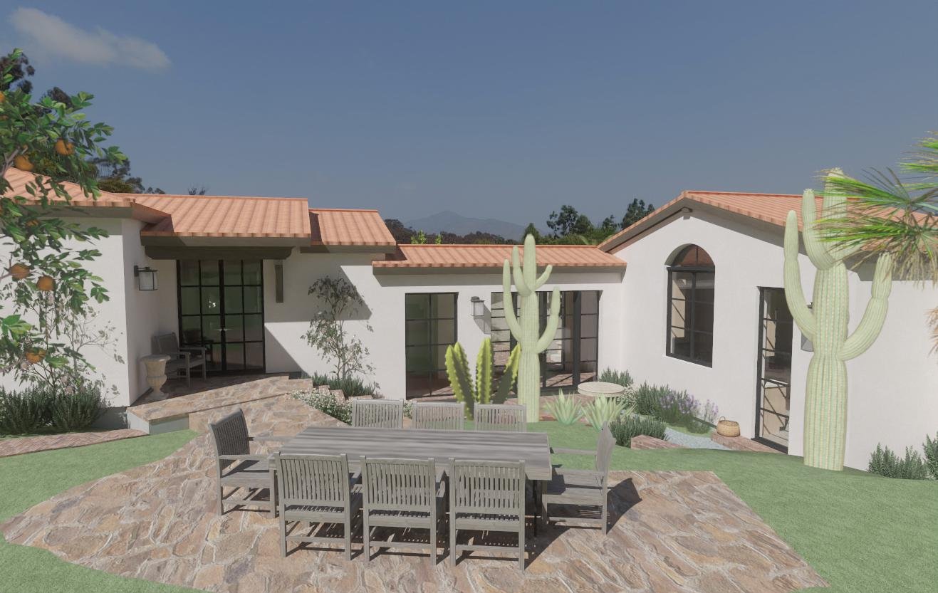

Renerabbitt Posted December 3, 2025 Share Posted December 3, 2025 1 hour ago, basketballman said: Still looks pretty flat compared to what is possible. Ha challenge accepted 2 Link to comment Share on other sites More sharing options...
basketballman Posted December 3, 2025 Share Posted December 3, 2025 Better. But not quite there yet. Look at stone patio realism And where are oranges ? Link to comment Share on other sites More sharing options...

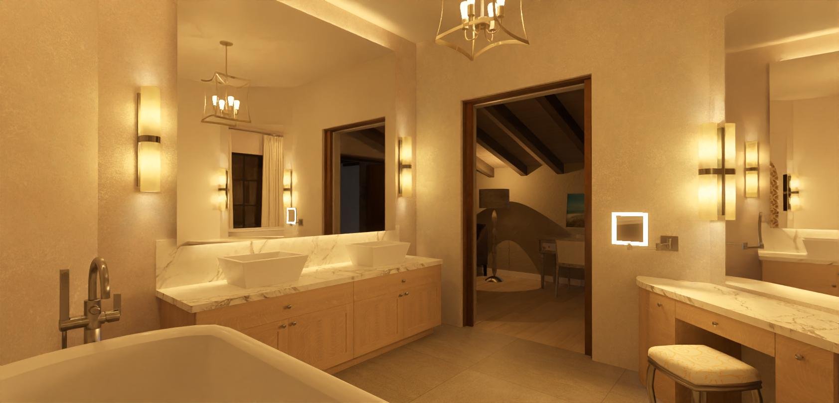

JuanR2 Posted December 3, 2025 Author Share Posted December 3, 2025 Thanks, my 360 image (picture from the site) takes the same time as HDR. I did turn down to 50 Samples on both Exterior and Interior Cameras -sun light does help a lot. These are the Results for Images: Exterior 3 Seconds. Interior 6 Seconds, Lighted Interior with Mirrors 9 Seconds. For Walkthroughs of 1,465 Frames on Standard was taking 16 min, now Ray Traced took 3:30 min with DLSS on. This with my OLD notebook! ... I'm finding out what I've been missing! I watched your video on turning off surfaces, mi project has 2 Million and came down to 1 Million, though I checked speeds and there was no noticeable difference. My Nvidia Card lets me choose between a Driver for Gamers or one for Creators. Guess the one for Creators should be my choice? I will test this setup on the NEW notebook, which for now my expectations are to design live in Ray Trace. FOR NOW, THE CHANGE YOU ENABLED HAS BEEN WAY WAY BEYOND MY DREAMS PS. Or maybe just return the new notebook and spend the money on a vacation ...LOL, really my problems have been solved! Link to comment Share on other sites More sharing options...
JuanR2 Posted December 3, 2025 Author Share Posted December 3, 2025 57 minutes ago, basketballman said: Better. But not quite there yet. Look at stone patio realism And where are oranges ? Both of the Renderings are very realistic! Now that I managed to bring down my time spent rendering, seems that now I'll spend time with AI I guess? Link to comment Share on other sites More sharing options...
JuanR2 Posted December 3, 2025 Author Share Posted December 3, 2025 These are the actual trees and not the cactus plants I'm using Link to comment Share on other sites More sharing options...
