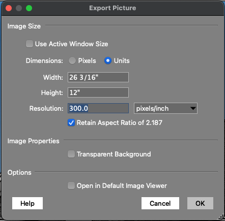

Chrisb222 Posted November 18, 2025 Share Posted November 18, 2025 Change the export dimensions to "Units" and set the Resolution to at least 300 pixels/inch: Link to comment Share on other sites More sharing options...

decorators3 Posted November 19, 2025 Author Share Posted November 19, 2025 21 hours ago, JiAngelo said: Choose 600dpi for best results at actual size. Use 1200dpi if you plan to enlarge the image. The latter is what we send as proofs to agencies and PowerPoint slides. Is this for units or pixels or does it matter Link to comment Share on other sites More sharing options...
DBCooper Posted November 19, 2025 Share Posted November 19, 2025 Units. If you are exporting pixels and you increase the resolution, you will just get a smaller picture and it won't look any better. Link to comment Share on other sites More sharing options...
