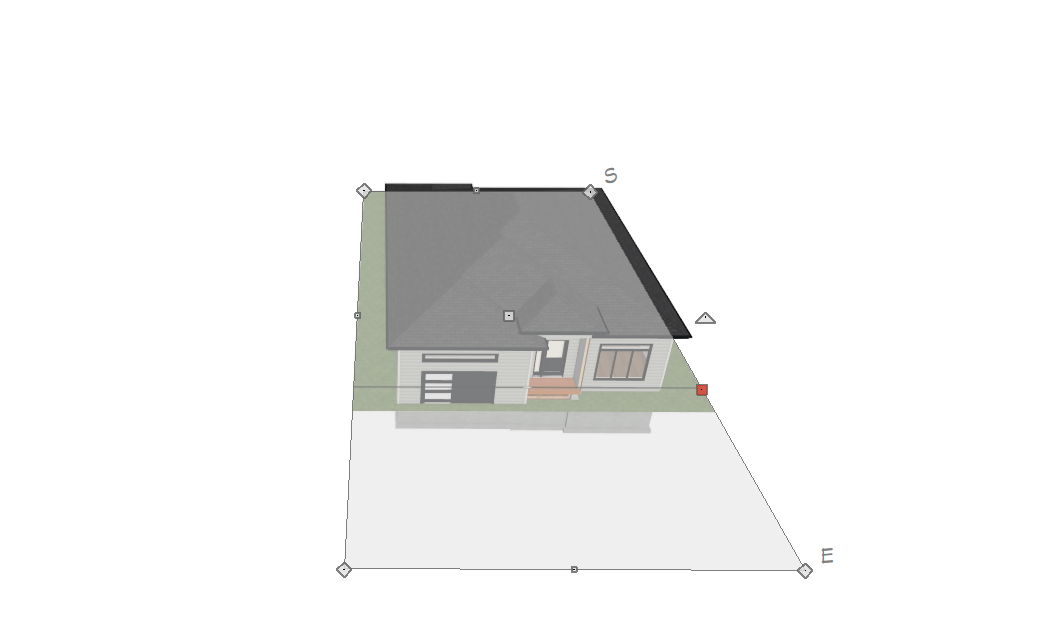

decorators3 Posted September 22, 2025 Share Posted September 22, 2025 Not sure why my terrain perimeter is not showing the full area . thinking i pressed wrong button or something. even when i cleared it and built it again the same results see attached image - any suggestions Link to comment Share on other sites More sharing options...

SHCanada2 Posted September 23, 2025 Share Posted September 23, 2025 (edited) did you "rebuild terrain"? Edited September 23, 2025 by SHCanada2 Link to comment Share on other sites More sharing options...
DBCooper Posted September 23, 2025 Share Posted September 23, 2025 If it fixed itself, then it was probably a rebuild terrain issue. I have seen the program get the terrain out of date even with the auto rebuild on but if auto rebuild is off then it is usually out of date as soon as you make any changes. The other thing that can cause something like this is a terrain hole. That was going to be my first guess and if it wasn't that it was going to be a "post the plan" issue. Link to comment Share on other sites More sharing options...
