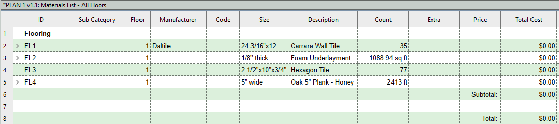

5Design Posted September 12, 2025 Share Posted September 12, 2025 (edited) Hey Y'all, Anyone had this issue? Not sure why Chief thinks a monolithic slab is a room w/ flooring, but I deleted the foundation and it's still doubling. And whomever is downvoting my post can go F off. So ridiculous. PLAN 1 v1.1.zip Edited September 12, 2025 by 5Design 1 1 2 Link to comment Share on other sites More sharing options...

robdyck Posted September 13, 2025 Share Posted September 13, 2025 You may already know this but I'll mention it anyway. Have you created a new material list after removing the foundation? If I remember correctly, in X15, a material list is a snapshot in time...it can't update itself with changes to the model. I don't use X15 anymore, but here's the output I get for the Flooring category: 1 Link to comment Share on other sites More sharing options...
5Design Posted September 15, 2025 Author Share Posted September 15, 2025 (edited) On 9/13/2025 at 8:51 AM, robdyck said: You may already know this but I'll mention it anyway. Have you created a new material list after removing the foundation? If I remember correctly, in X15, a material list is a snapshot in time...it can't update itself with changes to the model. I don't use X15 anymore, but here's the output I get for the Flooring category: Yeah, tried that. Thanks. That's about double what it should be--though not exactly double, which is also weird. Edited September 15, 2025 by 5Design NA Link to comment Share on other sites More sharing options...

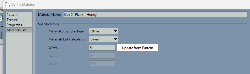

Solution Rpadge Posted September 15, 2025 Solution Share Posted September 15, 2025 the 2,413 of the plank flooring is not sq feet (I think), not sure if thats what your referring to or not, but you may want to check the material definition. I believe that is a linear foot quantity 1 1 Link to comment Share on other sites More sharing options...
robdyck Posted September 15, 2025 Share Posted September 15, 2025 1 hour ago, Rpadge said: I believe that is a linear foot quantity That's what it is: 1 Link to comment Share on other sites More sharing options...
robdyck Posted September 15, 2025 Share Posted September 15, 2025 1 Link to comment Share on other sites More sharing options...
5Design Posted September 15, 2025 Author Share Posted September 15, 2025 7 hours ago, Rpadge said: the 2,413 of the plank flooring is not sq feet (I think), not sure if thats what your referring to or not, but you may want to check the material definition. I believe that is a linear foot quantity Ahhh. That would be the issue. Thanks, Yall! Link to comment Share on other sites More sharing options...
