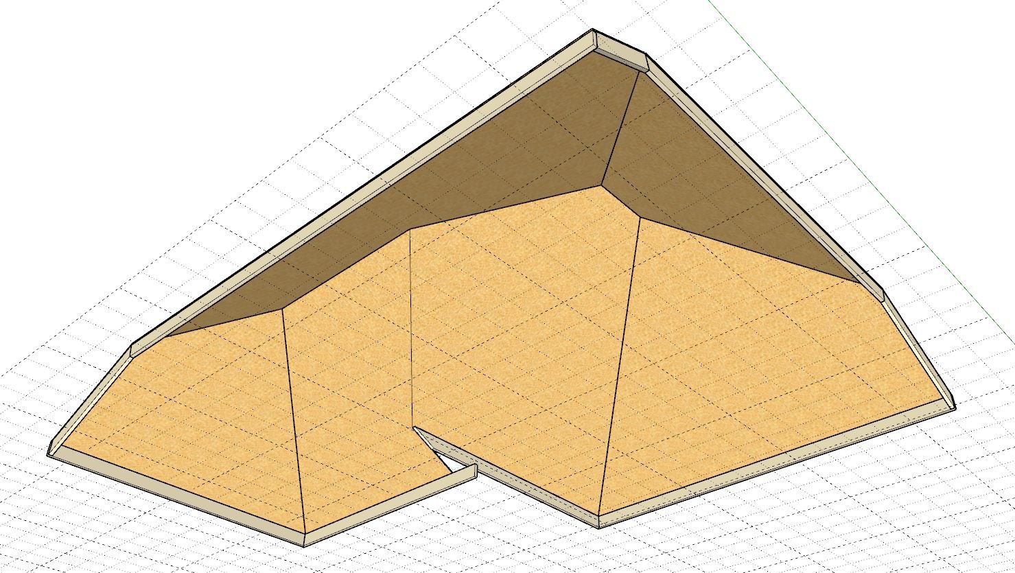

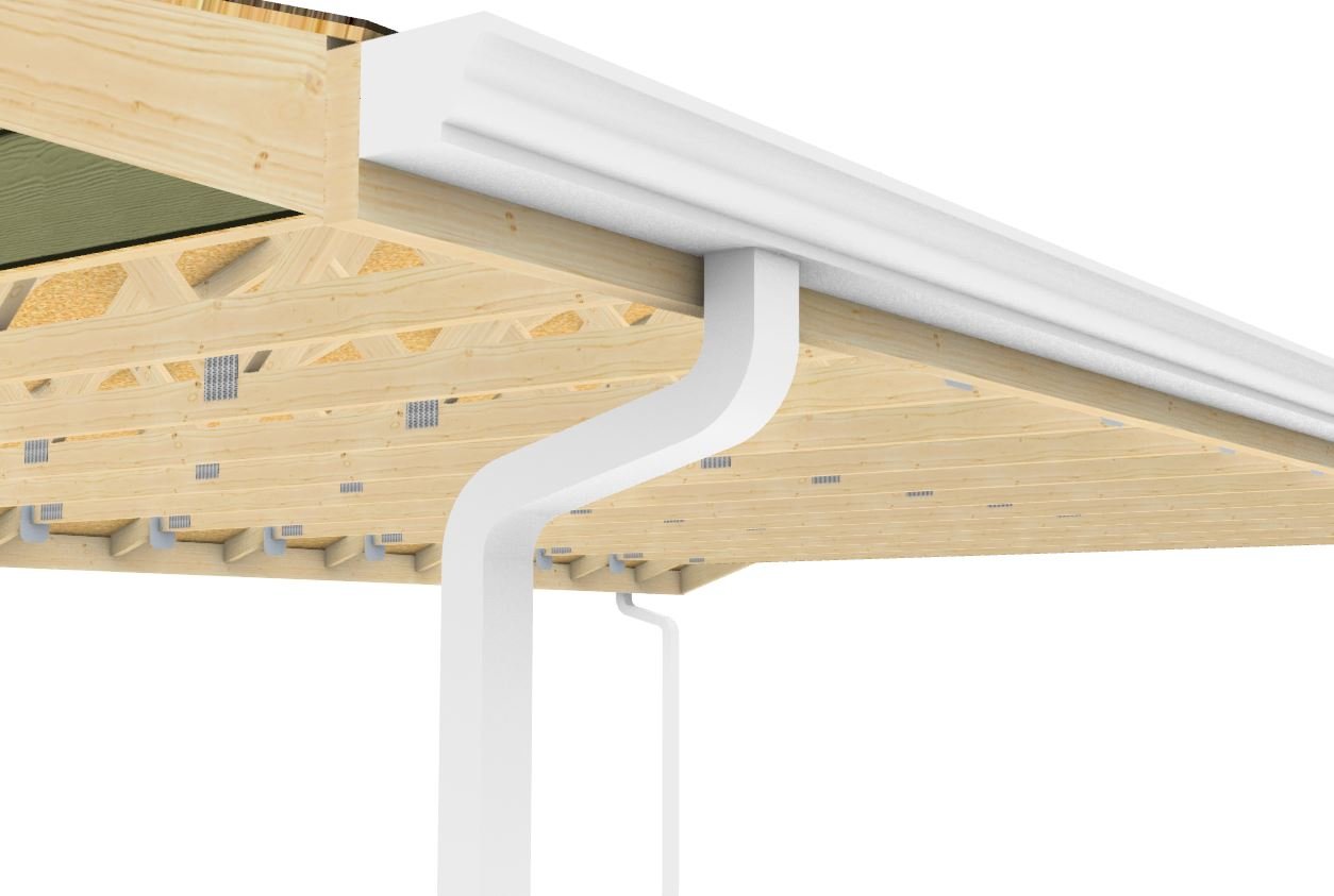

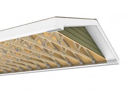

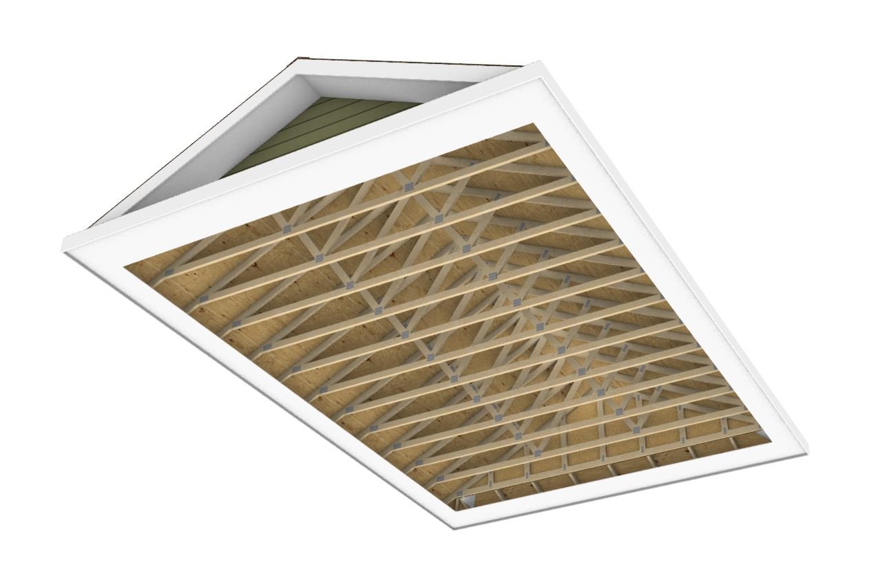

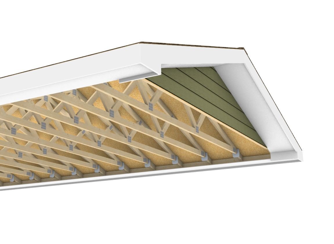

Medeek Posted August 14 Author Share Posted August 14 First look at sheathing, sub-fascia, outlookers and rake boards in Rhino 8: Its a shame I can't port my extensions into Chief, that would be pretty cool if I could. 1 Link to comment Share on other sites More sharing options...

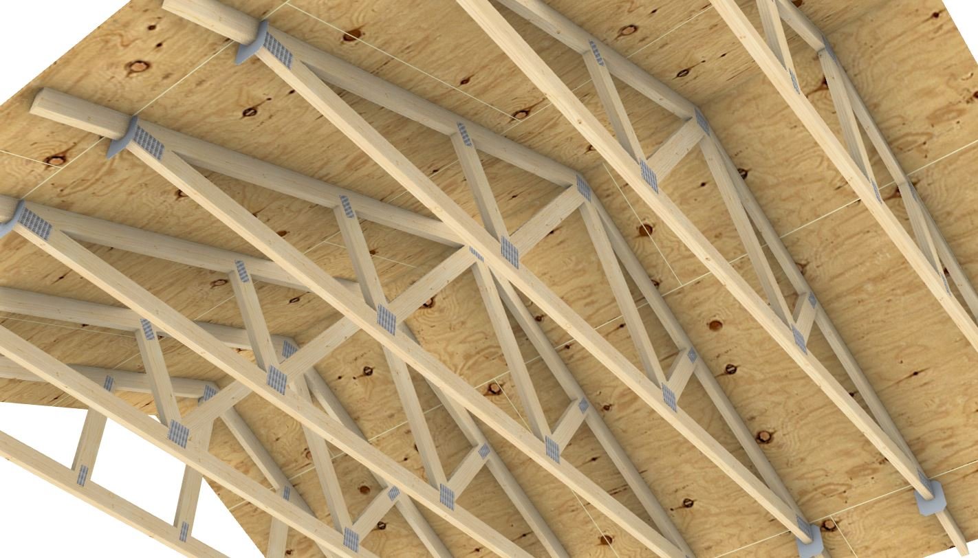

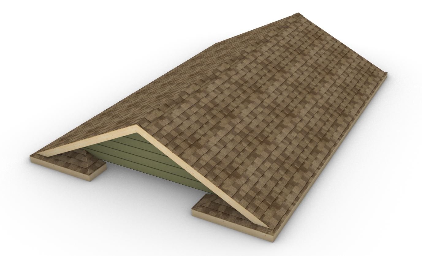

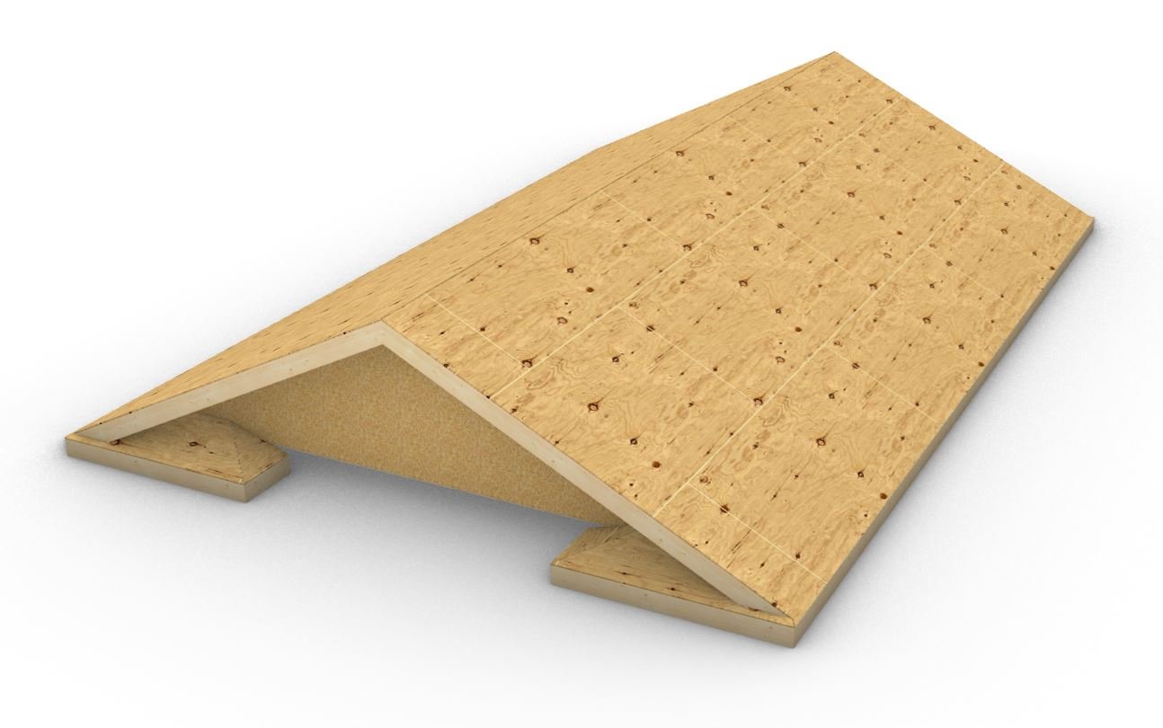

Medeek Posted August 16 Author Share Posted August 16 He is a first look at gable wall cladding in Rhino: truss_RH691507×826 128 KB The Rhino port is slowly coming together. The goal is to get all of the advanced options enabled for common trusses, then add in the rest of the common truss configurations. At that point I will probably release the initial 0.9.5 Version (Windows only). Then, based on the traction I receive in the Rhino community, I will continue to port the rest of the extension over from SketchUp. Link to comment Share on other sites More sharing options...

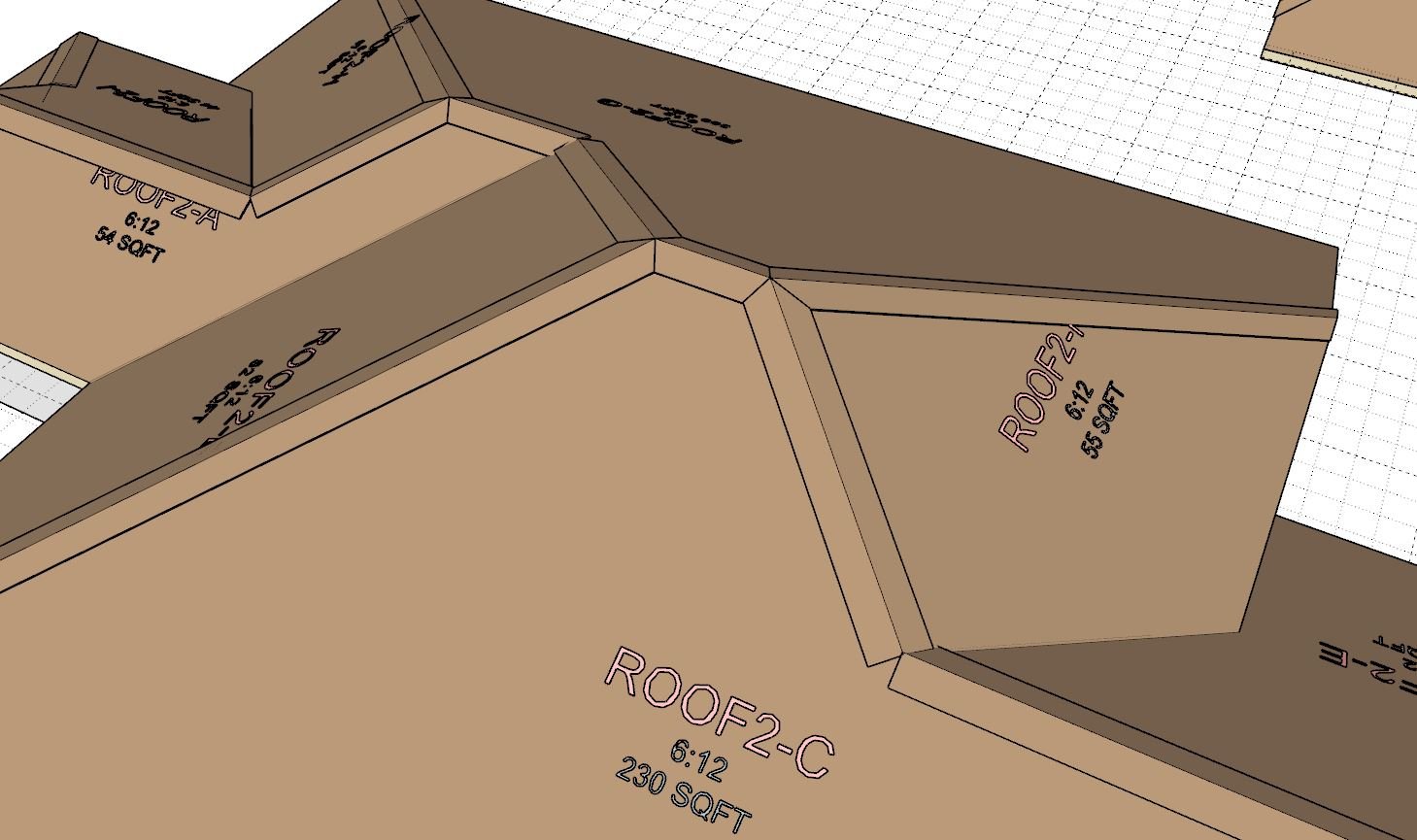

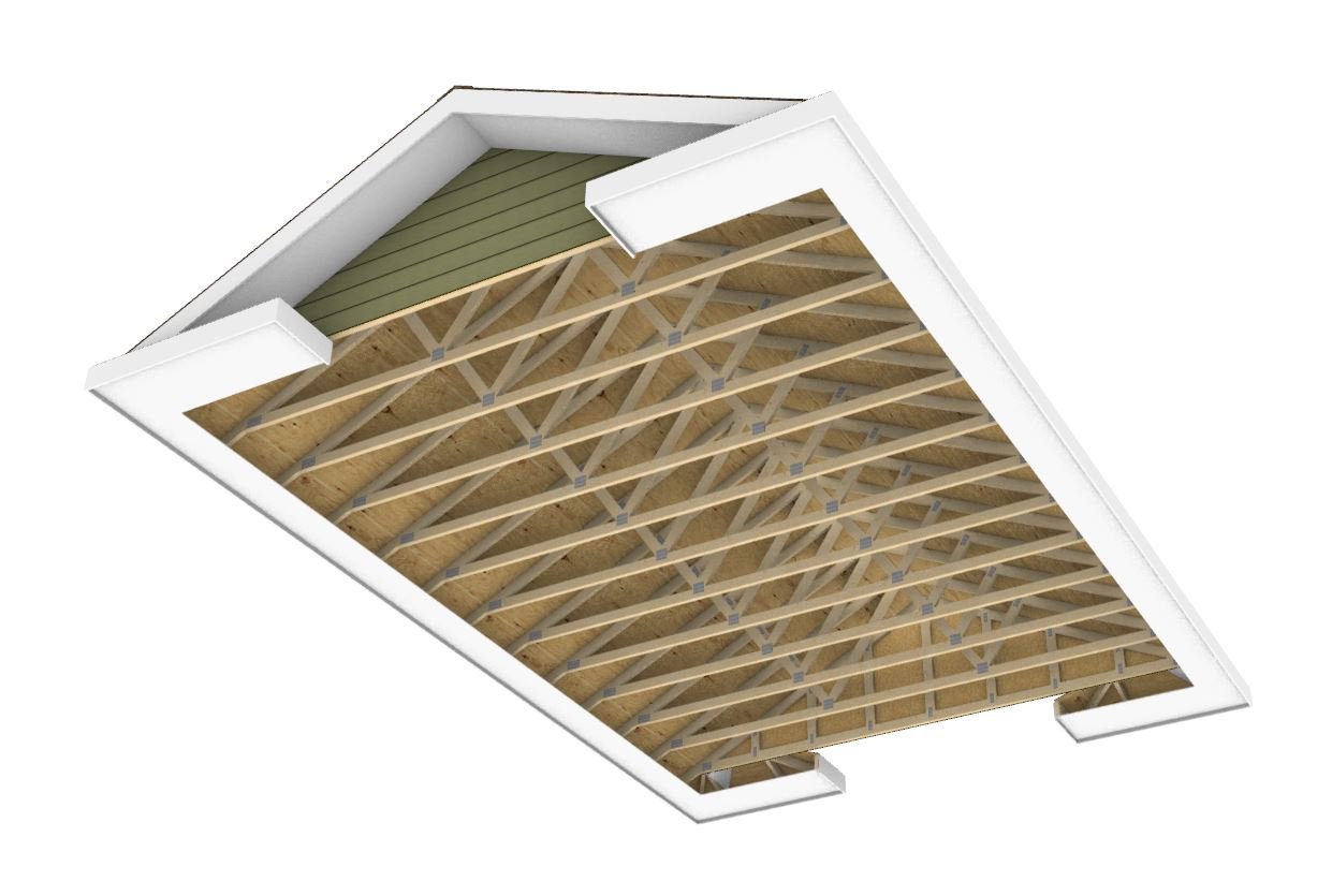

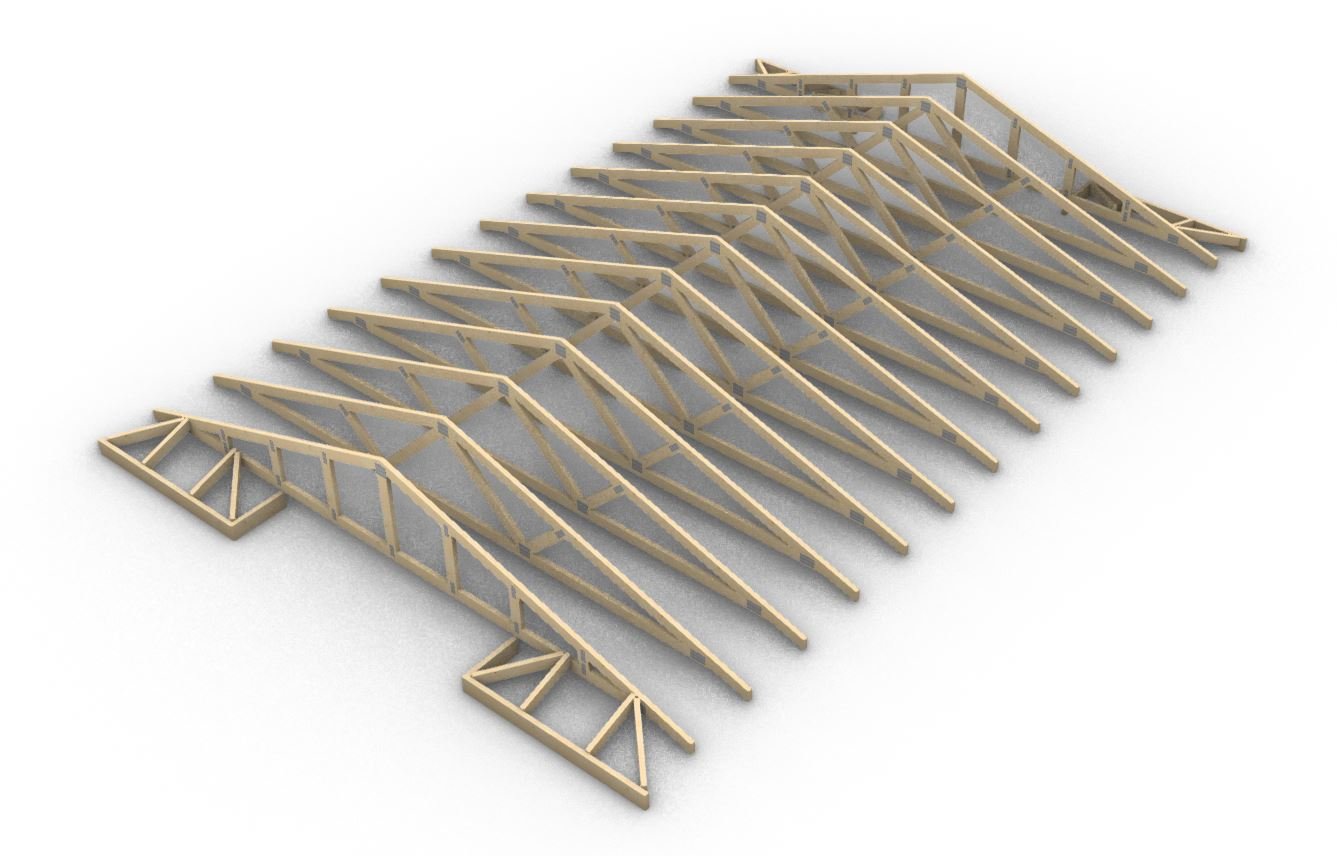

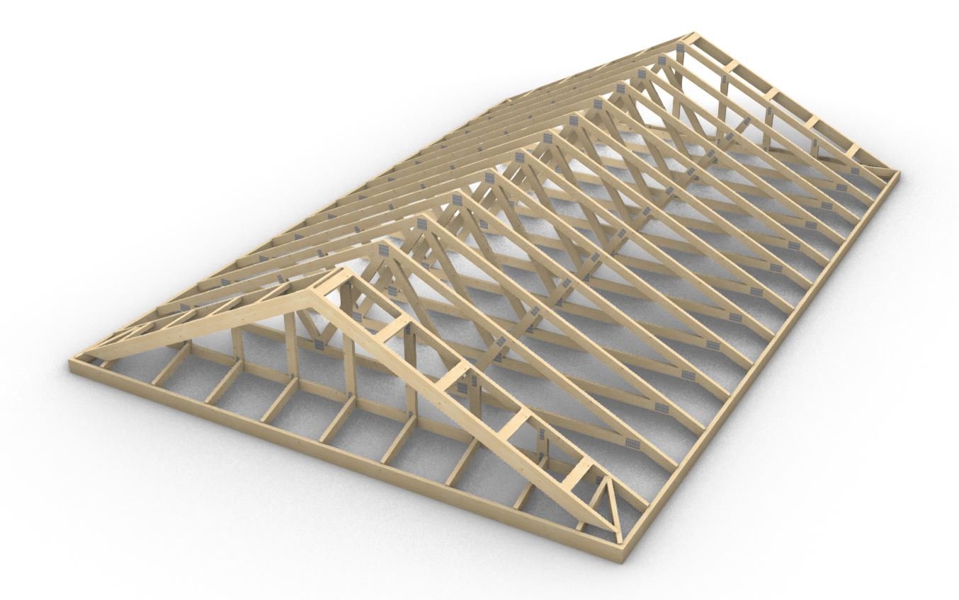

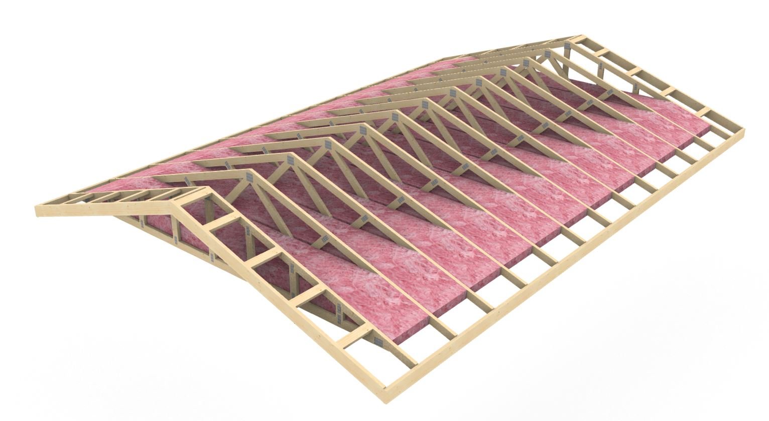

Medeek Posted August 16 Author Share Posted August 16 A few more screenshots of the Rhino 8 development: Link to comment Share on other sites More sharing options...

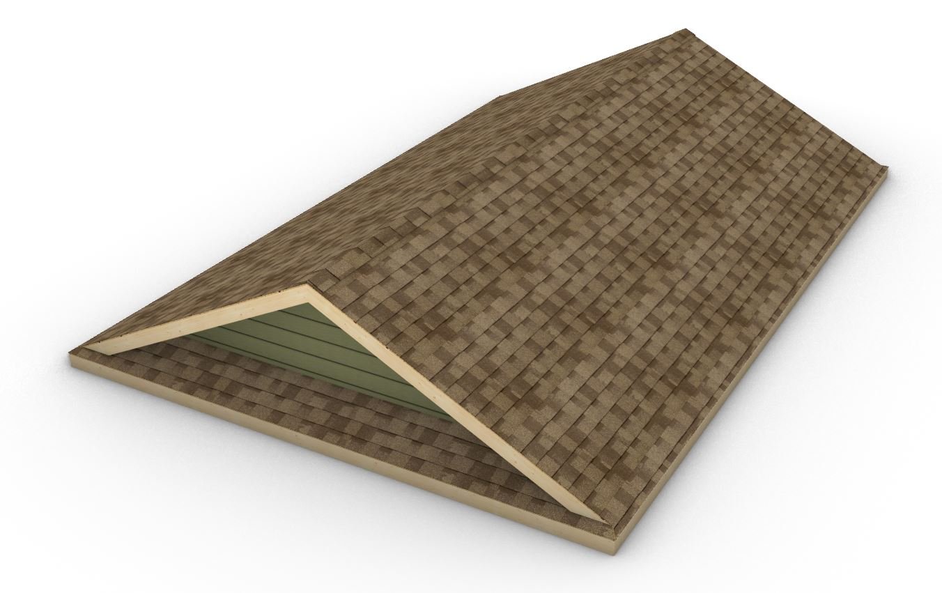

Medeek Posted August 16 Author Share Posted August 16 First look at some roof returns in Rhino: Link to comment Share on other sites More sharing options...

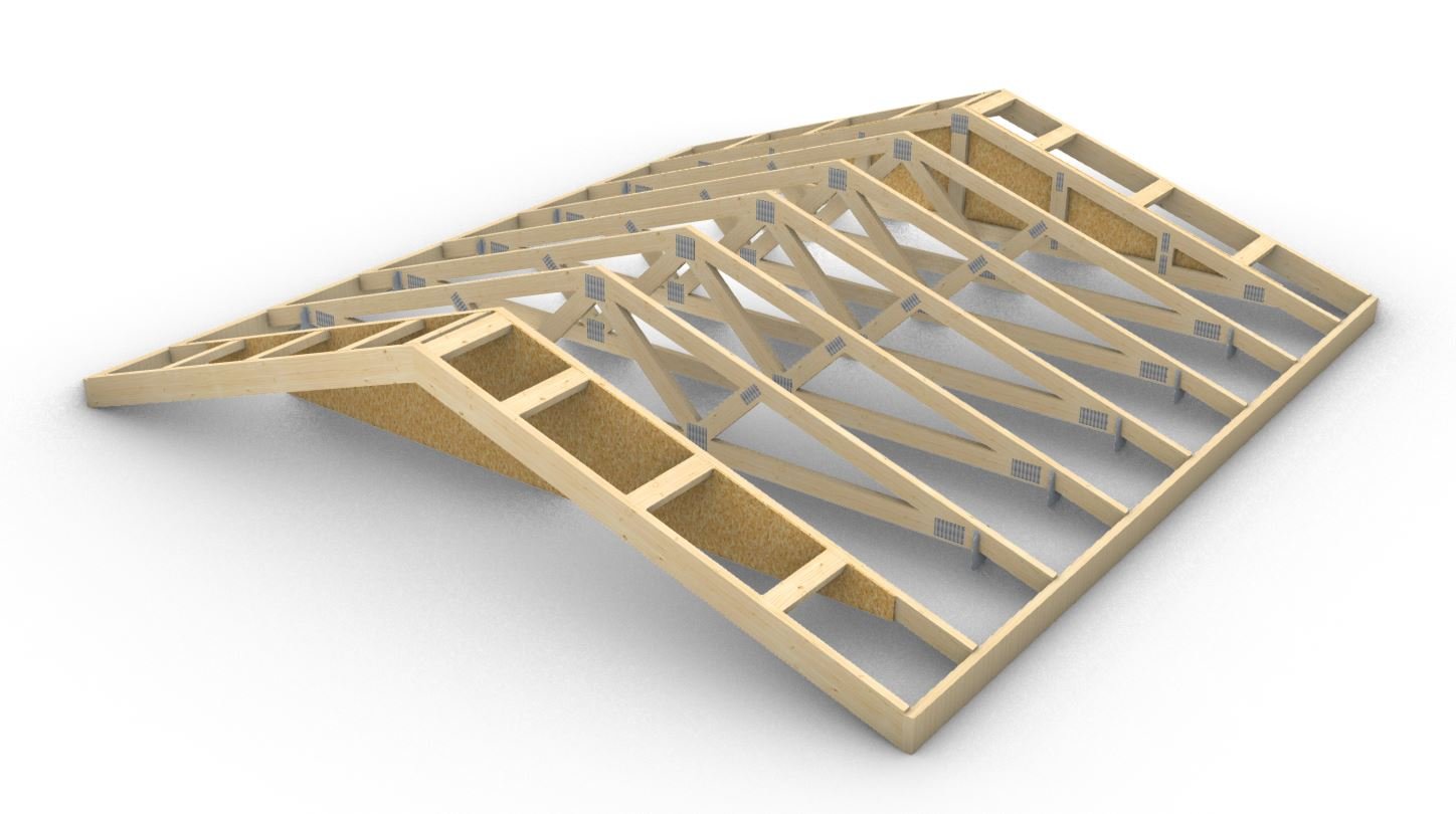

Medeek Posted August 18 Author Share Posted August 18 I’ve released the first BETA version of the Rhino extension (Version 0.9.5 - 08.18.2026). Please note that only common truss types (ie. King Post, Queen Post, Fink, Howe) can currently be drawn with the extension. The web page is posted here for more information: https://design.medeek.com/resources/medeektrussplugin_rhino.html You can also download the 30 day trial at this link (Windows only): https://design.medeek.com/rhino/medeek_truss_rhino.zip Tomorrow I will begin work on the MacOS version of the extension. I will also proceed to port over more truss types in the next few days and eventually we will get to rafter roofs, hip sets and complex roofs. Link to comment Share on other sites More sharing options...

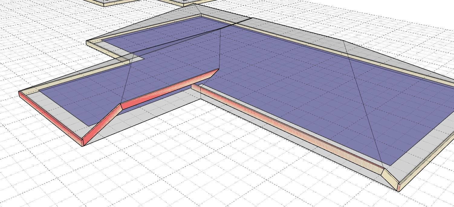

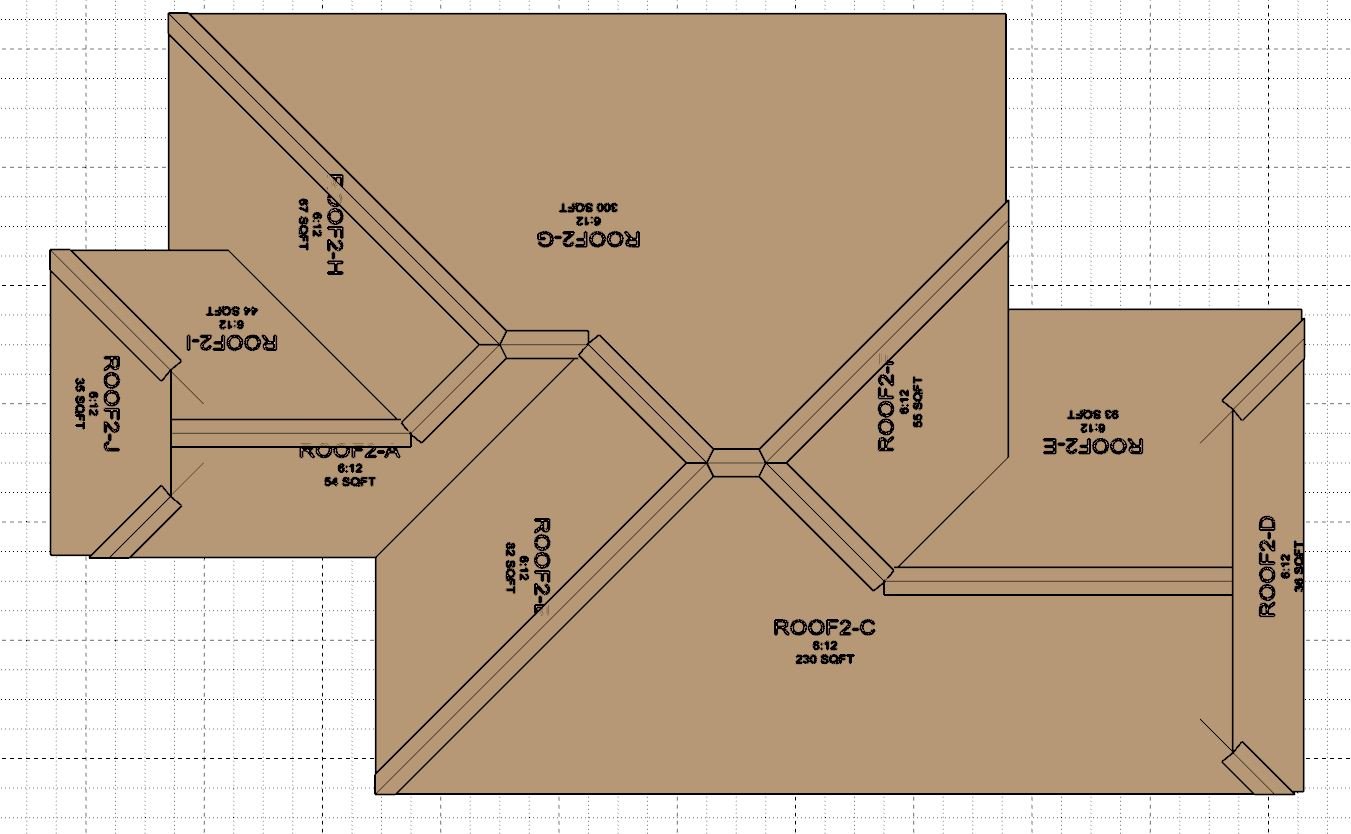

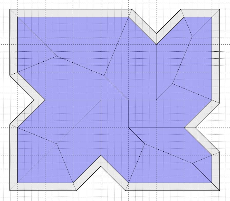

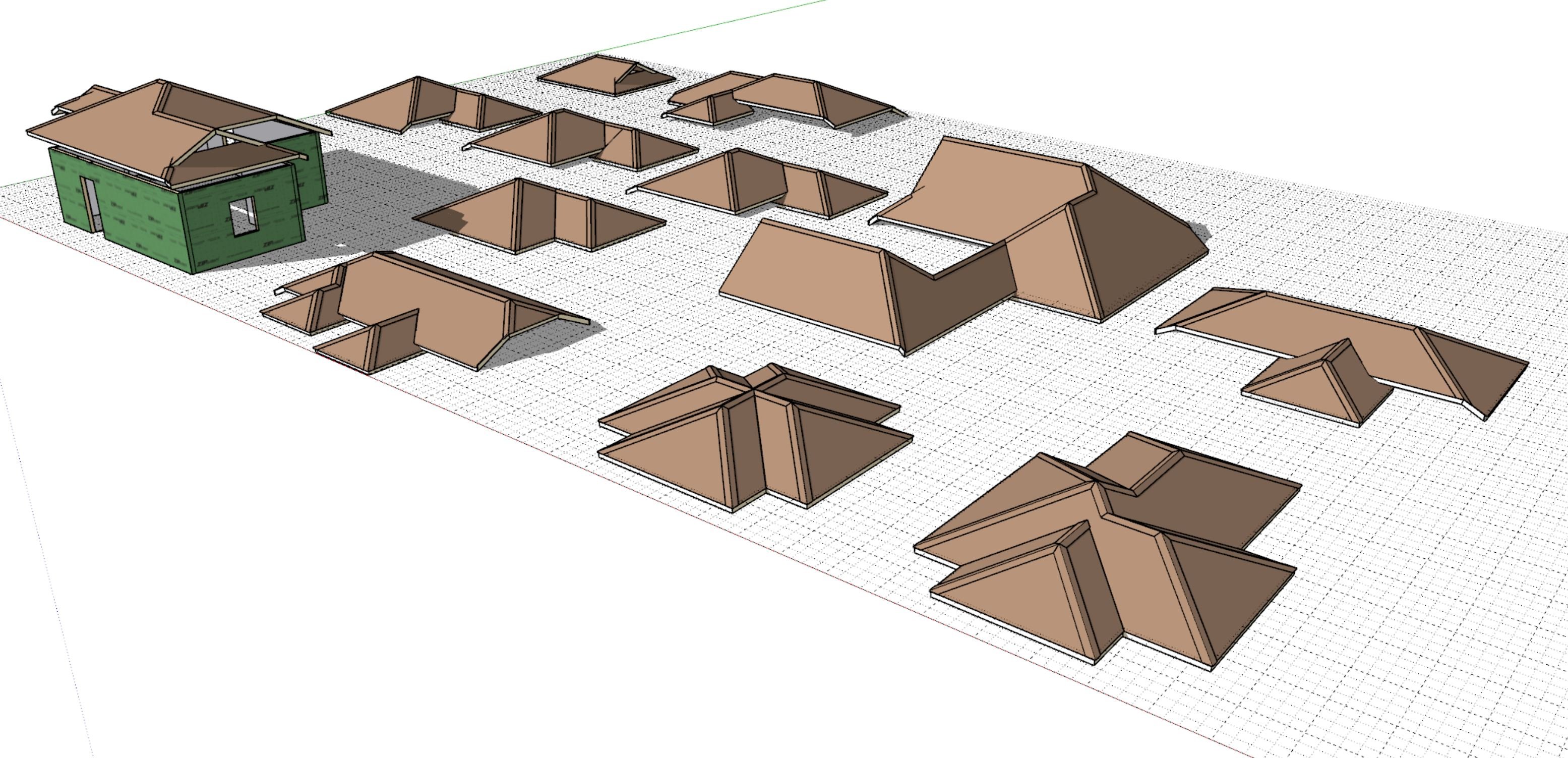

Medeek Posted August 20 Author Share Posted August 20 (edited) Version 3.8.4 - 08.20.2026 - Added an advanced (weighted skeleton) solver for complex roofs. Note that I have retained the "Legacy" solver for now. When you draw or edit a complex roof you will now have an additional parameter which will allow you to choose the solver or primitive engine. I've tested the new solver with well over 50+ roof configurations however I'm sure a few cases will sneak through. Both solvers should yield the same result but if they do not please report that information to me via email (nathan@medeek.com). The new solver is what is called a "weighted straight skeleton". It uses wavefront propagation. It is the "proper" way to solve a complex roof. The legacy method used a system of boolean subtractions to carve out the complex roof organically from an initial prismatic solid. Overall the legacy method is pretty good however there are certain oddities or roof geometries that will foul it up, hence the need to develop the more advanced method. Edited August 23 by Medeek Link to comment Share on other sites More sharing options...

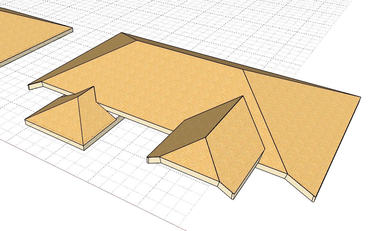

Medeek Posted August 23 Author Share Posted August 23 First look at some interesting roofs with the algorithm actually putting the sub-fascia where it belongs. Link to comment Share on other sites More sharing options...

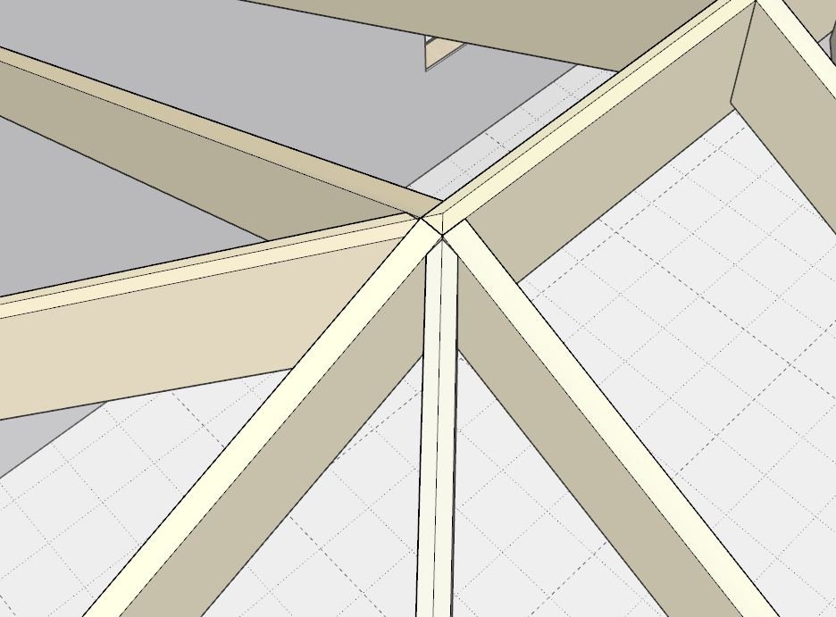

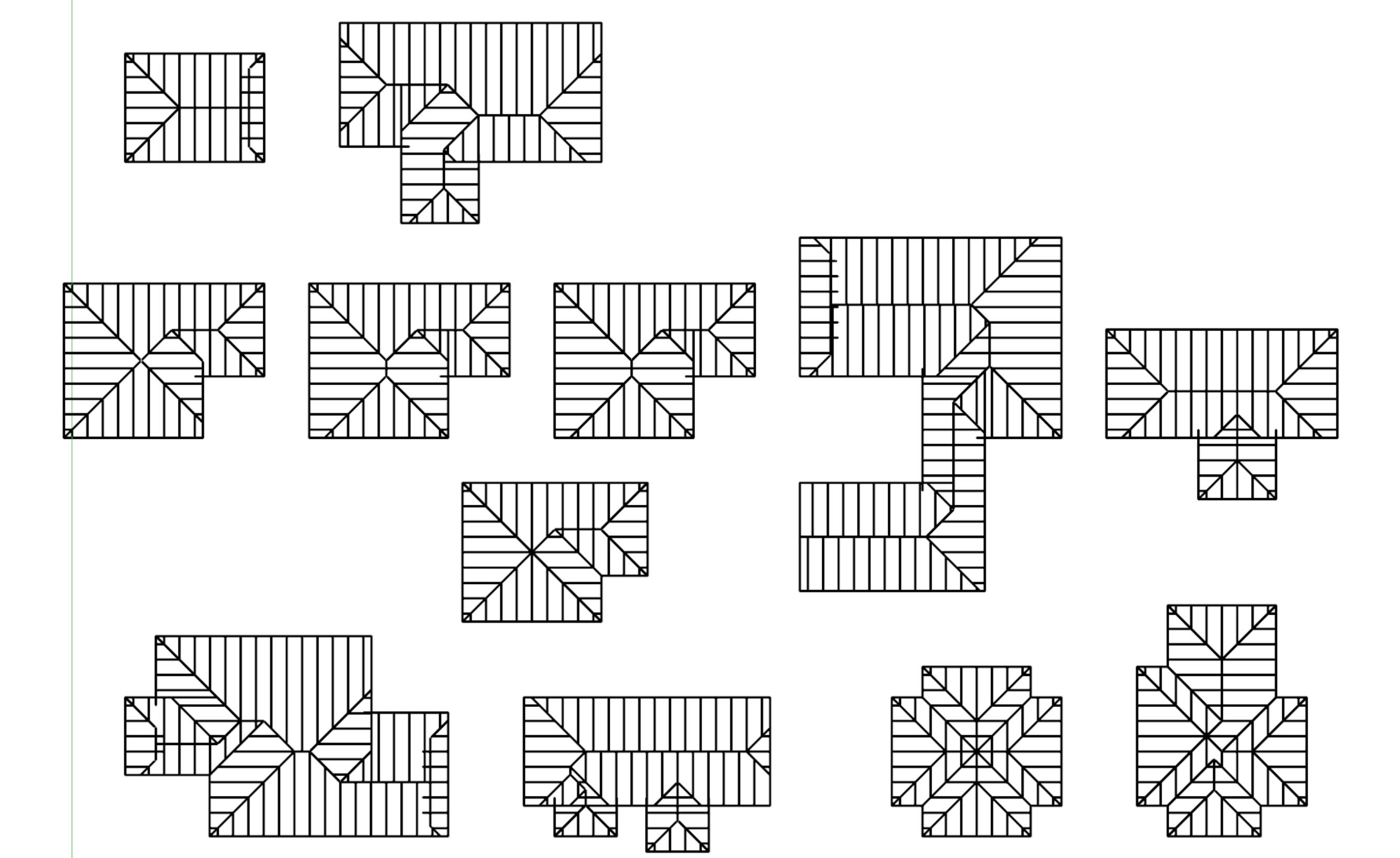

Medeek Posted August 27 Author Share Posted August 27 I’m now turning my attention to the hip & ridge caps. This has actually never been fully developed for complex roofs. I had gotten about half way into it and then Covid hit in Mar. 2020 and disrupted some of my development tracks. I went back into my code and found where I had left it disabled but mostly functional. My previous way of mathematically calculating the cap terminations worked well for simple deterministic roofs. However my new algorithms are more general and work off of the topology itself and therefore should be more robust and actually easier to generate. Sometimes you just need to look at a problem with a fresh set of eyes. Link to comment Share on other sites More sharing options...

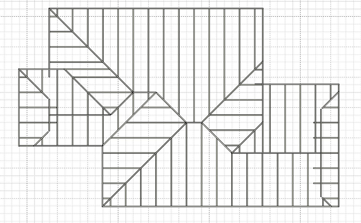

Medeek Posted August 30 Author Share Posted August 30 (edited) Version 3.8.5b - 08.30.2026 - Fixed a bug in the gutter module for complex roofs with discontinuous fascia lines. - Fixed a bug in the primitive generation step for complex roofs. - Improved the rafter framing algorithm for complex roofs using the advanced primitive solver (weighted straight skeleton). When you have framing enabled it should now take about half as long to edit or regen a roof. This should be a significant performance increase when using the new advanced solver (which invokes) the new framing logic. Additionally the common rafters at a RHH junction were being over trimmed previously. That should now be resolved. At this point I highly recommend using the new advanced primitive solver. I've kept the legacy solver for now, just in case, but at this point it probably makes more sense to use the new solver and take advantage of the performance improvements and framing corrections. I'm also super excited that I have somehow been able to enable hip & ridge for complex roofs. I hit a real roadblock previously on this feature but it turns out it was actually not as difficult as I had thought it was. It just took a slight different approach. Edited August 30 by Medeek 1 Link to comment Share on other sites More sharing options...

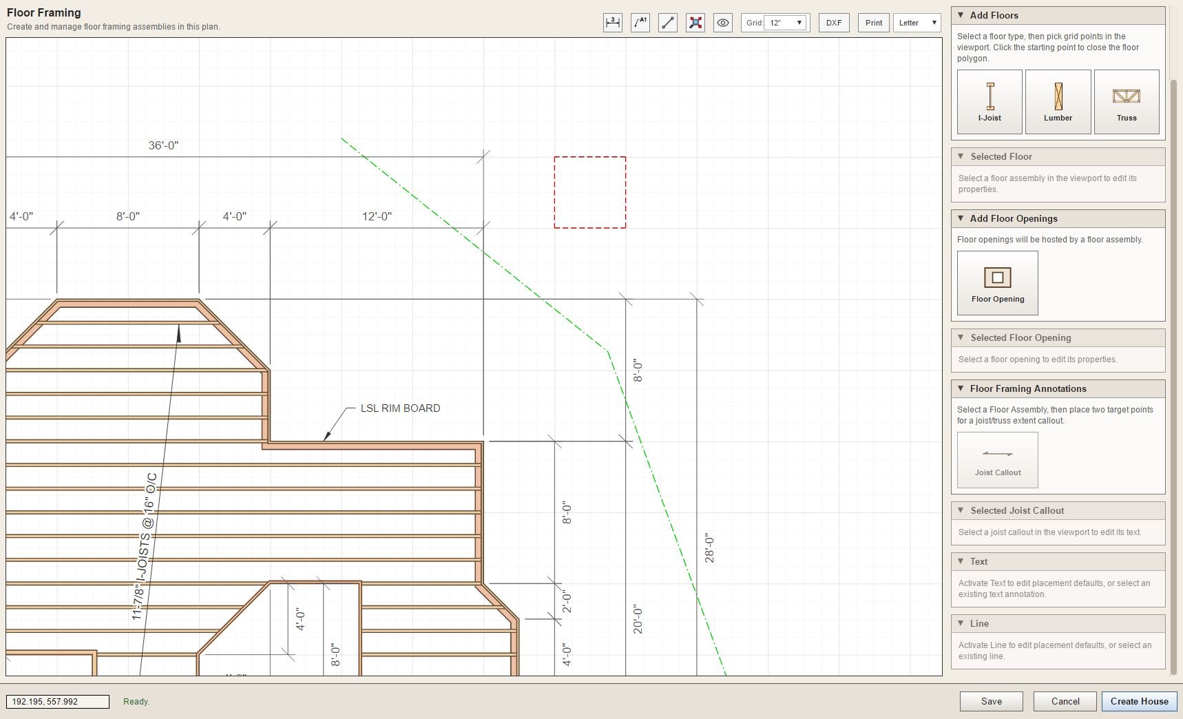

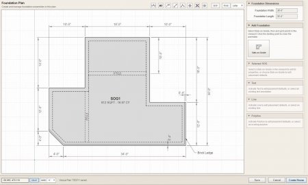

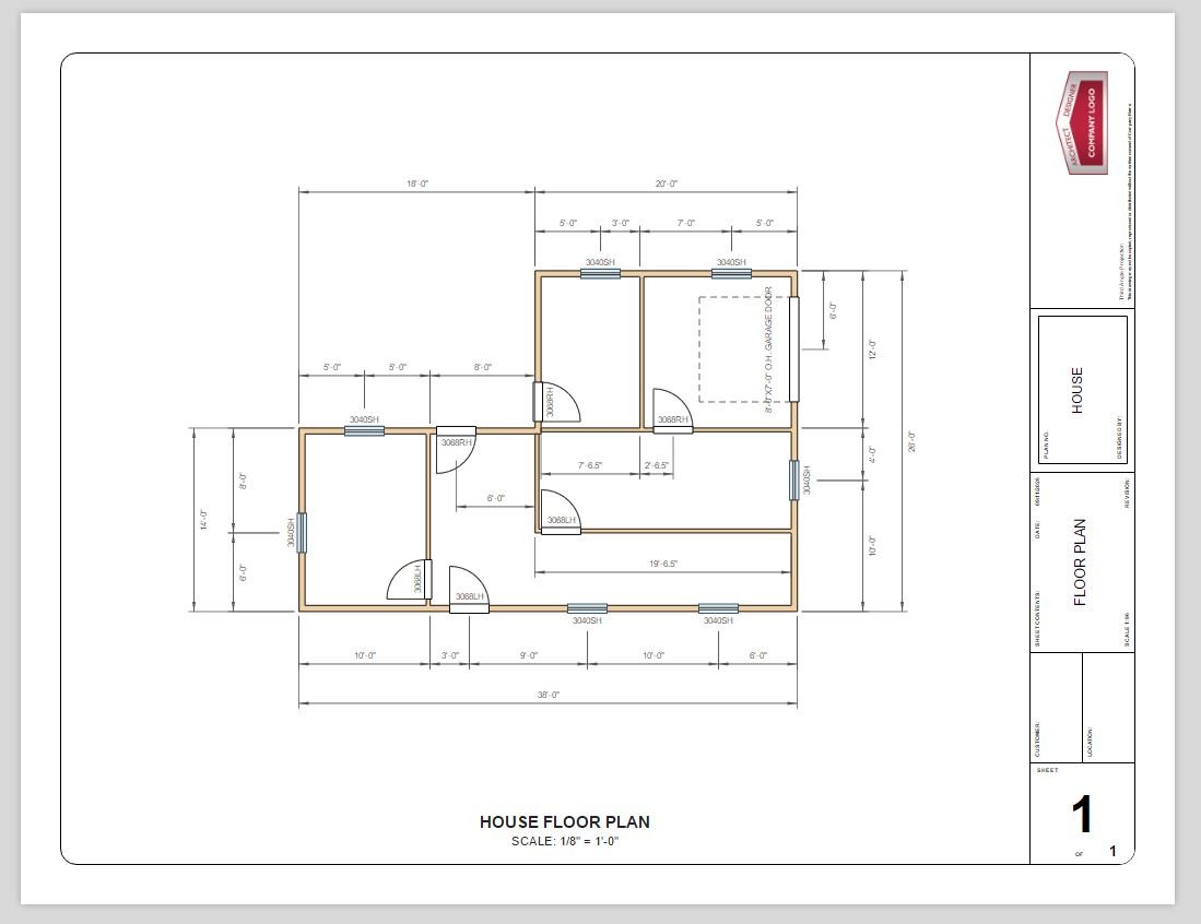

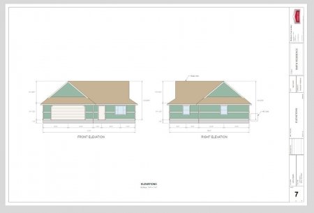

Medeek Posted September 4 Author Share Posted September 4 From the get go the Garage Builder was a proof of concept, and it does seem to work reasonably well. However, I'm now contemplating creating a slightly more complicated version of this tool called the House Builder. I will probably initially not include the roof or foundations for the first iteration and primarily focus on the wall layout engine (that is what is most important). Thoughts? Is there any interest for such a tool? In some way it may resemble what Chief Architect does, you create your layout in 2D, fully dimensioned and then like the Garage Builder it can with the push of a button translate that into a full 3D model on demand. The current algorithms that produce the DXF or printed drawing (PDF) will need to be further developed and augmented so that we can auto-dimension a much more complex floor plan, this should become very interesting. The goal is to be able to create, at a minimum, something like this in the House Builder tool: I've also been giving the auto-dimensioning some serious thought and even as attractive as this may seem, there will always be cases where the user will need to manually intervene and add or subtract dimensions. So I will need to build some sort of user driven dimensioning system that will allow manual override but somehow coexist with a fully automated dimensioning system. In addition to dimensions we will also need to enable some sort of annotation system with text blocks and text with leaders (this is giving me AutoCad vibes). This in and of itself is a full on project, we may have to take this in stages. Link to comment Share on other sites More sharing options...

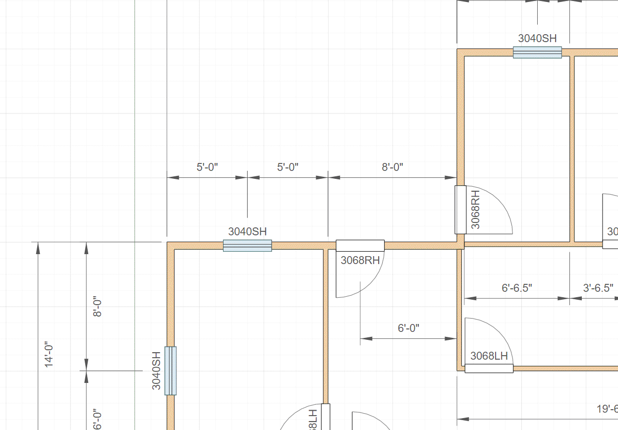

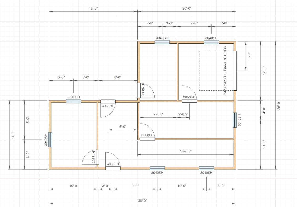

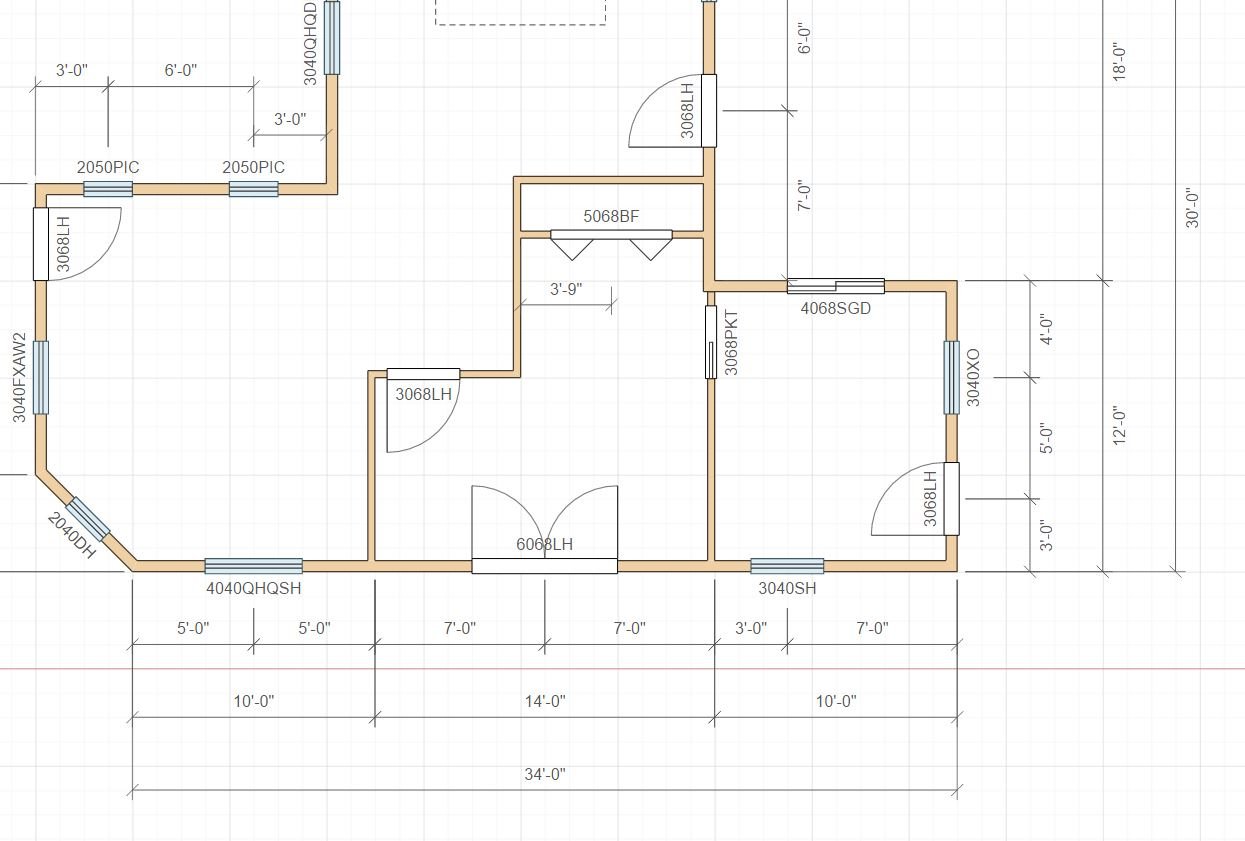

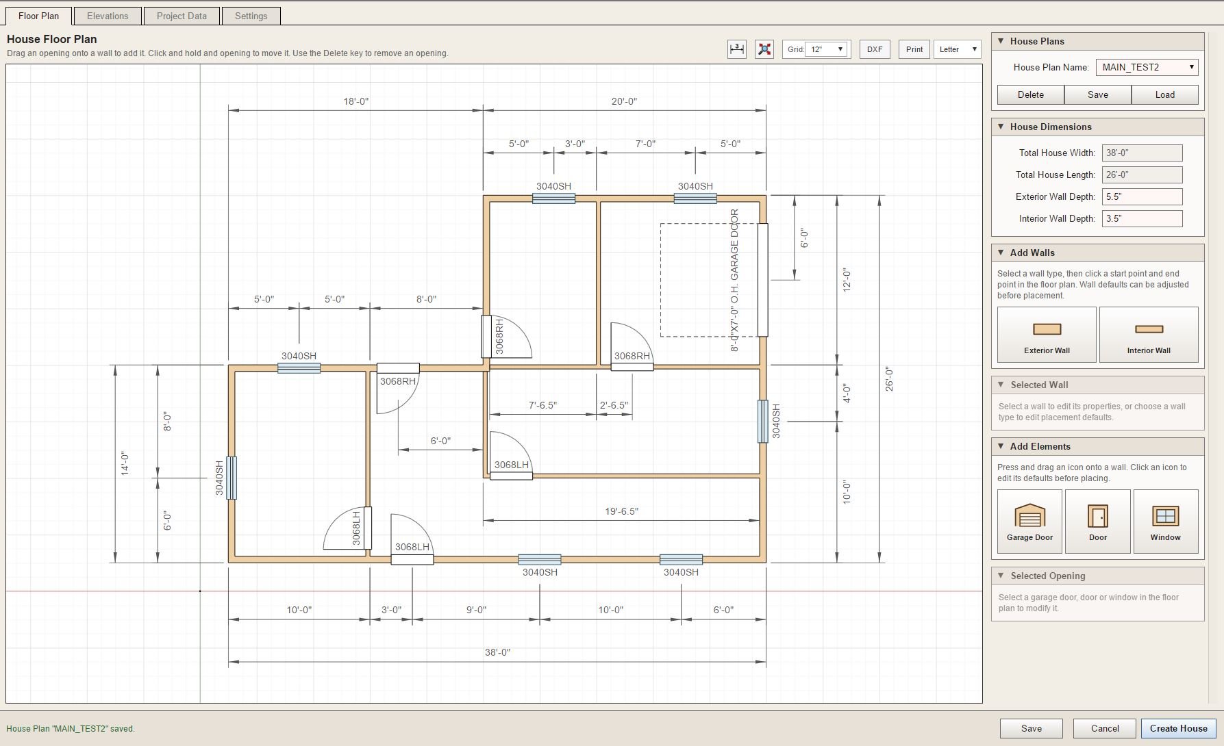

Medeek Posted Saturday at 08:12 AM Author Share Posted Saturday at 08:12 AM First look at some walls with dimensions added: I was going to setup an auto-dimension algorithm. However after building the manual dimension tool I found it so easy to use that I don't really see a reason to bother with auto dimensioning. What you see here I was able to do in about 2-3 minutes. 1 Link to comment Share on other sites More sharing options...
para-CAD Posted Saturday at 08:54 AM Share Posted Saturday at 08:54 AM Very nice! I have seen a de facto standard arise in some people's dimensioning where the outermost line is for overall. Then the next line closer to the building is for wall offsets. And then the third line is for the center of openings. So they use a three-line dimension system. I'm sure there's people that would use four lines, so even though automatic dimensions may not be needed, it would be nice if there were user set distances away from the house that you could snap these different types of dimensions to so that they look as good as the ones in your example images. 1 Link to comment Share on other sites More sharing options...
Medeek Posted Saturday at 04:47 PM Author Share Posted Saturday at 04:47 PM (edited) I still have some rough edges to work on in the UI but progress is being made: All dimensions are associative, there is no concept of an orphaned dimension, however I may eventually change my mind on that. The nice thing about associative dimensions is that when you change the location of a wall or opening all of the dimensions auto-update. Additionally the dimensions snap to the grid so it is easy to setup your dimensions and keep them all aligned as para-CAD has noted. Edited Saturday at 04:52 PM by Medeek Link to comment Share on other sites More sharing options...
Joe_Carrick Posted Saturday at 06:48 PM Share Posted Saturday at 06:48 PM Often we dimension to the centerline of interior walls. There should be an option for that and also notation of C/L 1 Link to comment Share on other sites More sharing options...
Joe_Carrick Posted Saturday at 06:49 PM Share Posted Saturday at 06:49 PM Arrow style is also desired. Slash filled dot etc 1 Link to comment Share on other sites More sharing options...
Medeek Posted yesterday at 02:36 AM Author Share Posted yesterday at 02:36 AM Duly noted. I will look into the arrow head style and the dimension to centerline of walls (interior). I agree that this is very important. Link to comment Share on other sites More sharing options...

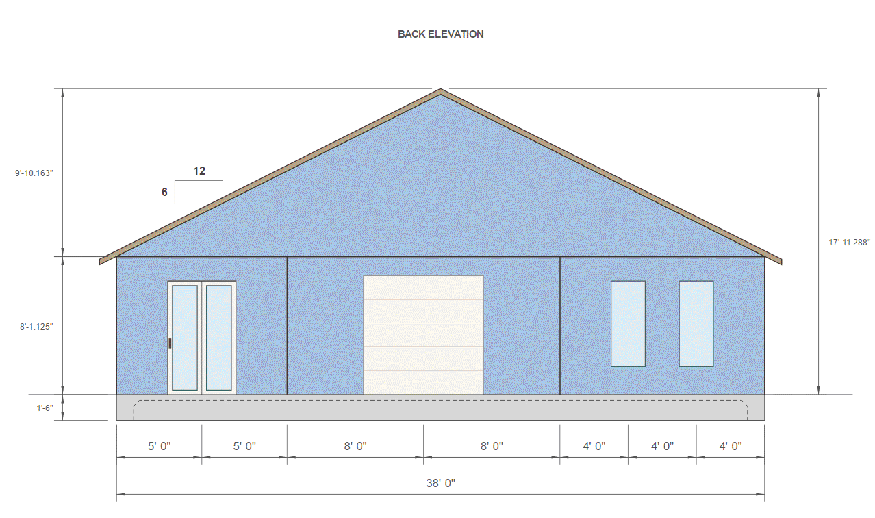

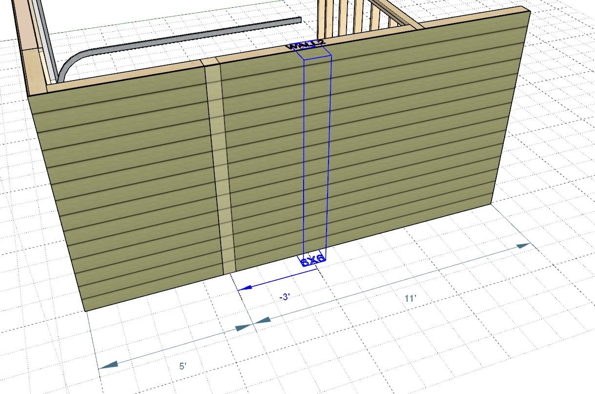

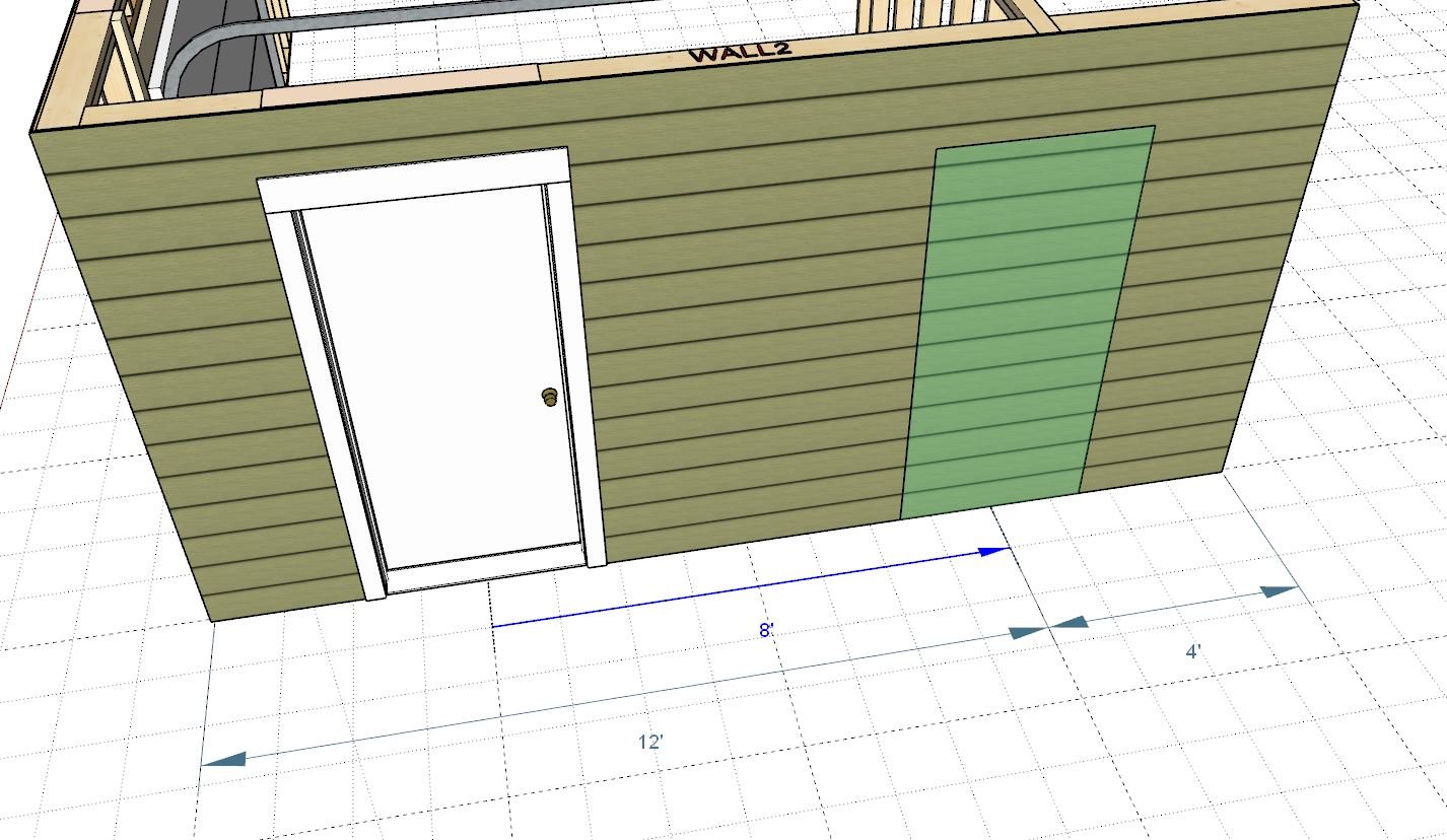

Medeek Posted yesterday at 02:37 AM Author Share Posted yesterday at 02:37 AM I've added the ability to edit, delete and also move openings in walls from the various elevation views: Link to comment Share on other sites More sharing options...

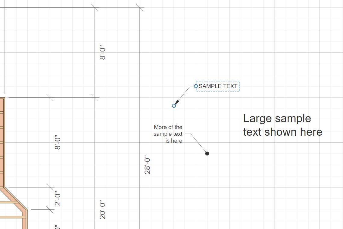

Medeek Posted yesterday at 04:15 AM Author Share Posted yesterday at 04:15 AM We now have a few more options for arrowheads and as you can see the settings tab has grown signficantly. Link to comment Share on other sites More sharing options...
