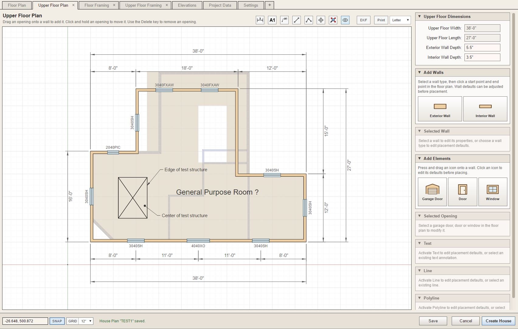

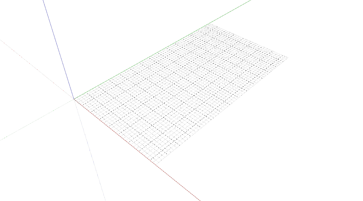

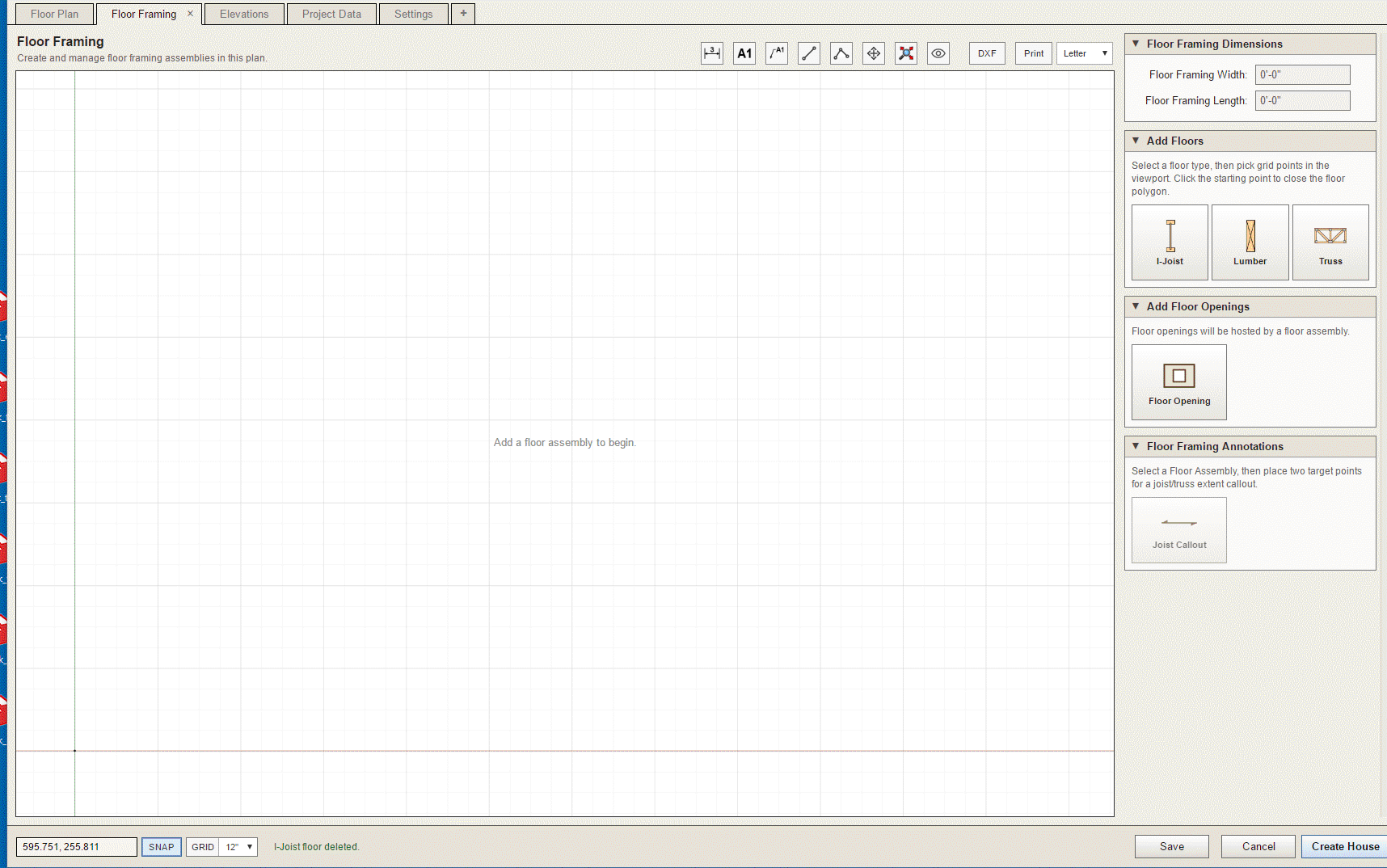

Medeek Posted September 20 Author Share Posted September 20 Testing the reference underlays for the Upper Floor Plan (level 1 wall framing and level 2 floor framing): Link to comment Share on other sites More sharing options...

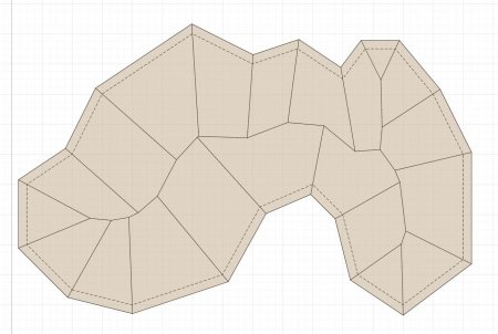

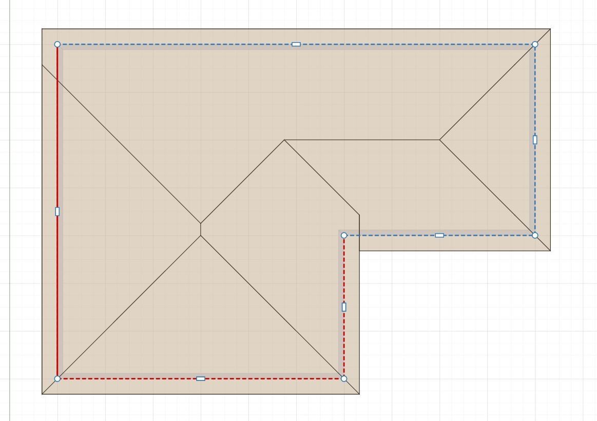

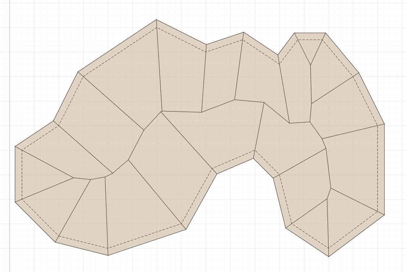

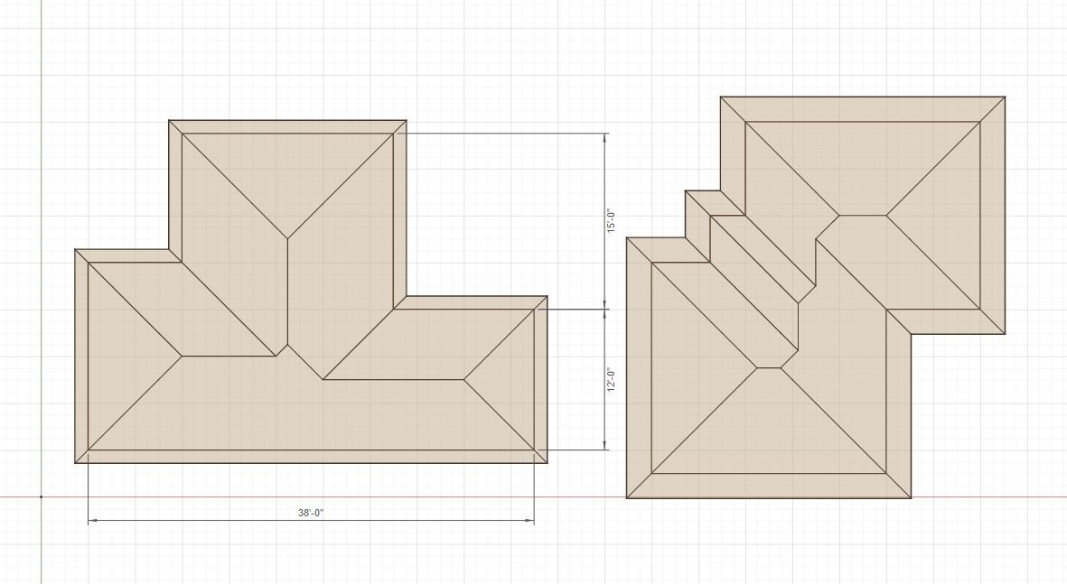

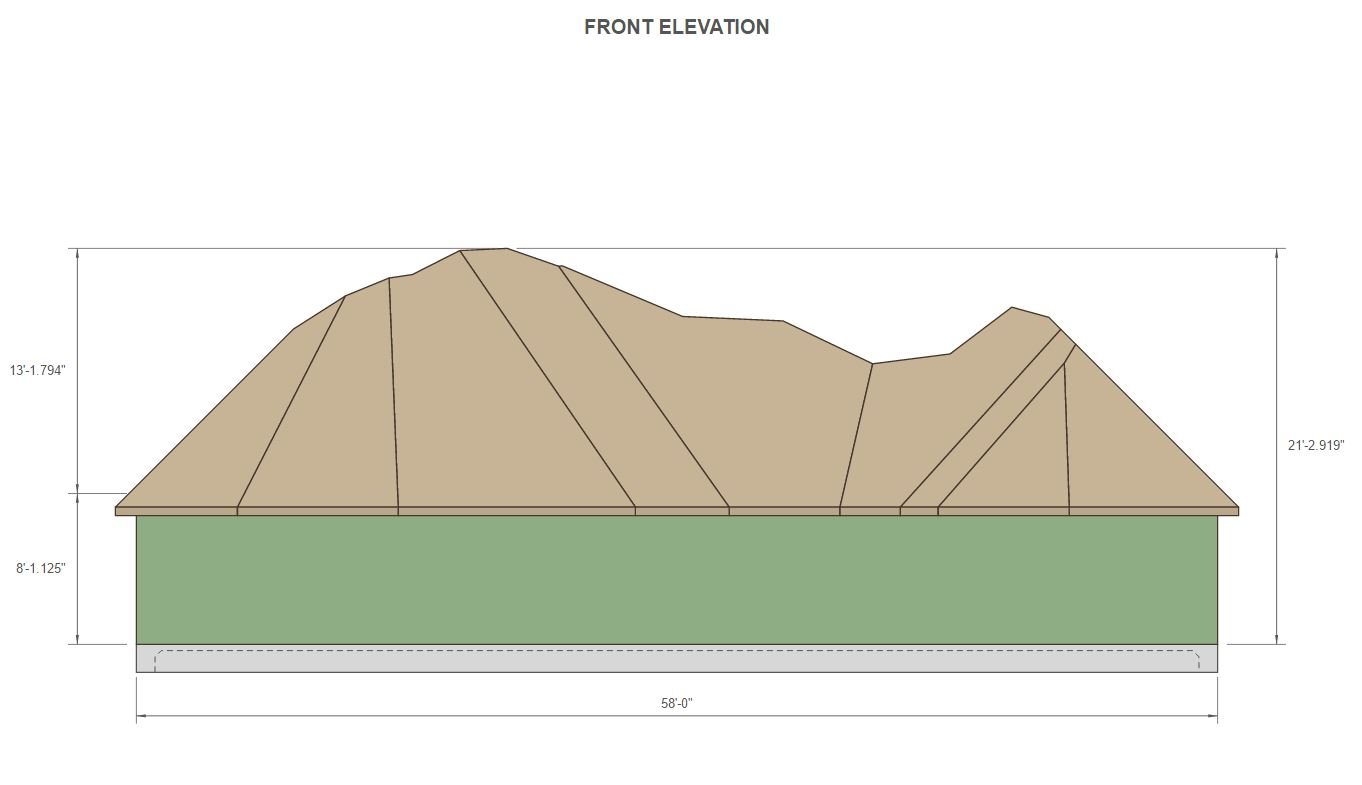

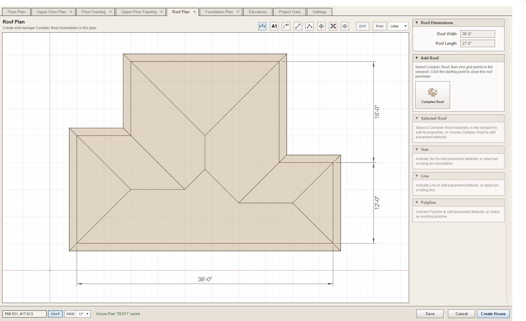

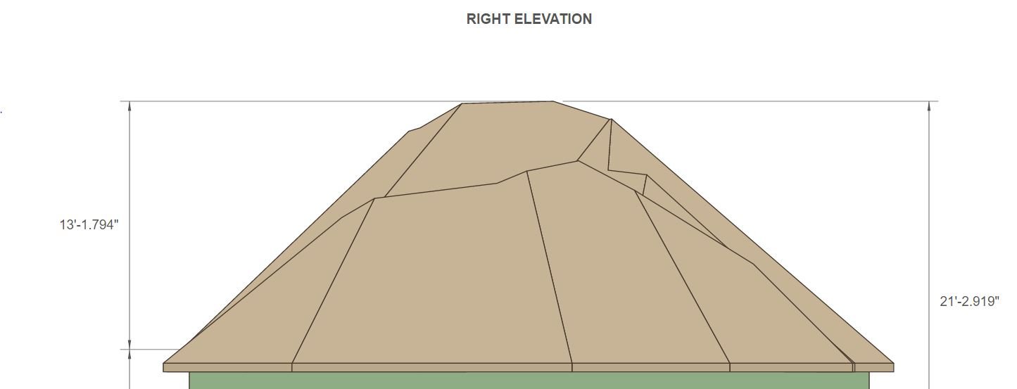

Medeek Posted September 21 Author Share Posted September 21 First look at some complex roofs in the Roof Plan tab: I will need to stress test it further to see if we can break it. The solver algorithm is borrowed directly from the new weighted straight skeleton solver I implemented about a month ago in the Truss plugin, no point in reinventing the wheel. Link to comment Share on other sites More sharing options...

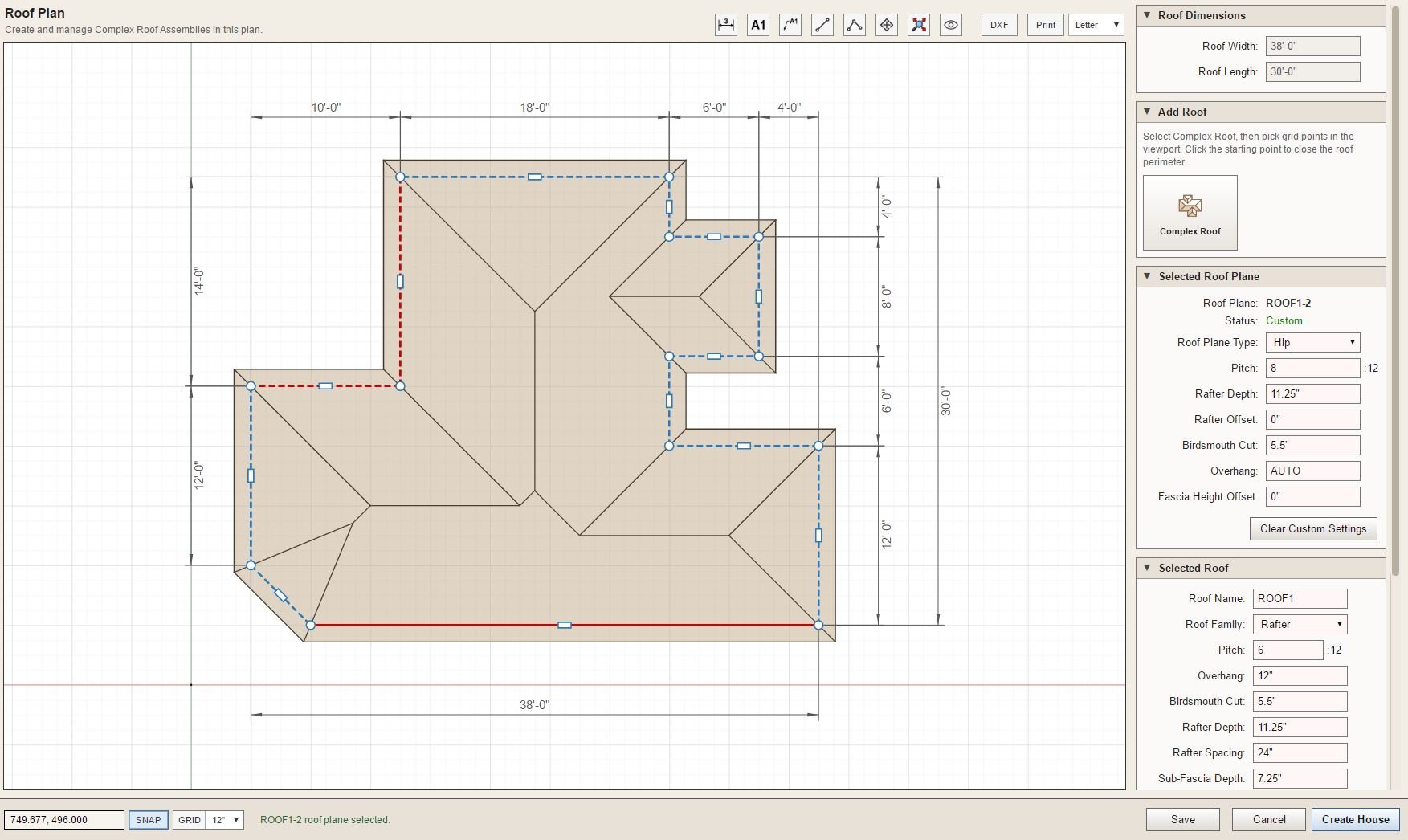

Medeek Posted September 22 Author Share Posted September 22 Complex roofs is still a work in progress, no surprise there. The interface will mirror the Truss plugin since we already know how that works. When a roof is selected the "custom" roof planes (edges) will display in red rather than blue. A selected edge will switch to a solid color and the right hand menu will display the settings for that roof plane. The same settings that are available in the Truss plugin will appear for the selected "roof plane type". Link to comment Share on other sites More sharing options...
Medeek Posted September 23 Author Share Posted September 23 And just for fun: I call this the "Mountain House". A sufficiently motivated framer (lots of money) could stick build this, I'm quite convinced. Link to comment Share on other sites More sharing options...

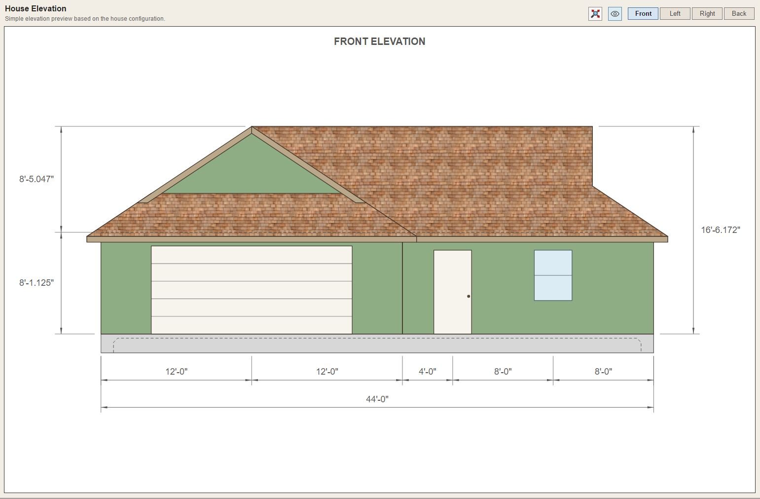

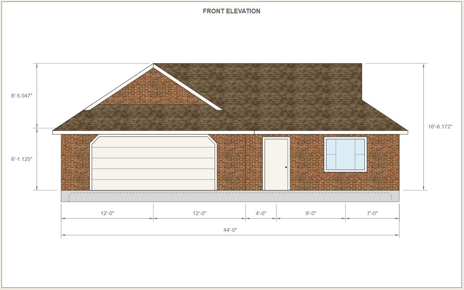

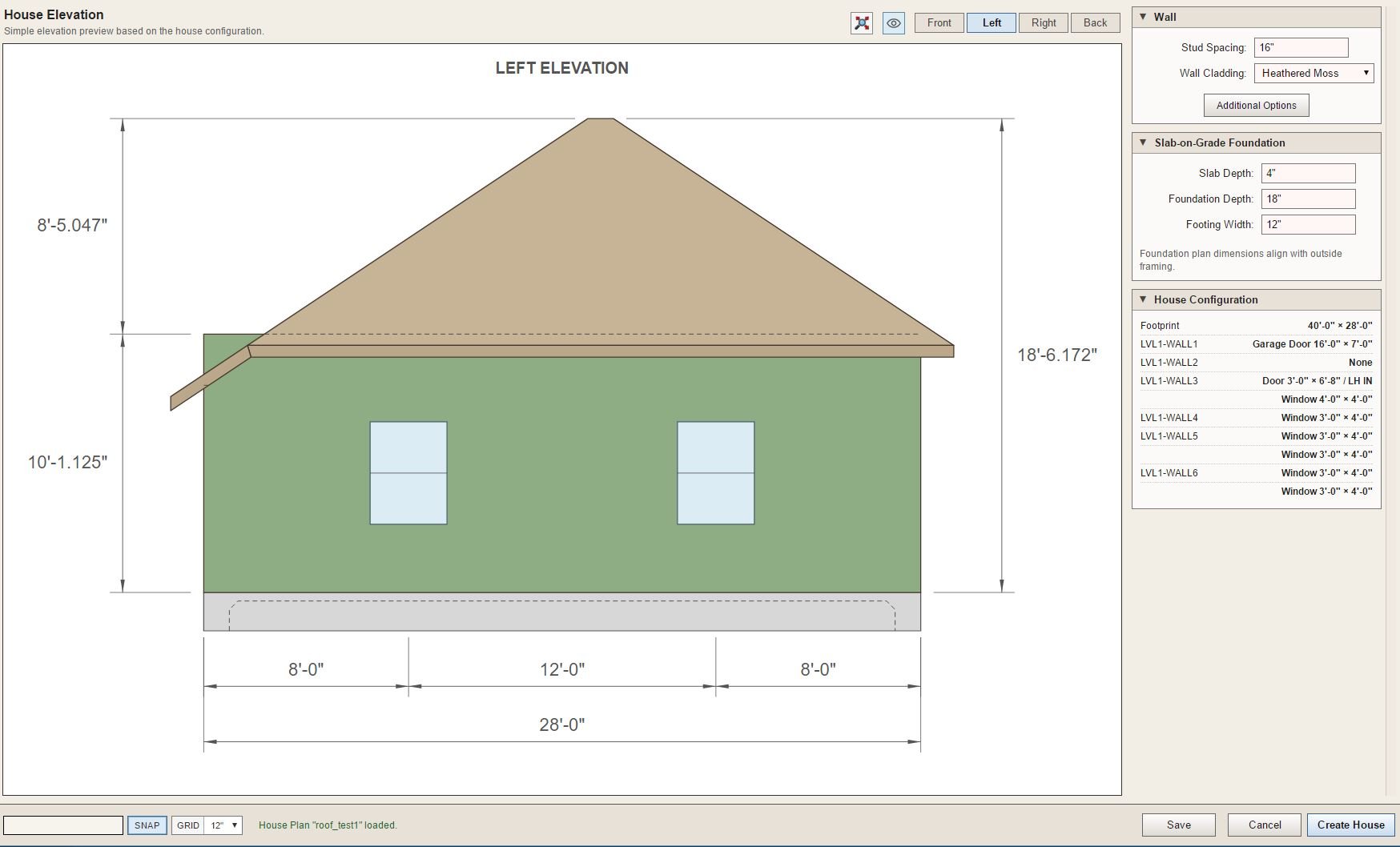

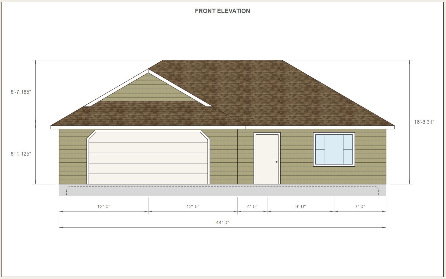

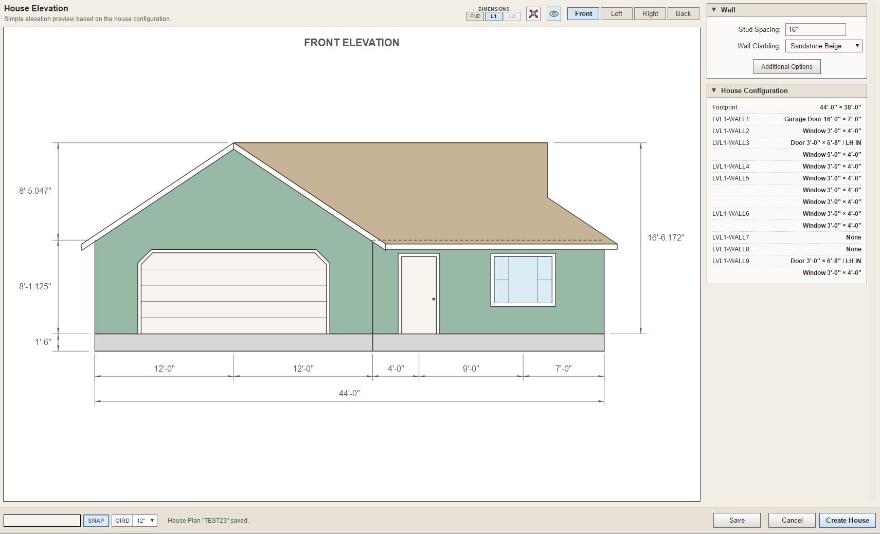

Medeek Posted September 23 Author Share Posted September 23 Next is a test of the raised fascia offset: My question is what do we do in the field at this sort of corner? Link to comment Share on other sites More sharing options...
JonathanK Posted September 23 Share Posted September 23 11 hours ago, Medeek said: My question is what do we do in the field at this sort of corner? Depends...if it's 10' ceiling garage all the way to the back wall, then your higher fascia needs to run all the way around to where the ceiling drops again. So what you're showing is incorrect. If there is a room on the back side of the garage where the ceiling height drops, then what you're showing is correct. 1 Link to comment Share on other sites More sharing options...

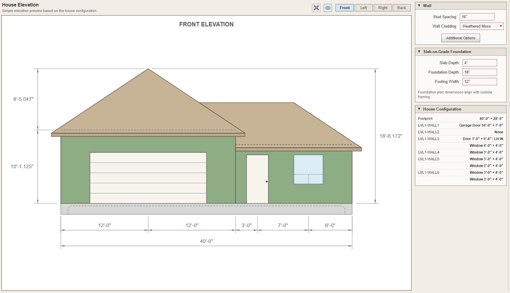

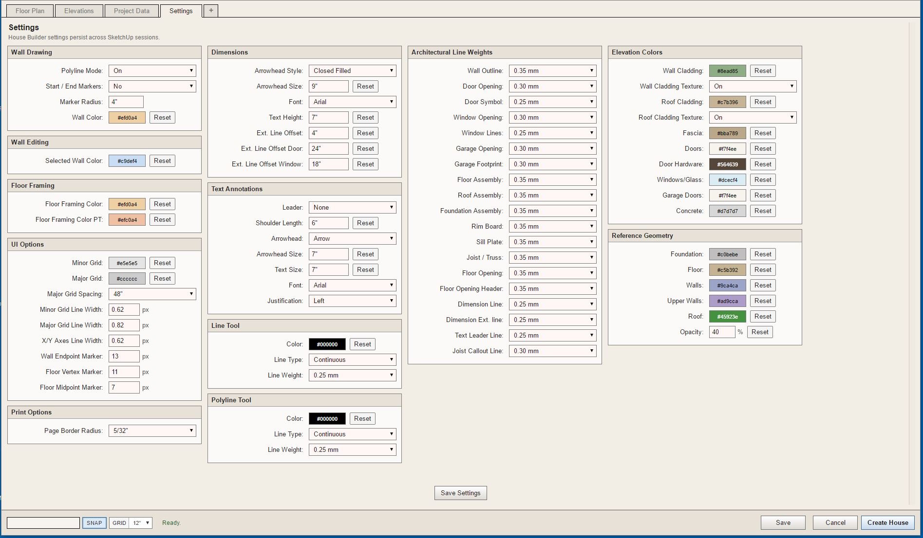

Medeek Posted September 23 Author Share Posted September 23 The user will have the option to use the basic fill colors or the built-in textures. This feature can be toggled ON or OFF in the Settings. 1 Link to comment Share on other sites More sharing options...

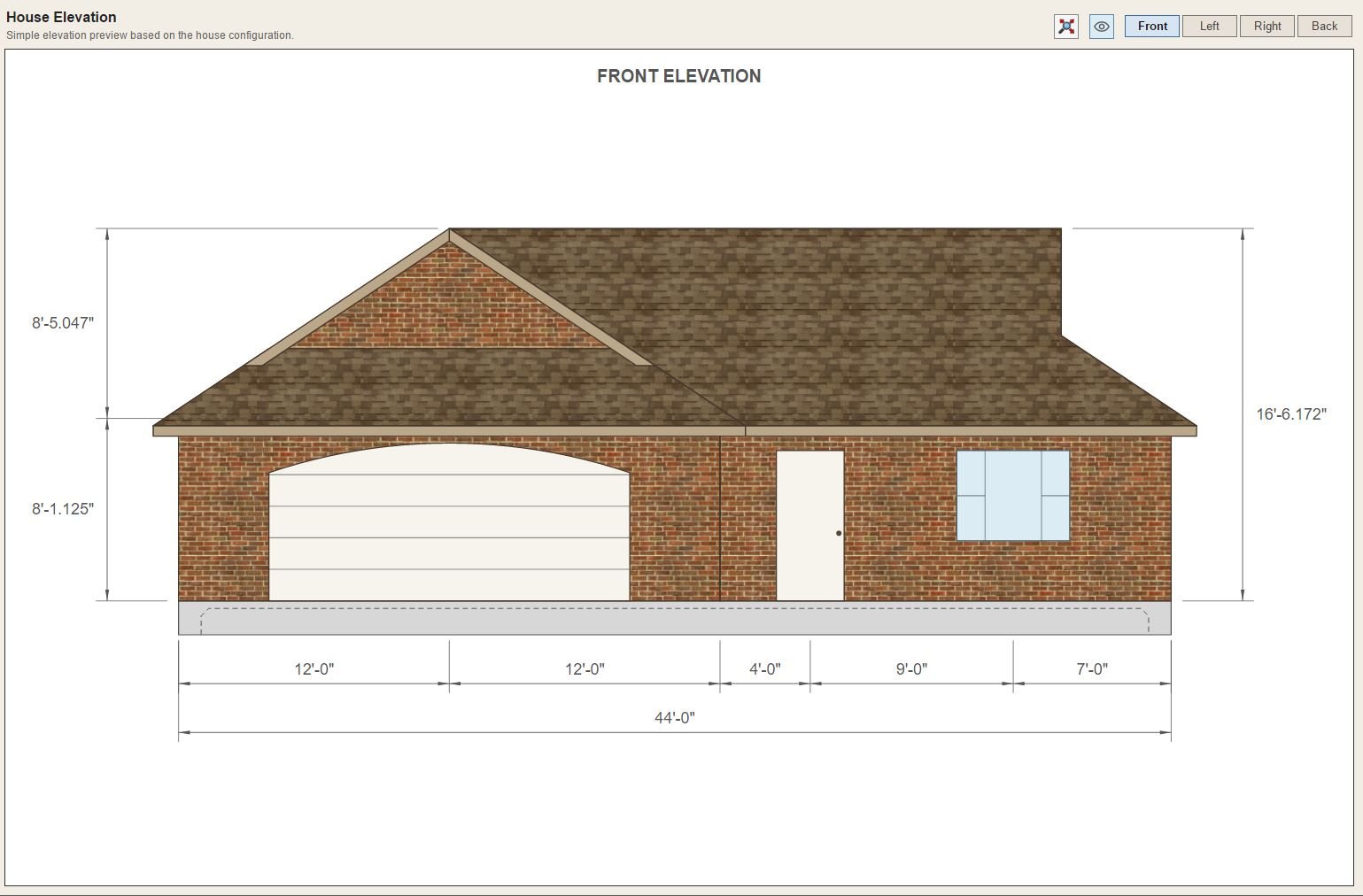

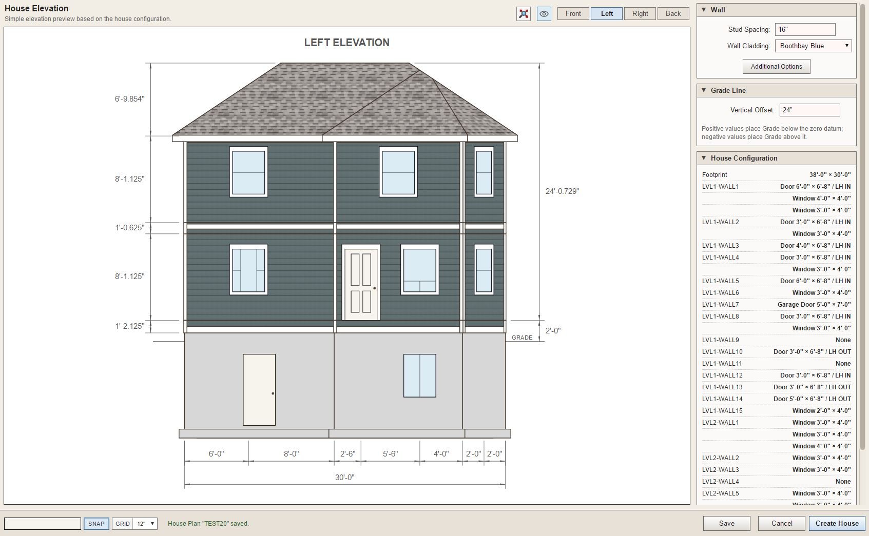

Medeek Posted September 24 Author Share Posted September 24 I haven't exposed all of the options in the House Builder that exist in the plugins, I am trying to keep this as light weight as possible, yet giving the user enough options to make this a viable design tool. To that end, I've enabled exterior trim for all openings: Link to comment Share on other sites More sharing options...

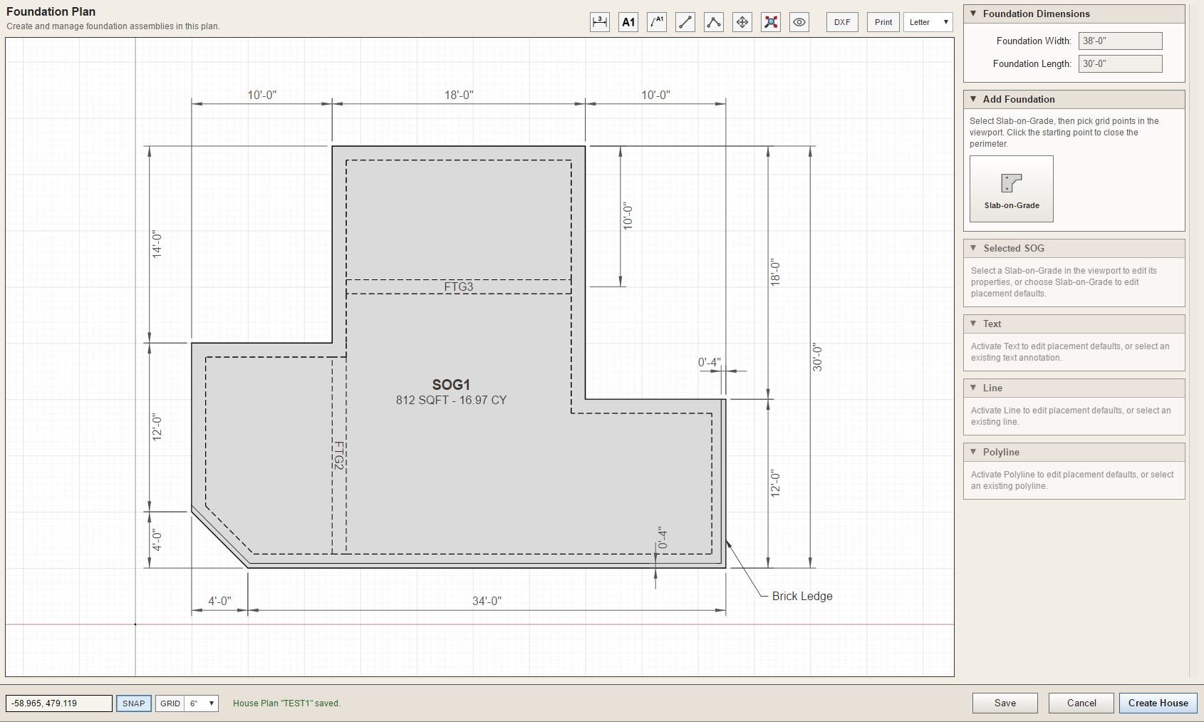

Medeek Posted September 27 Author Share Posted September 27 First look at internal footings within a Slab-on-Grade. Link to comment Share on other sites More sharing options...

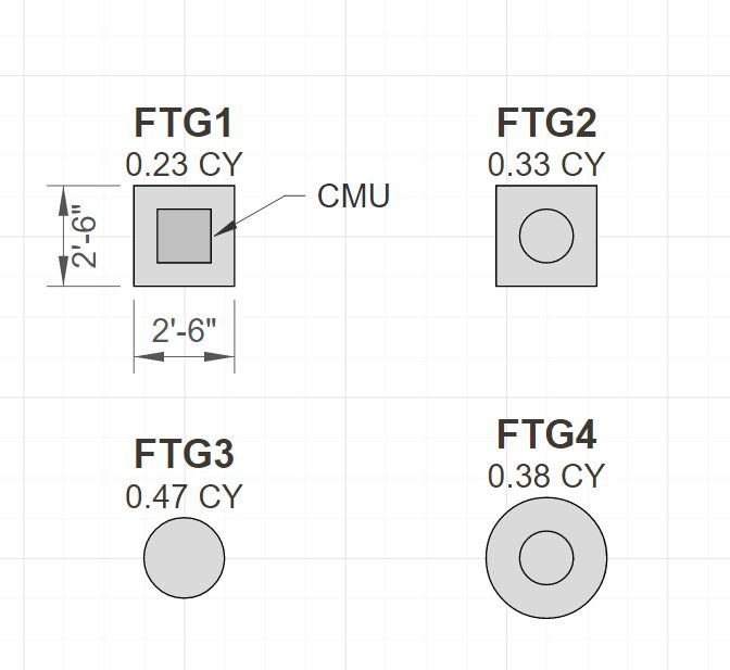

Medeek Posted September 30 Author Share Posted September 30 First look at column footings: Link to comment Share on other sites More sharing options...

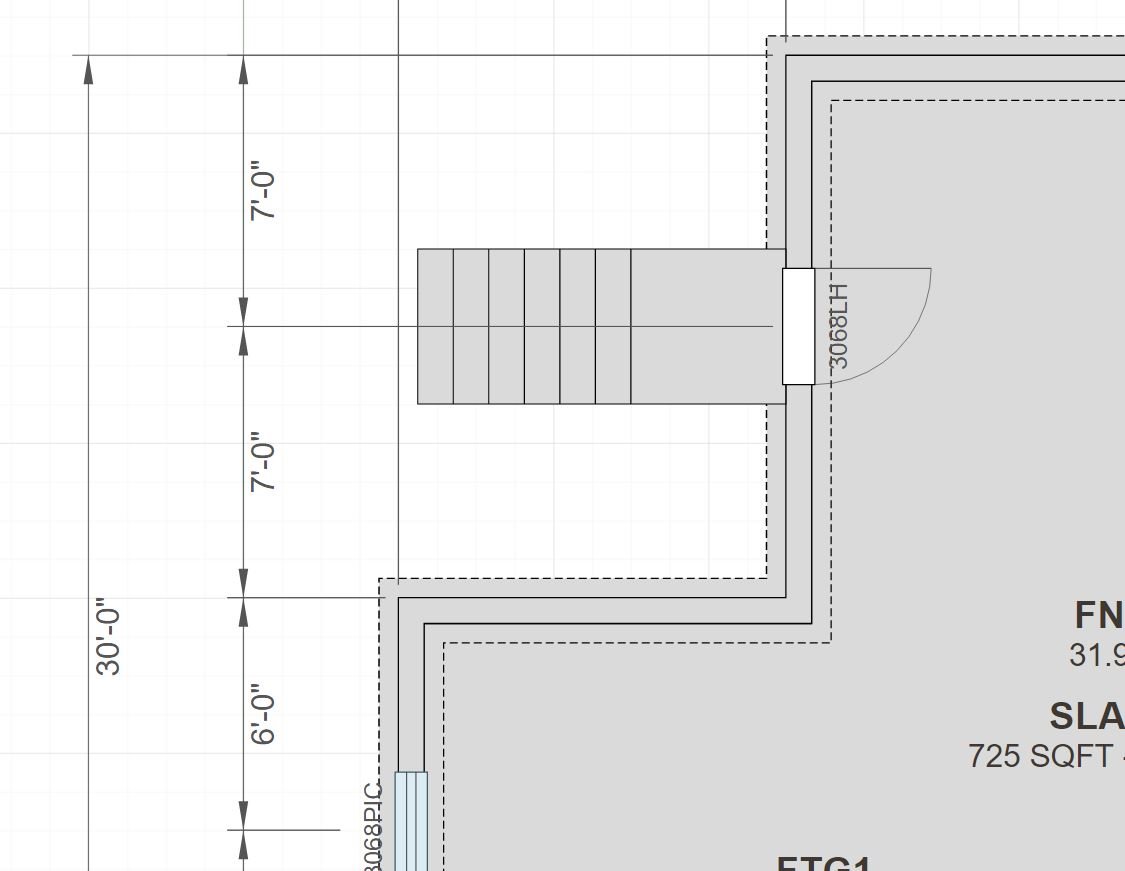

Medeek Posted October 1 Author Share Posted October 1 I’ve also enabled the entry stair option for foundation door openings. Link to comment Share on other sites More sharing options...

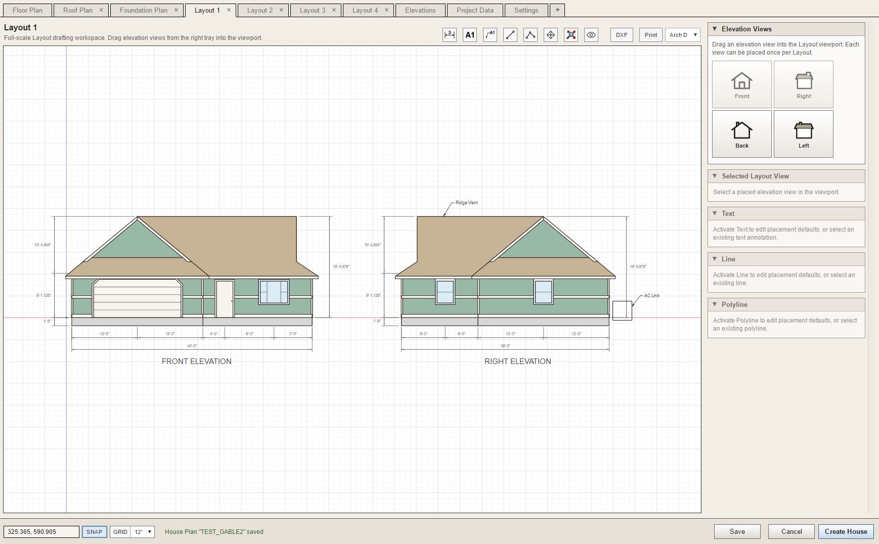

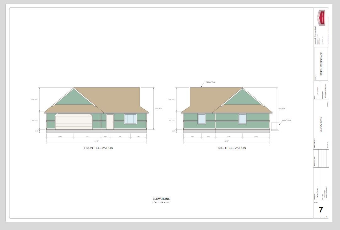

Medeek Posted October 9 Author Share Posted October 9 Currently the various plan view tabs are treated as their own “sheets” or pages. In other words if you print that tab you get exactly what is in the viewport scaled to fit into a regular sheet size (letter, 11x17, Arch C, Arch D). You cannot add in other geometry from other tabs. This seems to work reasonably well for most of these plan views (ie. Floor Plan, Foundation Plan, Roof Plan, Floor Framing Plan etc…) However, when it comes to elevation views things typically get a bit more interesting. Some designers like to put multiple elevation views on one sheet and in some cases all four if they will fit ( I like to do this for small ADUs for example). So it is not as easy as assigning one elevation view to one sheet, or even assigning two elevation views to one sheet, there needs to be more flexibility. After giving this some considerable thought I decided what I really needed was a Layout system where the user can drag the elevations into the “workspace” and position them as they see fit, and then at that point add their annotations and dimensions. I have now created four additional Layout tabs where the user can do exactly that. The only major thing I feel like I am missing at this point is a sectional view or section tool. Link to comment Share on other sites More sharing options...

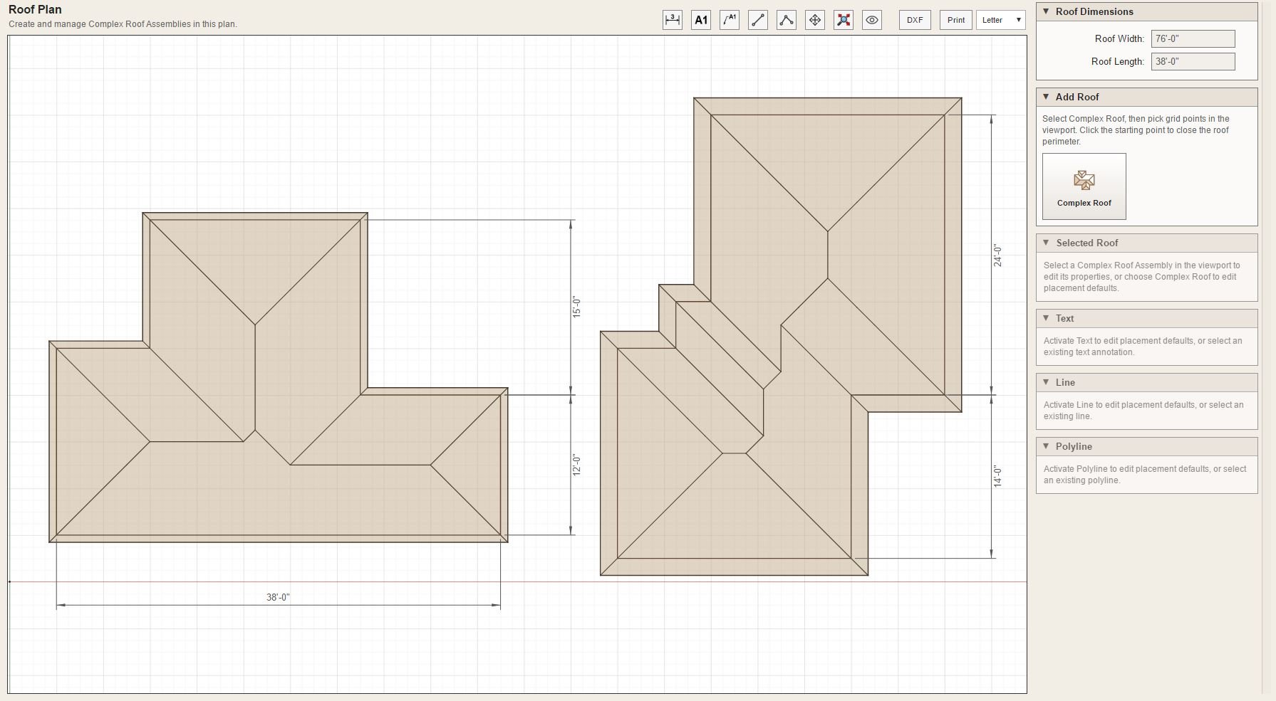

Medeek Posted October 10 Author Share Posted October 10 I've also add Common Truss Roofs along with Complex Roofs. Link to comment Share on other sites More sharing options...

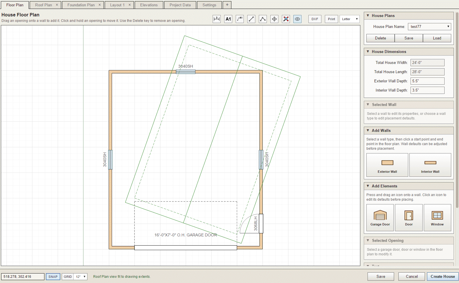

Medeek Posted October 15 Author Share Posted October 15 First look at some walls be generated by the House Builder. This is the easy part, next we need to add all the openings, and somehow make it very efficient. Link to comment Share on other sites More sharing options...

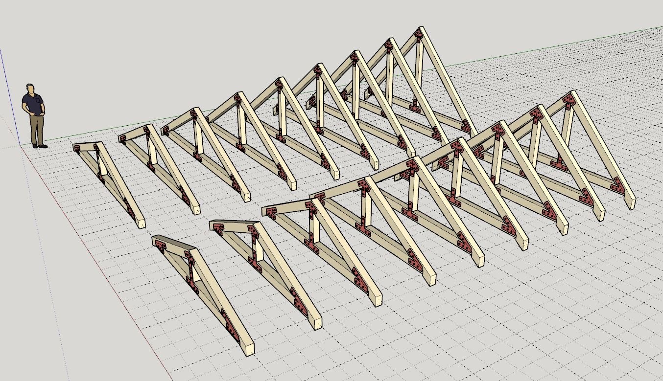

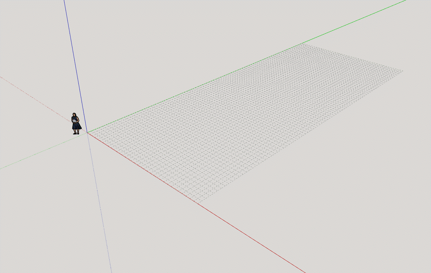

Medeek Posted October 22 Author Share Posted October 22 I appreciate all the support and interest I have received these last few months on this thread as I continue to develop different aspects of my suite of extensions. The original intent of this thread was to provide some additional resources for Chief users so that they could augment their ability to bring in resources from SketchUp. I've only used Chief a few times and I am not well versed enough in it to understand all the steps involved in importing geometry from SketchUp files. However I do know that it is possible. As a small token of my appreciation I've attached a sample of some basic (King Post) timber trusses in a SketchUp file that can be freely used by anyone within their Chief models. I don't know how much utility this will have so I've only created a line of 12' and 16' trusses that range in pitch from 4:12 to 12:12. I've saved the file in SketchUp 2017 format so that it can still be opened by SketchUp Make 2017 (which is the last free version of desktop SketchUp). If there is significant interest for more truss types and spans, please let me know. With my Truss plugin it is very easy for me to create as many permutations as needed. MDK_TIMBER_TRUSS_LIBRARY.skp Link to comment Share on other sites More sharing options...

GaryOhmer Posted October 25 Share Posted October 25 I love your trusses and appreciate everything you're doing - but the trusses have to done one at a time, they come in as one big symbol not individually 1 Link to comment Share on other sites More sharing options...
