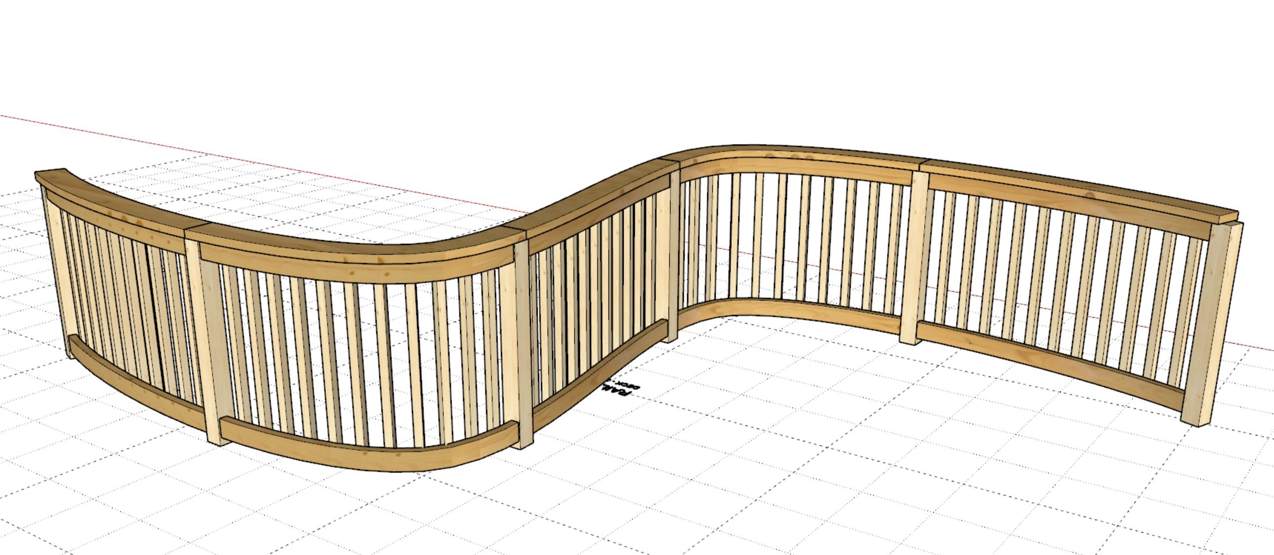

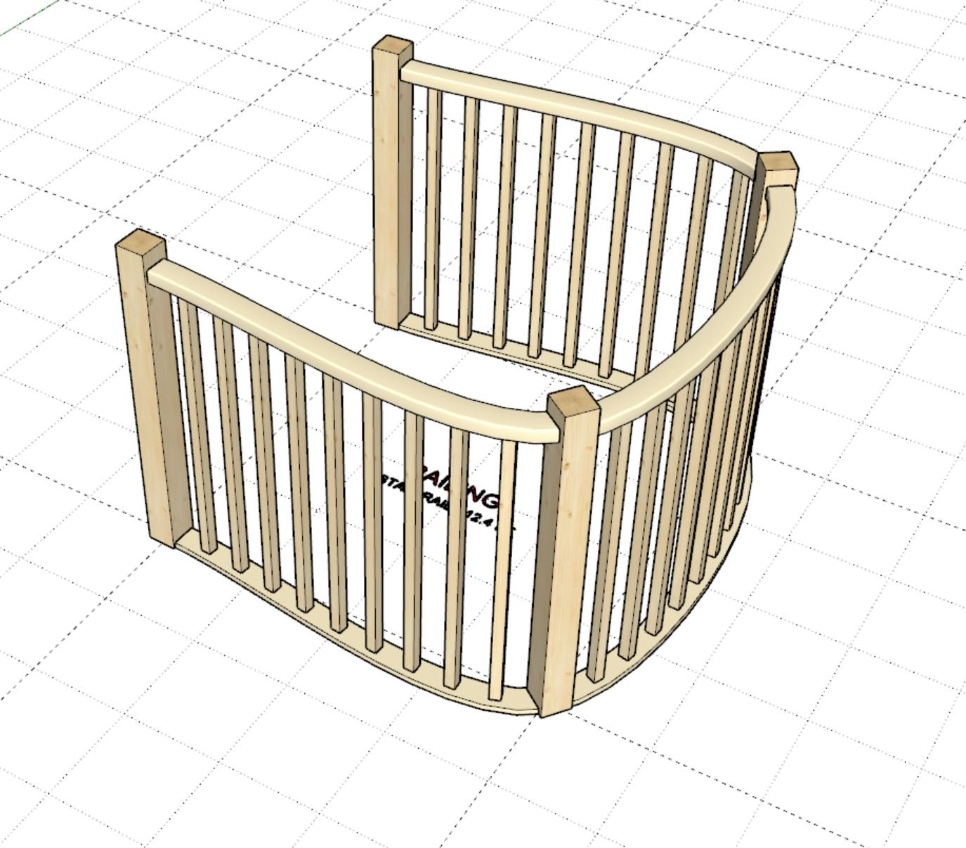

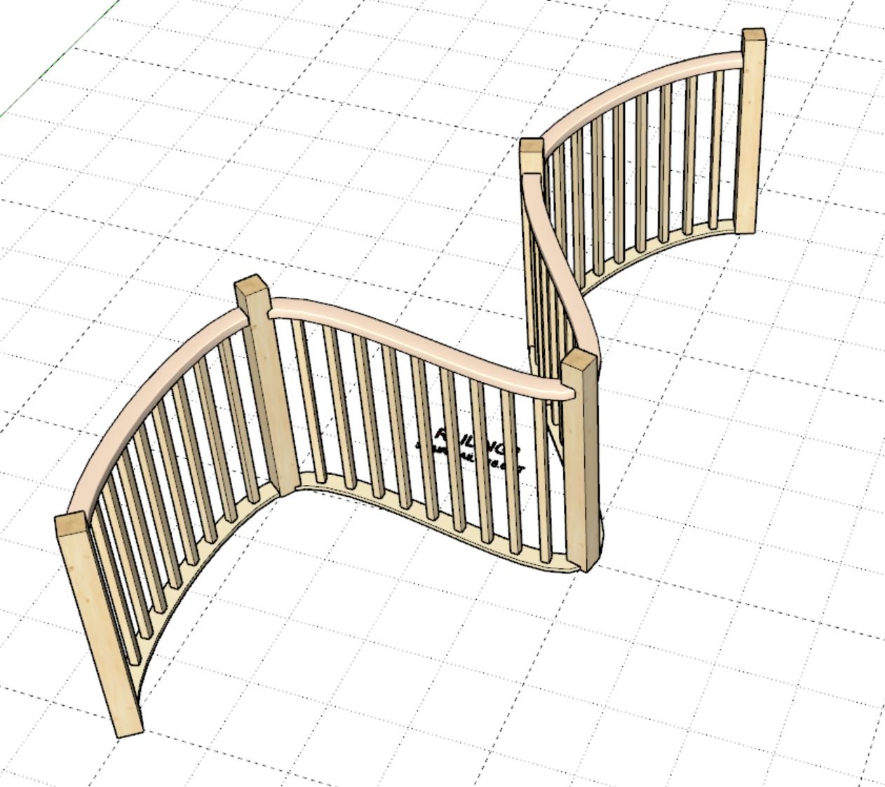

Medeek Posted June 23 Author Share Posted June 23 Version 4.6.6 - 06.23.2026 Added a Curved Segment option/tool for railing assemblies. Added a Spline Railing tool into the Stair Toolbar. Spline Railings enabled using a Centripetal Catmull-Rom spline algorithm with user selected start and end tangency points Link to comment Share on other sites More sharing options...

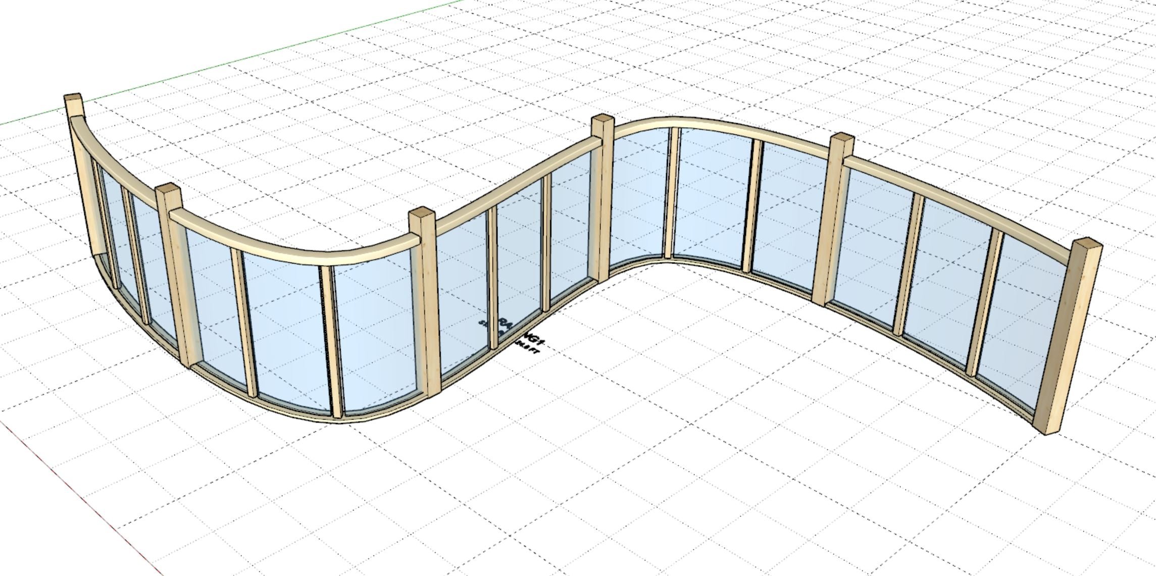

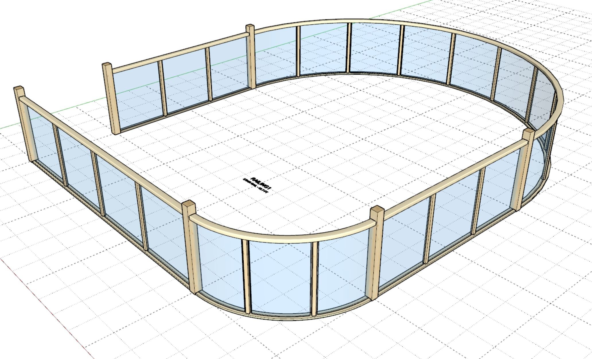

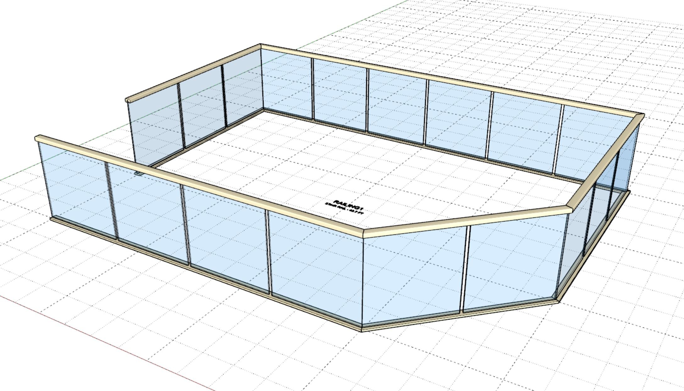

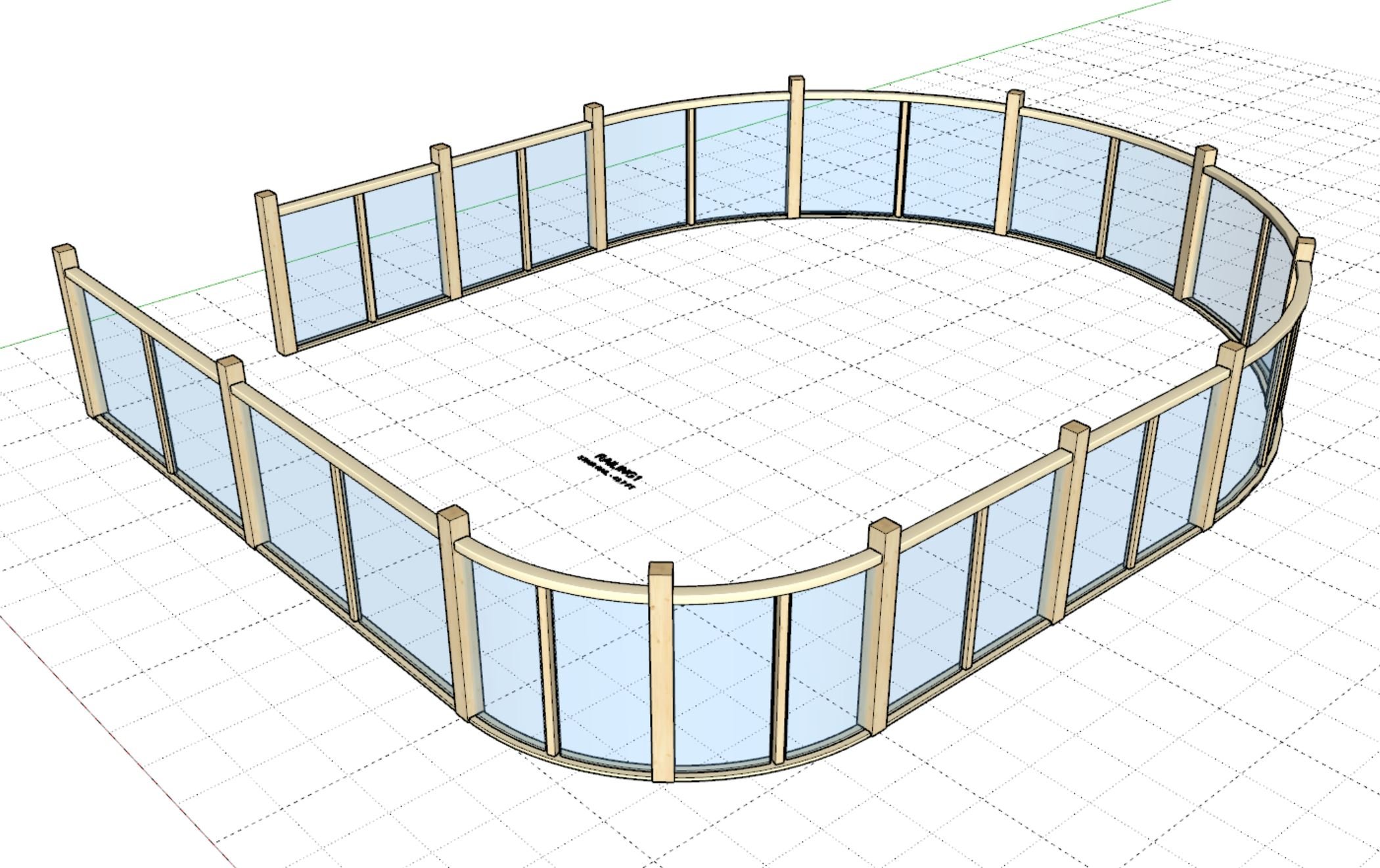

Medeek Posted June 26 Author Share Posted June 26 Version 4.6.7 - 06.25.2026 Added a “GLASS” baluster option for curved and straight rail assemblies. Added a “CABLE” baluster option for curved and straight rail assemblies. Link to comment Share on other sites More sharing options...

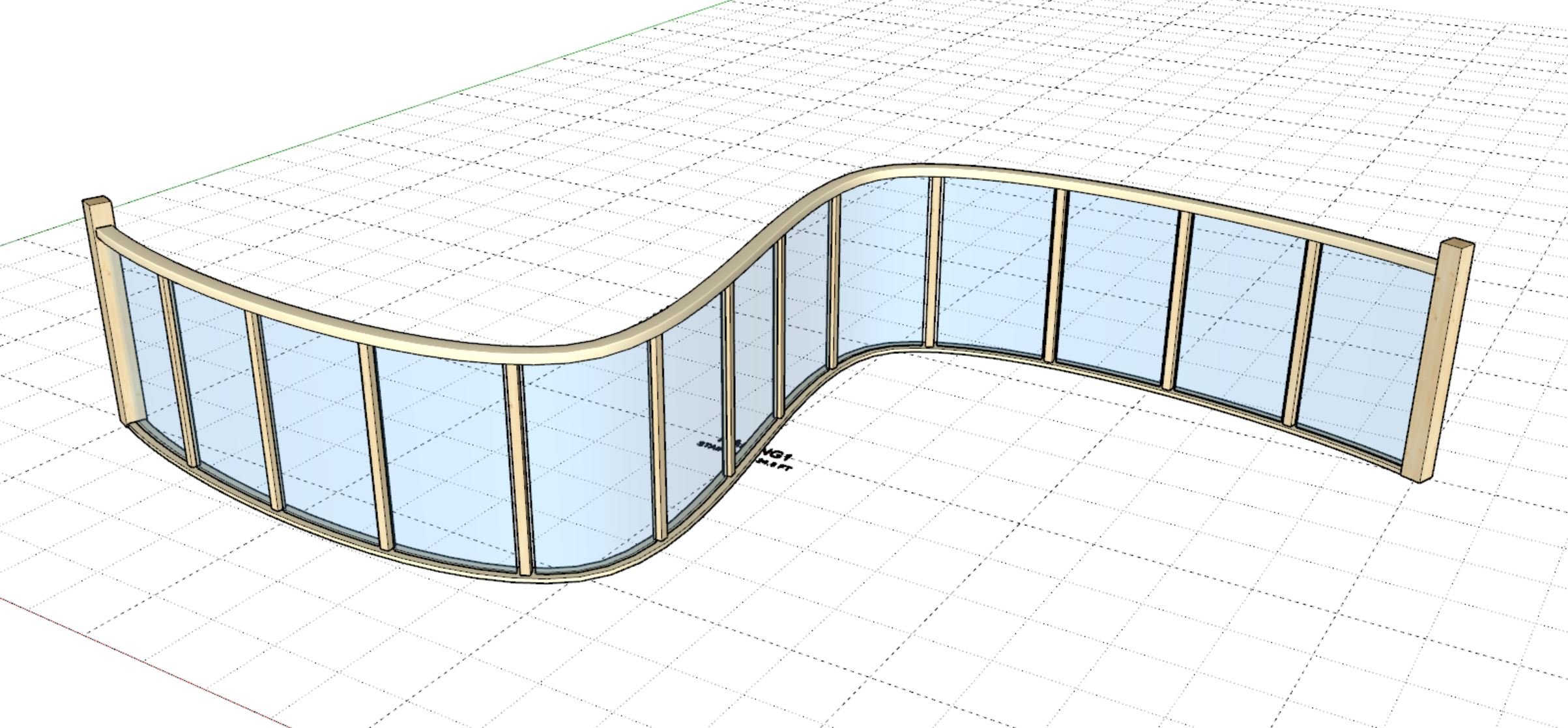

Medeek Posted June 27 Author Share Posted June 27 Version 4.6.7b - 06.26.2026 - Enabled deck railing for spline railing assemblies. - Added a "GLASS" baluster option for spline railing assemblies. - Added a "CABLE" baluster option for spline railing assemblies. Link to comment Share on other sites More sharing options...

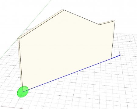

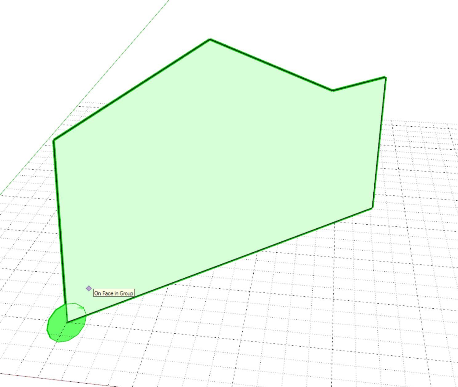

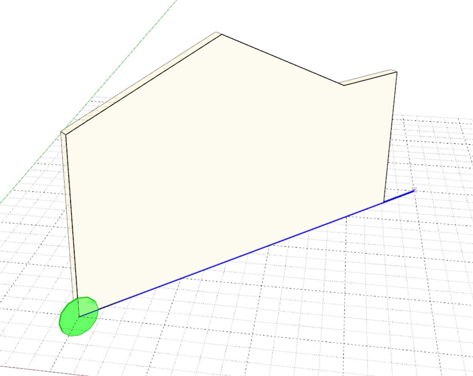

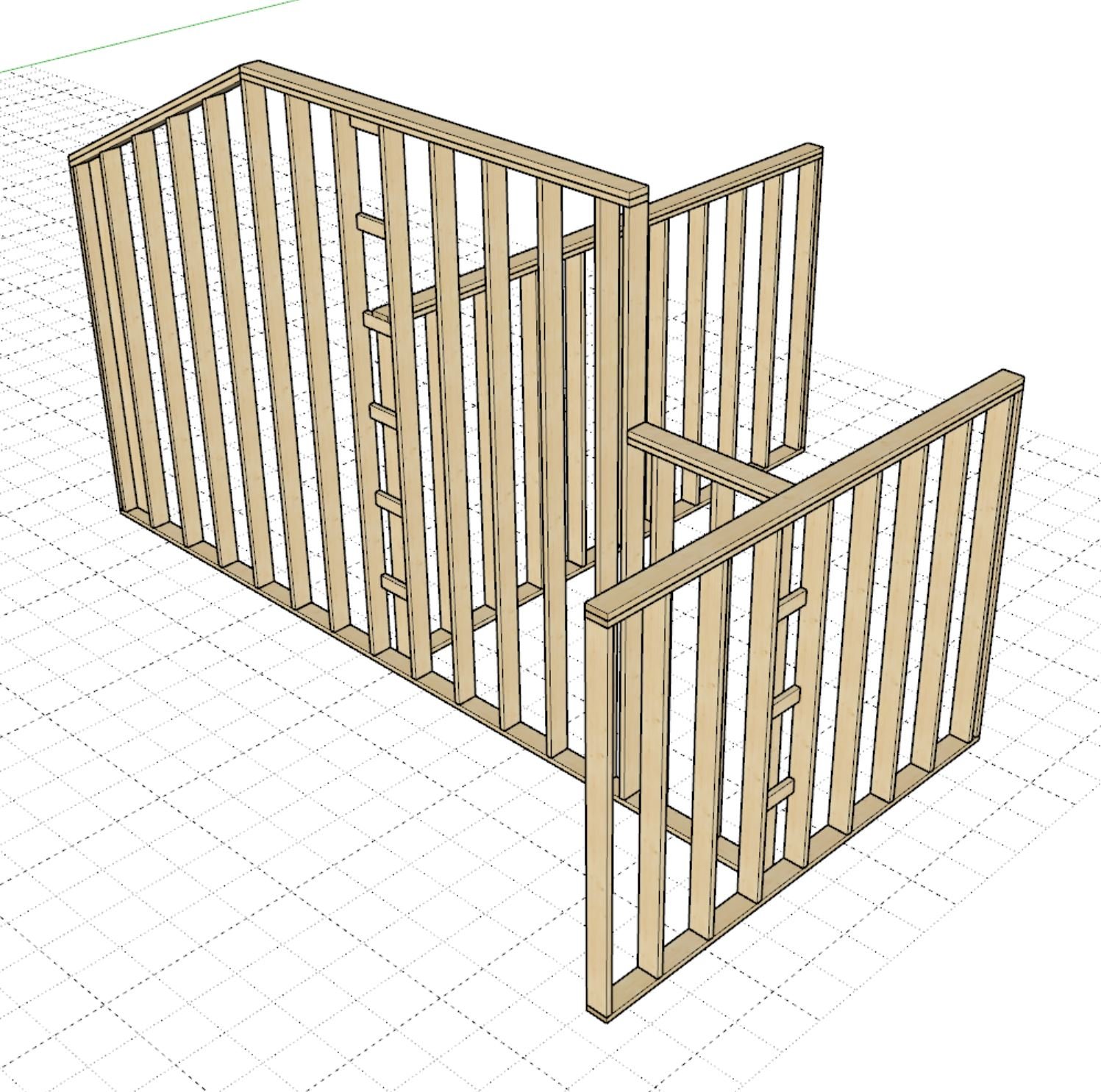

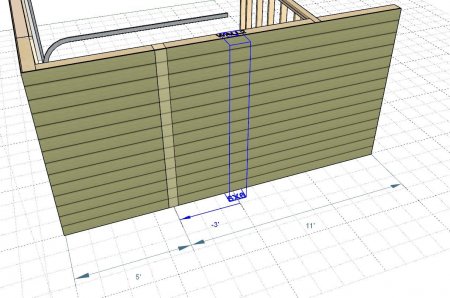

Medeek Posted July 2 Author Share Posted July 2 The custom wall "draw" tool is going to be a little bit different from the existing wall tools. Currently I have it so that can select a face (grouped or ungrouped). The face has to be vertical, in more precise terms this means the face normal vector must be perpendicular to the Z axis. Also note that as you hover over the face the nearest vertex is highlighted with the light green circle: This indicates where the "origin" or start point of the wall will be drawn from. Once you select the face, the tool then goes to phase 2, which allows you to project along the face in one of two directions. This will determine which side is the interior or exterior of the wall: The thick blue line indicates the ray or vector that is being used to determine which way the wall is facing, also the 3D wireframe indicates the wall's general envelope or geometry. Link to comment Share on other sites More sharing options...

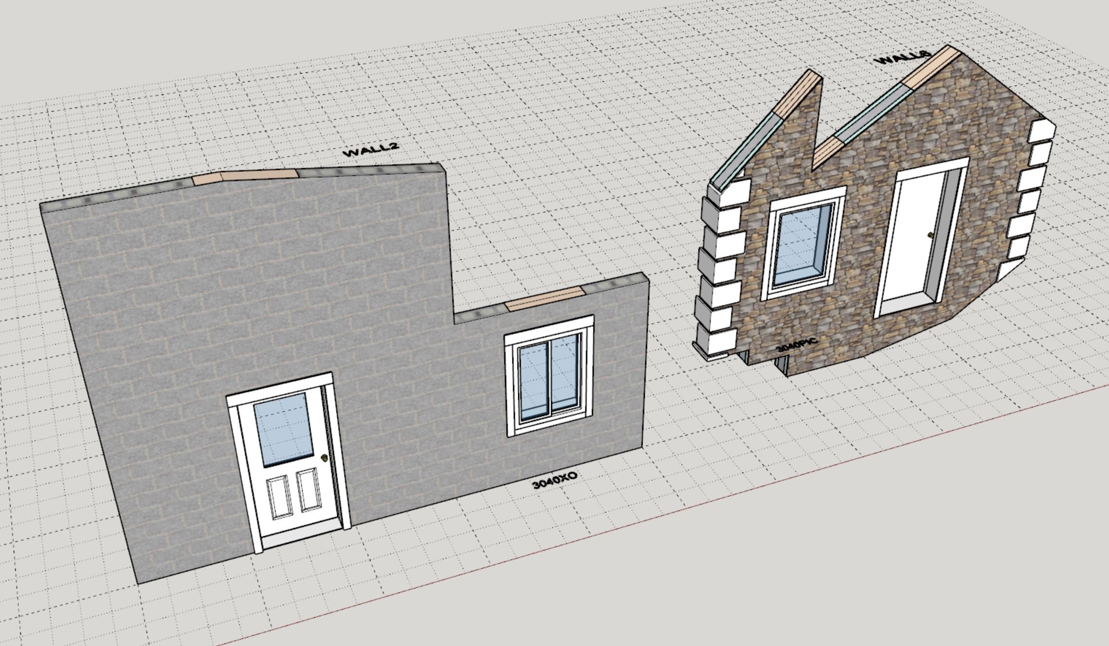

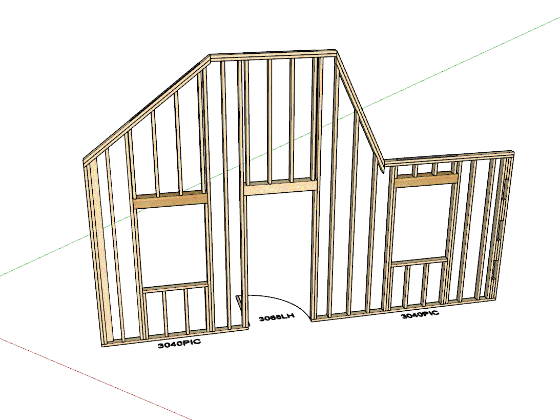

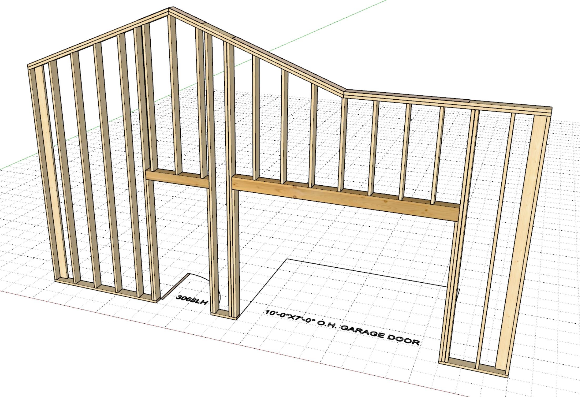

Medeek Posted July 6 Author Share Posted July 6 Testing garage doors and doors: Link to comment Share on other sites More sharing options...

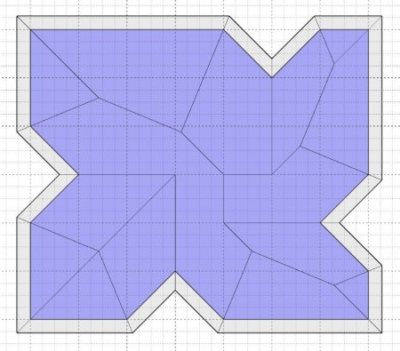

Medeek Posted July 7 Author Share Posted July 7 Custom or “complex” walls are really no different than complex roofs or floors. They are defined by an array of points. I was just going to adapt my current “Outline Edit” method for Custom walls but I felt like it was time for a bit of an upgrade. I’m hoping people will find this new tool a bit more intuitive. After I fully test it I may incorporate the same logic/tool into the other plugins for the following: Complex Roofs, Floors, Slab-on-Grad foundations, Polyline Stemwalls and Railings. Link to comment Share on other sites More sharing options...

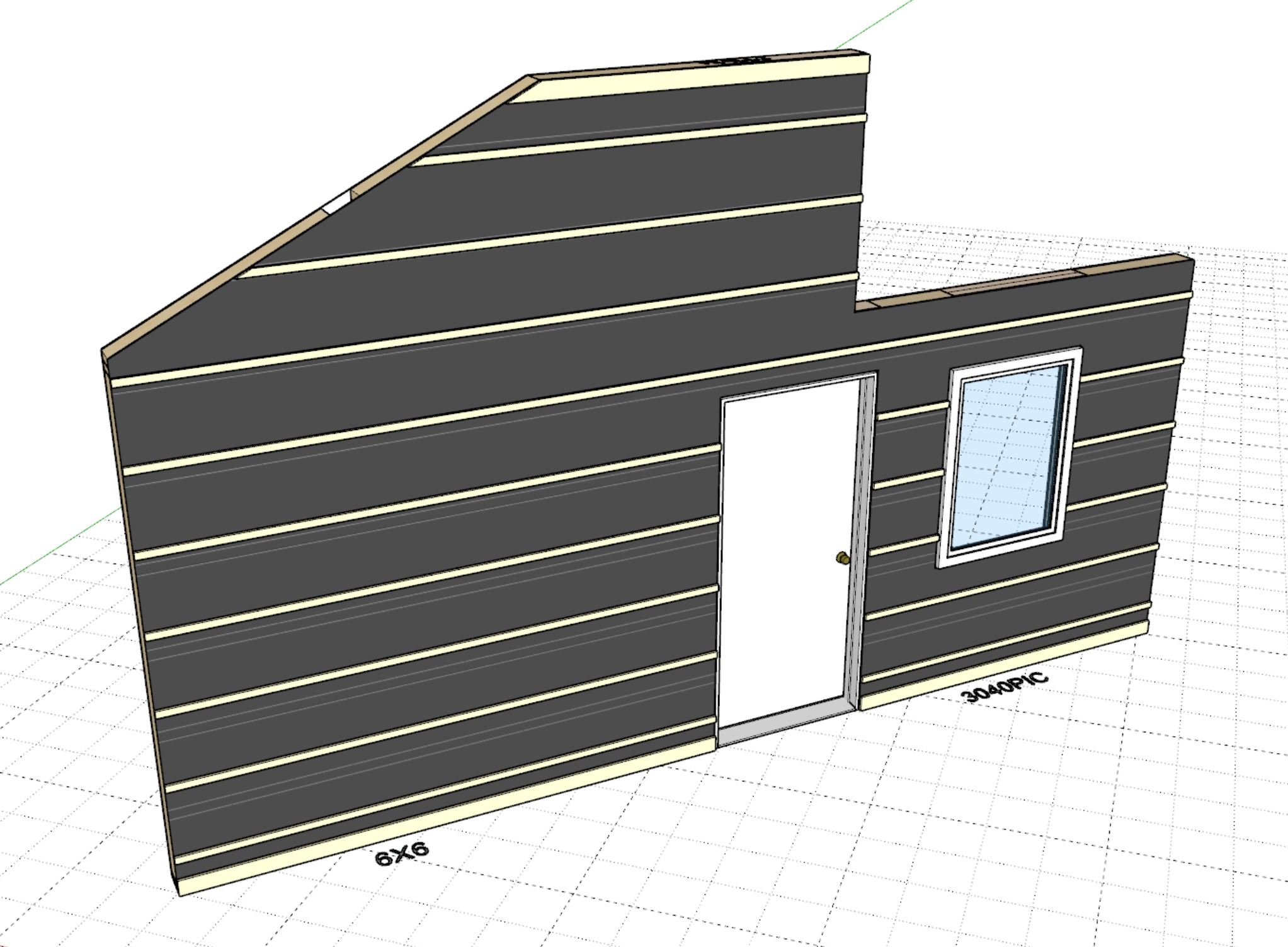

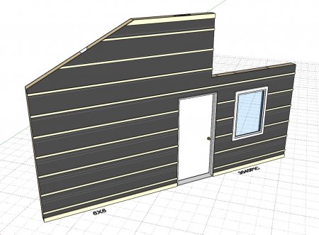

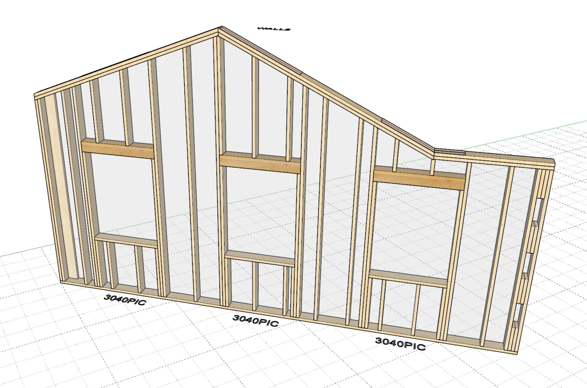

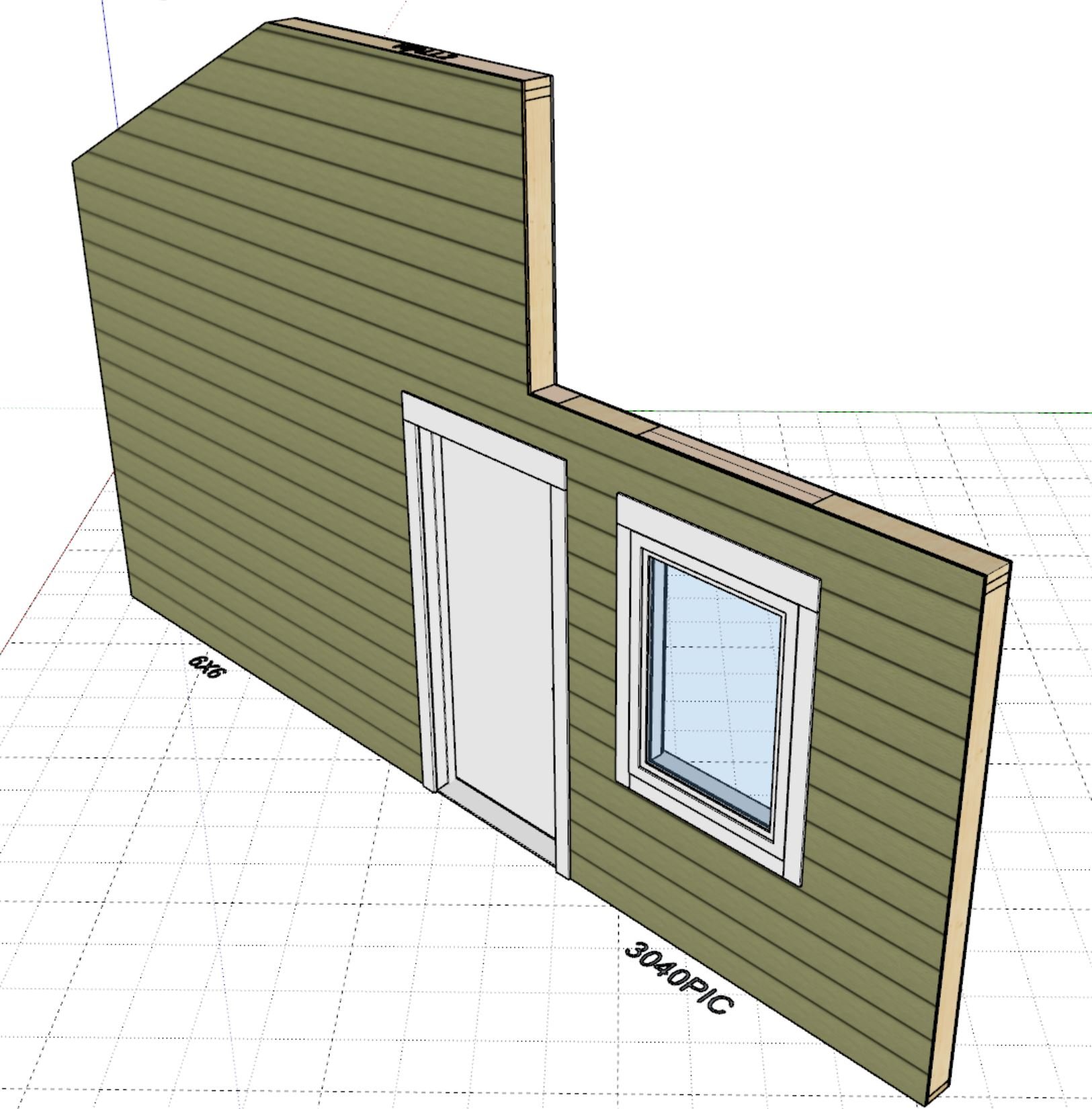

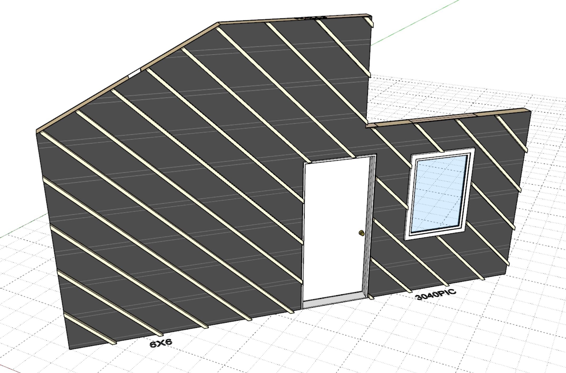

Medeek Posted July 10 Author Share Posted July 10 Today we are testing sheathing, cladding, gypsum and rainscreens: Yesterday we tested tee intersections. Link to comment Share on other sites More sharing options...

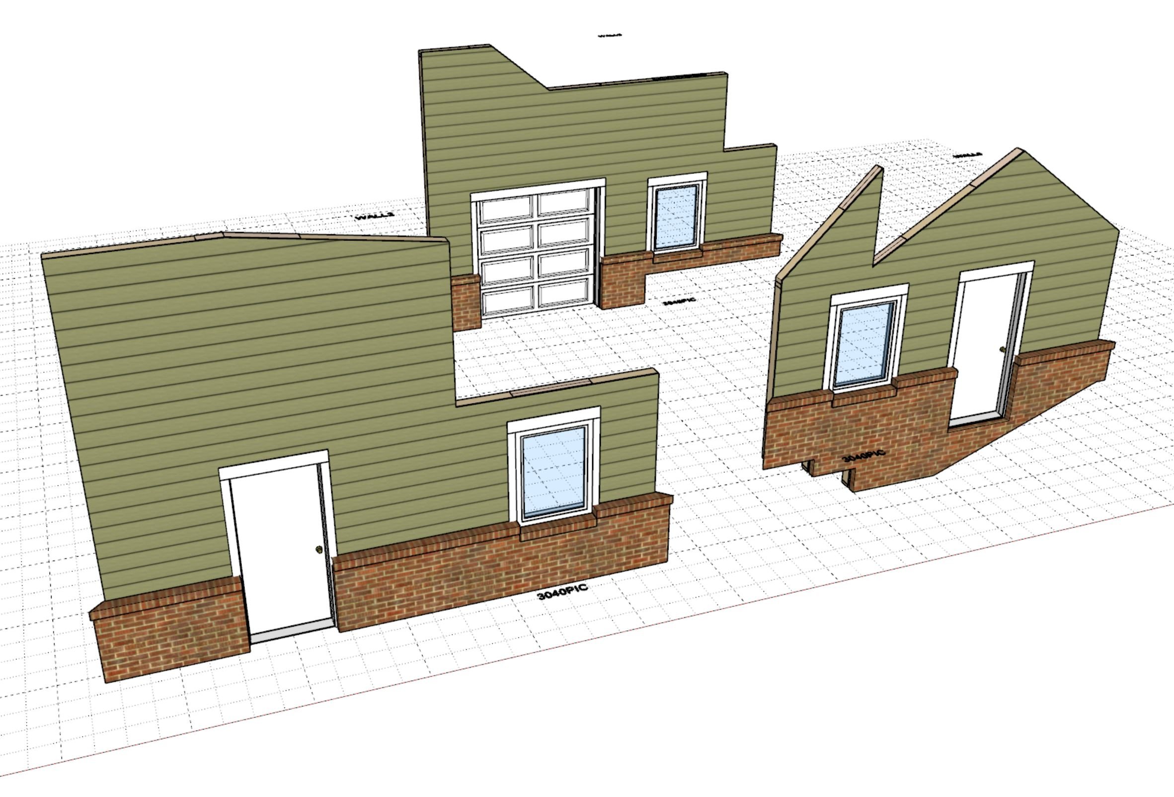

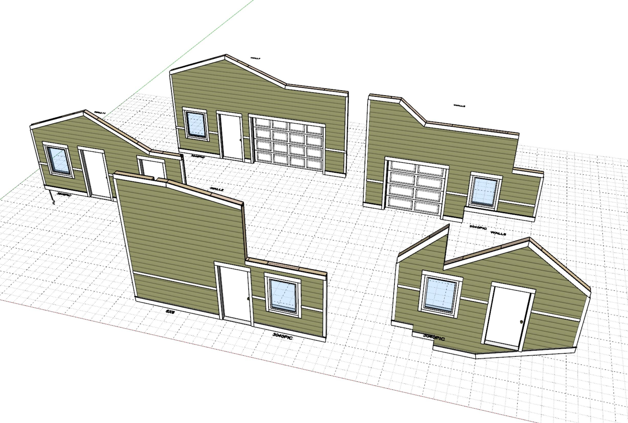

Medeek Posted July 16 Author Share Posted July 16 (edited) First look at wainscot applied to Custom walls. Edited July 16 by Medeek Link to comment Share on other sites More sharing options...

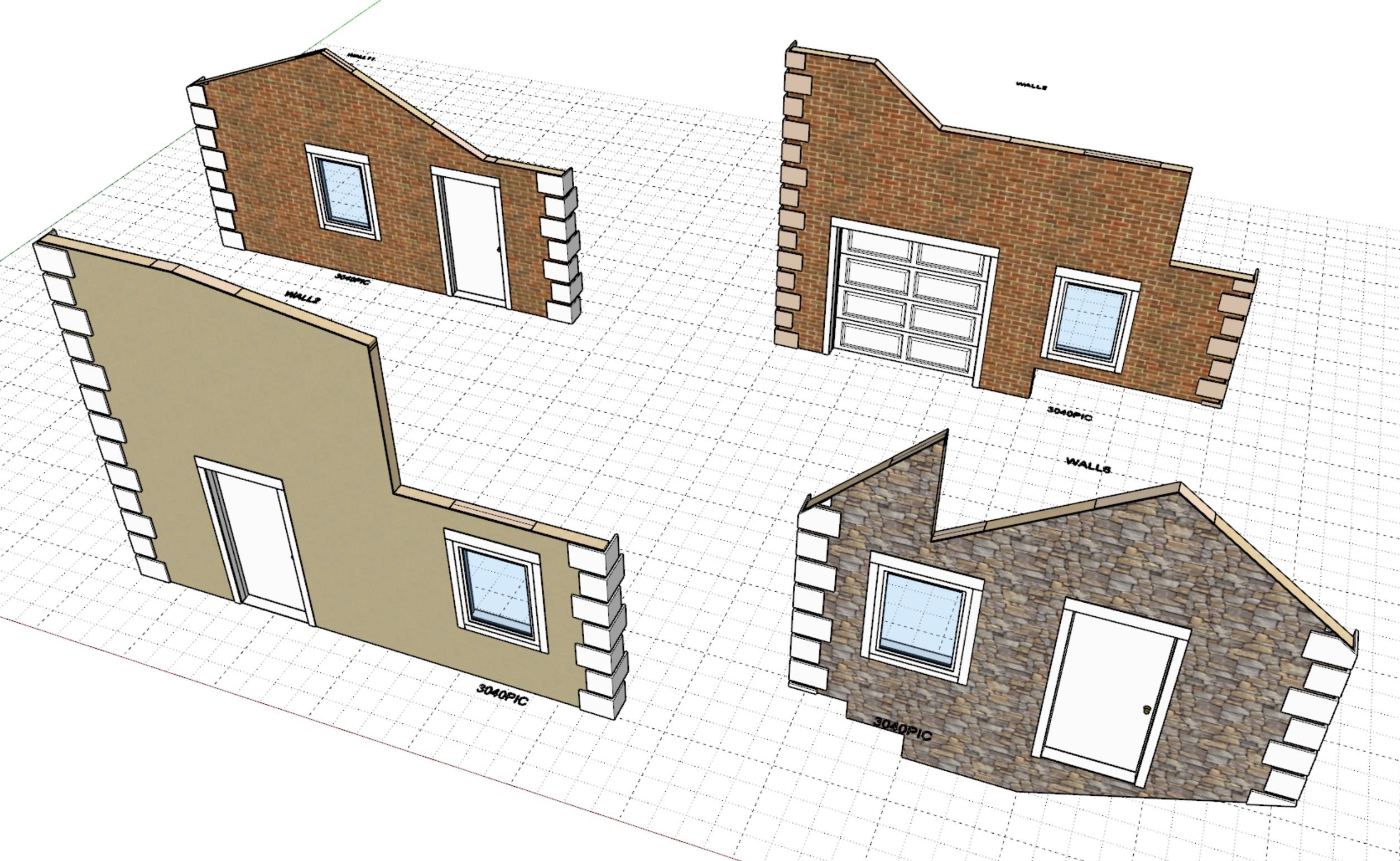

Medeek Posted July 16 Author Share Posted July 16 First look at quoins applied to Custom walls. Link to comment Share on other sites More sharing options...

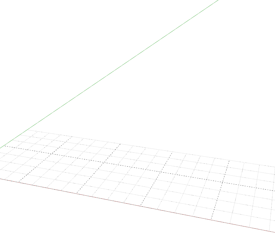

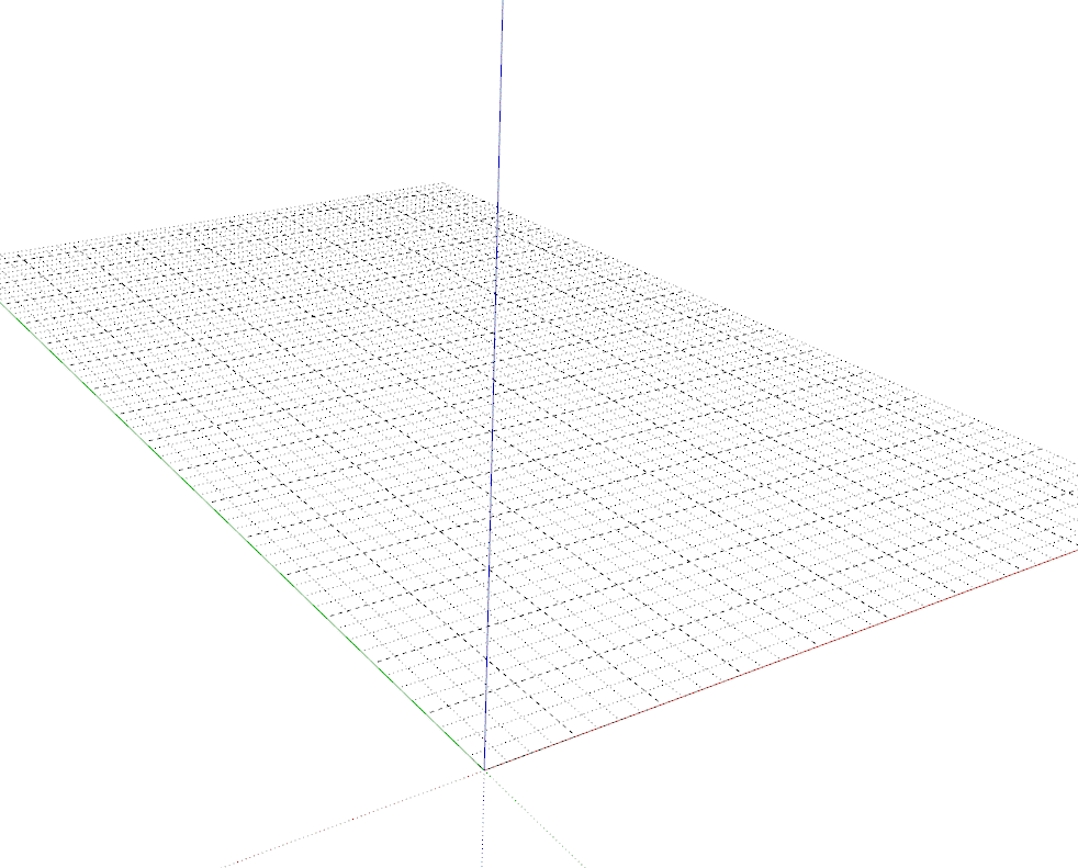

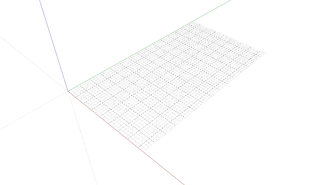

Medeek Posted July 20 Author Share Posted July 20 **Version 4.7.0b** - 07.20.2026 - Added a floating grid to the Custom wall draw and profile edit tool when the "Grid Snap" option is toggled on. Link to comment Share on other sites More sharing options...

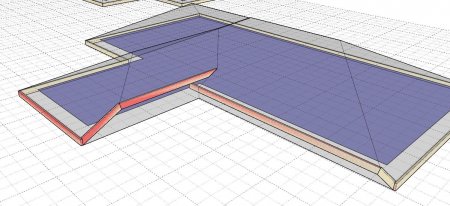

Medeek Posted July 21 Author Share Posted July 21 Version 2.1.5 - 07.20.2026 - Added a SOG "profile" edit tool within the context menu for polygon slab-on-grade assemblies. - Added a "Grid Snap" option with hotkey (End key) into the SOG profile edit tool. 1 Link to comment Share on other sites More sharing options...

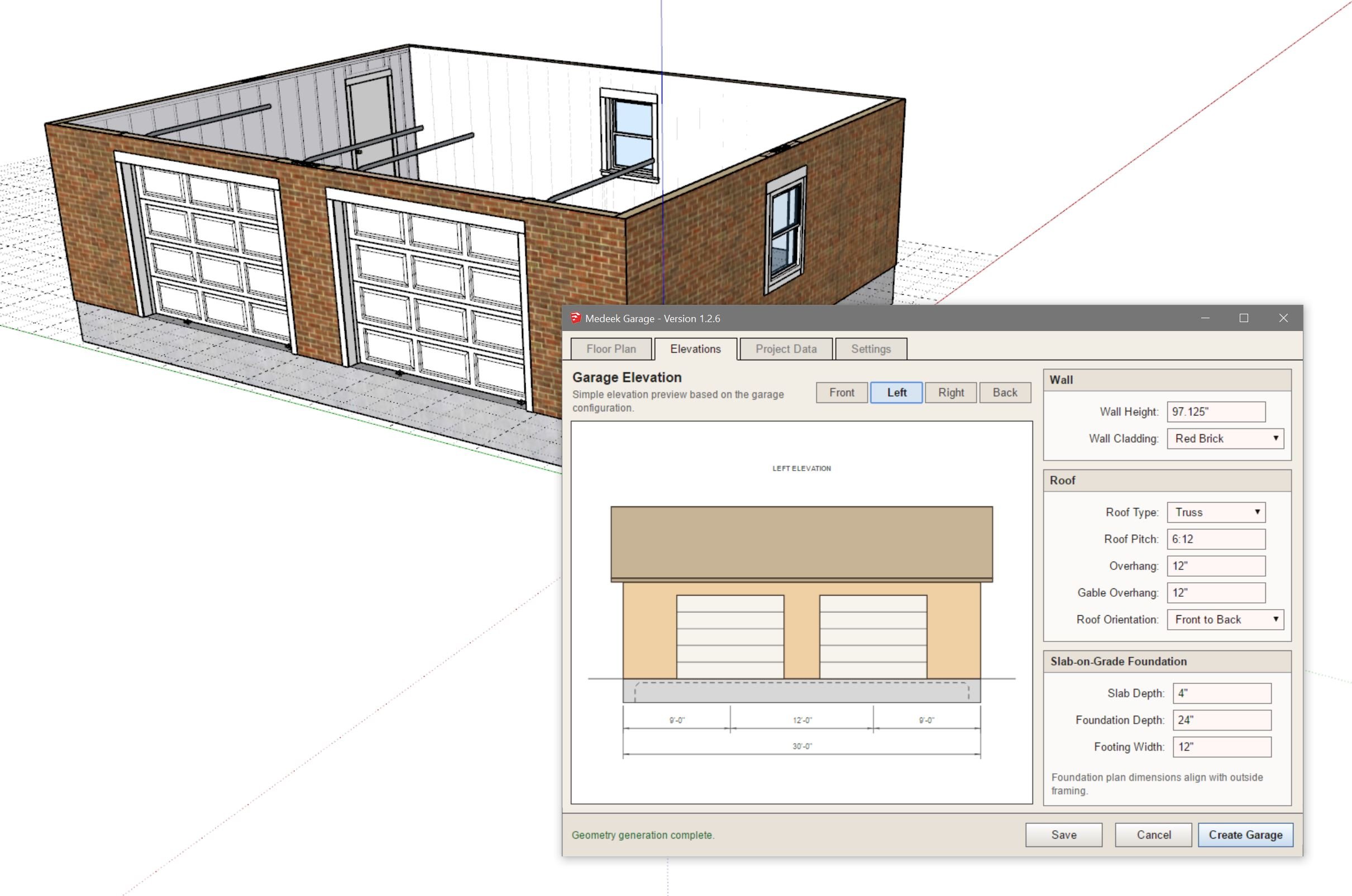

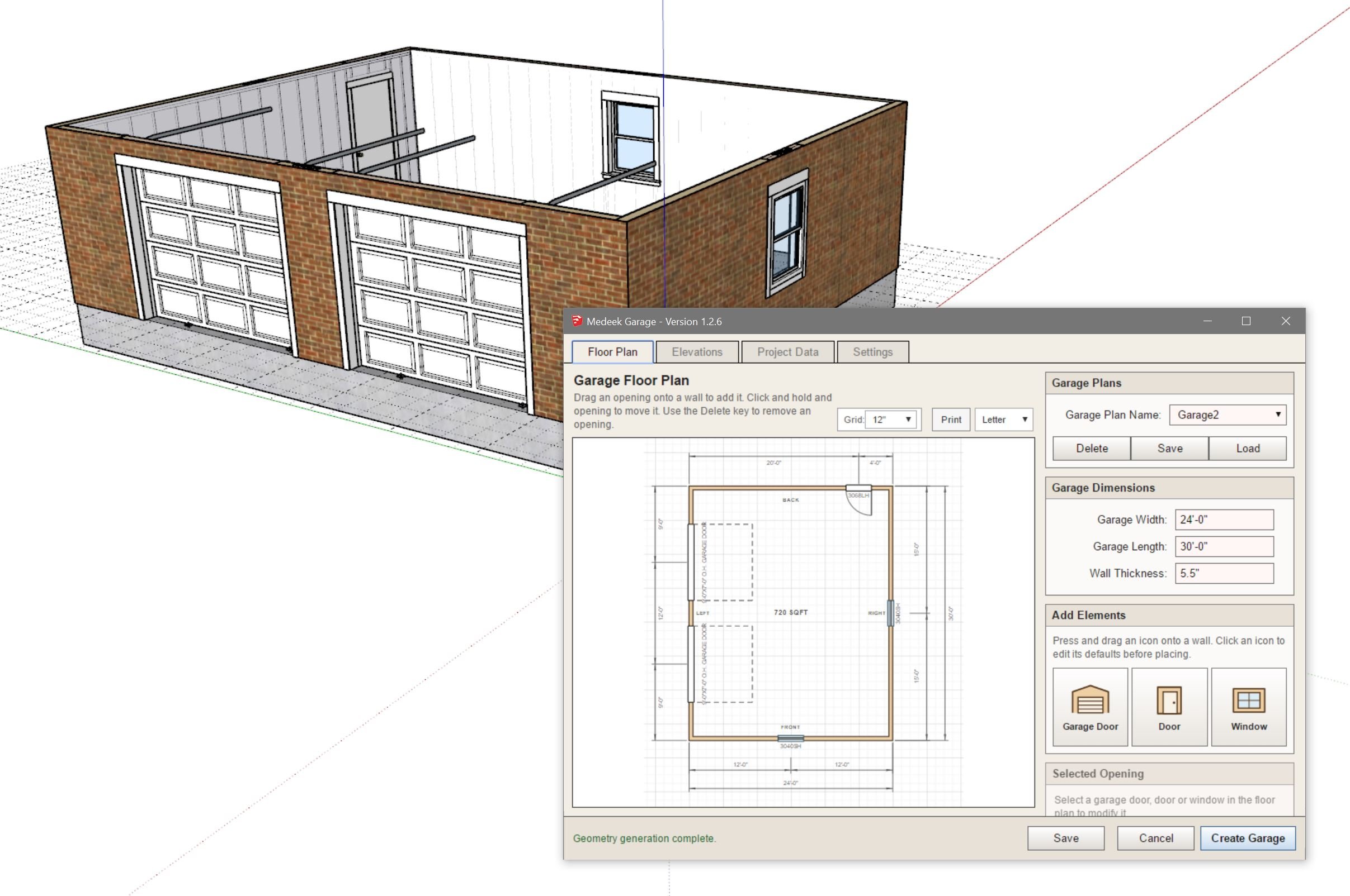

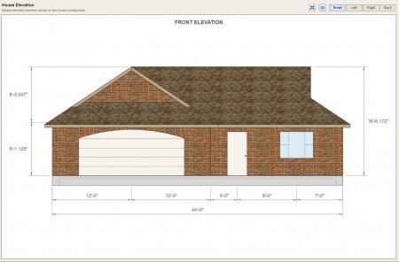

Medeek Posted July 27 Author Share Posted July 27 The API connector/bridge seems to be working, just need to do some more testing and also add the roof: 1 Link to comment Share on other sites More sharing options...

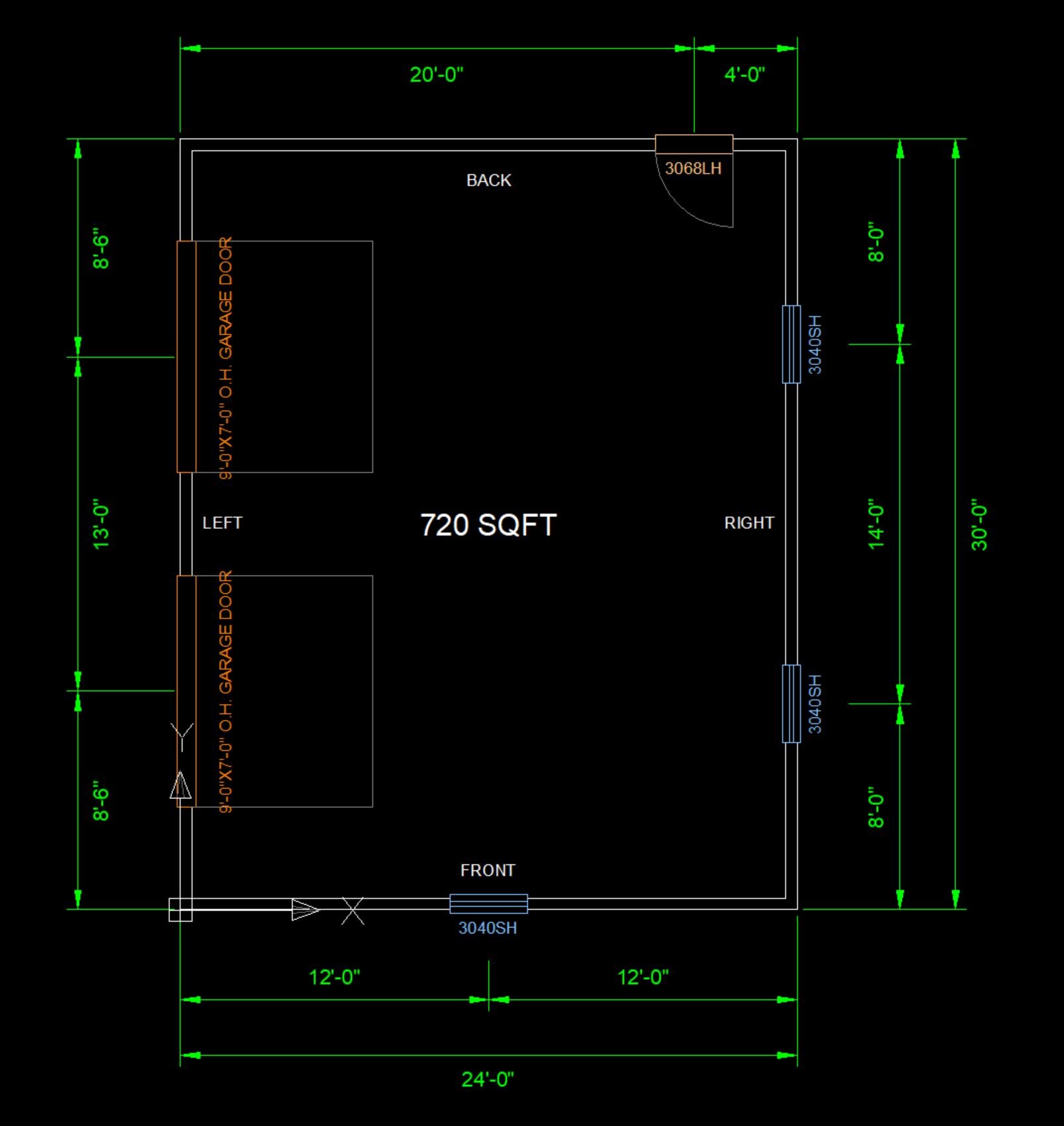

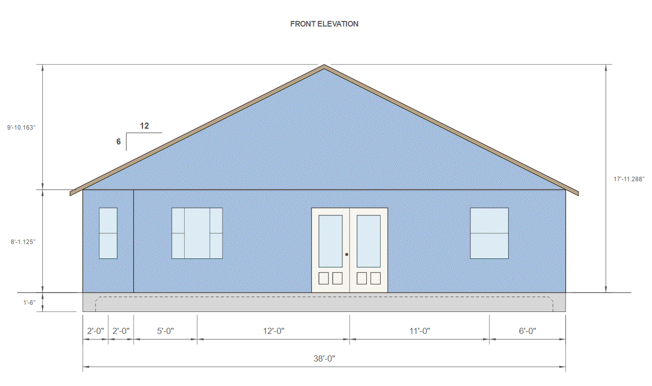

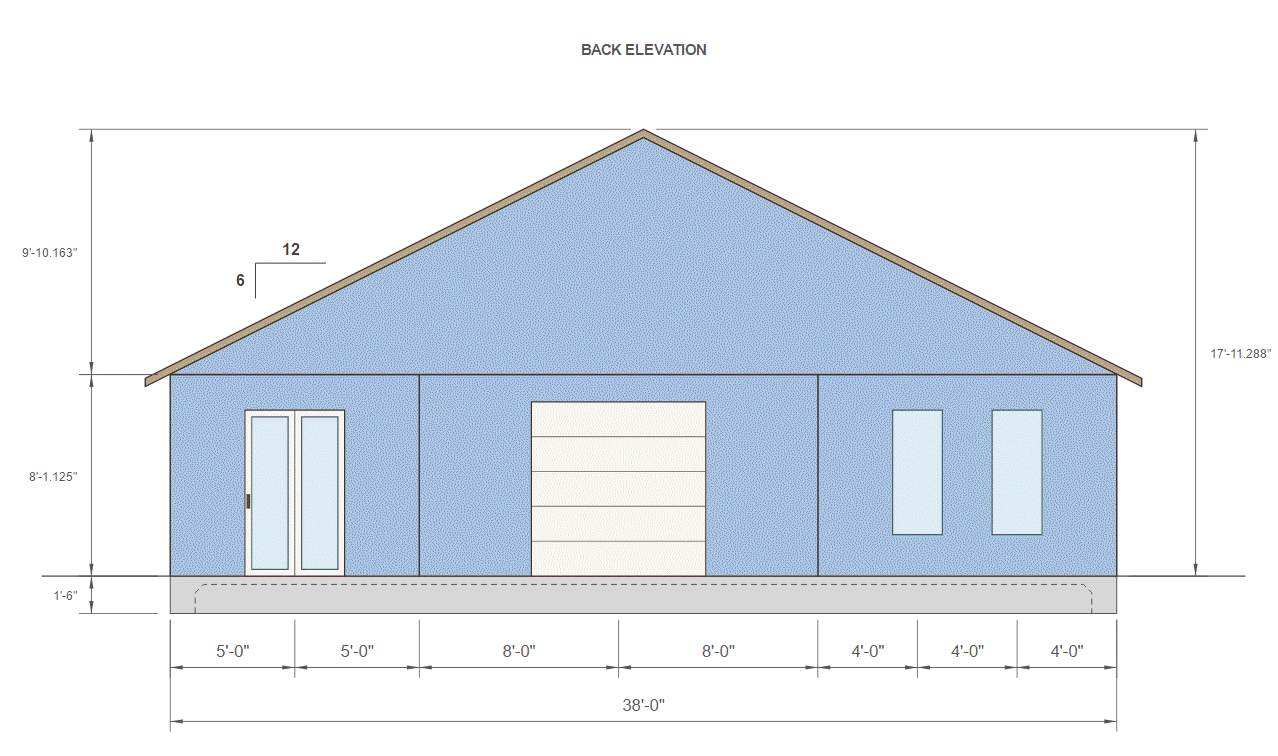

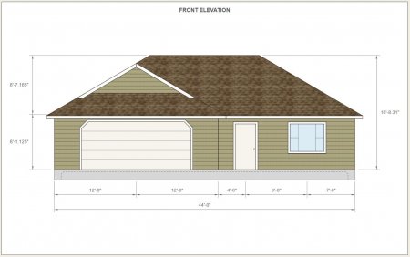

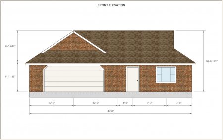

Medeek Posted July 28 Author Share Posted July 28 The first attempt was a bit crude in my opinion. After some fiddling with fonts and dimensions things look a bit more presentable: Link to comment Share on other sites More sharing options...

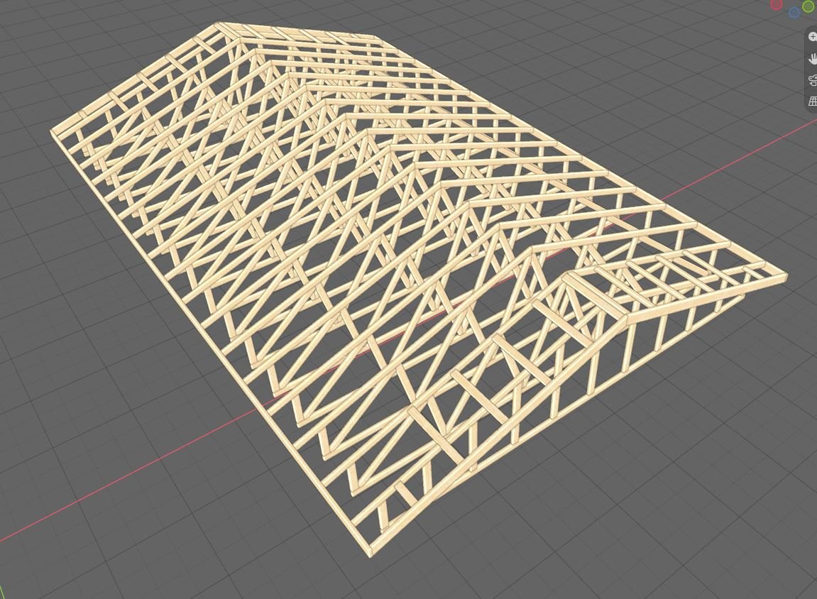

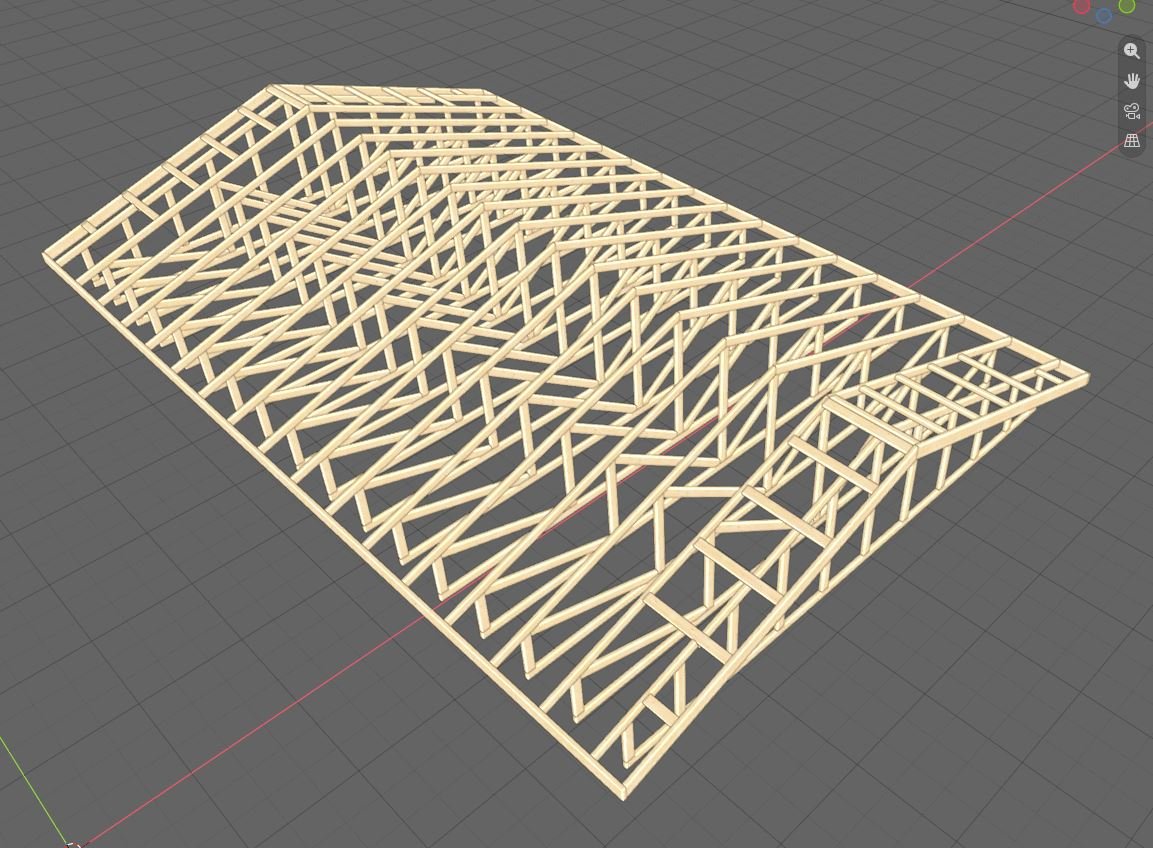

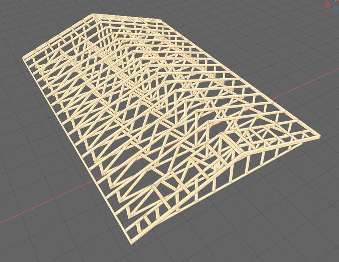

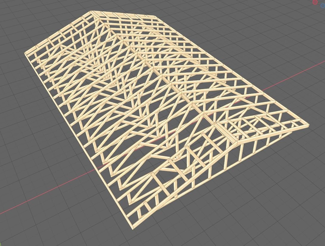

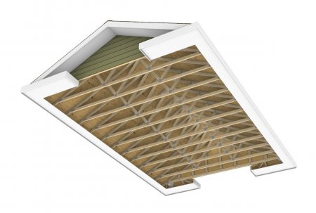

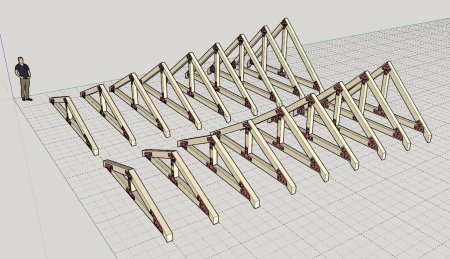

Medeek Posted Saturday at 08:56 PM Author Share Posted Saturday at 08:56 PM Here are some other more complex configurations drawn in Blender with the Medeek Truss for Blender: Howe, Fan, Mod Queen, Double Fink. Link to comment Share on other sites More sharing options...
Medeek Posted yesterday at 01:09 AM Author Share Posted yesterday at 01:09 AM I’ve released the first BETA version of the Medeek Truss (Blender) extension (Version 0.9.5). Please note that only common truss types (ie. King Post, Queen Post, Fink, Howe) can currently be drawn with the extension. You can download the 30 day trial at this link: https://design.medeek.com/blender/medeek_truss_blender.zip I will proceed to port over more truss types in the next few days and eventually we will get to rafter roofs, hip sets and complex roofs. Version 0.9.5 - 08.08.2026 - Created Medeek Truss - Blender extension, utilizing Blender’s Python API. - Added the following common truss types: King Post, Queen Post, Fink, Howe, Fan, Mod Queen, Double Fink, Double Howe, Mod Fan, Triple Fink, Triple Howe, Quad Fink, Quad Howe, Penta Howe. Link to comment Share on other sites More sharing options...
