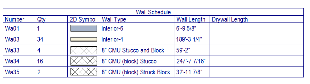

ACADuser Posted July 25, 2025 Share Posted July 25, 2025 I wanted a simple wall table with an added field to show 2x the wall length for drywall length. But when I added this %(length / 12 * 2).round(2)% to one of the fields in each wall "object Information" the table displays all walls as line items. Is there a way to do this and keep the simple table? Link to comment Share on other sites More sharing options...

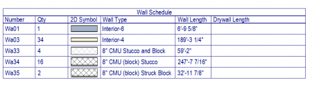

ACADuser Posted July 26, 2025 Author Share Posted July 26, 2025 I have that checked for wall length & it produces the table above. I wanted to go one step further & use my formula to get 2 times the length to get drywall length. When I do that the table separates all walls and I get a very large table. Link to comment Share on other sites More sharing options...
Joe_Carrick Posted July 26, 2025 Share Posted July 26, 2025 Because the wall lengths are different each wall will be a separate line. "Sum Similar Rows" really means "Exactly the Same" Link to comment Share on other sites More sharing options...
ACADuser Posted July 26, 2025 Author Share Posted July 26, 2025 That is what I'm up against. There seems to be no way around this limitation. i.e. limiting the wall comparison in the table. I suppose if you knew you way around material list one could tease out a similar table using that material list? Link to comment Share on other sites More sharing options...

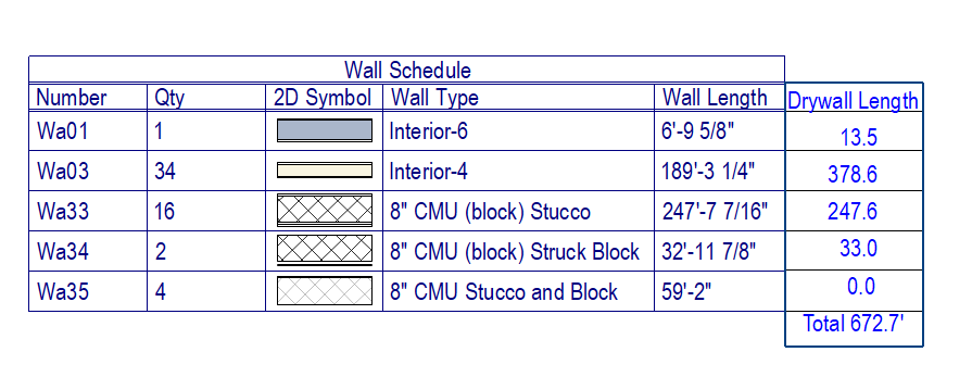

ACADuser Posted July 28, 2025 Author Share Posted July 28, 2025 I did this with added Mtext object. There are only 5 wall types in the plan. Link to comment Share on other sites More sharing options...
