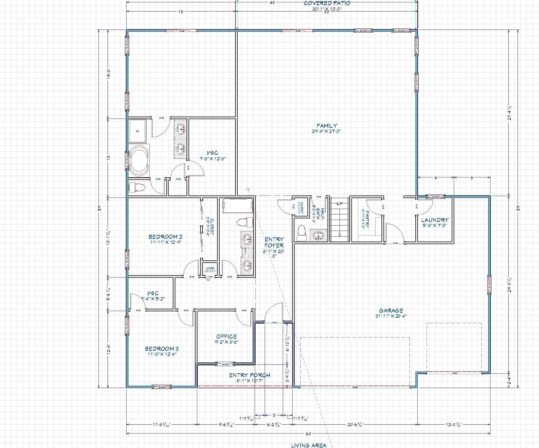

HowardStronglast Posted July 20, 2025 Share Posted July 20, 2025 Good day. I have designed a one-story house with an 8/12 roof pitch. I want to add living space in the "attic" above the center of the house (where the roof pitch allows adequate floor-to-ceiling height. I cannot figure out how to add that second floor just where the roof height allows. Thanks. Link to comment Share on other sites More sharing options...

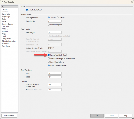

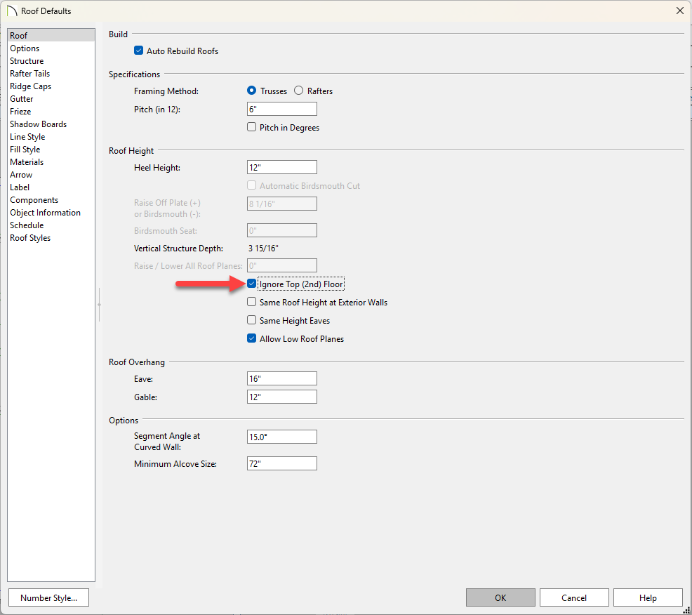

Doug_N Posted July 20, 2025 Share Posted July 20, 2025 You can still have automatic roofs by setting the default roof dialog to ignore the upper storey. 1 Link to comment Share on other sites More sharing options...

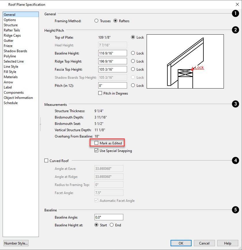

CharlesVolz Posted July 20, 2025 Share Posted July 20, 2025 11 minutes ago, Doug_N said: You can still have automatic roofs by setting the default roof dialog to ignore the upper storey. Yes. And you can Edit All Roof Planes> General tab> Mark as edited. Link to comment Share on other sites More sharing options...
