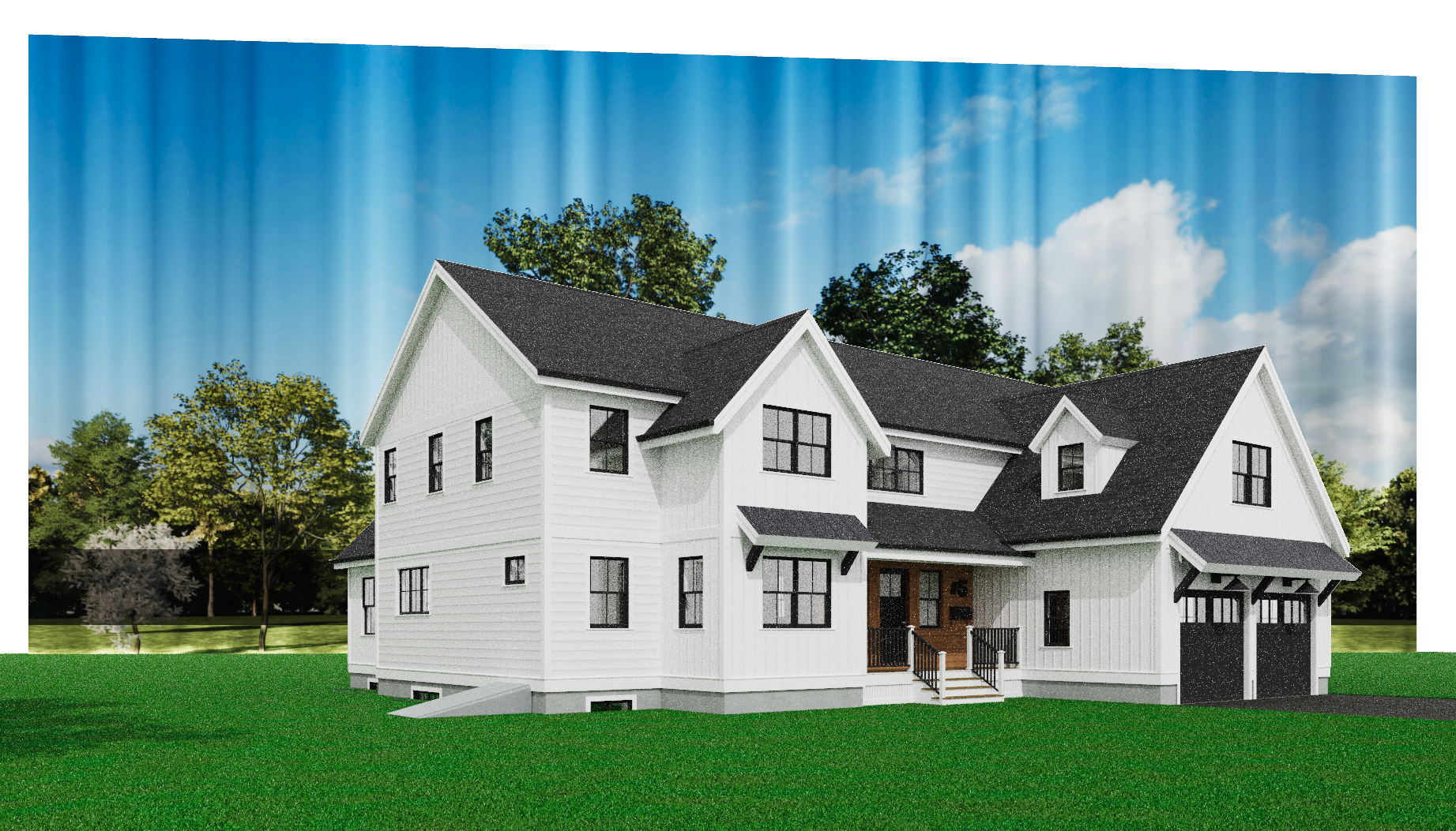

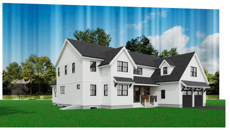

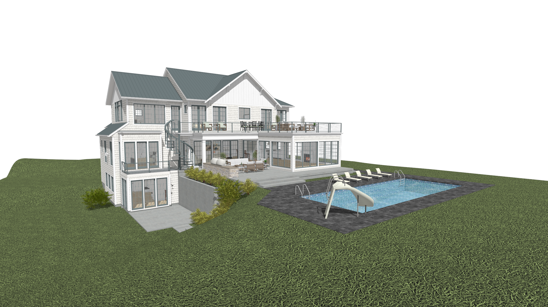

HardWorkingBee Posted July 28, 2025 Share Posted July 28, 2025 Hi @Steve_Nyhof! First of all huge thanks for this incredible thread. I learned so much and everything you've provided encouraged me to take the plunge and start working on my own renderings directly in CA. Please see the attached screenshot. The rendering is not complete but that doesn't change the outcome. I'm getting those light stripes and the dark horizontal band on the background image. I tried changing the sun position, the image position and the image orientation to no avail. It doesn't happen with the spherical backdrop. Applying the backdrop has no effect on the stripes. I'd greatly appreciate any pointers any of you could provide please. Best, Onur Link to comment Share on other sites More sharing options...
Steve_Nyhof Posted July 28, 2025 Author Share Posted July 28, 2025 12 hours ago, HardWorkingBee said: I'm getting those light stripes and the dark horizontal band on the background image. I am getting these light stripes also. Not as bad as you are. I have tried a number of things, including adding a large solid behind the image and that also does not work for me. I do believe the lighting for the background plays a role so you might mess with that. But, one thing that is about this thread, is that it has progressed over time, and ended with me using HDRi backgrounds when introduced with X16. I did not hear anything about the image background issues from anyone else, so thought it was just me. I might have even eluded to this issue in this thread. I don't remember. Try moving your sun around a little also and see what you get. Link to comment Share on other sites More sharing options...
Steve_Nyhof Posted July 28, 2025 Author Share Posted July 28, 2025 Download this rendering file and see what my settings are https://drive.google.com/file/d/1I2ZwzEyGUJHPKaD5RQ6J2S5B-f7iW8Mt/view?usp=sharing Link to comment Share on other sites More sharing options...

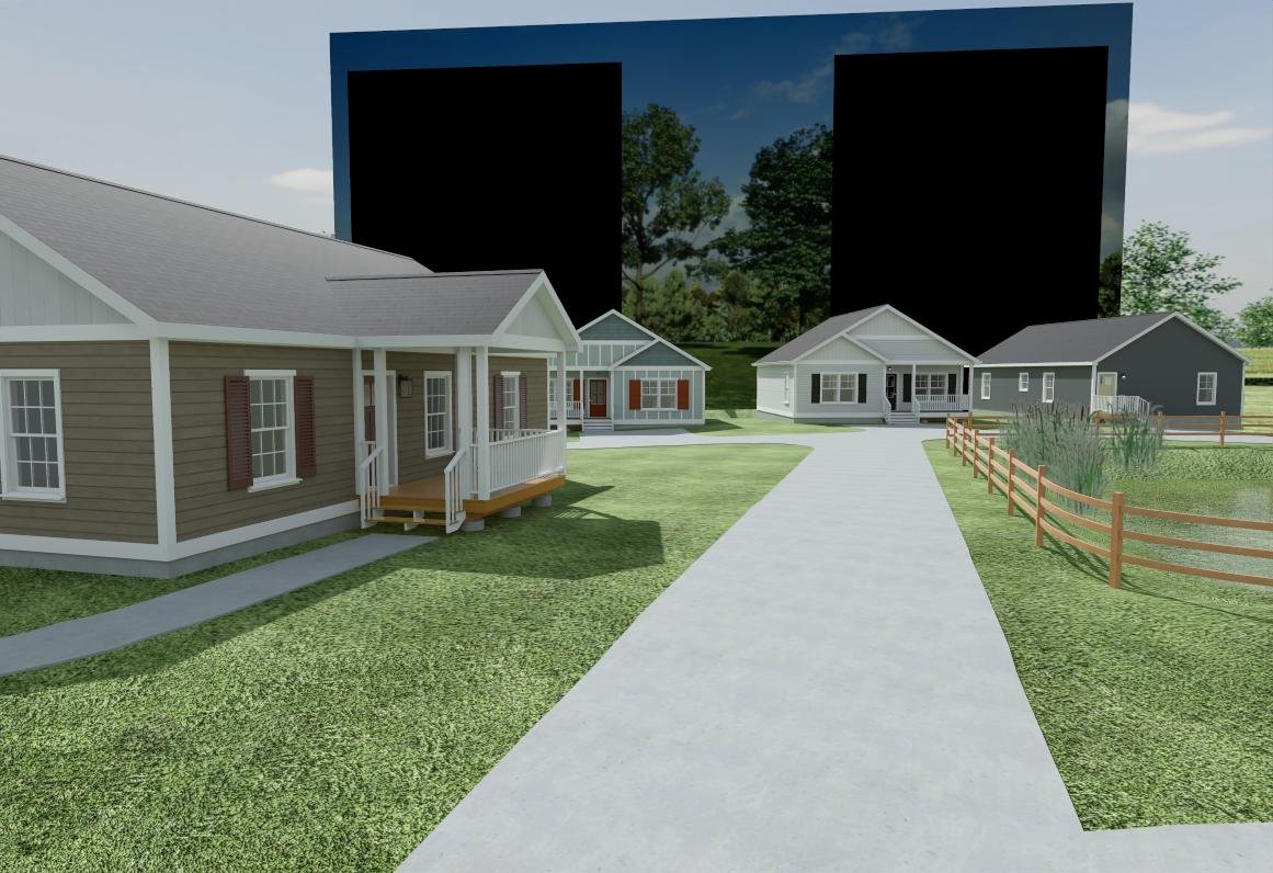

ACVNarch Posted November 6, 2025 Share Posted November 6, 2025 I've been trying to use this technique with a subdivision model (that has multiple houses brought in as symbols) and the background image object keeps clipping. I feel like I've seen it do this before when my camera was on the wrong side of the image object, but I only have one camera in this plan file. Any suggestions? Link to comment Share on other sites More sharing options...
Steve_Nyhof Posted November 6, 2025 Author Share Posted November 6, 2025 3 hours ago, ACVNarch said: I've been trying to use this technique with a subdivision model (that has multiple houses brought in as symbols) and the background image object keeps clipping. I feel like I've seen it do this before when my camera was on the wrong side of the image object, but I only have one camera in this plan file. Any suggestions? Seems this is a problem. You are the second one to note this. Because we are in X17 now, I would use HDRi backgrounds as chief uses them. I do like my backgrounds because they are more congruent with the 3D imagery of the model, and I can often rotate the scene or sun a bit to hide the lines, but what I am seeing here in your image would work nicely with HDRi backgrounds... Check a number of them out here... 1 1 Link to comment Share on other sites More sharing options...

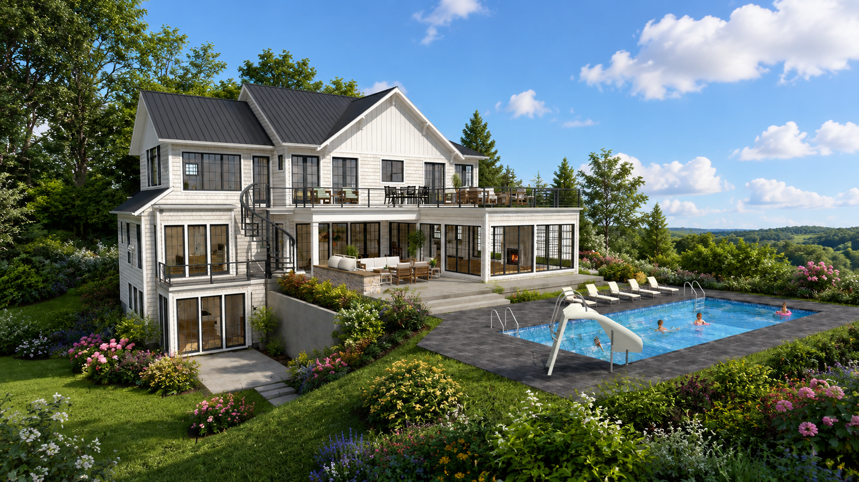

basketballman Posted November 7, 2025 Share Posted November 7, 2025 On 7/27/2025 at 9:54 PM, HardWorkingBee said: Hi @Steve_Nyhof! First of all huge thanks for this incredible thread. I learned so much and everything you've provided encouraged me to take the plunge and start working on my own renderings directly in CA. Please see the attached screenshot. The rendering is not complete but that doesn't change the outcome. I'm getting those light stripes and the dark horizontal band on the background image. I tried changing the sun position, the image position and the image orientation to no avail. It doesn't happen with the spherical backdrop. Applying the backdrop has no effect on the stripes. I'd greatly appreciate any pointers any of you could provide please. Best, Onur Pretty easy fix .. AI enhanced .. 1 Link to comment Share on other sites More sharing options...
Steve_Nyhof Posted November 7, 2025 Author Share Posted November 7, 2025 35 minutes ago, basketballman said: Pretty easy fix .. AI enhanced .. Looks great! Thank you for showing a solution to my backgrounds. So a little more context to help others. Did you upload this picture and ask AI to clean it up? And would you like to share what AI you used. I personally like Midjourney, but there are many now. Link to comment Share on other sites More sharing options...
basketballman Posted November 7, 2025 Share Posted November 7, 2025 Yes, I uploaded your image into one of the A.I. programs that I use. ( There are several ) Not only were streaks removed, but image was also enhanced ( upscaled ) significantly at the same time. Grass now looks real and lighting is greatly improved. Chief should really consider incorporating A.I. capabilities into the program, since it's here to stay and gets better every day. Not doing so may start to hurt future CA sales since less expensive and even free cad programs can replace it and beautiful renderings can be done via A.I. I no longer spend all the time and effort necessary to do a decent render in Chief. Interior design and rendering is where A.I really shines. I offer a training course in A.I. that covers the use of prompts, negative prompts, techniques and which free programs to use and when. 1 Link to comment Share on other sites More sharing options...
ACVNarch Posted November 7, 2025 Share Posted November 7, 2025 Quote Because we are in X17 now, I would use HDRi backgrounds as chief uses them. I do like my backgrounds because they are more congruent with the 3D imagery of the model, and I can often rotate the scene or sun a bit to hide the lines, but what I am seeing here in your image would work nicely with HDRi backgrounds... Thanks Steve!! I'll give it a shot and provide an update. Link to comment Share on other sites More sharing options...
Steve_Nyhof Posted November 7, 2025 Author Share Posted November 7, 2025 Just now, ACVNarch said: Thanks Steve!! I'll give it a shot and provide an update. Thank you, I would love to see it! Link to comment Share on other sites More sharing options...

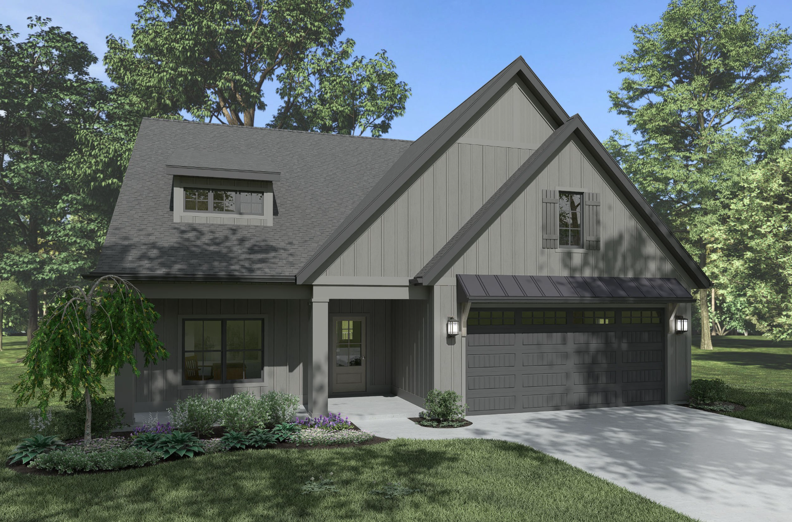

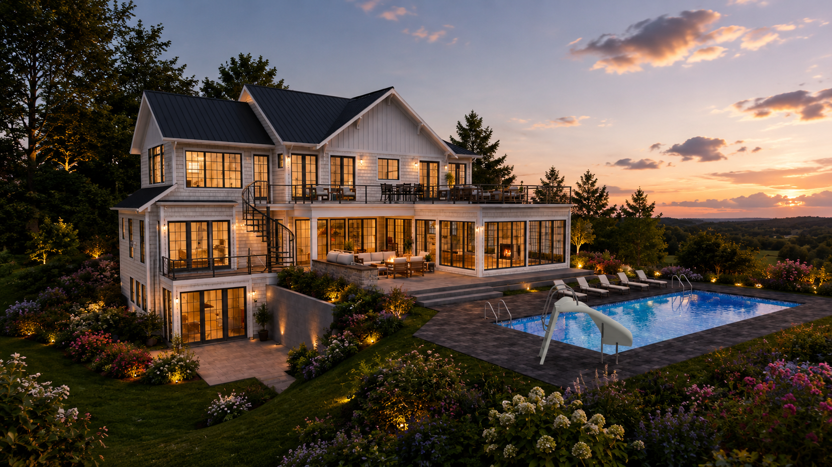

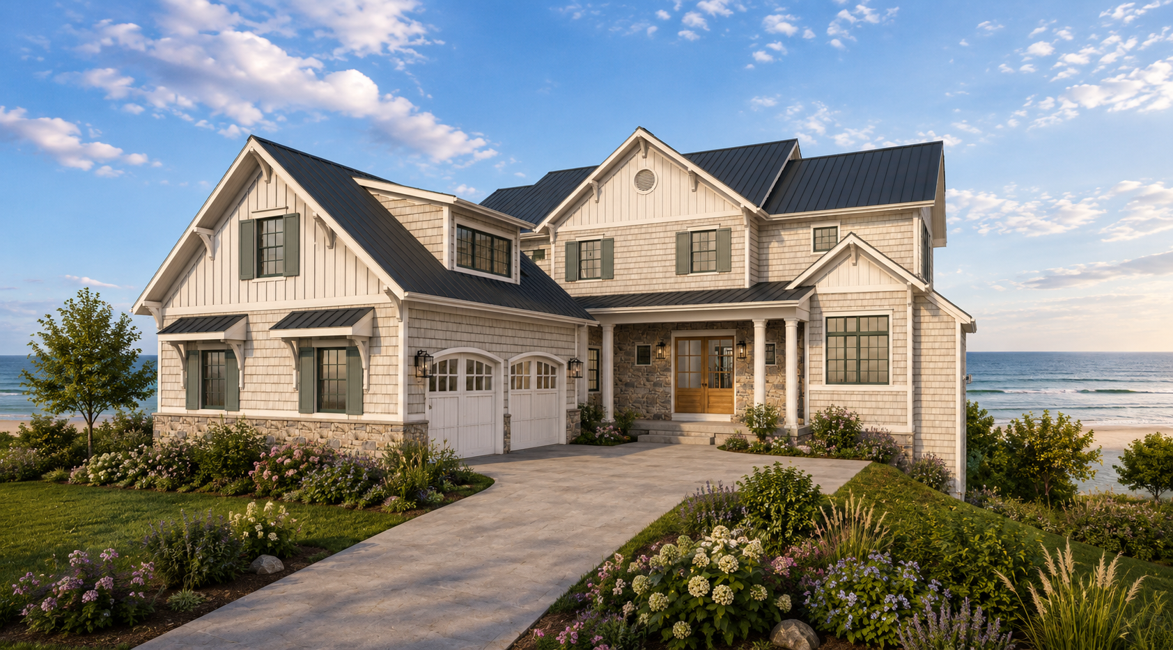

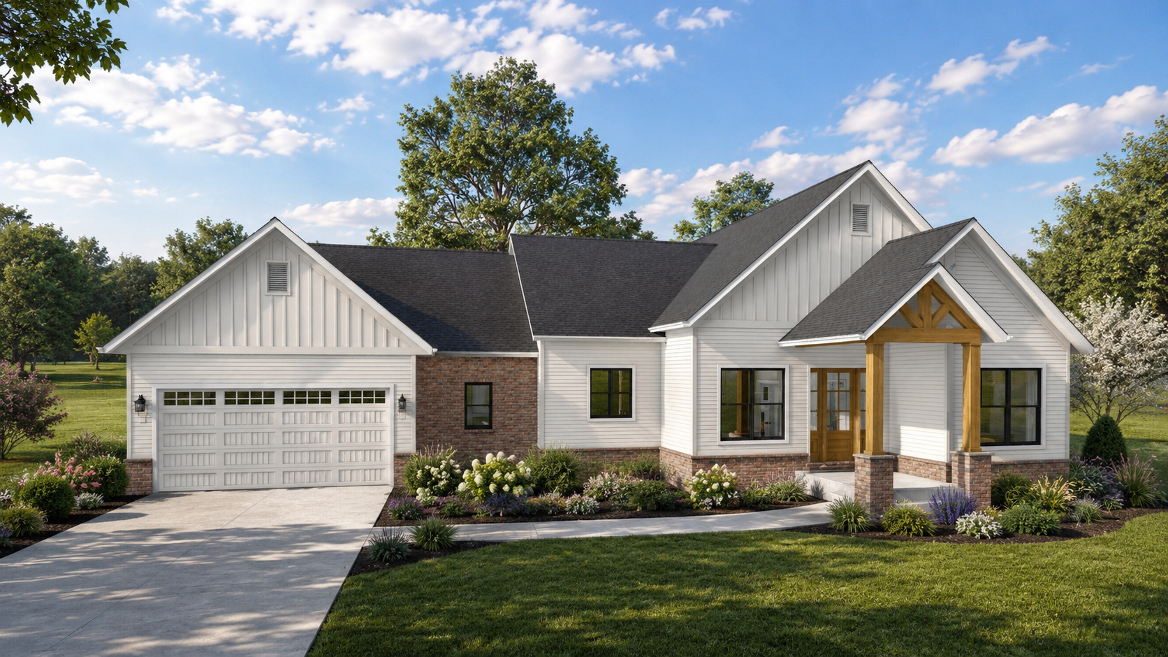

Steve_Nyhof Posted May 17 Author Share Posted May 17 (edited) Its been a while - and I have been busy, but I finally got around to testing AI software to generate renderings. I tested a few on the market like Rerender and ArchiVinci, and they fell flat in comparison to ChatGPT. I moved to Claude for writing as ChatGPT is typically sycophantic in its approach. But I tested it for rendering with very little prompt and its output is very impressive. Exported image from Chief. Note I did not even ask it to retain the original structure, it just did. Also note that I worked with it for 8 months and it knows who I am and what I do. That could play into the short prompts working for me. Prompt: Add beautiful landscaping plants and flowers and bright morning sky with 20% clouds. Add a few kids swimming in the pool Prompt: Add beautiful landscaping plants and flowers and evening mood. sky with 20% clouds. And the front. Note the stone still shows a pattern. I tried to have it remove the pattern, and I will find a way, but I do like that ChatGPT has left my model alone. Edited May 17 by Steve_Nyhof Link to comment Share on other sites More sharing options...

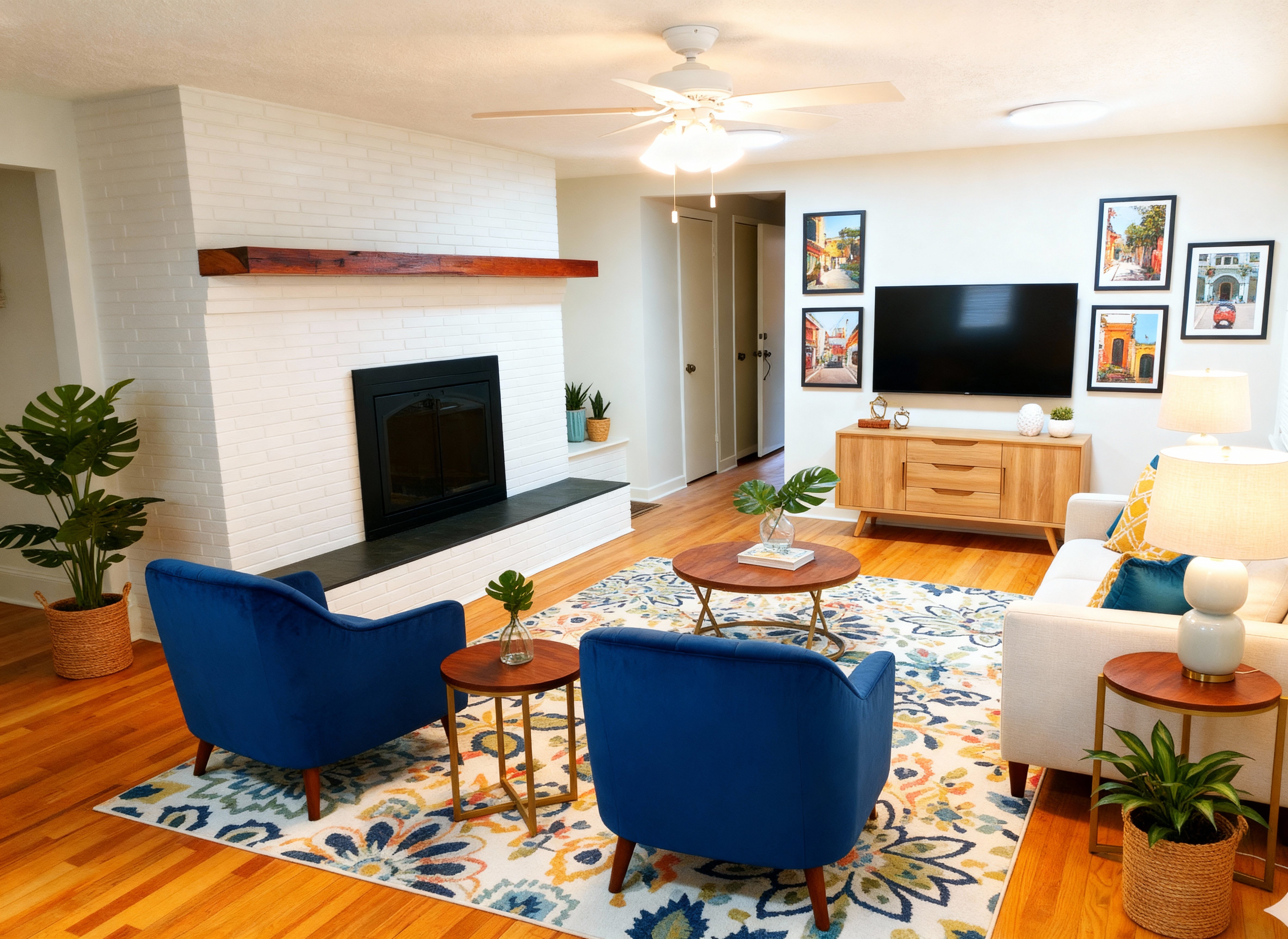

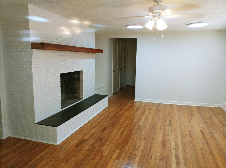

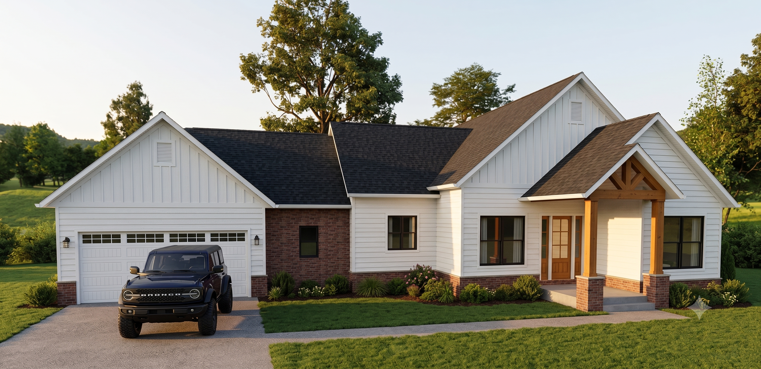

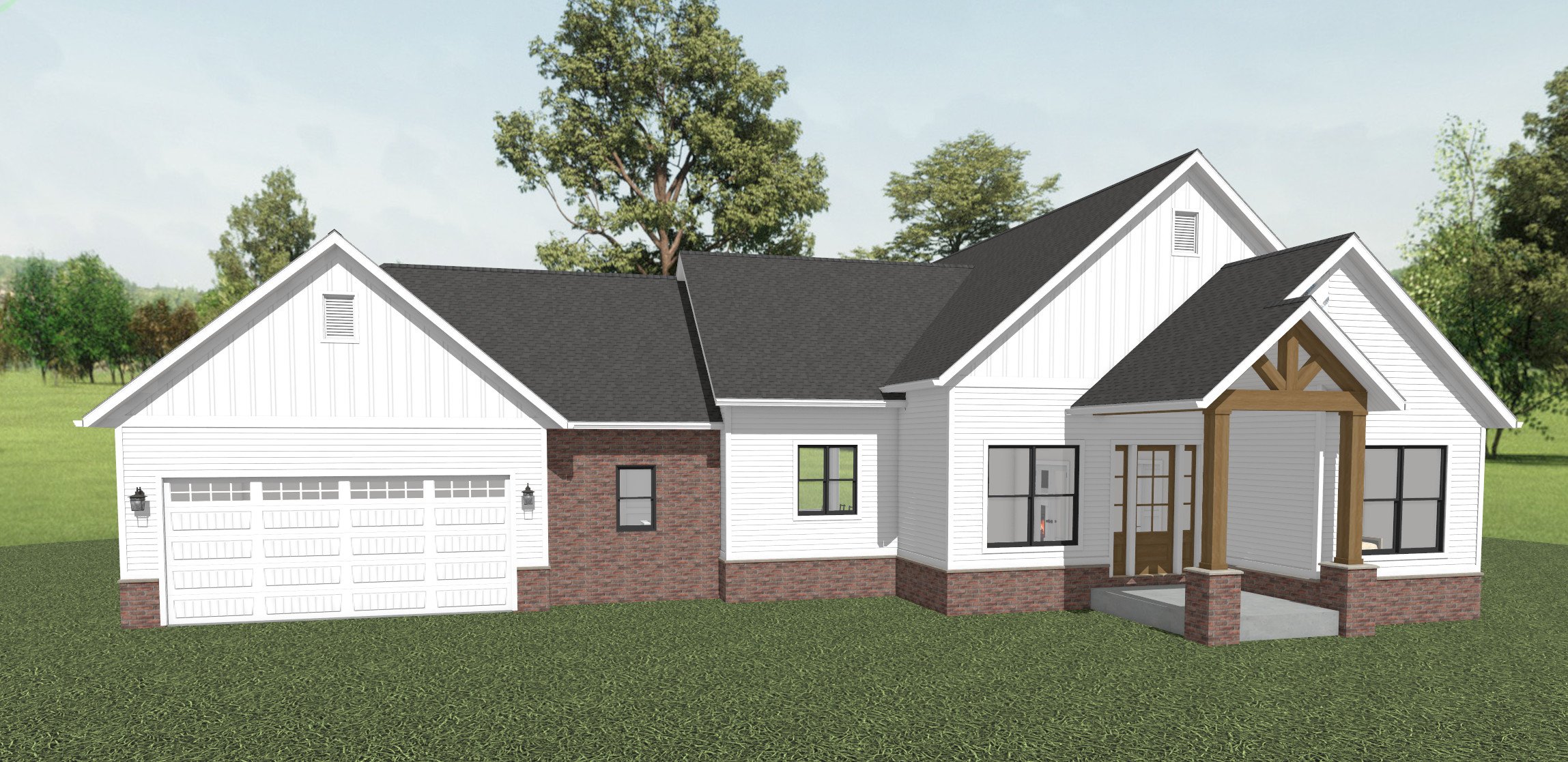

ACADuser Posted May 17 Share Posted May 17 Wow nice job! Just tried for the frst time & only the 2nd version from ChatGPT. https://chatgpt.com/s/m_6a09c42d17788191a3b10acc2368c3ea Link to comment Share on other sites More sharing options...
Steve_Nyhof Posted May 17 Author Share Posted May 17 Wow!! Is that amazing or what! Beautiful Link to comment Share on other sites More sharing options...
