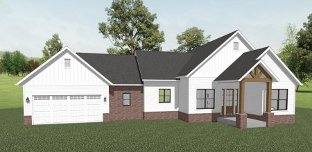

Steve_Nyhof Posted March 30, 2024 Author Share Posted March 30, 2024 How is this for materials and texture mapping? I knew Chief had it in it. Was a nice way to spend a rainy Saturday afternoon. My posts and beams are solids with solids subtracted on the edges to split the wood. The roof and a few other textures are using all the map fields. The stone are terrain sidewalk polys broken up to allow the grass through. I used my grunge images on the brick walls and the deck floor. Chiefs grass is very nice, but their plants pull the realistic look out of the picture. But I did darken them which helps. You can also see I used a few wall regions on the brick and foundation stone, as well as the wood lintels. My background is not perfect yet, but my granddaughter is bugging me to play with her. So I will fix this up later. Added some broken glass to the front window 3 2 Link to comment Share on other sites More sharing options...
Ryan-M Posted March 31, 2024 Share Posted March 31, 2024 4 hours ago, stevenyhof said: How is this for materials and texture mapping? I knew Chief had it in it. Was a nice way to spend a rainy Saturday afternoon. My posts and beams are solids with solids subtracted on the edges to split the wood. The roof and a few other textures are using all the map fields. The stone are terrain sidewalk polys broken up to allow the grass through. I used my grunge images on the brick walls and the deck floor. Chiefs grass is very nice, but their plants pull the realistic look out of the picture. My background is not perfect yet, but my granddaughter is bugging me to play with her. So I will fix this up later. This is cool, thanks for sharing. Adding more variety to the grass tool (and expanding it to other types of similar foliage) is something we've talked about a lot, and these are good examples of what it could do. 1 Link to comment Share on other sites More sharing options...

Steve_Nyhof Posted March 31, 2024 Author Share Posted March 31, 2024 12 hours ago, Ryan-M said: Adding more variety to the grass tool And maybe random works, or at least it could be one of the options, but as an artist (speaking for anyone with an eye for proper detail), maybe even a map over the grass region with +Add options so we could specify where within the map we would place random features (plants, grasses, etc.). And like the grass, options from little to many, etc. +Add = add plant one +Add = add grass three +Add = add leaves B And then within each added option are controls for each with an optional map parameter where you want them located. Map regions could overlap each other. You get the idea. Link to comment Share on other sites More sharing options...

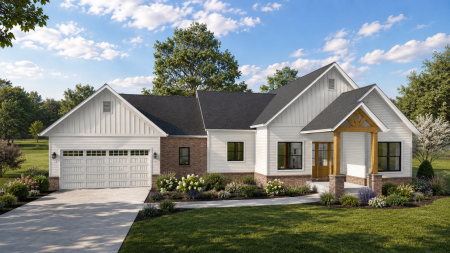

Steve_Nyhof Posted April 1, 2024 Author Share Posted April 1, 2024 I worked on my modern house with new material textures and maps. The stone on the wall I made from a wallpaper and put into PixPlant 5. I put in a photo for the background. I still like to see some bushes, and that is still an area to put some work into. I'm trying to push the bar for Chief renderings so they look into more realistic trees and bushes. I have trees in Twinmotions that are up to 700 Mb's, so I do not expect those types of file sizes in Chief. Even when you get into 4k maps the system really starts to lag. Daytime Nighttime 3 Link to comment Share on other sites More sharing options...
SHCanada2 Posted April 1, 2024 Share Posted April 1, 2024 those both look really good. are these just plants: Link to comment Share on other sites More sharing options...
Steve_Nyhof Posted April 1, 2024 Author Share Posted April 1, 2024 Yes. Those are in my library posted above Link to comment Share on other sites More sharing options...

MPDesign Posted April 1, 2024 Share Posted April 1, 2024 Wow, Awesome job Steve! Really great views right out of Chief! Curious how long does it take your card to render the images? 1 Link to comment Share on other sites More sharing options...
Steve_Nyhof Posted April 1, 2024 Author Share Posted April 1, 2024 1 hour ago, MPDesign said: Wow, Awesome job Steve! Really great views right out of Chief! Curious how long does it take your card to render the images? Thank you, Michael! I do not make any money at present from renderings. I have done a few for money, but because I have wanted to do this for so many years, I just needed to prove to myself that I could do it and find a process that I could repeat in a little time. You can fuss for hours, like my cottage rendering above, but if I was on the clock I could do this in less than 2 hours once I had the materials. Finding and setting up new materials is what takes a lot of time. When I set the samples to 500 it takes maybe 45 seconds to render. One thing to note, you can get 4k and 8k images out there, but some of the images I am using, like the pavers were 4k, but I reduced them to 1k (1024) just to keep the lag out of every step. You start to place 4 to 8 4k materials and maps into your drawing and you will come to a crawl. Well, maybe not you, looks like you have a very nice computer! My son and I put a computer together yesterday on https://pcpartpicker.com/ - not sure when or if I will pull the trigger. Link to comment Share on other sites More sharing options...
