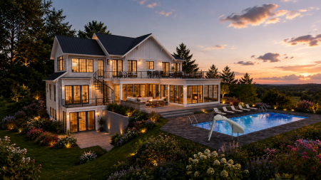

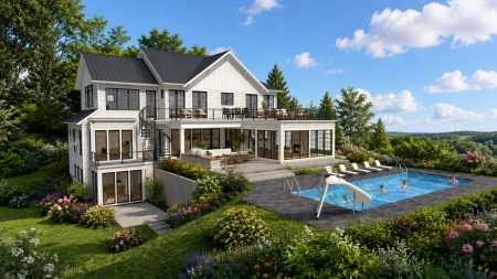

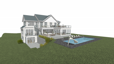

Popular Post Steve_Nyhof Posted March 14, 2024 Popular Post Share Posted March 14, 2024 Using this method, you can create beautiful renderings in less than an hour. Everything you need, including my 3D modeled background images, shadow trees, Leaves, Clover and more are below. Make sure to follow this thread down as I have continued to add more ideas and more things to the Libraries... Here is a brief overview explaining the steps below... https://my-plan.stevenyhofdesigns.com/v/iwg6TRh5GxnwXhQwmWLA Step by Step on how to render a fast and beautiful image in Chief Architect I am using an image only for the background image instead of the Backdrop which gives me more control over the placement and look I am after. I made up 7 background images for you to use. As an image you can move it around easily, scale it and even reverse it for another rendering. These are the grass settings... You can of course mess with these, but I am matching my background images. This shows the placement of the camera and the background image. In my model I am taking a picture from the rear corner. How to capture a proper and realistic perspective... set your horizon about 1/4 to 1/3 of the total height from the bottom set your camera height at eye level. It can be lower for a neat effect, but never higher as it will make the person looking at the house feel like they are 10' tall. Only birds see houses from 10' high. (Unless you are being intentional to show off the roofs) Your house should be top priority. I have seen renderings where the designer wants to show off a beautiful mountain scape, etc. When a person is searching for what they like in a house they don't care about your background. The background should enhance the house. in camera view, move the model/view up a bit on your screen so that the side walls of the exterior of the house are vertical or leaning in just a little. In chief if the model is too low it will lean in vertically too much and lose a realistic perspective. Moving the model up will encroach on the sky so not too much. When possible, there should be more sky above the model than grade below the model in your captured final image. This is difficult with Chief and I have a ticket in with them to look into lowering the floor line (0 level) in the camera to below center screen. Now knowing some of these things, spend some time looking at google images of exterior renderings and begin to note which homes really stand out because of the horizon placement (sky vs grade), and the model angle (eye view). The tree I am using only as shadow trees. I will have some nice 3d trees available in the future that will look more realistic to place in the foreground and in your scene. Carpinus caroliniana 2 - see the size in the DBX below Camera PBR Settings Camera Specs The sunlight I am using - set the angle of sunlight until shadows looks good for the house and the trees. I am using the tree shadows to hide the edge of my grass/terrain. Not too much shadow on the house. Set the Backdrop image from the Library included. This image is used for the window glass reflection only. You can control the Horizontal Offset to get the tree reflection you like in the windows. Change the glass material properties on the windows to 2.5 Index of Refraction. This will allow some view through the glass and into the rooms but also create reflection of the Backdrop image trees. This shows the view of the software and the different elements involved before the screen capture. (I like my menu on the left - not important here) This is what the rendering can look like when complete and after placing Chiefs plants... I do not mind Chiefs plants, they look pretty nice. The most time you will spend on this is on the plants and shadow trees. Now that I have this all in place I will need to test my time, but I think I can pull this off in less than 30 minutes. Home Designed by BD Design Here is the Library of background and backdrop images https://drive.google.com/file/d/1DAyFz76wks-jABoMGXbjmxryAAhI9axB/view?usp=sharing Here is the plan template where I have the camera and backdrop all set up... Open the drawing and copy the camera in the circle and paste it into your plan/template. https://drive.google.com/file/d/1H24RNzj_vEOkgn2-XkWc_KzdzxVyGq02/view?usp=sharing I would love to see some renderings that you create using this method Steve 6 10 Link to comment Share on other sites More sharing options...

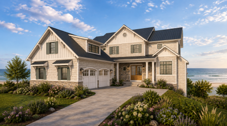

Steve_Nyhof Posted March 22, 2024 Author Share Posted March 22, 2024 Here is a house plan I just completed, and because the owner is going to use it as a Airbnb, he wanted some simple renderings. I set up the same camera I include above, placed my background image, put in a few nicer trees that can also cast shadows and rendered the image. Then I made a copy of the camera and put it in the front of the house, moved my trees a bit and rendered the next image. Both in about 5 minutes. I did not spend any time on landscaping. This is the lake side of the house This is the front side so you can see I used one of the backgrounds that has a lake Here I am pointing out where the Terrain ends and the Background image begins, and how to use the tree shadows. I think this is why this method is working well... https://my-plan.stevenyhofdesigns.com/v/qgO8wvasLRm4GlCLFBrw 3 Link to comment Share on other sites More sharing options...
