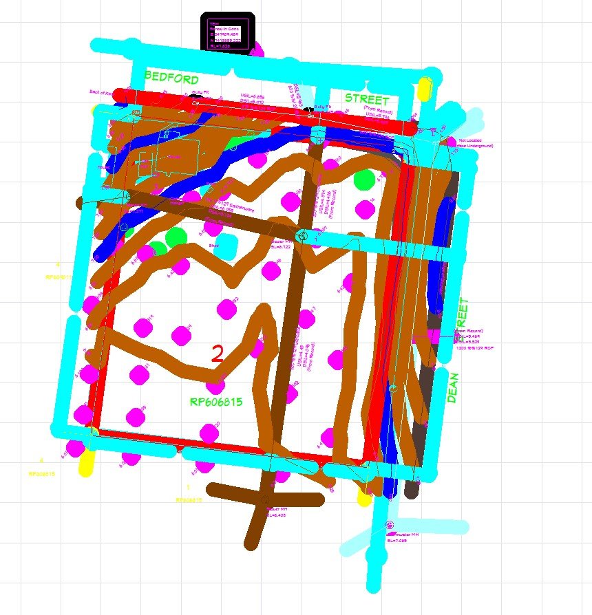

cavemanwfire Posted September 16, 2025 Share Posted September 16, 2025 back again with same issue for same block had major health issues and starting again from scratch since my chief license has expired, i'm chasing for someone to do: a) the block from scratch, showing the approved retaining wall positioned on the block, the overall diamentions of the block + diamentions of each key position point ie; retaining wall and sewerage. b) with services shown on a second copy and c) contours on a third copy, taking into account the retaining wall elevations and as if the retaining wall and fill are completed. please message me the costs to do such an endevour. cheers in advance can supply the retaining wall, contours and service locations attached is the survey plan and retaining wall SITE PLAN inc Conours & Underground Connections.pdf Retaining Wall - Approved Plans.pdf Link to comment Share on other sites More sharing options...

cavemanwfire Posted September 17, 2025 Share Posted September 17, 2025 @Renerabbitt now dwg file - it was lost when business sold no 3D required, just basic drawings ( for you anyways ) attached is a sketch of what i\m chasing wanting it in chief format, as i can still access chief but cant modify in chief desired plans.pdf Link to comment Share on other sites More sharing options...

cavemanwfire Posted September 18, 2025 Share Posted September 18, 2025 (edited) @mthd97 if you refer to the previously attached site plan, it goes min 10m outside the 5x boundaries i'm not asking for miracles, its already been done. its just that the original dwg is lost Edited September 18, 2025 by cavemanwfire sbelling ebors :D Link to comment Share on other sites More sharing options...

cavemanwfire Posted September 18, 2025 Share Posted September 18, 2025 @mthd97 Ohh yes the $97 was such a great investment look at the attached file would have so preferred to have paid someone to do this, to begin with at least it wouldn't look like its been paint drawn by a 5 year old Link to comment Share on other sites More sharing options...
mthd97 Posted September 18, 2025 Share Posted September 18, 2025 (edited) Yes It is always good for us to have go. This video also might help with importing a DWG site survey plan into Home Designer Pro if you decide to go down that road ? Here Scott shows us how to go about it in detail with Chief but it might also work with HDP ? https://www.chiefarchitect.com/videos/watch/1056/import-a-surveyor-dwg-file-for-a-site-plan-or-terrain-perimeter.html Edited September 18, 2025 by mthd97 Link to comment Share on other sites More sharing options...
