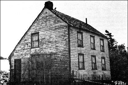

decorators3 Posted 20 hours ago Share Posted 20 hours ago I'm trying to create a Saltbox-style roof similar to the one in the attached photo. Would this require different roof pitches on each side? I'm considering a vaulted ceiling on the second floor, but I'm concerned that the longer, steeper roof slope may interfere with the second-floor space and structural framing. Has anyone created this style of roof in Chief Architect? Any suggestions on the best way to approach it would be appreciated. thanks Link to comment Share on other sites More sharing options...
NRST8TRKR Posted 19 hours ago Share Posted 19 hours ago Hello, Last time we built a Salt Box we used the same pitch front and back. It has been quite a few years though. Have a great day,Ken Link to comment Share on other sites More sharing options...
CharlesVolz Posted 18 hours ago Share Posted 18 hours ago That is the same pitch on both roof planes. Follow the horizontal lines of the siding from eaves to eaves. Link to comment Share on other sites More sharing options...
DBCooper Posted 15 hours ago Share Posted 15 hours ago See if this helps: https://www.chiefarchitect.com/support/article/KB-00119/automatically-creating-a-saltbox-roof.html Link to comment Share on other sites More sharing options...
decorators3 Posted 12 hours ago Author Share Posted 12 hours ago 2 hours ago, DBCooper said: See if this helps: https://www.chiefarchitect.com/support/article/KB-00119/automatically-creating-a-saltbox-roof.html fabulous! worked perfectly thank you for the link! Link to comment Share on other sites More sharing options...
