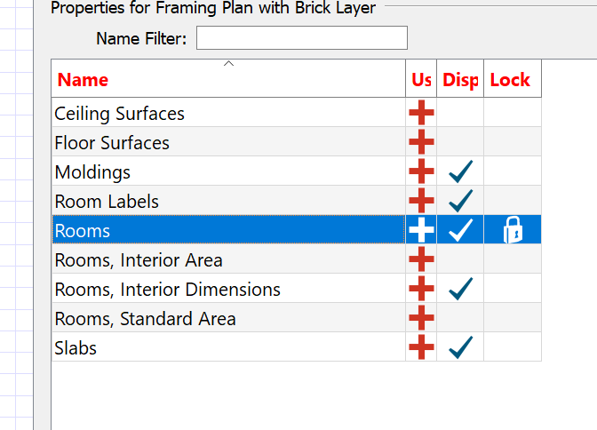

rwdozier Posted August 23 Share Posted August 23 First things, first... If you can't "select" / "highlight" a room, it's possible that Rooms may be locked in the Active Layer Options. Unlock them and try it. 1 1 Link to comment Share on other sites More sharing options...
chrisinnh Posted August 23 Author Share Posted August 23 Ugh, was hoping that'd do the trick! Went through the process of building the wall assembly one layer at a time. Turning on the "furred wall" option turns off the roof and makes the room inaccessible- which is very odd, I used this option on a different version of a plan earlier today. Link to comment Share on other sites More sharing options...
