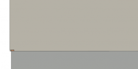

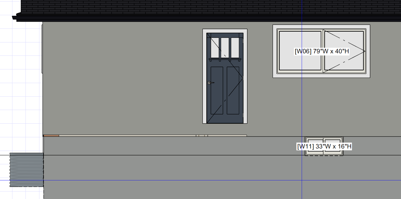

open to below room causes stucco to not come down
SHCanada2

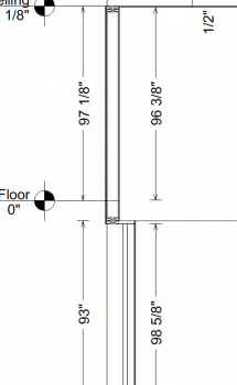

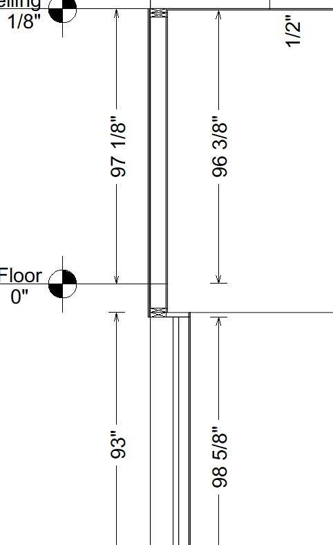

see below. There is no break in the foundation wall nor the main floor wall.
I know I can pull it down...but should I have to?
On the residential template, it only exhibits the same behaviour in the corner. shown below as well.
I also noticed it shows as bottom plate & sill plate in my plan in the structure panel, but the residential template only shows 1. both have sill plates checked on the foundation walls
stock template:
179 Maple Court Cr SE.zipimage.thumb.png.3309e04574a7ef4a08e56e555fff0aa9.png
any ideas
