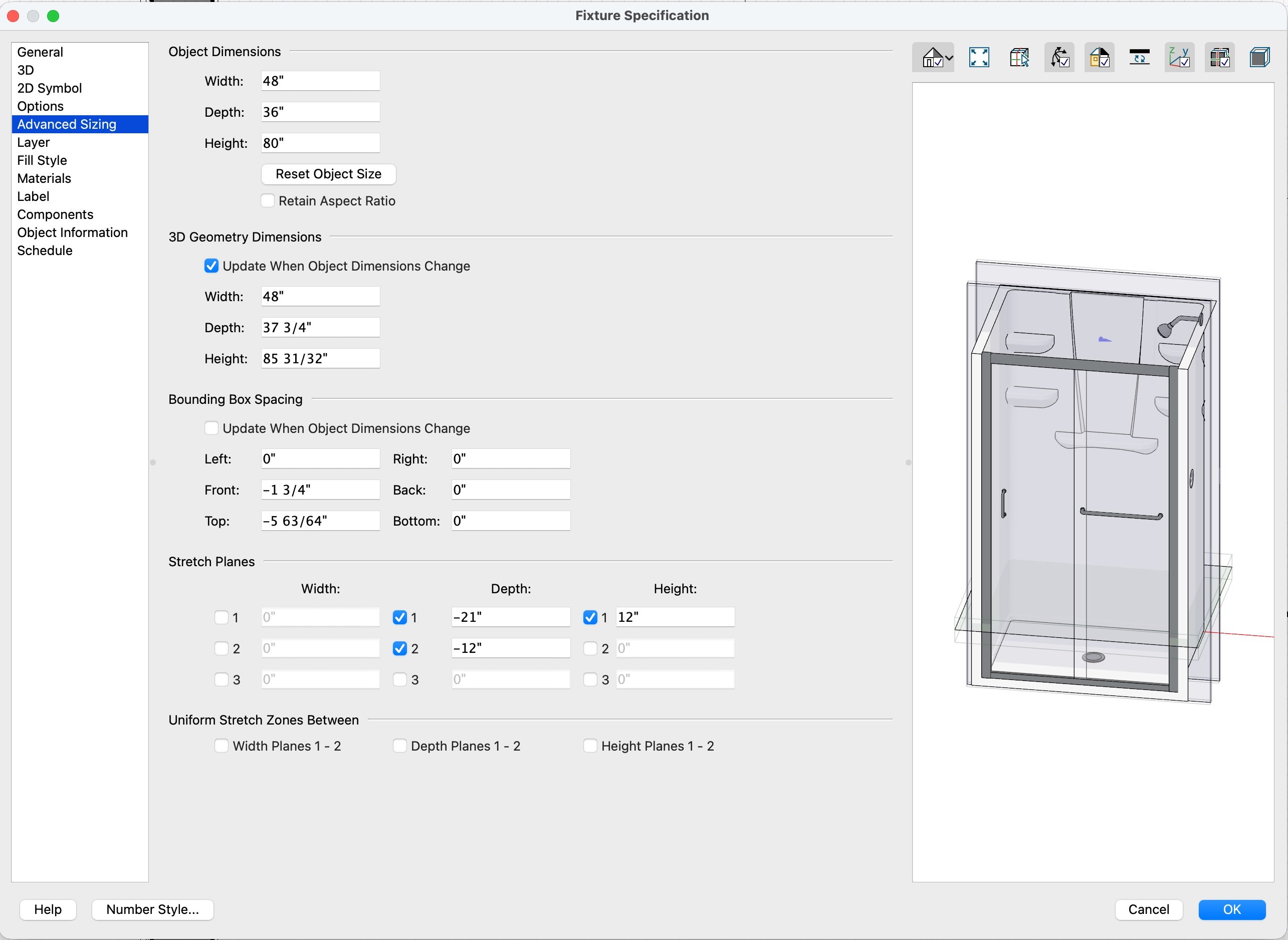

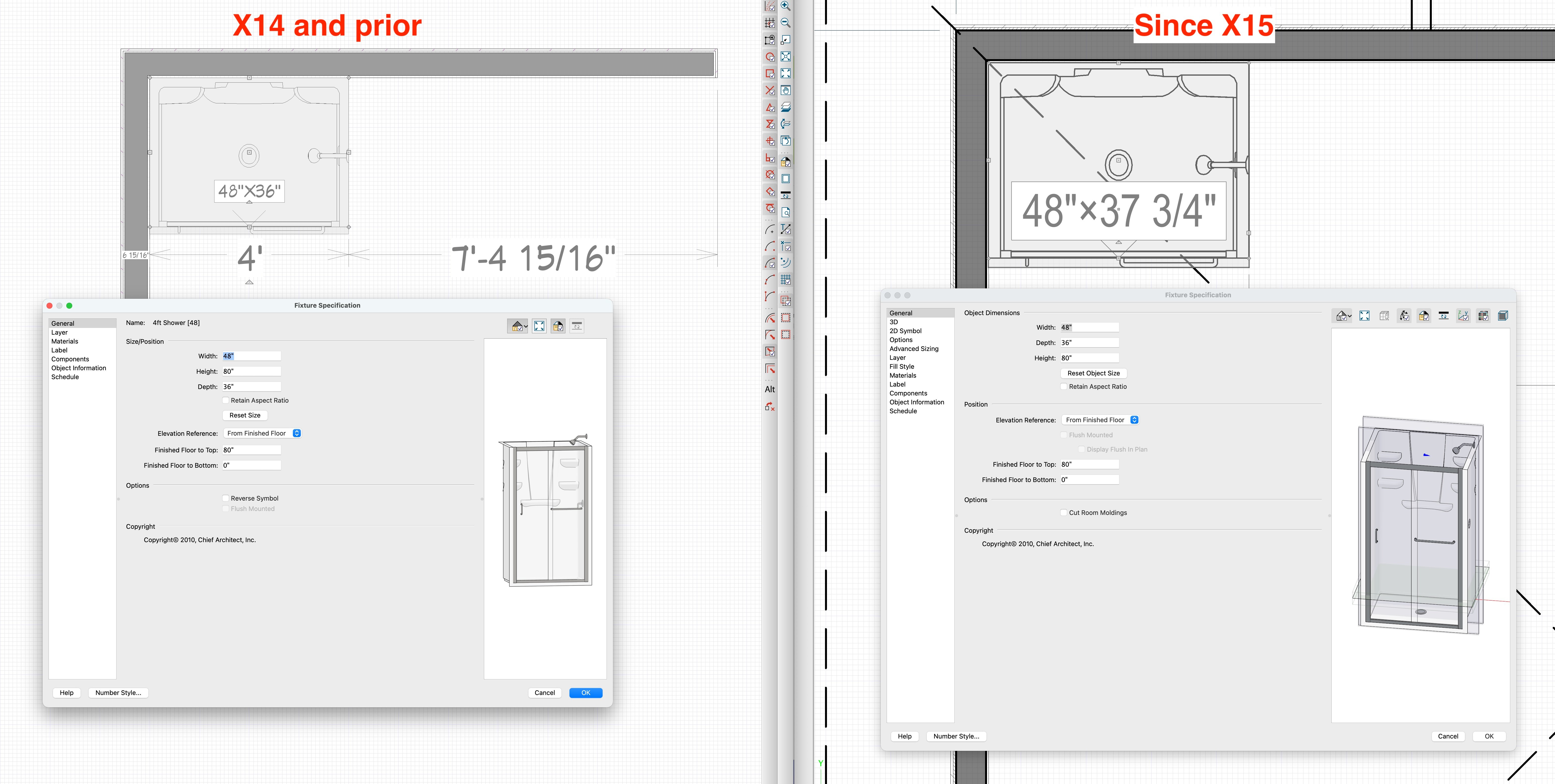

LevisL Posted Friday at 11:14 PM Share Posted Friday at 11:14 PM Looking for some help from the macro gurus on this one! I have plumbing fixture symbols that I've customized over the years. For example, I took the "Rect (medium)" shower from the core library and changed the bounding box to exclude the door handles. I also changed the depth to one that I more commonly use (36"). In X14 and prior versions, the depth macro would report the depth of the bounding box. which was great. Since X15, the depth macro reports the overall depth including the handles, which I don't want. Could I create a custom macro that would give me the bounding box depth? When I checked in the Ruby console, I don't see any attributes/NVP's for the bounding box size... Link to comment Share on other sites More sharing options...
