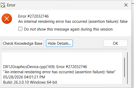

SHCanada2 Posted May 28 Author Share Posted May 28 (edited) i rebooted, same issue. Tried to see if it happend on X16, and got this error when just starting X16 without opening anything going to try and roll back the driver Edited May 28 by SHCanada2 Link to comment Share on other sites More sharing options...

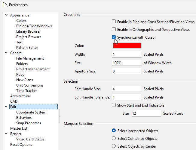

ChiefTylerL Posted May 28 Share Posted May 28 Does changing your Synchronize with Cursor Preference change this behavior at all for you? This setting can be found by going to Edit> Preferences and going to the Edit panel on the left side. Here you will find a setting for Synchronize with Cursor. If this doesn't make any kind of change I would try a different mouse, if you have one on hand. If you're still experiencing the problem I would recommend contacting Technical Support through the Technical Support Center: https://www.chiefarchitect.com/support/article/KB-00717/using-the-technical-support-center.html Link to comment Share on other sites More sharing options...
SHCanada2 Posted May 29 Author Share Posted May 29 7 hours ago, ChiefTylerL said: Does changing your Synchronize with Cursor Preference change this behavior at all for you? that seems to mask the problem. Now when I move the mouse there is a delay in the mouse pointer moving (which is now tied to the crosshairs) I tried 3 different mice, same problem. Not to mention the problem does not occur in plan view. Link to comment Share on other sites More sharing options...
